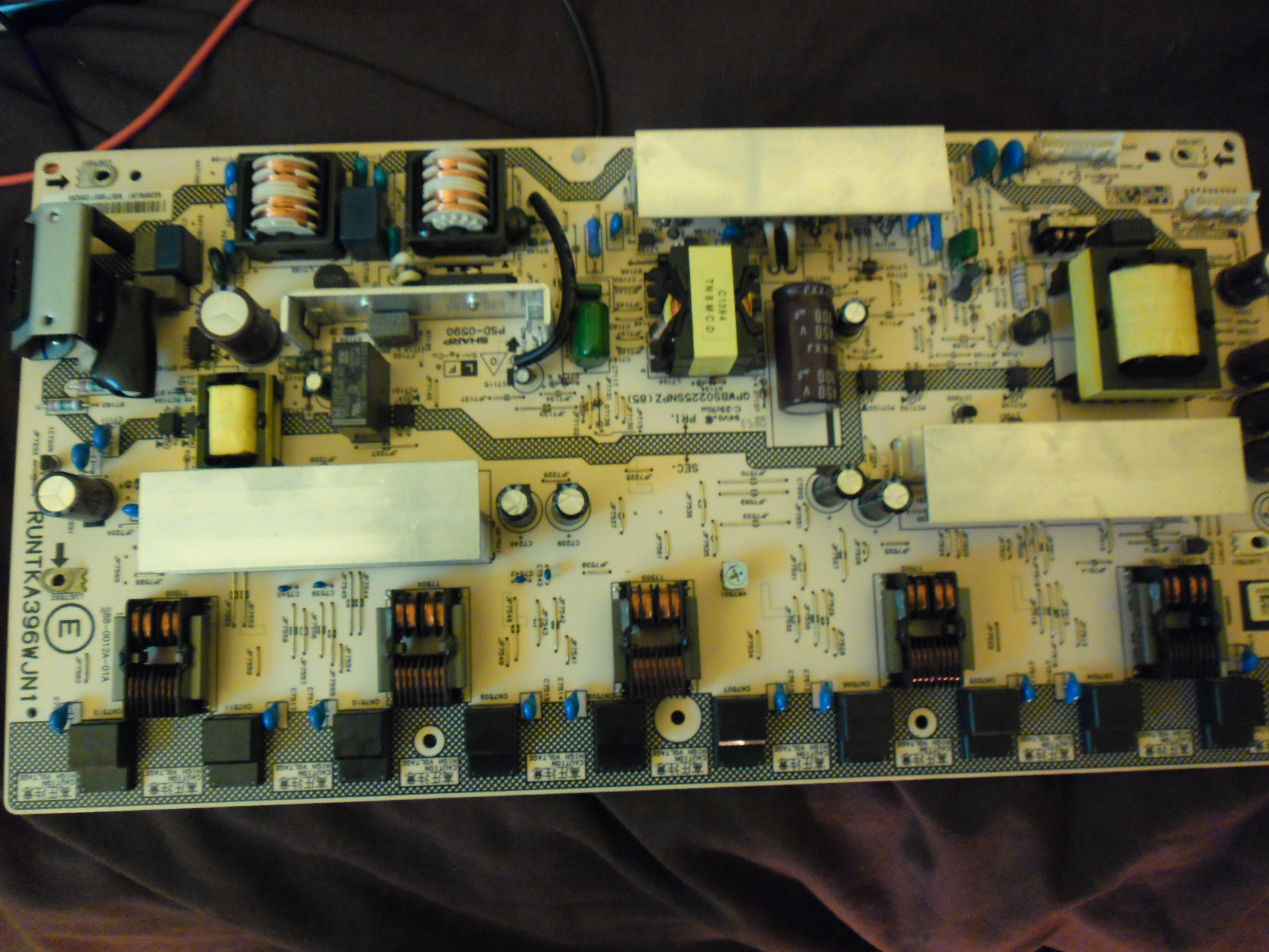

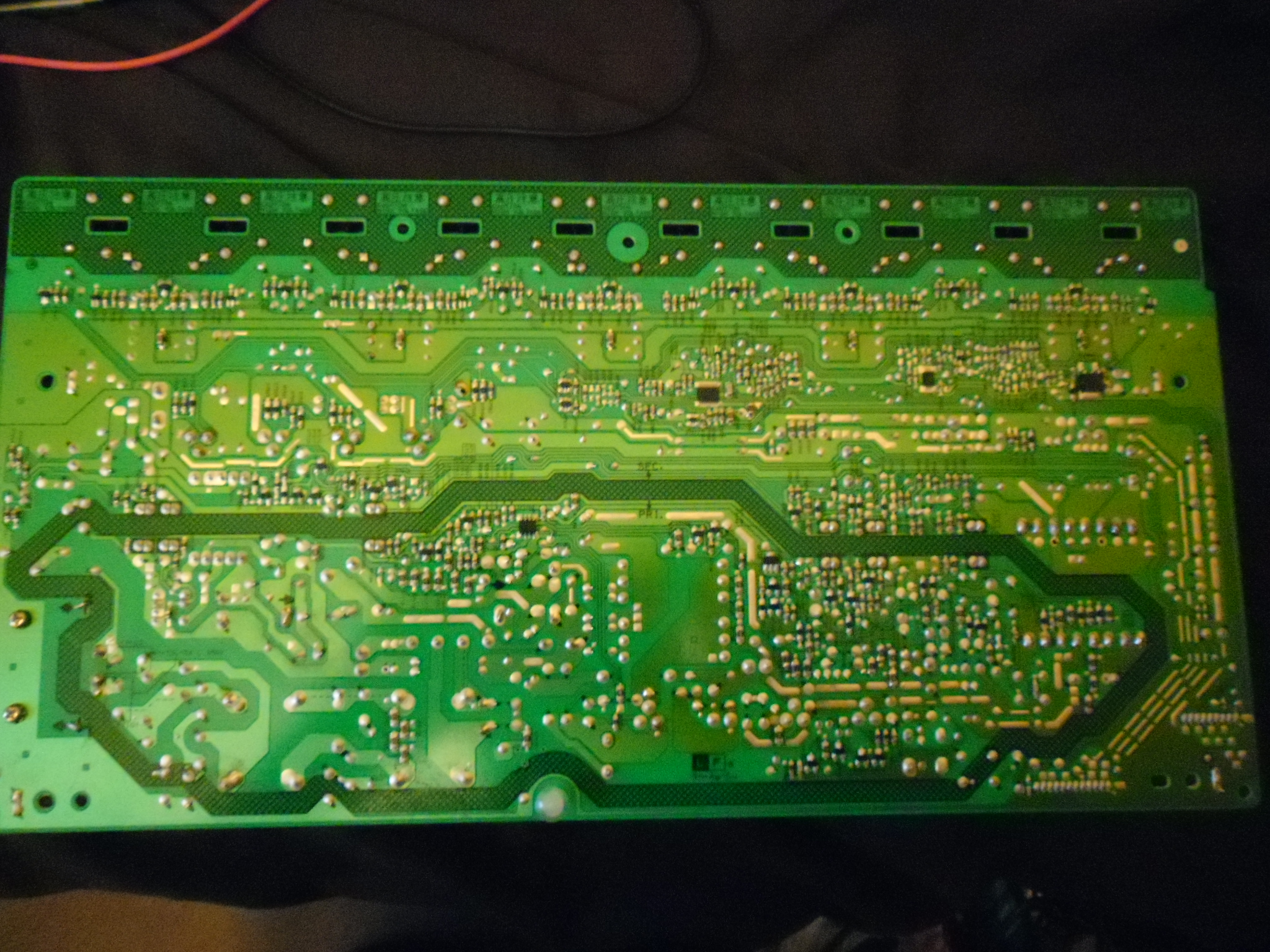

    Hiya got a sharp lc32d44e-bk from a friend stuck in standby mode, solid green led for 2-3 seconds then to red.
    I've done a visual inspection on all the caps on the power board, all seems ok.
    Checked all black diodes & Zener diodes, all seem fine except (D7134) DMM reading in both directions, .607 & .1116 probes reverse. Im sure thats a fault.

    Repaired one of these about a month ago.
    https://www.youtube.com/watch?v=5wUuARpFe90

                                        Did a few recaps, still the same, RL701 doesnt make a proper relay click sound, sounds kinda flat.
                                        Tom66 think the buttons are ok, not stuck
