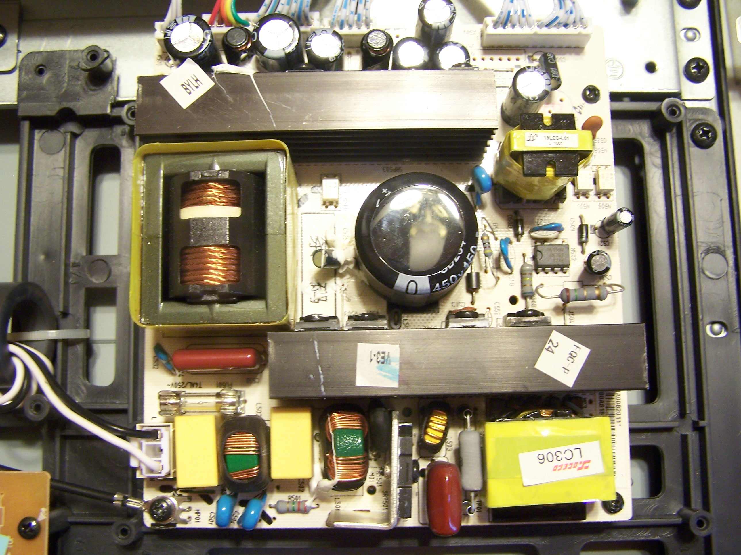

                      I have narrowed the area to where transformer LC306 is located (see photo). Heating the caps made no difference. I've turned it off and let it cool then reheated LC306 about 3-4 times and I get a picture immediately. So do I replace PS or try to replace LC306?

                          Ok - I dont know but heat only usually affects a transformer in that it has cold solder joints - Suggest you take the board out and resolder it - remove the old solder and apply new You may of course be able to see something when you get it off.
                          Other possibilities are the components next to it Resistor? Red Cap ( That actually looks a bit fat?) then the three on the heatsink.
                          Try a partition to keep the heat off the transformer and heat the other parts.
                          Transformers are usually not replaceable ( blast forgotten the word but they are made specially for the board manufacturer to specs for that board and not sold )
                          Edit word I forgot is proprietary

                              Hmm - Just looked further out - does the Big cap have a bulge or is it just the pic.
                              It may just be a plastic end piece - can you press it in?

                                Maybe a bad solder connection on one of the transformer pins? Try adding some fresh solder to each pin.
                                  Re: Insgnia NS-LCD26A:have power & audio, video comes on after 15 minutes
                                  Yeah, its not the transformer...it appears to be the "grey" component but I am still rechecking via isolation and heating. What is the grey component? (i am a rookie!!!)
                                    It seems like it is the resistor, the grey component. I isolated and heated each of the components in that corner and everything points to the resistor, the grey component. Does that make sense? Its definitely not the transformer or the Red cap as I'm pretty sure I did a good job of isolating those components while heating the resistor.
                                      After more testing, I believe its the red cap. I did more isolation to ensure I was only hitting it with the heat and not the other components and heating it solves the problem. I have been turning on the TV from a "cold start" the past 3 hours and it is starting right up which it was only starting after heating the red cap....so I don't know what I did but it seems to be fixed. If it acts up again, replacing the red cap looks pretty simple. Is that what you would suggest?
