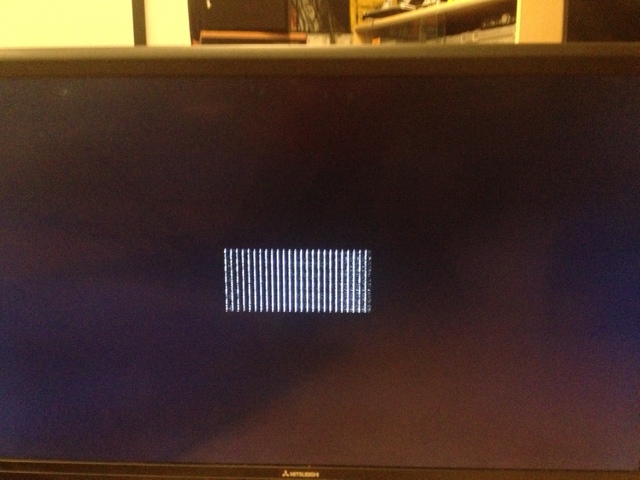

    I just picked up a 65" Mitsubishi LDT651L LCD Monitor. It's a monster!
    It powers up, and seems to respond to commands. the problem is the on-screen image is pretty scrambled. when I power up with no input, I see boxes where the menus should be, but they are crazy looking. ( see attachment, for what would be the "no video input" message.)
    Feeding an input gives me a full screen of out-of-sync looking madness.
    pressing the menu button in this case changes the whole screen to blue-ish out of sync looking stuff- exiting the menu, goes back to the other state. It seems to obey the remote and act normally otherwise..
    Could this be a t-con, main board or power supply cap problem?
    I've ruled out the display itself as there are no permanent H or V lines, it's all very dynamic, and it seems fixable to me.
    Pretty much everything inside appears to be branded Sharp.
    Thanks!

    I would be more considering a main board problem.

      Re: Mitsubishi LDT651L - bad tcon? or PS?
      Hmm.. I can see how that would be the case.
      The main board is a QPWBY1091MPZZ.. I can't seem to find one in stock.
      Do you know where I might look for one? It seems like that main board is found in several brands.
        How about some clear pictures?
