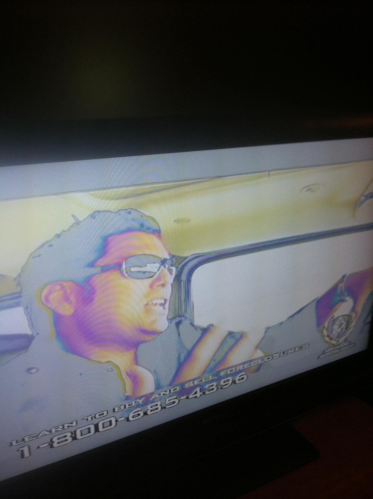

    Hi someone called me with this TV, picture looks like contrast is turned way up similar to a Toshiba I had with wrong main board. Nothing has been worked on with this TV as of yet. Just curious if anyone has any experience with Sony's and this problem?

    I reflowed the main board in the oven, cleaned the LVDS connections, and there was no change. Im thinking it is a bad main board, can a t-con cause this issue though?

        OSD looks OK but still not right, it's just not as noticeable. The color is off. I tried a factory reset and got into the factory menu but nothing has helped.
          Re: Sony KDL-37L4000
          I'm thinking T-con personally though I wouldn't rule out the main board.

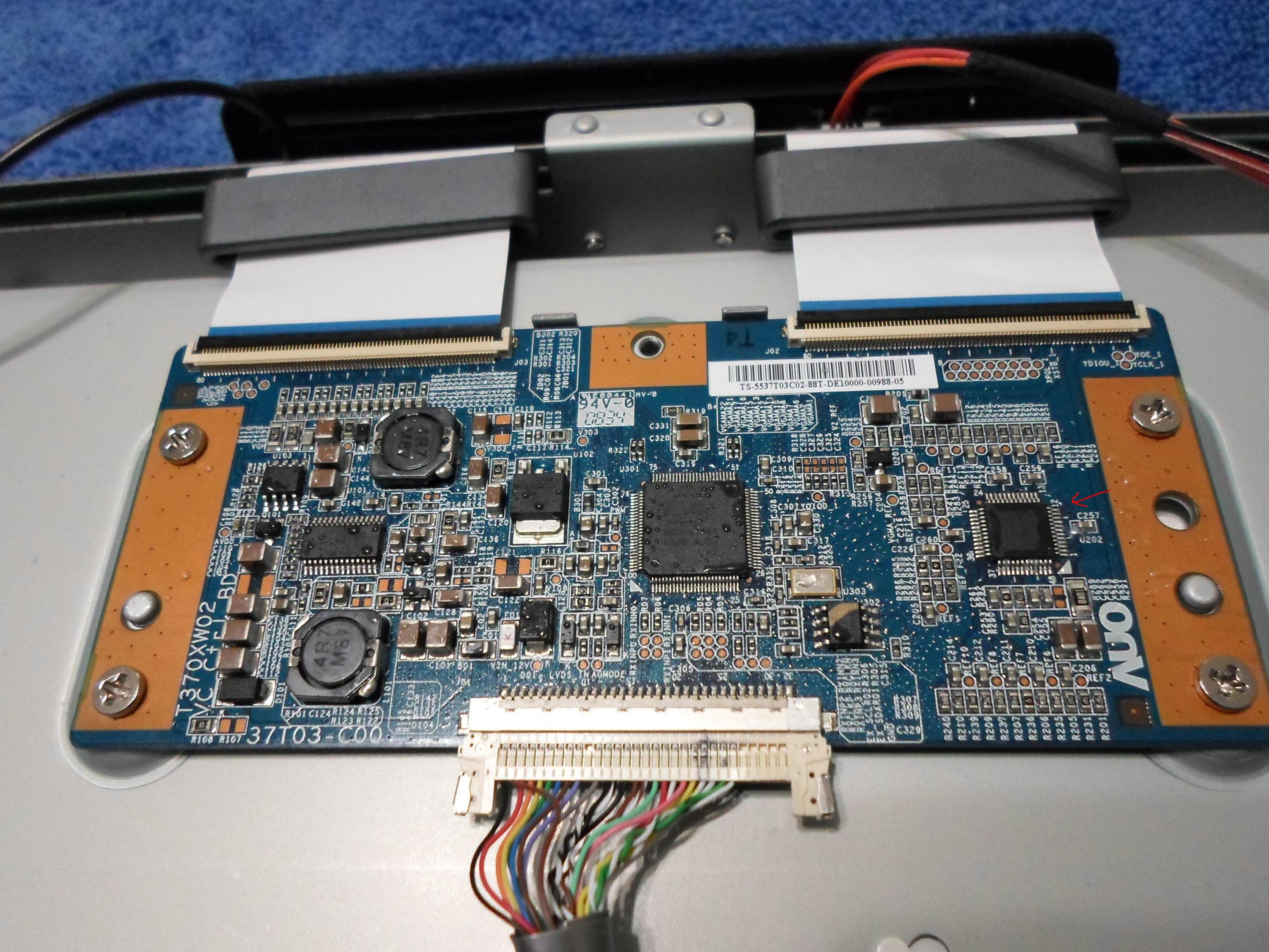

              Well I got new main board today but same problem. So I put old main board in and started looking at t-con (AUO 5537T03C02).
              I froze the t-con board and plugged it in, and although most of the IC's defrosted pretty quickly, the one that went first was the one labeled AS15-U which closest datasheet I found was
              https://cdn.badcaps-static.com/pdfs/...61ea6520a5.pdf
              Tom I know you thought T-Con originally, I swear everytime I had an issue like this it turned out NOT to be T-Con and this time I decided to go with the main board, figures..
              Should this chip heat up normally, or could this be the culprit, description being:
              The EC5575 is a 14+1 channel voltage
              buffers that buffers reference voltage for
              gamma correction in a thin film transistor
              liquid crystal display (TFT LCD). This
              device incorporating a Vcom amplifier
              circuits, four rail to rail buffer amplifier
              circuits (the highest two stage and lowest
              two stage) and 10 buffer amplifiers circuits.
              The EC5575 is available in a space saving
              48-pin TQFP package, and the operating
              temperature is from –20°C to +85°C.
              T-con is expensive and hard to locate..
                That is common failure on T-CON board with AS15 IC.
                https://www.badcaps.net/forum/showth...mma#post304275
                https://www.badcaps.net/forum/showth...099#post304099
                • kevinm34232
                  • May 2012
                  • 1884
                  I saw that after searching that part # on here, thanks Bud. I ordered the part I will post back results..
                  • kevinm34232
                    • May 2012
                    • 1884
                    Replaced the AS15-U IC today and that WAS the problem, TV is working with good color. Thanks!
