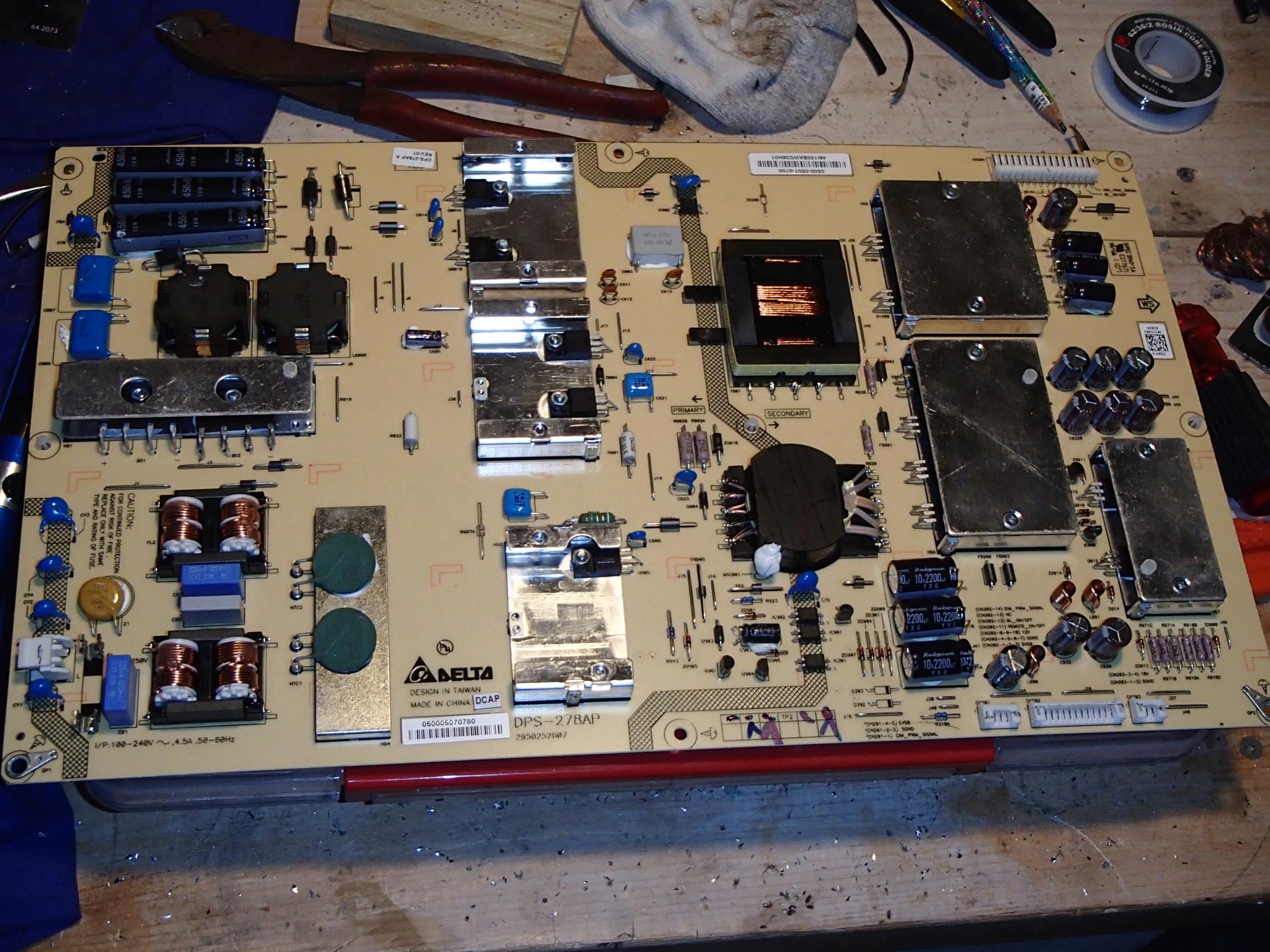

tv does not get power, no standby led or power.

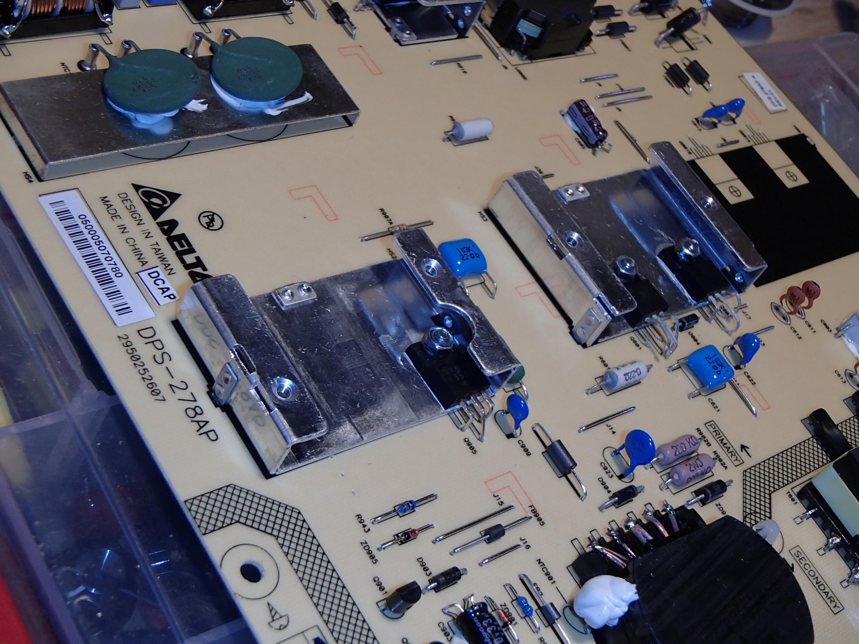

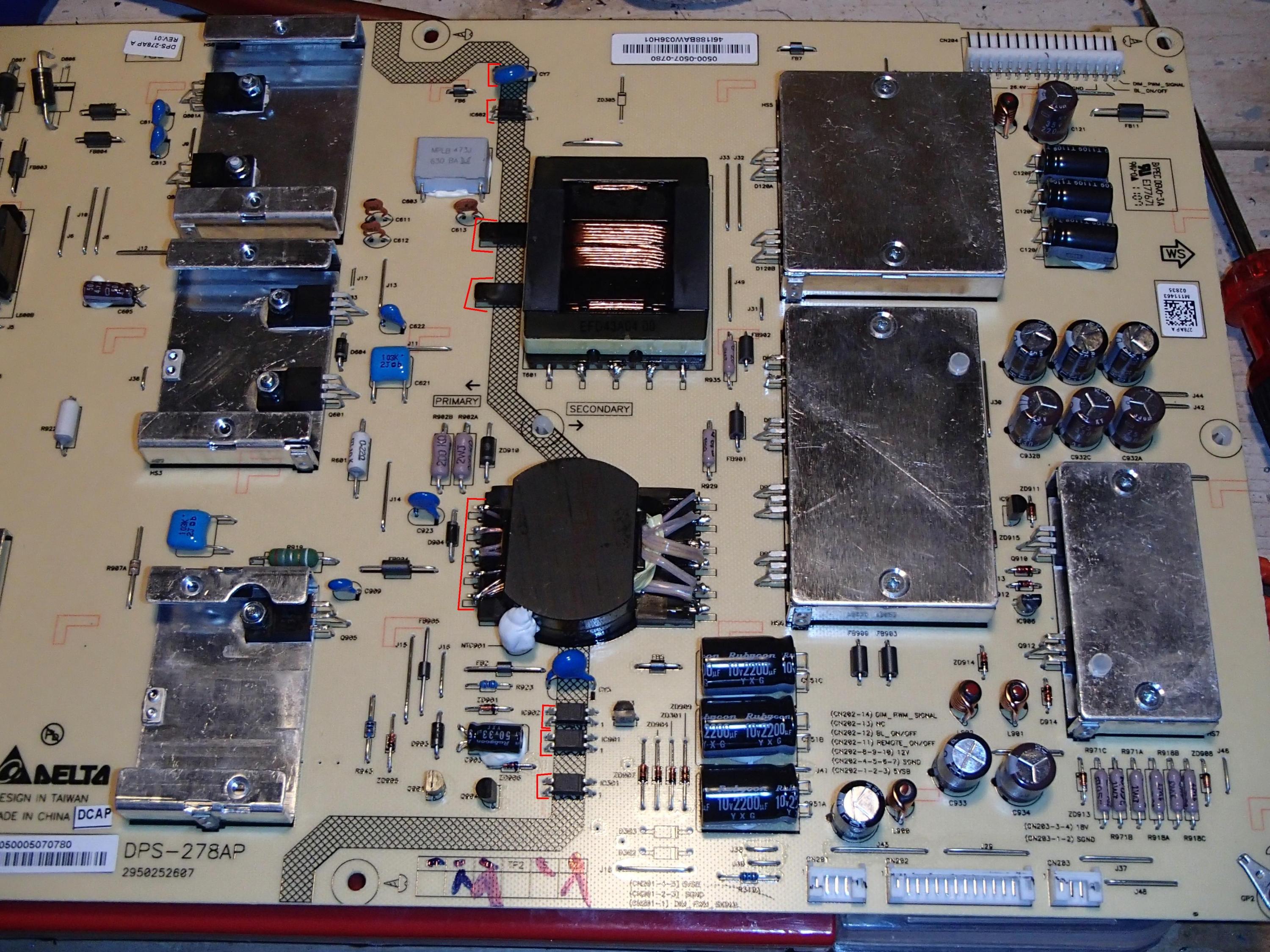

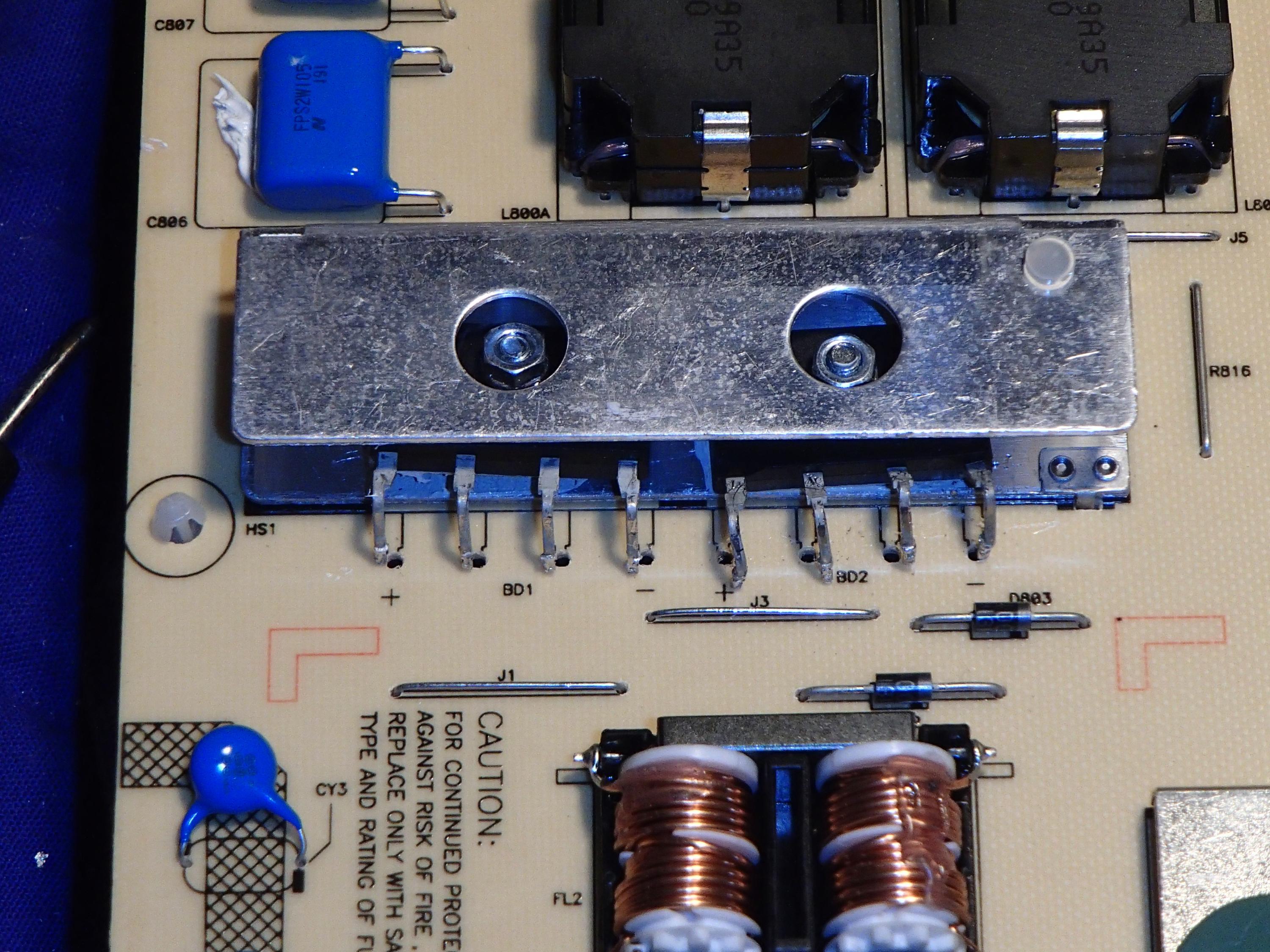

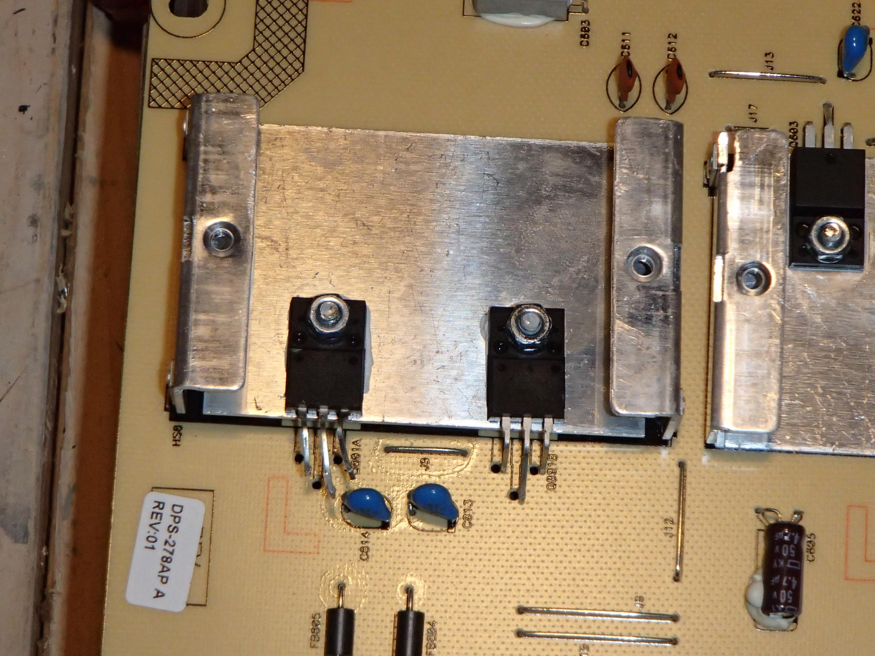

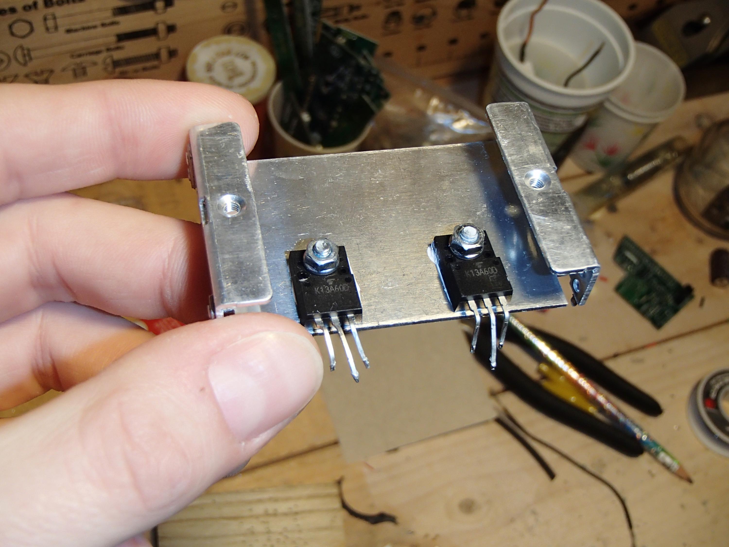

I opened up, first thing i test is continuity F1 on power supply, and its blown, a T5A 250V
I replace with a 5A 250V Ceramic Time Delay Fuse. Still having everything disconnected from this board, I plug in the AC power cord. The fuse blew right away.
