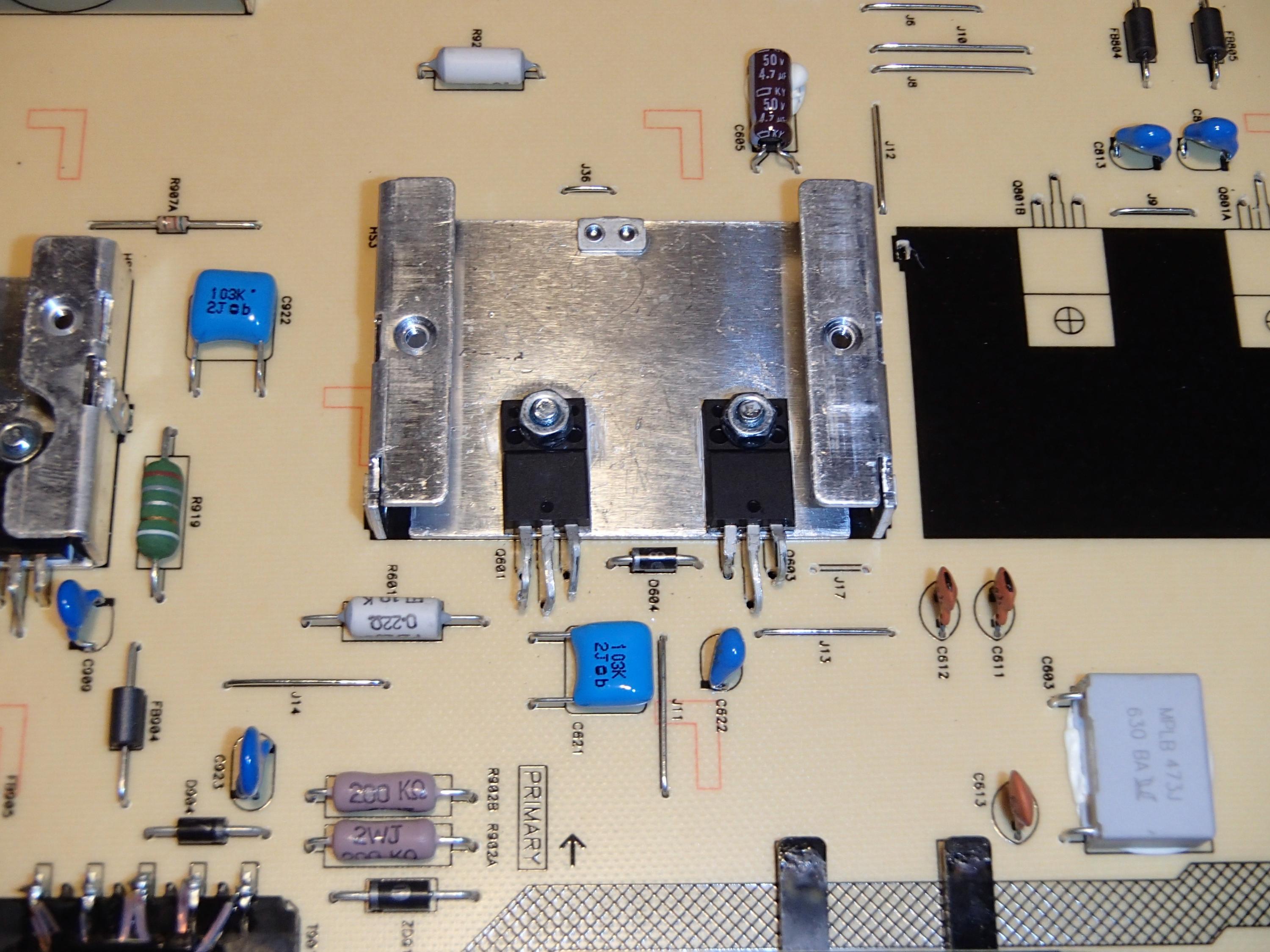

    I opened up, first thing i test is continuity F1 on power supply, and its blown, a T5A 250V
    I replace with a 5A 250V Ceramic Time Delay Fuse. Still having everything disconnected from this board, I plug in the AC power cord. The fuse blew right away.

    I unsoldered the bridge rectifier, and it seems to be testing good, also checked the individual diodes around the bridge and larger capacitors.

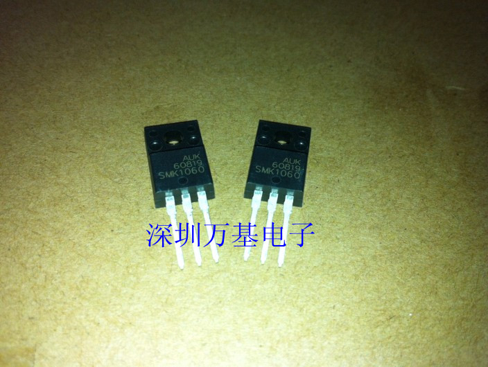

    I unsoldered first set of mosfets, and one seemed to test good, one bad. Ordered two, found exact match at digikey.

      unsoldered next set of Q's and they tested good as well
      mine is 21914 not 60819 like it is in picture at the number above smk1060

        unsoldered final single Q and it tested good also.
        On the chip above K3532 on mine it reads P00R55 not P7NP03 like it is in picture

          Im testing by checking resistance on highest setting 2000k, on what I think are still good Mosfets i'm getting infinite ohms on pins 1 to 2 and 1 to 3.
          Between pins 2 and 3 if red lead is on 2, infinite ohms, if black lead is on 2, i start to get numbers.
          Looking at the board from top to bottom (ones on the heatsinks) the readings from pin 2 to three with black lead on 2 and red lead on 3 are:
          000
          317
          200
          370
          360
          On the bad Mosfet, all pins were continuous.

              Also need replacement part numbers for SMK1060 and K3532 if anyone knows digikey part number, thanks.

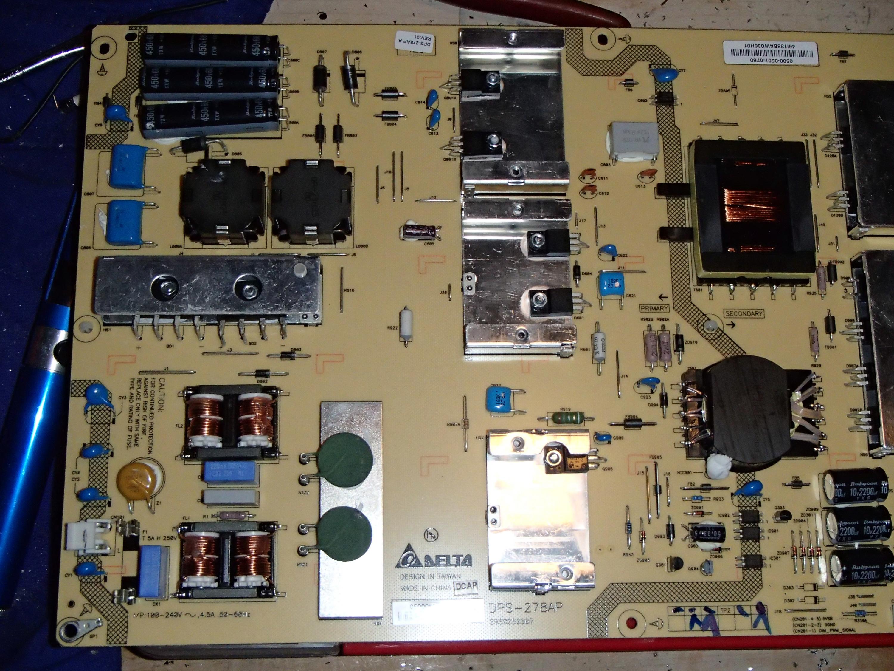

                Without having a schematic in front of me, I'd suggest that you check for a dead short. How to do that quickly would be to measure ohms between the fuse, once it's placed back in, to ground (use that screw hole tab on the bottom left side of the first picture). Do this with the power off. Most likely you will get zero ohms showing a dead short. Id then pull off the bridge rectifier and then try to check for that same zero ohms from fuse to ground. If it's there, then the problem is still on the board between the input power connector and the bridge, which is only about a handfull of components. If the short is not there, then that means it's the bridge OR a few components after it on the primary side of the power supply.
                You can also check ohms across the three large caps (top left of first picture).
                Start there and report back.
                  Re: Vizio XVT553SV no power
                  The fuse is in the primary side, the screww hole tab is for the chassis Ground which is the secondary side ground ref, not primary circuit ground (that is why you see black hatched line to show the chassis ground and the hot side on the board), the circuit ground ref for the primary circuit is the negative leg of the large filter cap (primary circuit ground is NOT TIED to the chassis), not chassis ground. You should check the resistance between the two ~ on the bridge rectifier to see if it show shorted circuit or not, then do the same ohm reading between + and - pins of the bridge rectifier. You can see blue safety caps that are connected between the chassis ground and the Hot and Neutral on the board.

                    I already have the mosfet K13A60D as shorted, no resistance between any combination of pins, plus all the bridge rectifiers, and mosfets are all unsoldered. So testing them should be easy, with meter in 2000k ohms setting, there are two bridge rectifiers, between plus and minus on bridge i get infinite ohms when red lead on + and black on -, but when reversed i get 572 and 584. Between the middle two pins infinite resistance regardless of lead orientation. That makes the bridges good, correct? I'm not sure.

                      Well, i have bridge rectifiers still unsoldered. tested between fuse and the ground of the capacitor next to it underneath the board, and there is infinite resistance. So there shouldn't be any shorted components before the bridge?
                        Souns like it. You can use 75 Watts lamp in place of the fues, if the lamp lights up and stay brightly lit, then you still have shorted circuits. Not sure about the sub for the MOSFET, have to do more searching.

                              Damn cant even find smk1060, just seems one went bad since both give different readings between pins 2 and 3 with black lead on pin two and red on pin 3

                                  Ok, received the K13A60D today, and put it in. There is no longer a short to ground. Have fuse in and its not blowing.
                                  Secondary problem. I only have voltage on the Hot side of the board. The cold side, where all the wires from other boards go in, have no power at all. its like voltage reaches the line in board and stops.
                                  Does anyone know which parts could be causing this, and what I should check?

                                    I've included a picture, all points where there is red, these components all have 5.9v or 6v on the primary side, and 0V on secondary side. All other components on primary side have voltage.
