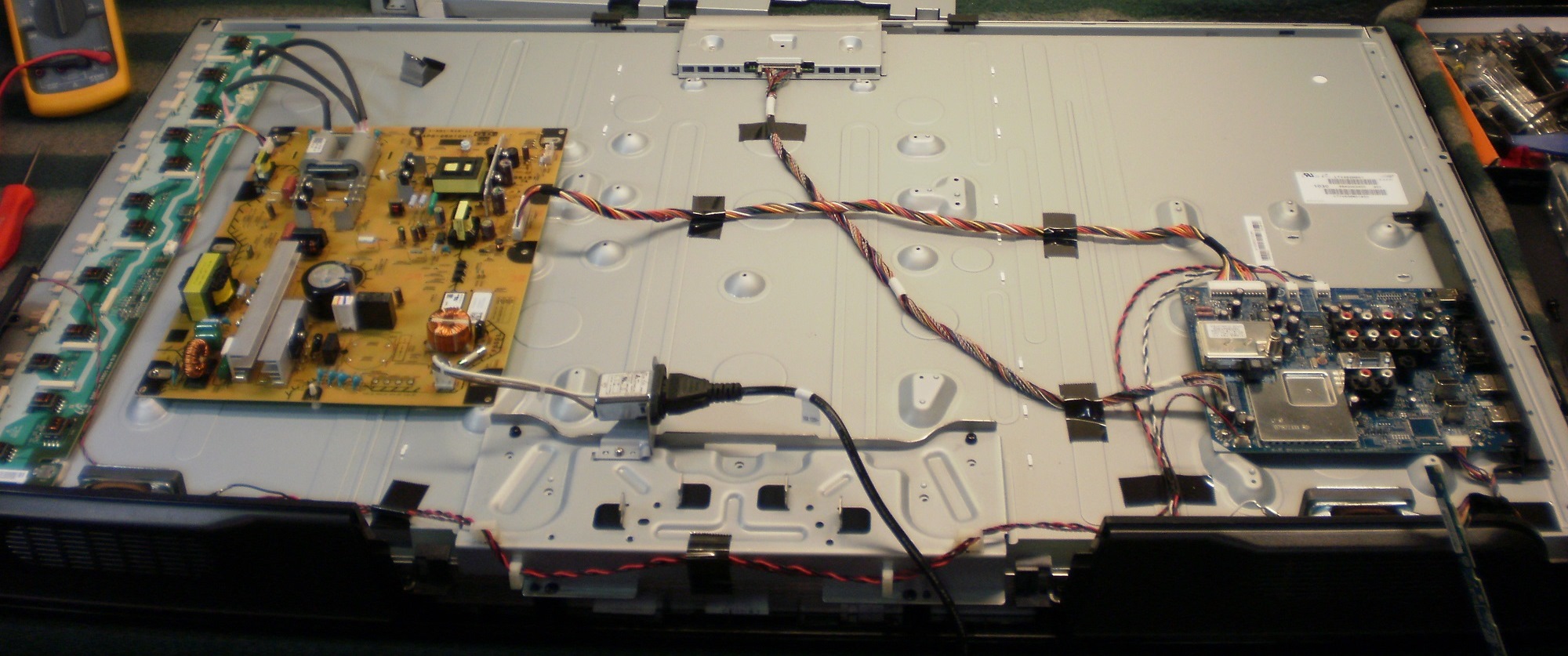

    Sony 46EX400 won't turn on, 2 blinks

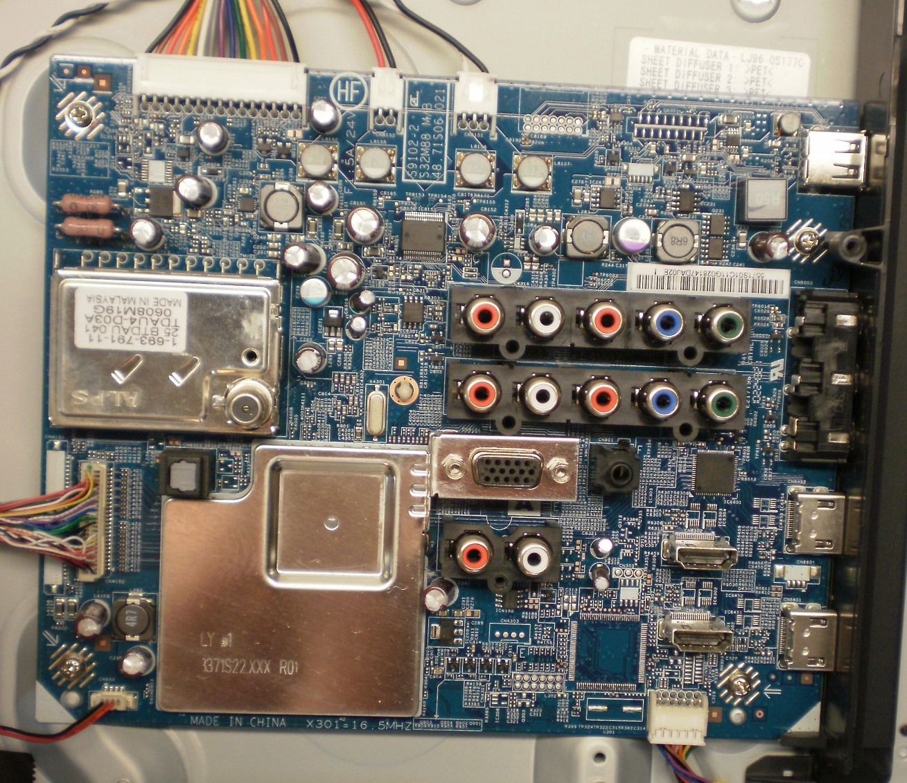

    I have picked up this TV and I couldn't find anything about this issue.
    It turns on for like two seconds with nothing on the screen(no BL), just the red LED and then begins blinking the error 2.

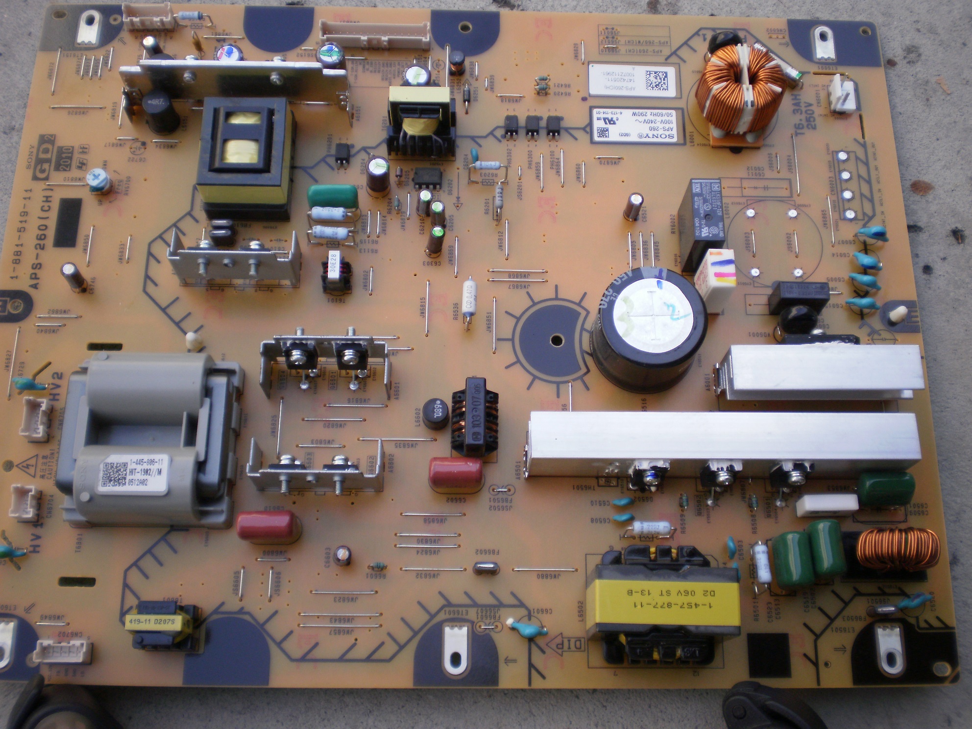

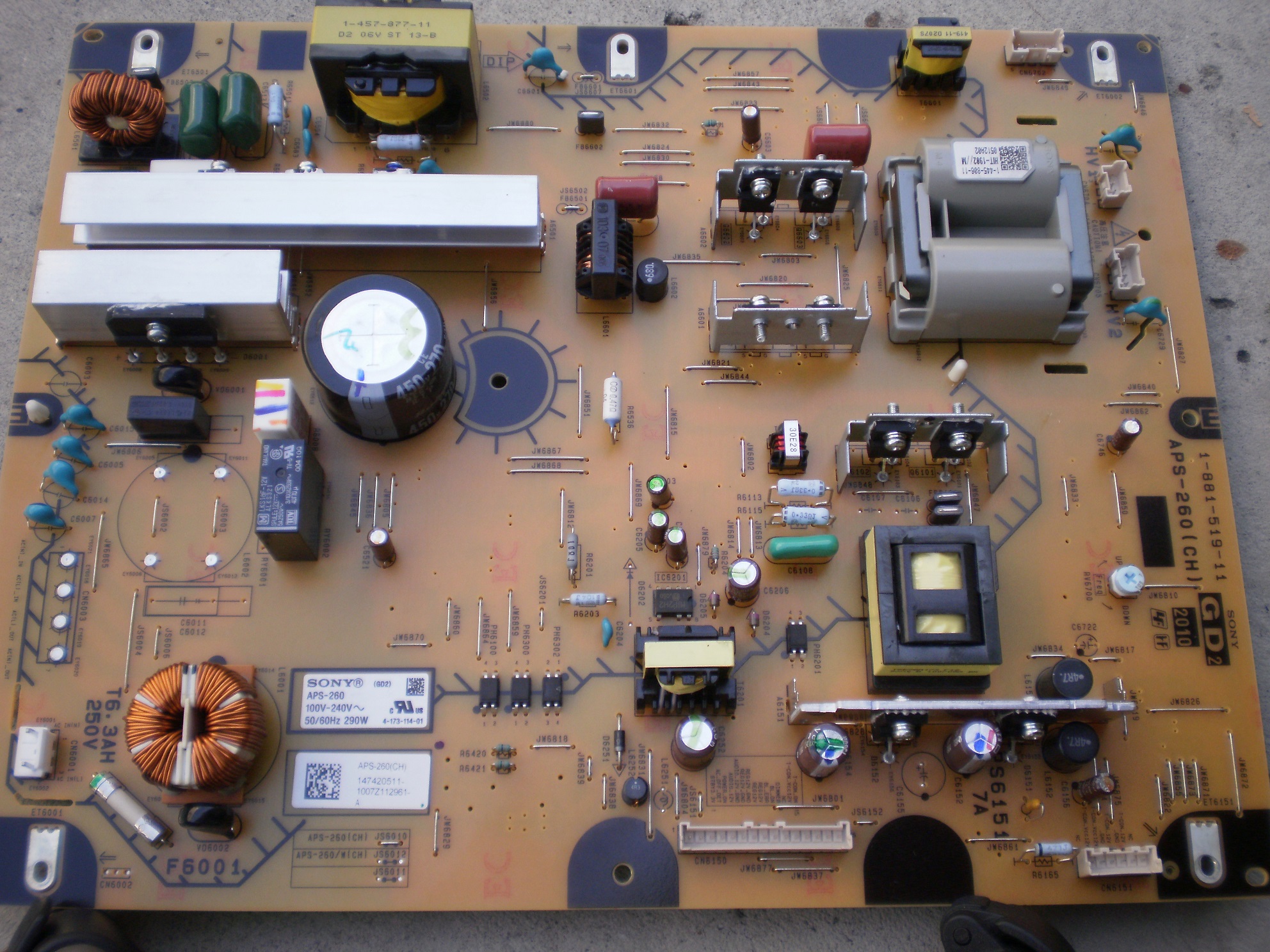

    This error points to the main power supply.
    I have measured all the pins at the PS and to me the only fishy voltage is the BL_ERR and the T-Con is not getting the needed voltage.
    here are the voltages:
    CN6150 connector:
    T-CON_ON= -0.004v
    T-CON_VCC= 0.092V
    DIMMER= 2.96V
    BL_ON= 0.046V
    BL_ERR= 3.32V(TV ON OR OFF)
    REG 12V= 12.71V
    AUDIO 12V= 12.72V
    POWER ON= 3.3V
    AC_OFF_DET= 2.75V
    STBY= 3.32V
    Main caps= 396V

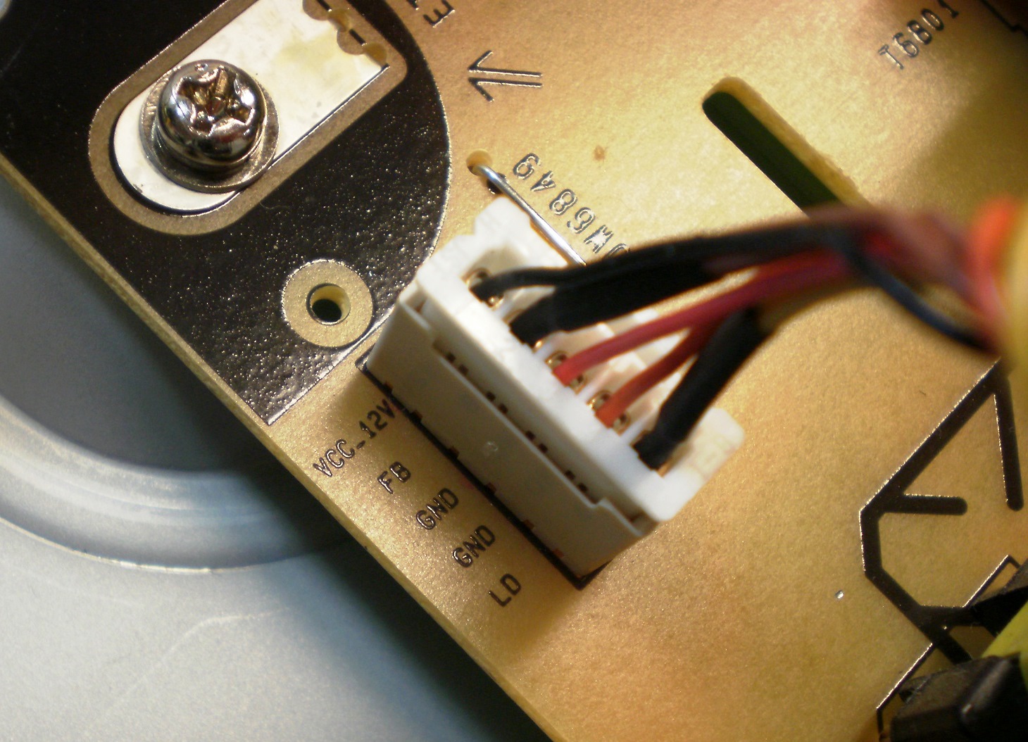

    CN6702 connector:
    12V= 12.67V
    FB= -.0001V
    GND= 0V
    LO= 12.02V
    Capacitors are KMG, KMZ. I don't see any bulging.
    These voltages are there only for those two seconds and then they are gone, except the STBY and the BL_ERR.
    T-con fuse is OK.
    Inverter transformers show 139-142 Ohm.
    Checked for shorted FETs or diodes, couldn't find any.
    No visible damage.
    Here are some general view pictures. If specific areas needed, just ask.
    I would appreciate any input.
    If I fix it, I may keep this one and sell my 46" Samsung.

        Re: Sony 46EX400 won't turn on, 2 blinks
        "CN6150 connector:
        T-CON_ON= -0.004v
        T-CON_VCC= 0.092V
        DIMMER= 2.96V
        BL_ON= 0.046V"

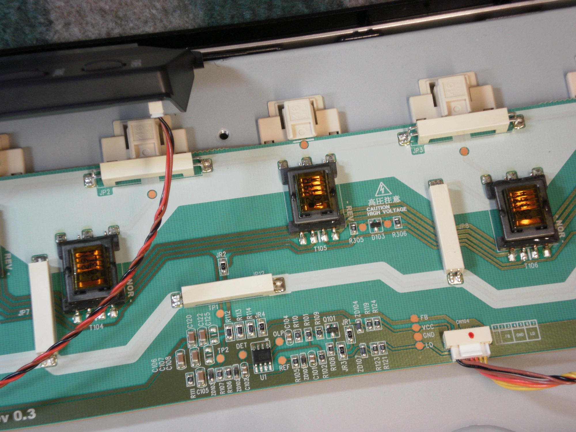

        The reason that there is no T-CON VCC is because the T-CON on signal is stuck LO, the signal is used to turn on the switched transistor to supply 12v to the T-CON (see page 21 of the service manual).
        The BL_ON is also stuck LO.
        The BL_ERR (FB) is LO when it is normal, this TV uses Balancer board which has a bunch of the current sensing transformer on each lamp, the when the lamp draws too much current, it will send out the signal to turn off the lamp.
        http://s807.photobucket.com/albums/y...psa9c38f7d.jpg
        See https://www.youtube.com/watch?v=oE6K4xBVweA
        Notes: Samsung/Sony basically uses the same setup for the Balancer board.

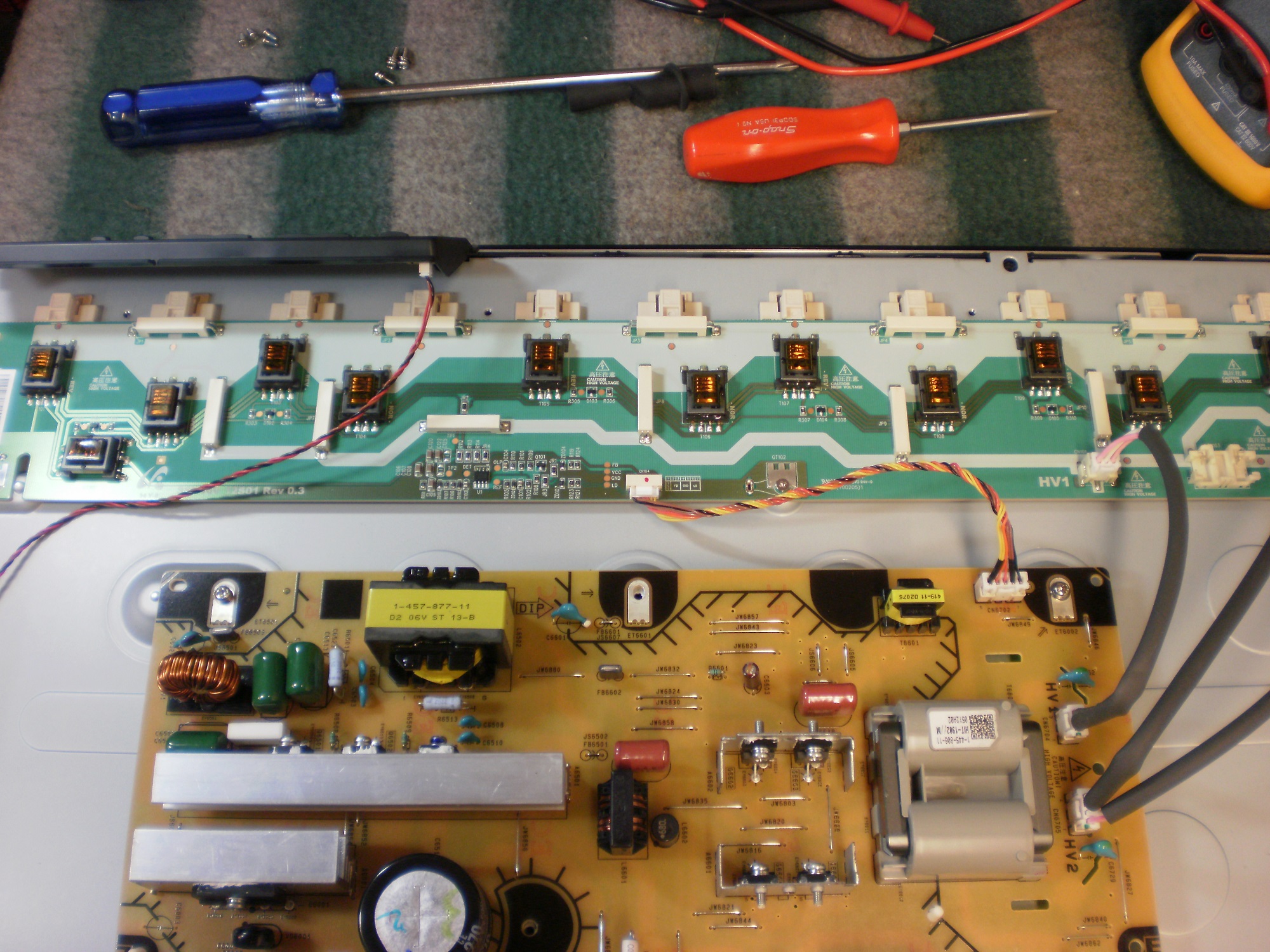

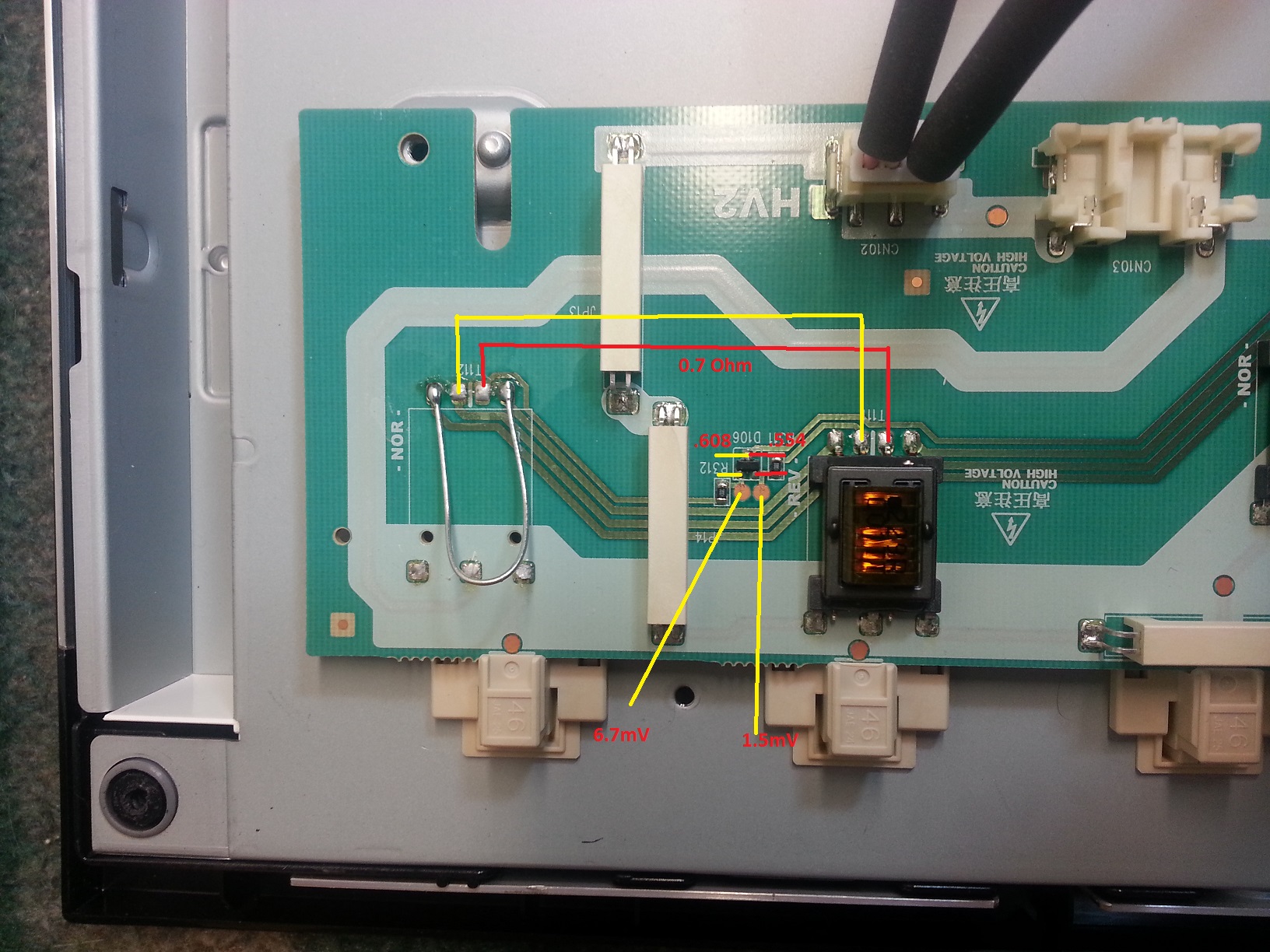

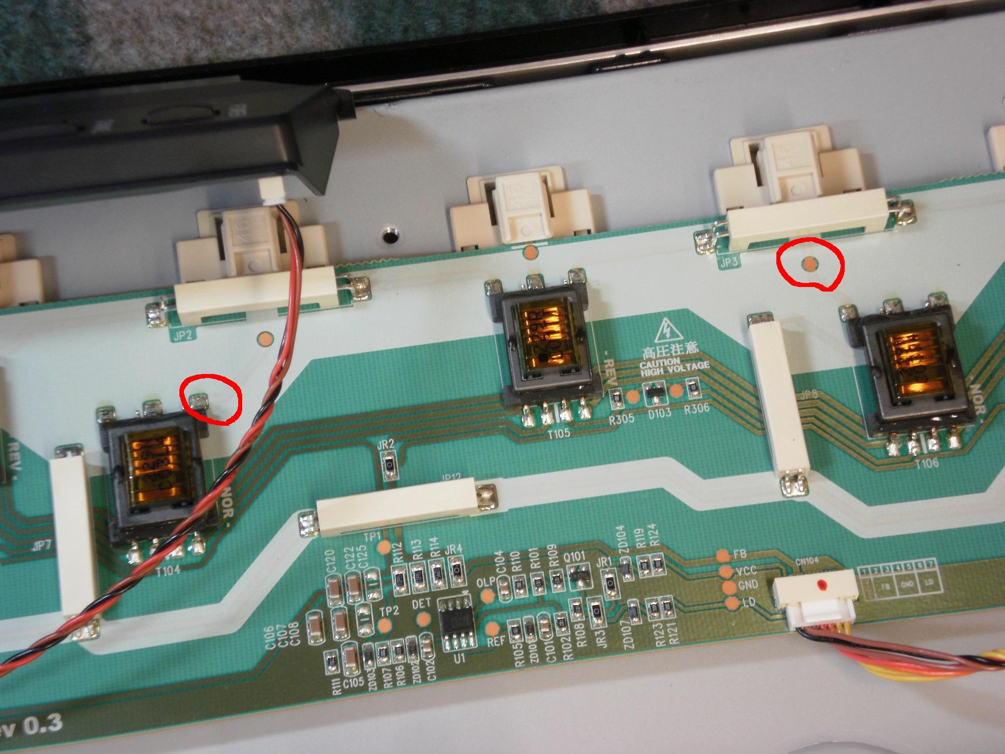

            I havedone some measurements, but I haven't found anything that out of order then in that video.
            Number 1 from the top of the TV, had the highest voltage. Most of them were under 2mV AC, one it was just a bit over 2mV and the first one from the top of the TV went up to 6.7mV.
            Removed the transformer, checked out OK and then I have soldered a jumper as in that video.
            The TV didn't turned on. It was in the same situation with the two blinks.
            I have noticed some differences between the last transformer/diode measurement and the rest of the transformer and diode measurements.
            Firstly the diode next to the first transformer shows .608 on the diode check scale, on the side closest to the "bad" transformer(w/transformer removed) the other side of the diode shows .554.
            Measurements between these points (yellow line and red line in the picture) on the yellow line has different value then between the same points on other transformers.Forgot to wriyte it down,but it was something around 330 Ohm or Kohm.
            I will update with more info as I'll check more.
            • tibimakai
              • Jan 2012
              • 3680
              It doesn't seem that this method works.
              The voltage measured it's much higher with the jumper, then with the transformer.
              Should I take the panel apart and check out the tubes themselves?

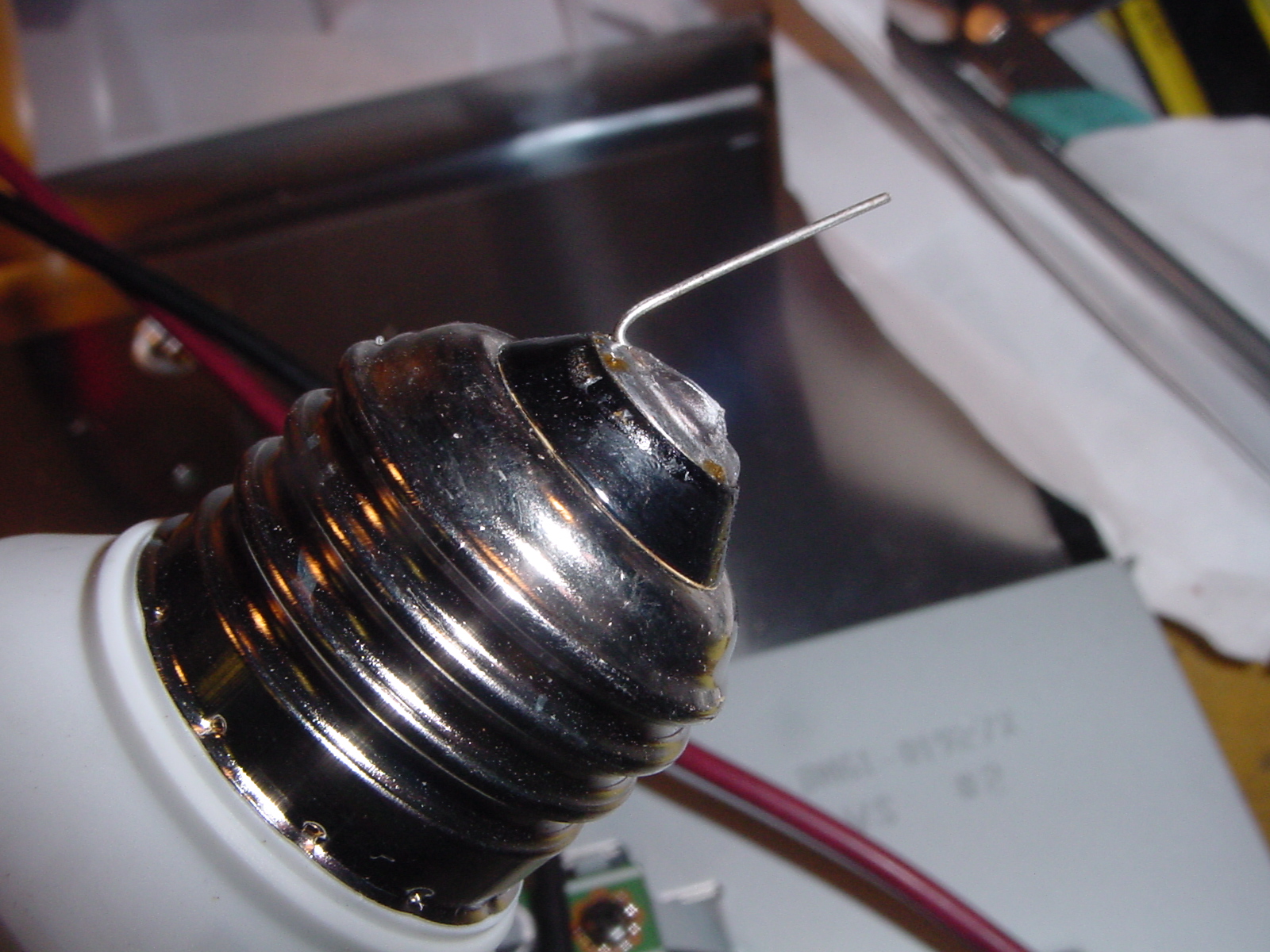

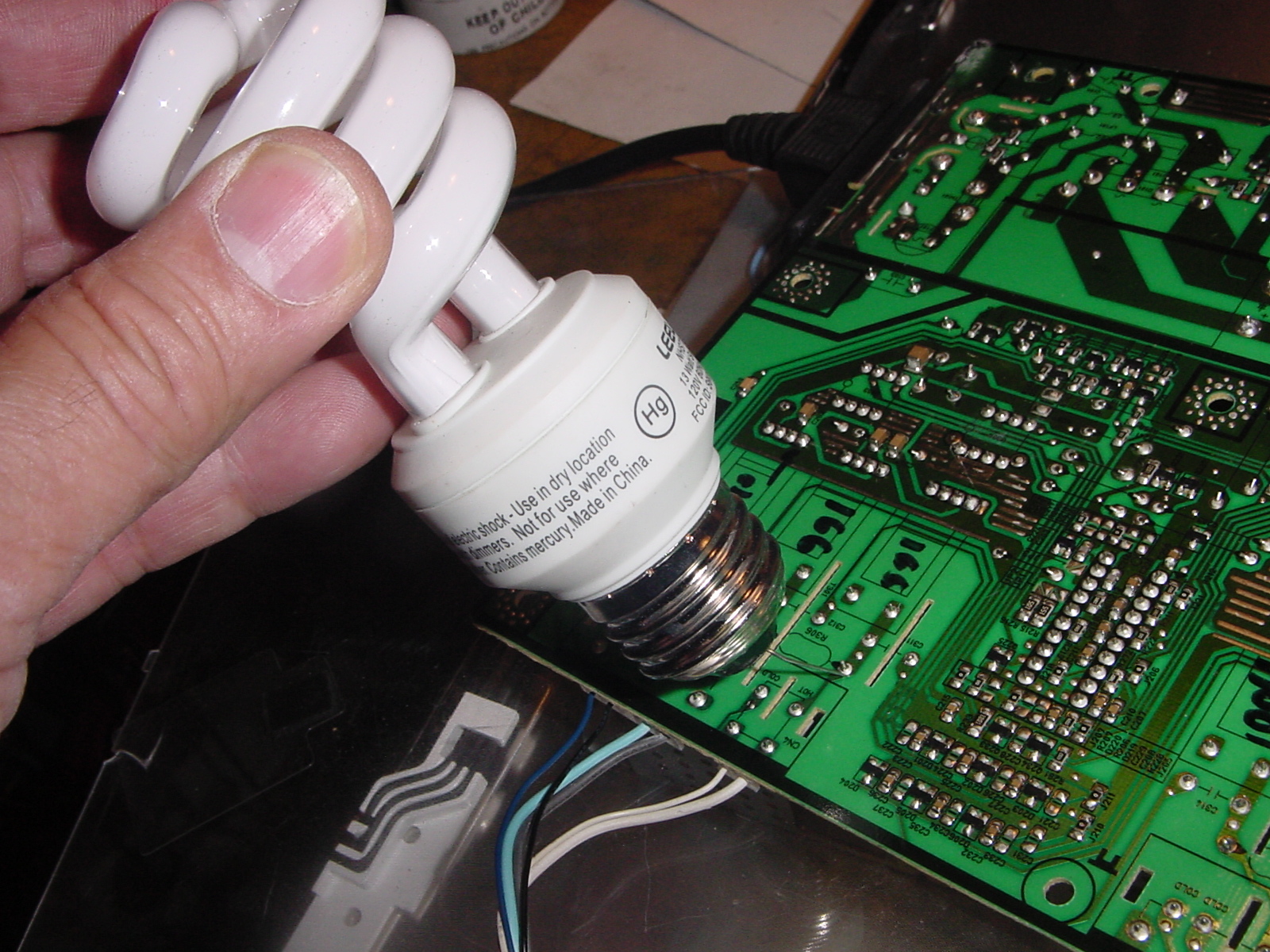

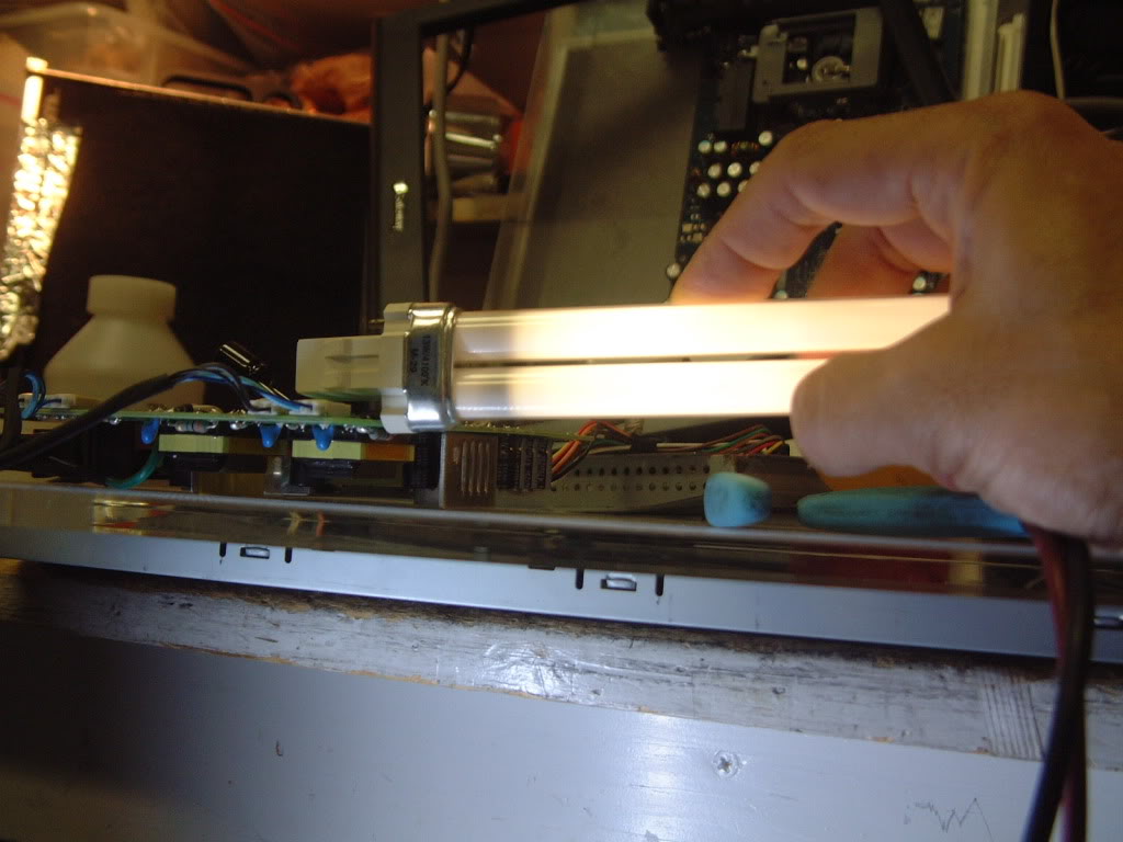

                            We can try to see if the high voltage transformer even try to fire up when the TV is first powered up. You can solder a piece of wire to the bottom of the CFL, then just touch that pin the one of the pad in red circle, you should see the lamp flash if the high voltage does come on for second when you turn on the TV. You can try that on the monitor.
                            I think the High voltage transformer is not being driven by the MOSFETS.
                            • tibimakai
                              • Jan 2012
                              • 3680
                              I have extra ccfl tubes, should I used one of them instead, or it's better the bulb?
                                You can use that too, just need to make contact with just one end of the test lamp, just have o hold the lamp body with your hand.
                                    Nothing happens Bud.
