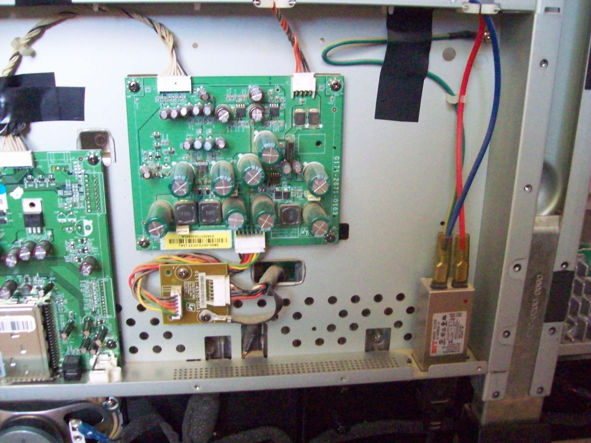

    Sorry I think I posted my question in the wrong spot the other day. This is what I had posted: Hi Tom. Your guide on the troubleshooting of plasma tv's is great. I've learned alot so far but have a great deal more to learn before I'm really up to troubleshooting. At this point I'm probably doing something wrong with the guide. I'm new to this and don't have a great deal of experience troubleshooting boards. I'm more into mechanical. I have a vizio plasma JV50P HDTD10A serial PHLANAH1801xxx The original problem from reading was the sound would go on and then off with a loud noise. Then off and on with the tv. Then would work normal. Did this a few weeks. Now tv would not even turn on. Yellow vizio label would not turn white, no click, no sound. Took off back of tv, read many items on internet, wish I would have found badcaps first. I did see caps on power board were leaking bad. Replaced that board. Was able to then get tv to turn on, yellow vizio turn white and you can hear a click. Still no sound or picture. From what I had read elsewhere, I replaced the main board. I still have no sound or picture. You can hear a slight crackle from speaker when turned on but that's it. I found this website and tried your troubleshooting guide but didn't seem to help pinpoint anything else wrong. I know I must be doing something wrong. I have noticed that I believe there use to be a small red light that could be seen when using the remote, that is no longer doing that. Batteries have been changed and does turn tv on and off, but I have been using side controls of tv during testing. Any other possible tests or retests that I could try. I did check the few fuses that I could find (regular fuses). As I say, I'm not really into board troubleshooting but learning from the posts on badcaps. Thanks, Ken

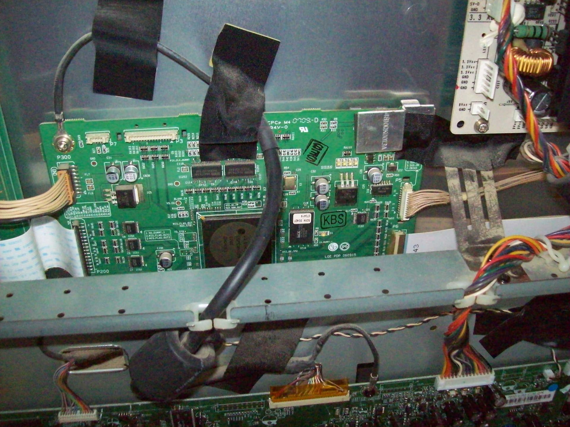

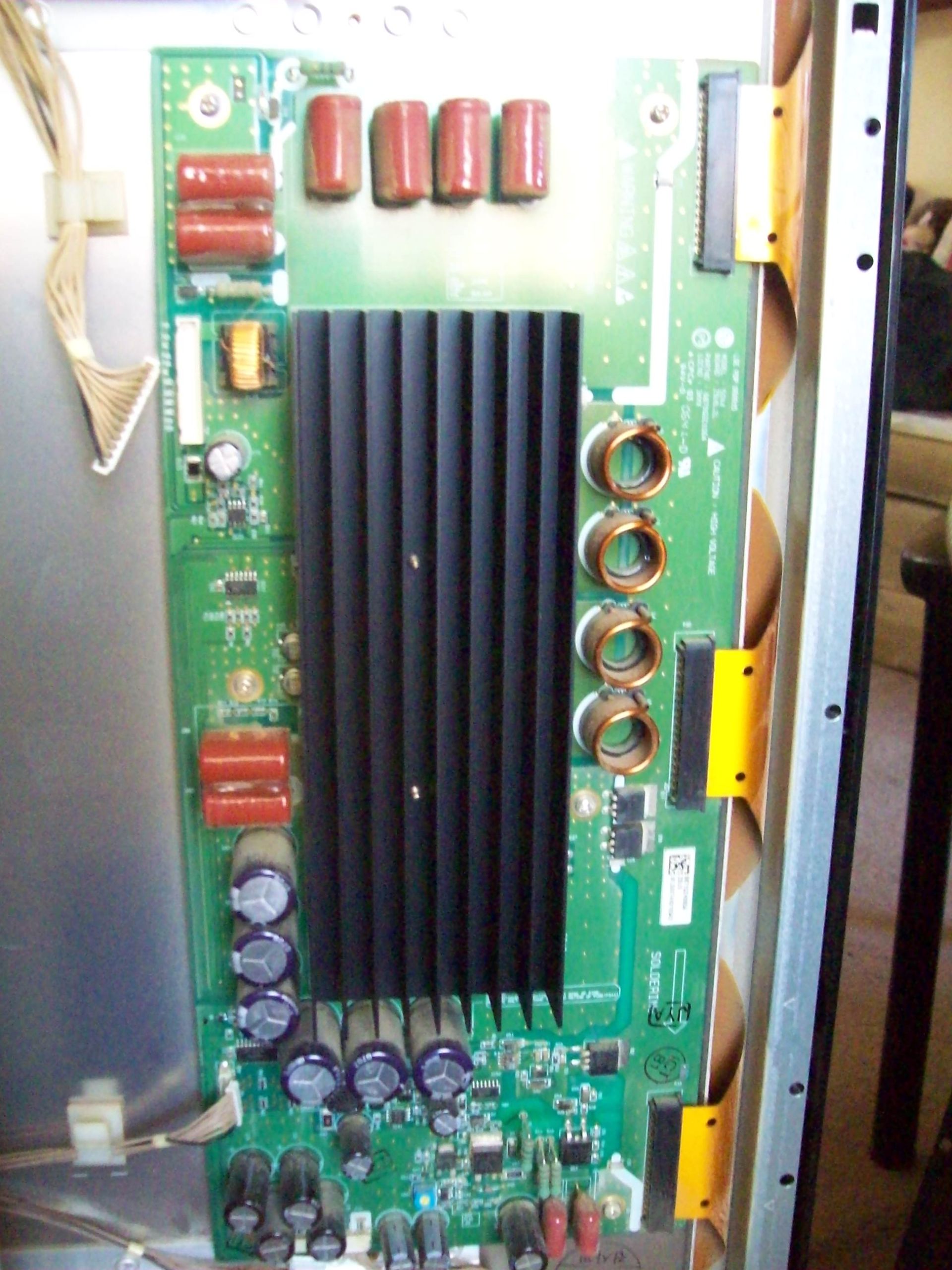

    Can you take pictures of the boards in your TV?

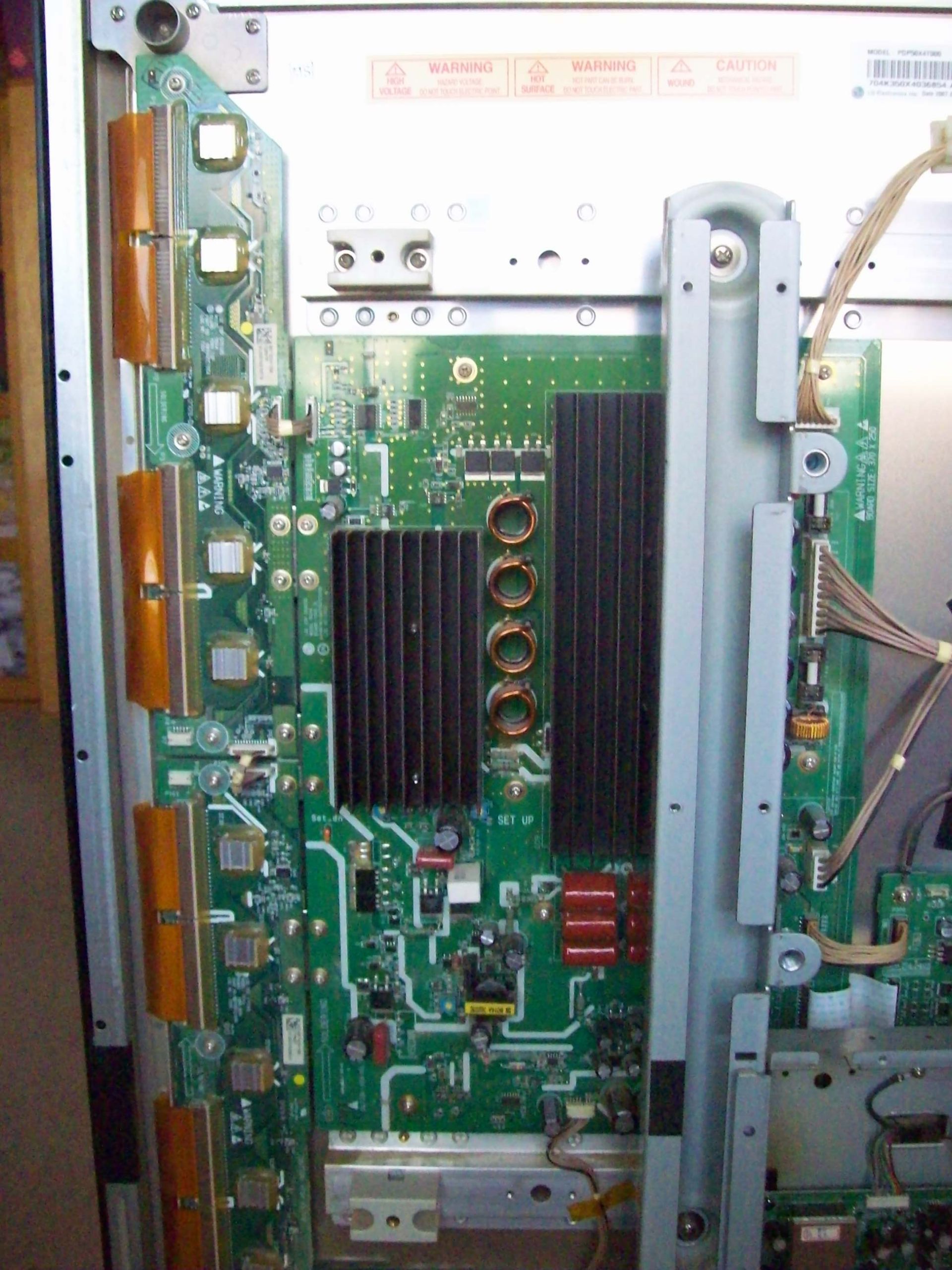

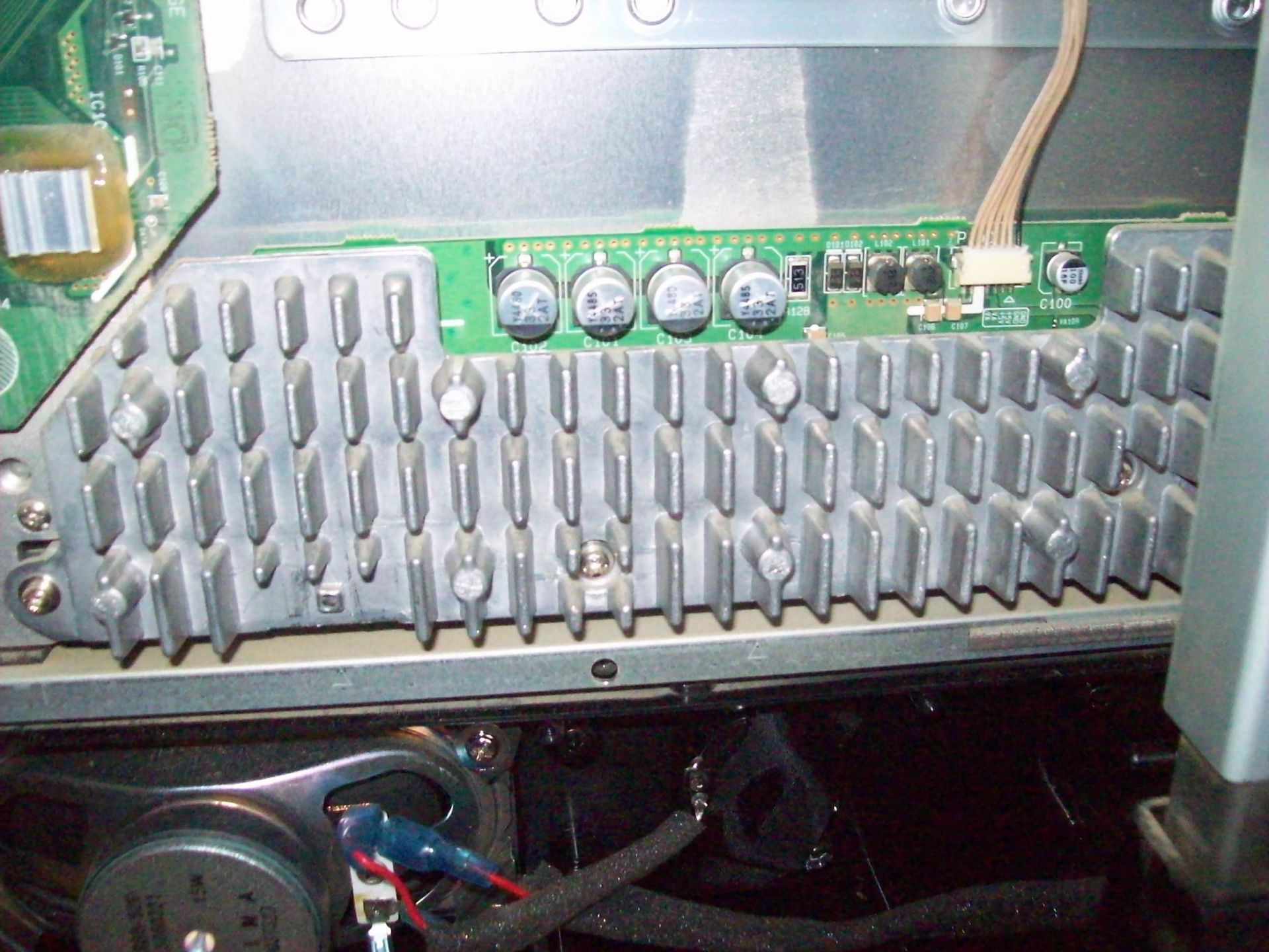

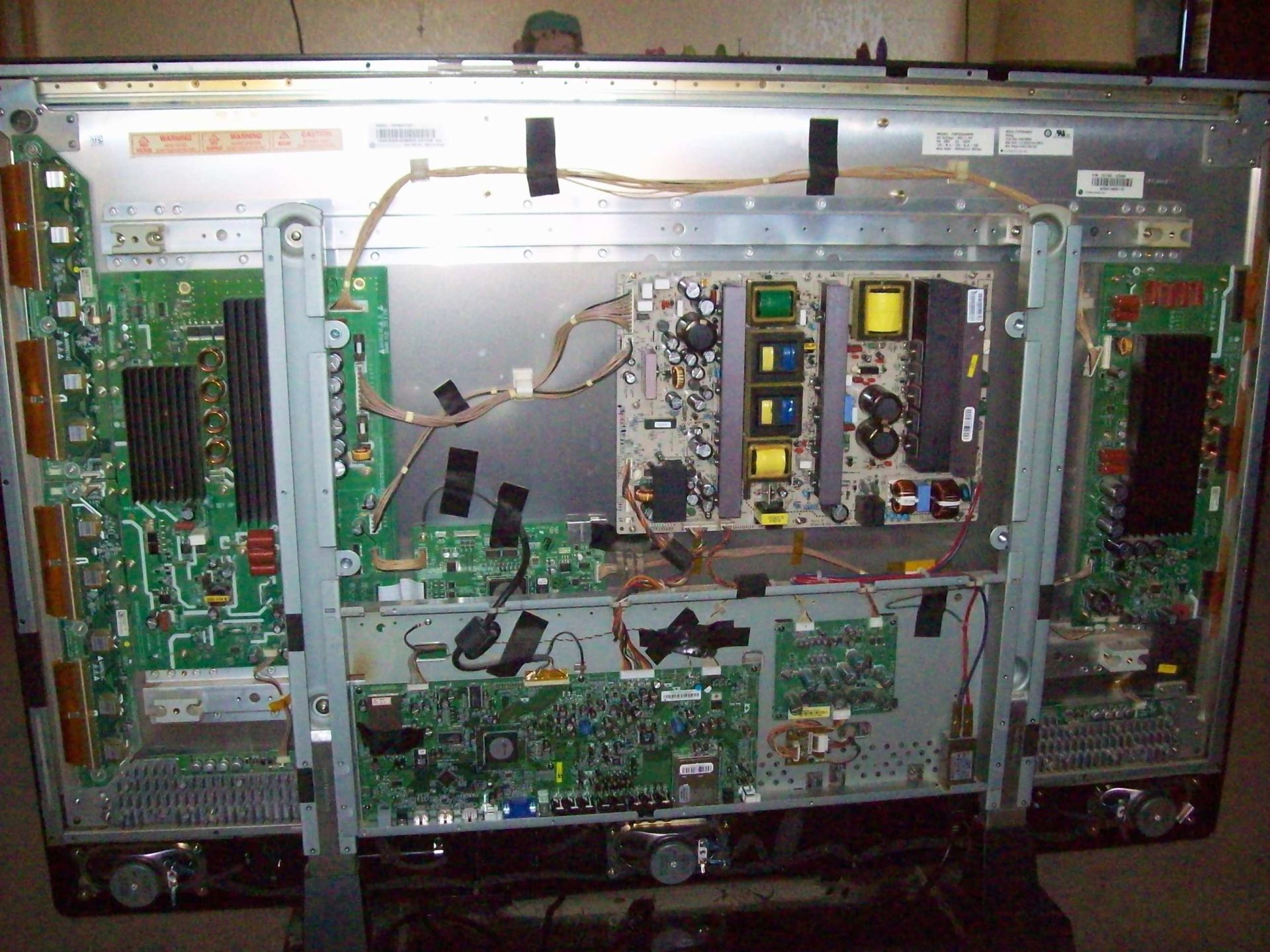

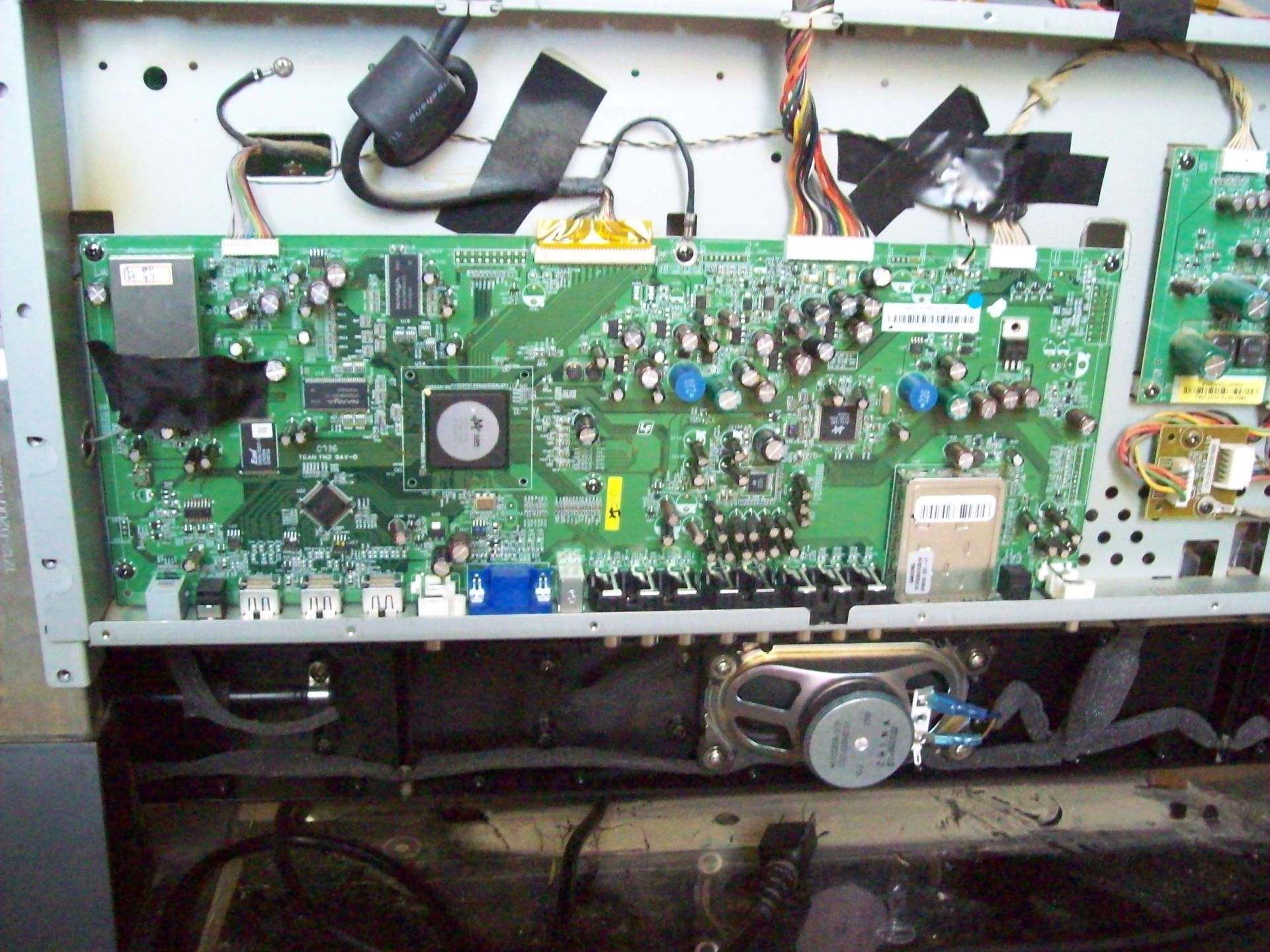

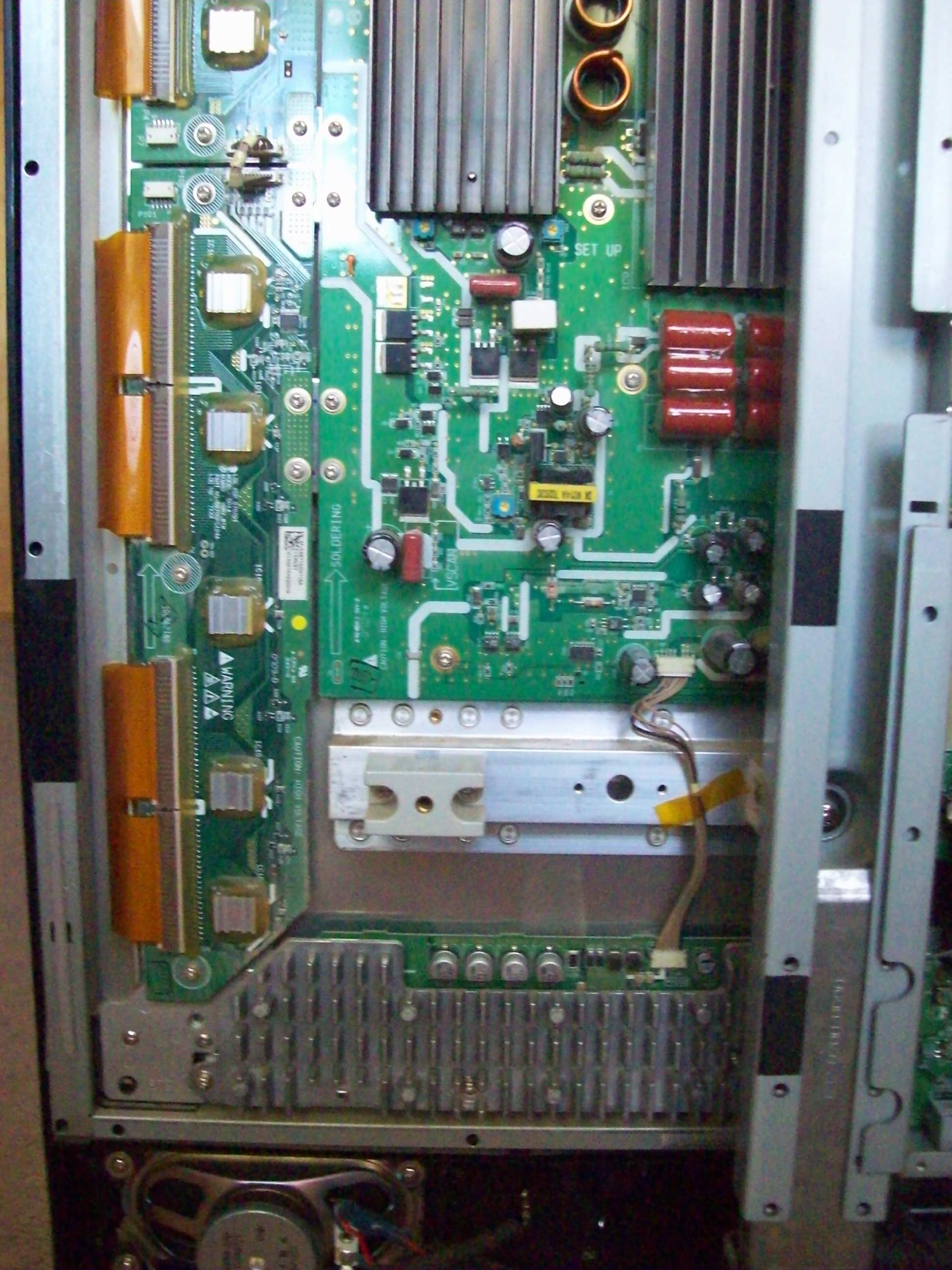

      Hi Tom,
      Sorry about the no paragraphs. Did a copy and paste and it got messed up. I'm attaching photos of the boards so hope that it helps.

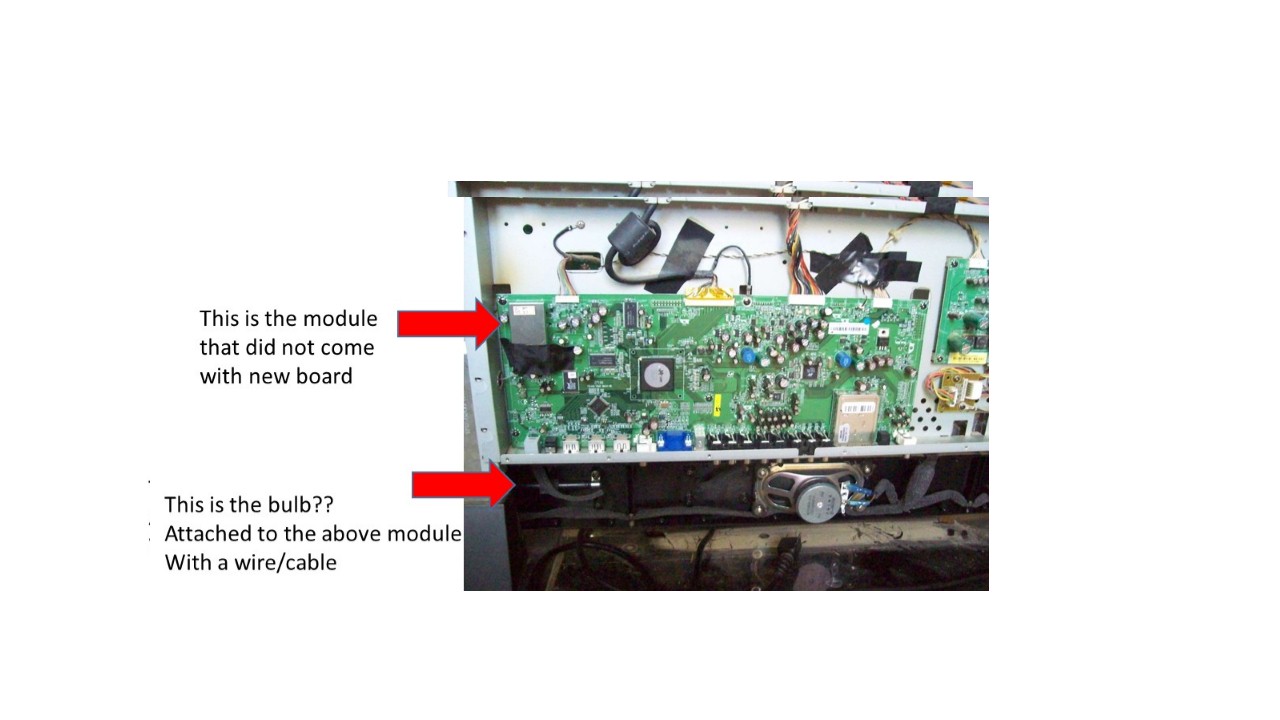

      With the main board there was one part that wasn't included on the recertified one, it plugged in to the top left of the board and had a wire running down to a bulb type of item below. (its not really named anywhere that I can find).
      As for the digital multimeter, I have one but it's not the greatest. If needed I'll have to buy one. Let me know. Thanks, Ken
        Re: Vizio Plasma JV50Phdtv10a no picture/no sound
        Tom, the part that I was talking about that did not come with the recertified control board is marked on this picture. I could not find a name for it on any drawings I've been able to find. Thanks, Ken

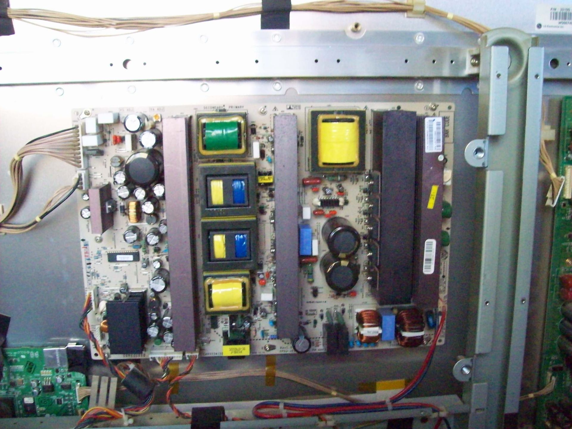

          This is your PSU:
          https://www.badcaps.net/forum/attach...2&d=1361158532
          There is a pin "AC-DET" on PSU to main board connectors, which are labelled. Can you see this pin?

            Picture didn't attach first time, sorry.
              Hi Tom. I didn't see that you posted this morning in between my picture. Sorry.
              On the board your talking about I see the connector (I believe) and it has AC-D on one of the pins and DET on another.
              attached is the connector.
              Let me know what else you need.
              Thanks, Ken
                AC-D is the one. Test the voltage here, red probe on the pin (stick it where the wire goes) and black probe on chassis of the TV. If all is well, I expect to see more than 4V.

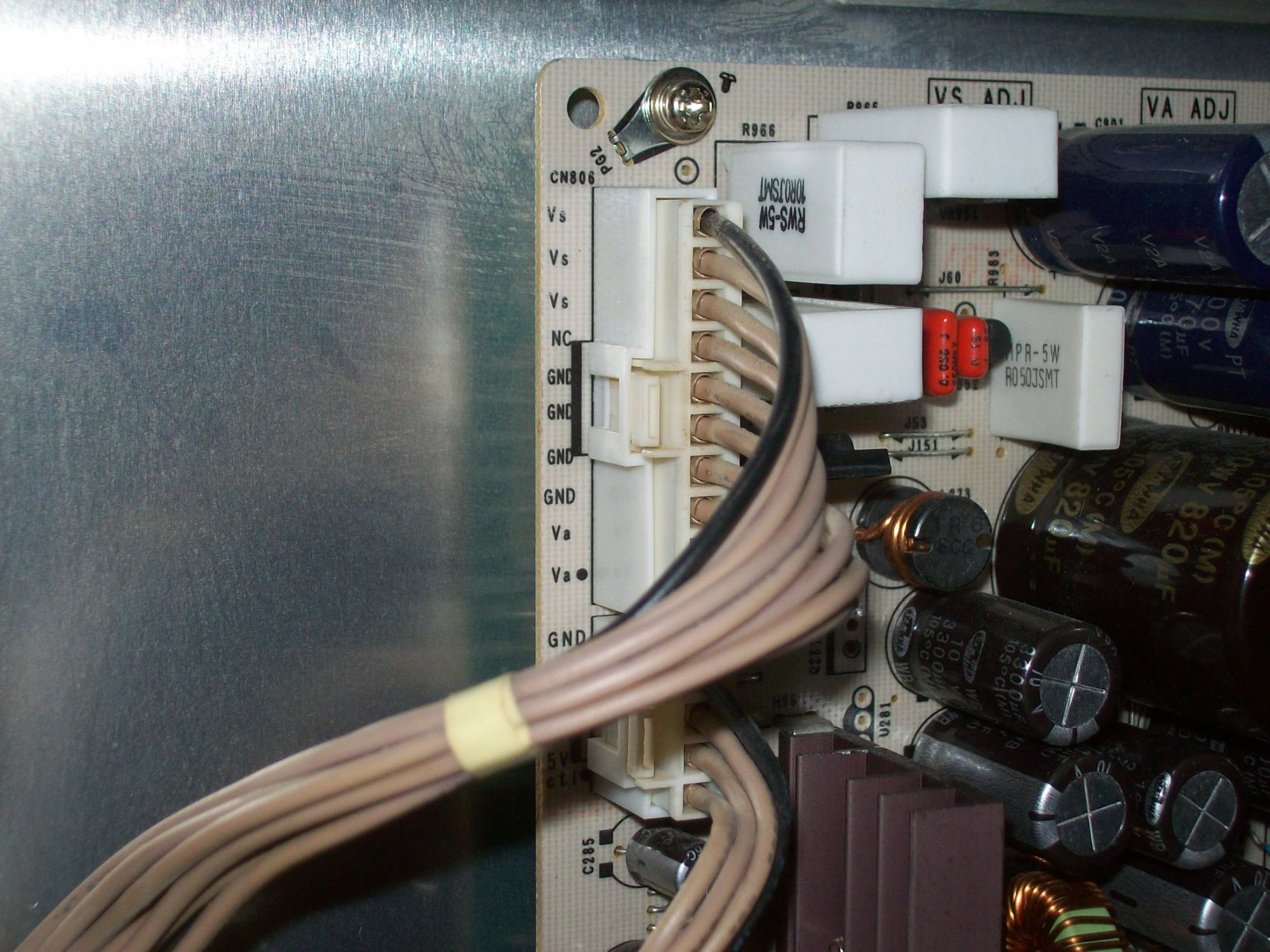

                            Do you get any VS/VA voltage with VSON at that voltage?
                              Hi Tom,
                              I'm not sure where you want the voltage measured at, but I did measure it on the power board connector just above where the other voltages were taken. I attached a picture of the connector/location measurements taken.
                              With the tv on, and meter set on 500dcv the readings are:
                              Vs is 189dcv and steady (this is on all three terminals)
                              Va is 60dcv and steady (on both terminals)
                              Hope that helps. Thanks.
