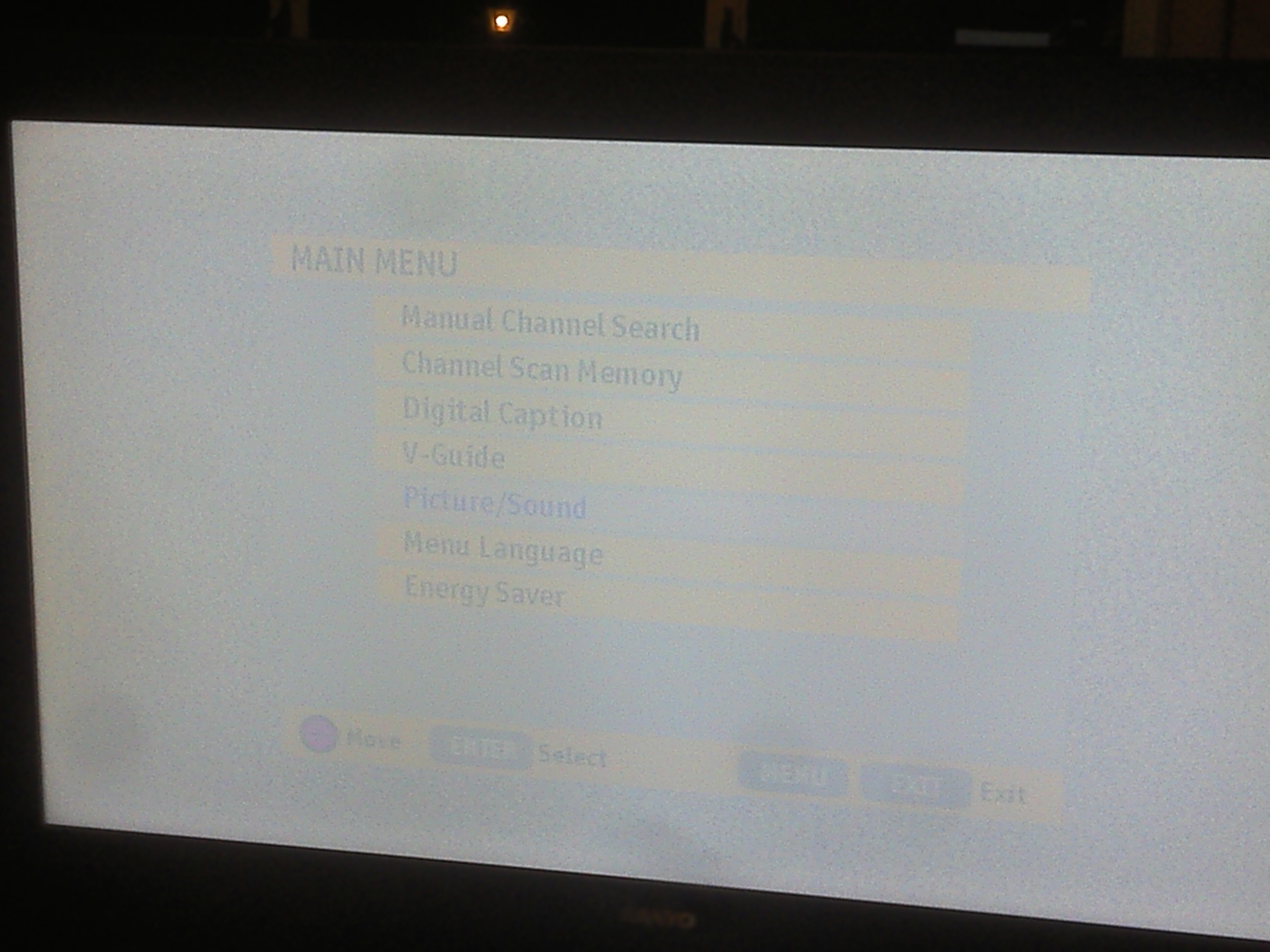

    Im working on a sanyo dp42848 which you can make out whats on the screen but theres no color / low contrast. As far as i know this is a tcon error, so im probably gonna pick one up from a badcap member who's tv was incapacitated during a backlight repair. (Plan to sell the set right after its working, cause looks like these sanyos fail all the time from backlight issues)
    I wanted to check Budm's guide to tcon faults first before buying it, but i cant find it from searching here, maybe hes one of those people who call them LCD controllers
    Checked all the PSU voltages and theyre great, doesnt shut off (so no backlight issues), and checked for 12v at test point on TCON and i get it. Problem affects all inputs and menus.
    I have a feeling when tcons do this type of fault, its due to them no longer producing sufficient voltage to fully turn on the pixels, but i suppose the problem could be related to something in the panel / but it seems logically that a disconected connection would leave some areas not functioning at all (sort of similar to sonys with bad tab bonding only having half some of the screen too bright / slow to change), and not produce a even affect over the whole screen.

      This type of failure isnt listed, how often do you run into the almost no contrast issue in your repairs? and is it usually the tcon?
      A picture is attached below of the set while on. Obviously have tried a factory reset, and adjusting all picture settings.

        Re: Sanyo DP42848 with almost completly white picture
        That does look like the lost or low voltage for turning off the LCD, that voltage is geneared by the IC on the T-CON board..
          I tested the 1 large regulator on the tcon, and it had a little over 1 volt on the tab , and no voltage on the lower / outer 2 pins. Which seemed odd, but i dont have my diode testing multimeter at home so didnt test it further. Not sure if that is used to drive the chips vcc on the tcon, or what.
          Are all the other voltages created within the main chip on a tcon?
            You may want to read this and see if your T-CON has this IC AS15G (EC5575).
              Mine has AS15-F, clearly no relation
              Looks like ill go ahead and get that tcon for $30, even if that chip was 10 cents, im not waisting my time / or limited patience soldering a 48 pin IC with a 3mm bevel iron
                You got it. It looks like bad news if a lot of T-con boards use this AS-15 IC (EC5575).
                  I got the new t-con, popped it in, and has worked flawlessly for the last 6 hours. Time to sell it. 42 inchers move like hotcakes on craigslist.
