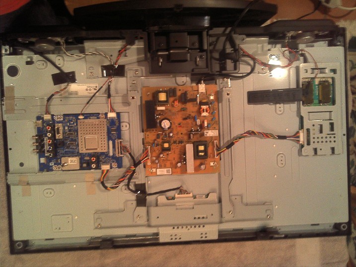

    I bought a broken 32" on craigslist cause i was bored ... not a whole lot of money left in repairing 32"ers, but need something to distract me from spending more money on guns.

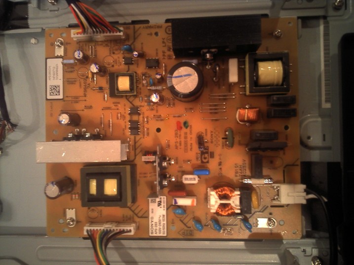

    Its a ~ 1 year old sony (probably a good sign that sony's get out of debt plan to cheapen all their sets is starting to pay off , doesnt power on, no light on front (should the LED be always on / red on new models when off?). I checked the power supply board and it outputs 3.3v on standby, 12.5 volts on 12v when jumped on, and 25.4 volts on the 24v for the inverter. When the mainboard is connected the voltages go to their on state automaticaly after plugging it in (12v and 24v become present), and i hear a near silent clicking from the processor area of the main board. I also tried reseting the set by holding the power button and pressing up on the remote, but no change. (is that just a settings reset on sonys, or will it clear error states?)
    Im not sure where to test next to see if its getting the signal to turn on from the IR board, or the button board. The button board does get 3.3v on 1 wire out of 3, but im not sure if its a simple connection to 1 of the other wires that turns the set on, or a more complex signal / pattern. Im not sure if these sets can get a failure signal from the inverter / tcon and choose not to turn on , but youd think in both those states the LED would change color, and using the factory reset would make them turn on again for 2-3 seconds before erroring again.
    Ill post some pictures in a few minutes, but here are some part numbers for reference
    power supply board: aps-283

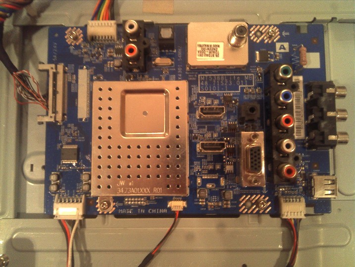

    main board: mt5388 lite (there are a lot of other numbers various people give, not sure which are correct), theres 2 versions on ebay for various 32/40/46 inch versions that all seem to be built on the same board. I can get one of the other versions for 10 dollars so tempted to try that, but might be a panel vendor change.

    pics posted below
    I did the 3volt to bl on test and the backlight lights up, and appears to be consistent in all areas, and i dont think that would prevent the set from showing any sign of life. Manual indicates standby is a yellow lite, I assume thats what it should be in when plugged in, but obviously that doesnt light up.
    Im leaning towards just replacing the main board with the identical model main board, because the other variant looks like it has the tcon connector set back, and the board i have has pin pads for that connector place, but uses many less pins... so im guessings its for another brand panel.
    The clicking noise from the mainboard might be comming from the 4 black smt parts at the lower left labled 6R8, is there any way to test those? they seem very hard to get good readings on, but appear to have around 1 volt on each side, so id be guessing they control the vcc for the main processor.

          elektrotanya had a service manual, but it didnt figure much was serviceable. acording to it the standby light will flash for error states, and there is a test screen , that you press info + 5 + vol- + power to get to, but there is no info button on remote...
          So further signs that the mainboard is so destroyed, it wont even display error codes or any other signs of life. I guess ill see if i can offer someone down to 40 for the mainboard on ebay.

              AC OffDet can cause your problem on a Sony. This signal lets the microprocessor know that it is getting a good power line voltage. I would have to check my records at work to see what voltage it should be.

                    I put in a new main board ($40), and everything worked great. I did have to change it from Store Display mode to home mode, so I guess we know where some of the used boards on ebay are comming from
