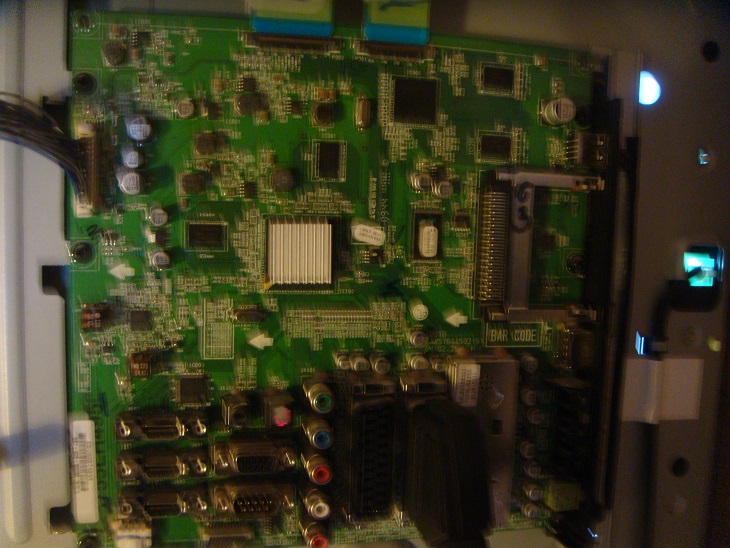

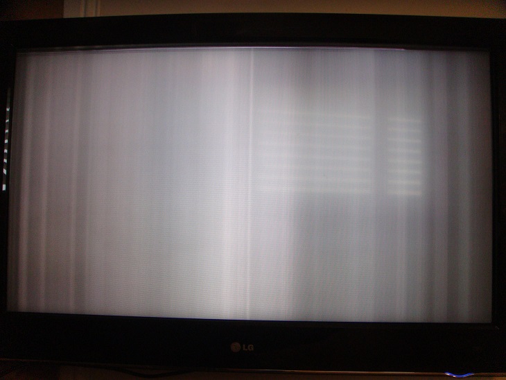

    from switch on black screen with some twitchy lines at very top
    after a few mins some white showing in patches with vertical lines
    then 5 to 10 mins later white screen with lines, top centimetre of screen showing image
    Almost hour later full image that freezes followed later by nice minty picture!!
    advice help welcome

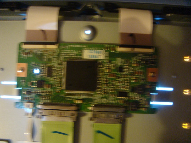

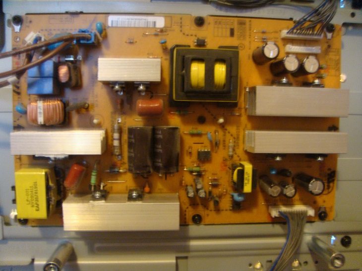

    voltages all good at psu but noticed at t-con fuse getting 11.80 changed smoothing cap on 12v rail still the same!
    thanks Ronnie

        Re: Wanted LG 37LH5000-ZB screen problem!
        I would see if a t-con is cheap. If it is I would swap it. But I suspect the panel.
        • netdent
          • May 2011
          • 208
          that's my worry too, t-con is £30 main board near £40, dilema!! I have a hunch it is not the screen but am often wrong lol
          Ronnie

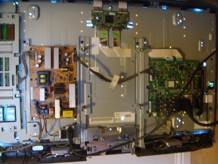

                  Hi Mike,
                  Yes I stripped the screen and applied heat and behold picture within mins!
                  Only heat worked tho not touching or pushing made it work, so yes another bad panel, not good! at least I never spent money on boards
                  thanks to you and Tom for input
                  cheers Ronnie
