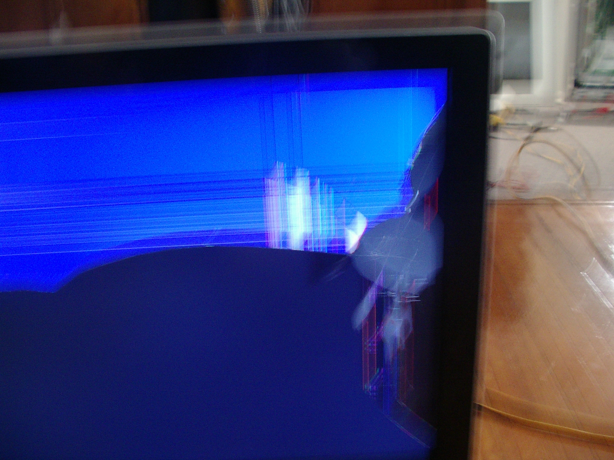

this will power on but as you see from the pic the screen is distorted
vizio vw26l hdtv20f bad panel or bad caps ??
Re: vizio vw26l hdtv20f bad panel or bad caps ??
The screen is quite obviously cracked. Please tell me you did not spend a single penny on this.Please do not PM me with questions! Questions via PM will not be answered. Post on the forums instead!
For service manual, schematic, boardview (board view), datasheet, cad - use our search. -
Yeah, it's going to give problems in a few months time -- perhaps already. Perhaps someone smashed it in anger after it wouldn't turn on properly.Please do not PM me with questions! Questions via PM will not be answered. Post on the forums instead!
For service manual, schematic, boardview (board view), datasheet, cad - use our search.Comment

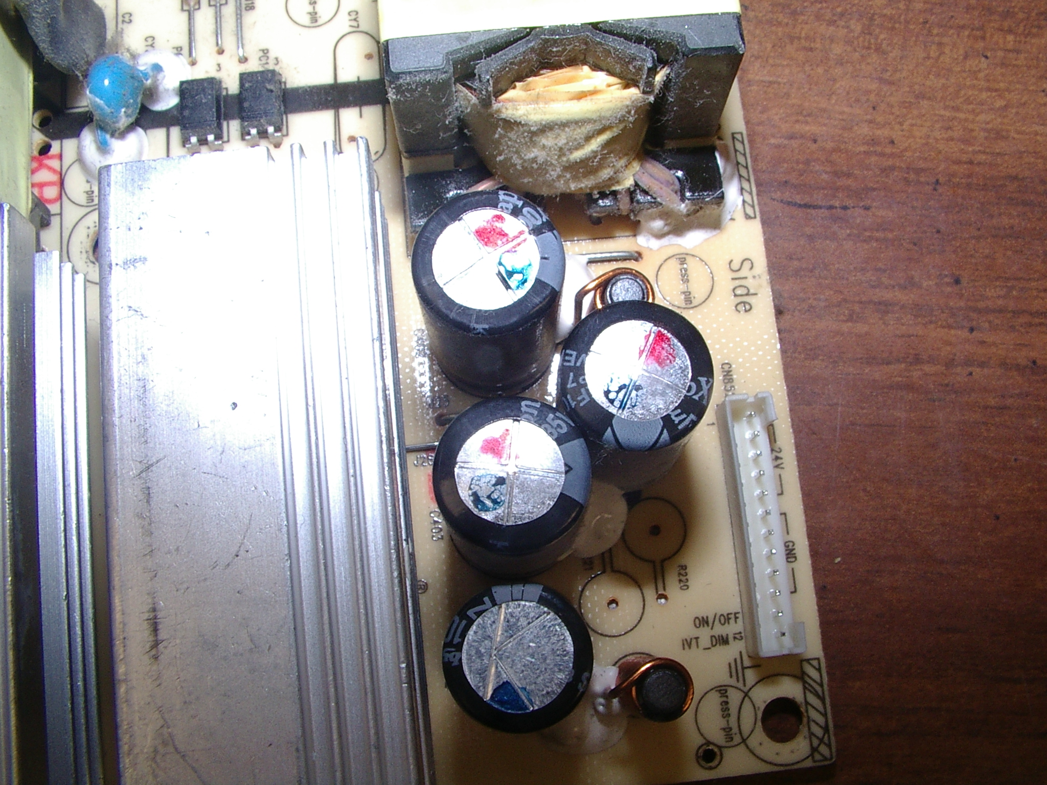

Here is another example of someone changing out what was probably an obviously bulged Capxon with a Rubycon ("K" vent), but didn't bother changing out the rest of the non bulged Capxons at the time.
Time passes and, not surprisingly, the other Capxon's bulge.
I have always recommended people replace all the caps regardless whether they are bulged or not especially if they are known bad brands like Capxon.--- begin sig file ---
--- end sig file ---Comment
