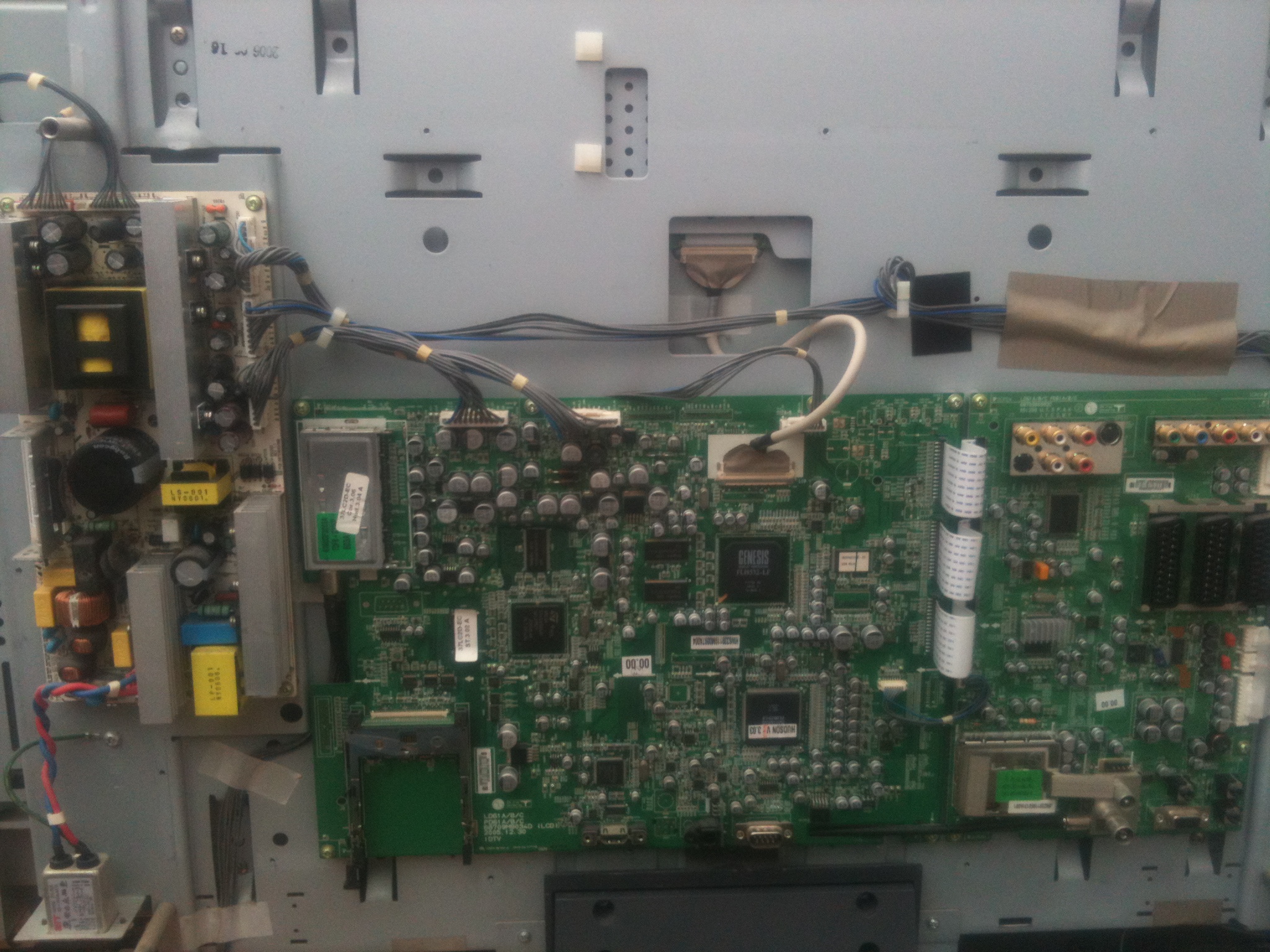

    Hello forum,yet again another lcd with a problem,i have a lg plasma 37 incH (37LC2DB,has no sound ? picture is ok,have checked speakers they do not seem blown,i have no pictures yet to post up,but have part numbers,if anyone has come across them
    psu:6709900016 LGp2637n
    Re: Lg 37 lc2db
    It's an LCD.
    You weren't clear on the symptoms but I'm guessing all too common no sound problem from your post.
    The 3.4V output on the PSU is defective (measures low) and that will cause no sound.

      Re: Lg 37 lc2db
      basically no sound,someone who had it before said he could even get sound out of a amp plugged in ?
        Re: Lg 37 lc2db
        Yes, bad 3.4V output almost certainly, very common issue.

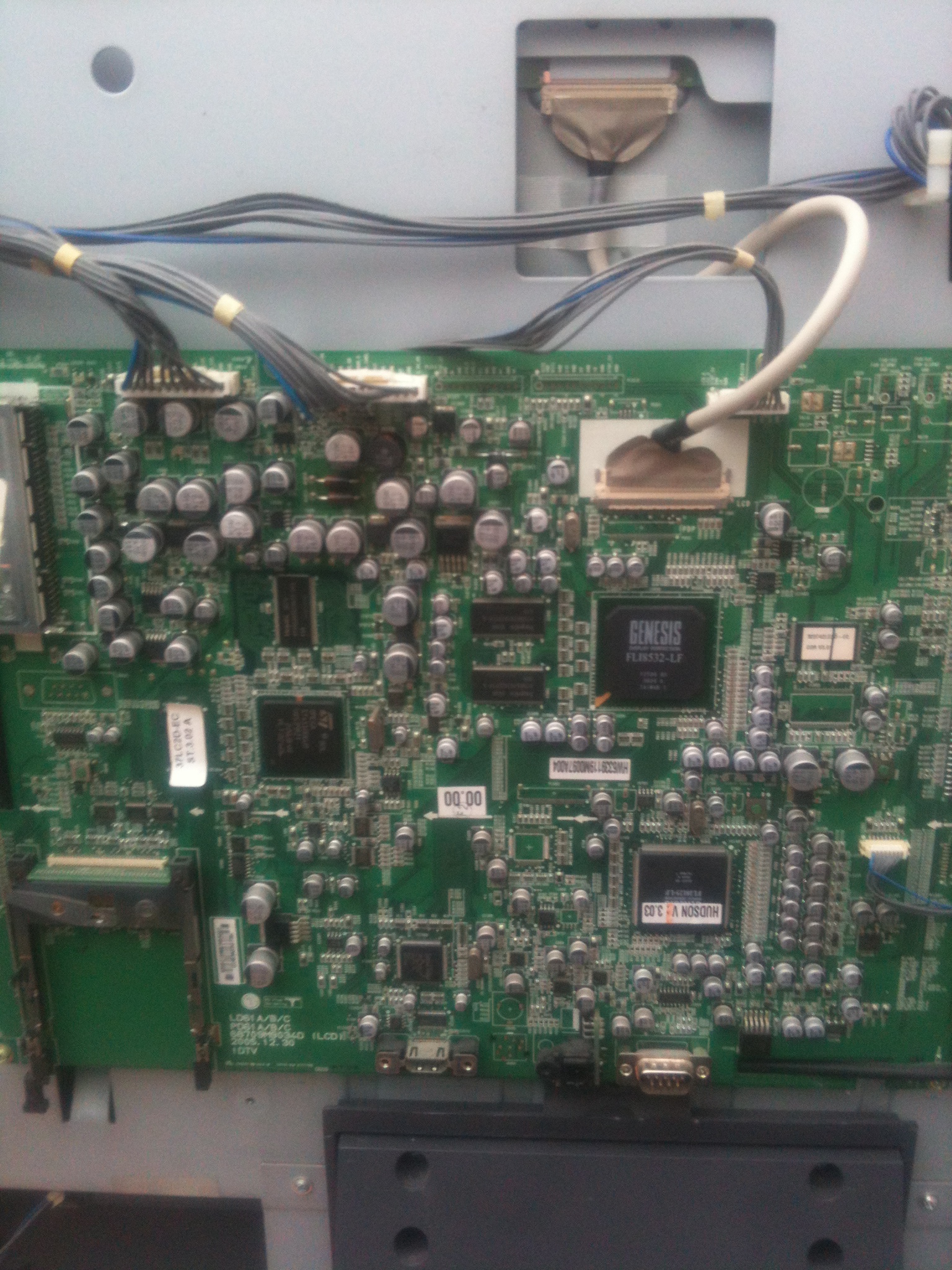

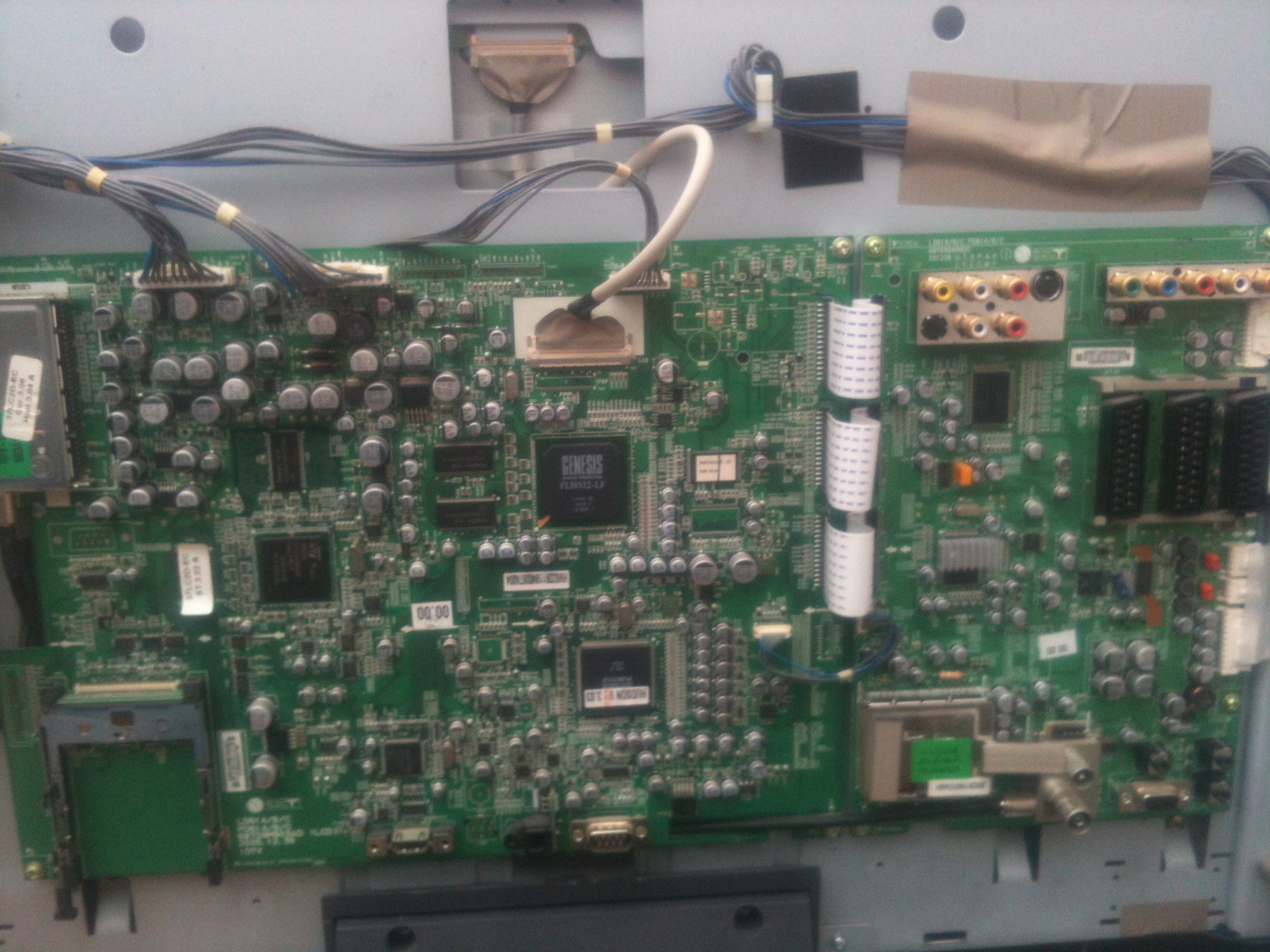

          Re: Lg 37 lc2db
          tom have you a diagram or picture to highlight please.
            Re: Lg 37 lc2db
            No, but I know the 3.4V is on the PSU, and the PSU outputs are labelled, you need to take a few pictures so we can see the chassis layout of this TV.

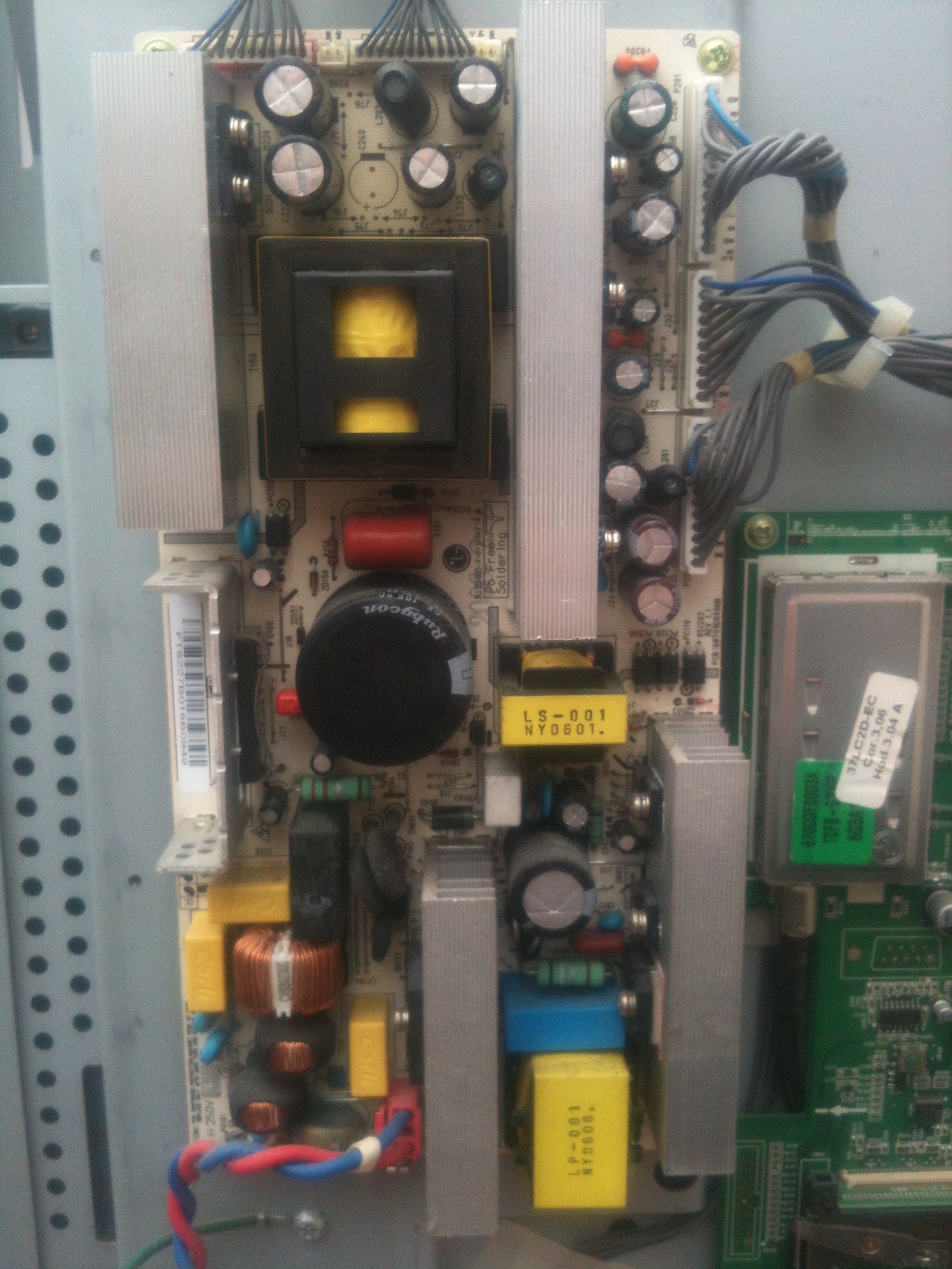

                      Re: Lg 37 lc2db
                      I can see a bulging cap on the PSU.
                      • LEEDASH
                        • Dec 2012
                        • 481
                        • Bedfordshire
                        Re: Lg 37 lc2db
                        the one near the 3rd connector
                          Re: Lg 37 lc2db
                          Indeed.

                            Re: Lg 37 lc2db
                            now got to undo the set to see what voltage of the dam thing : (
