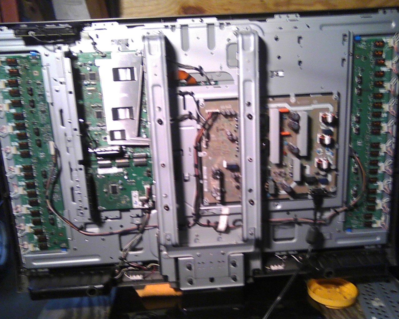

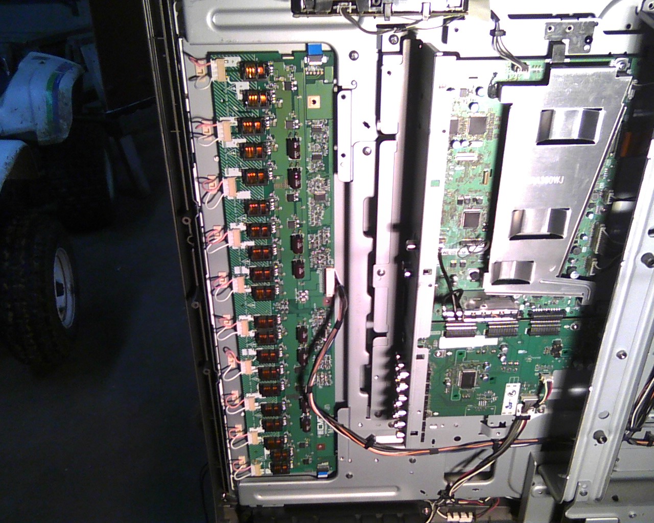

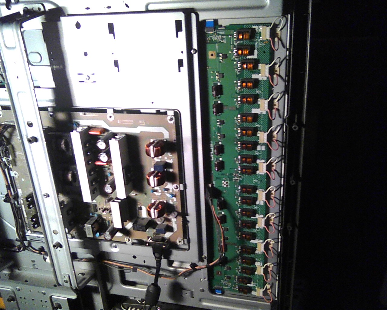

      While attempting to start the TV - The Main backlight inverter board (on back, left side) does have 23.66V running through it, and I can trace the voltage through to most of the board. The two connections with power that run to the top ribbon have 23.61V on both. The two connections with power on the bottom running out to the ribbon on the bottom have 22.09V, and 21.40V to them. (Not sure if this is meaningless or not...seemed odd, especially when compared to the next part) The Slave backlight inverter board on the right side back has a little different voltage for some reason...23.65V to the board, 23.60V on both at the top, 21.41V and 21.95V for the two on the bottom. Also not sure how much of an issue this is, but some, not all, of the transistors on both backlight inverters have power running to some part of them. Seems like all of them should have power running to them, but they don't...again, don't know if this is an issue, or not...just looking into every possible symptom.

              Even if the voltage is a little low, I would think you should be able to see if the backlights even flash for seconds, for it to have error feedback, it had to try to start first then reports the feedback back to the main board to tell the processor that there is the problem. So look at the holes on the back of the panel in the dark room to see if you can see the flash at all.
              Can we also get good clear pictures of both inverter board so we can read the labels on the connector, we need to check for the BL_ON/INV ON/FF pins, and fuses.

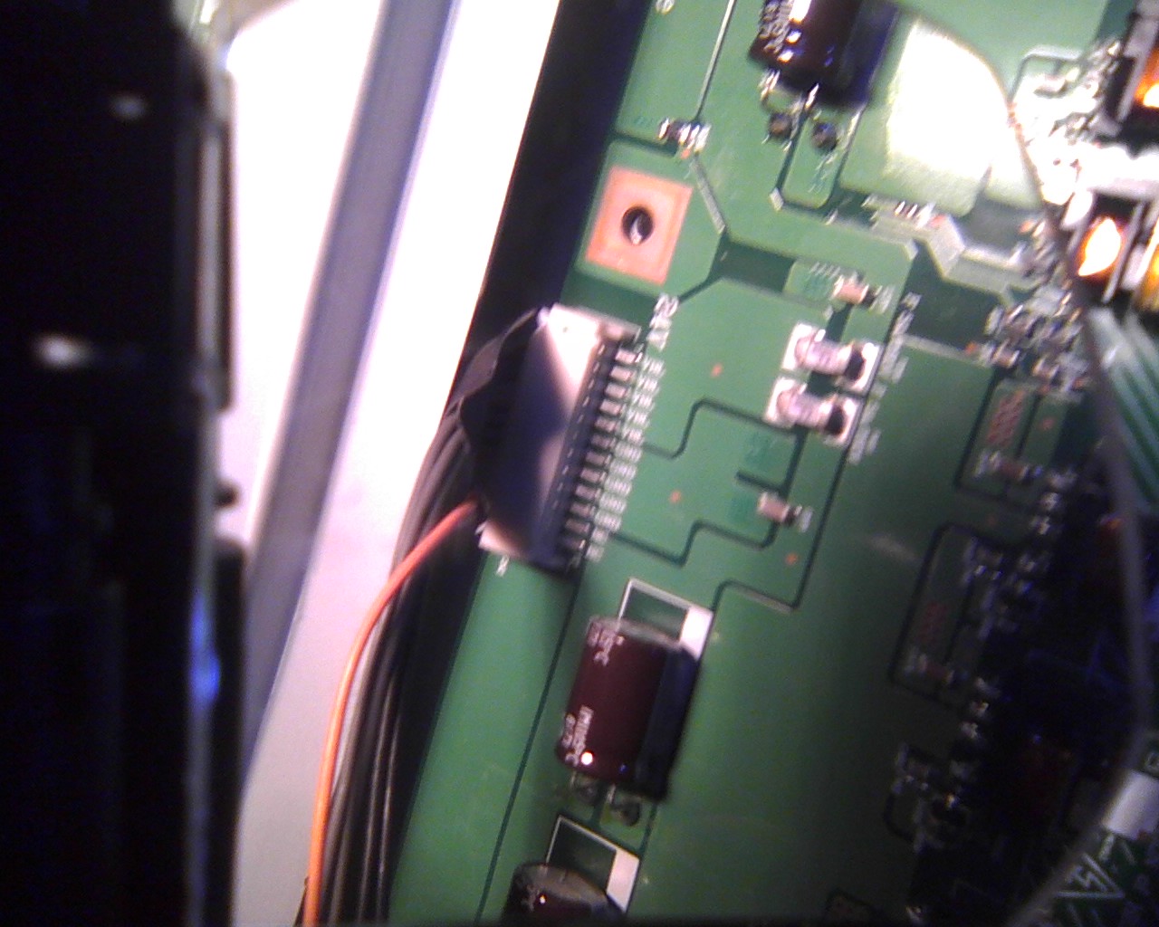

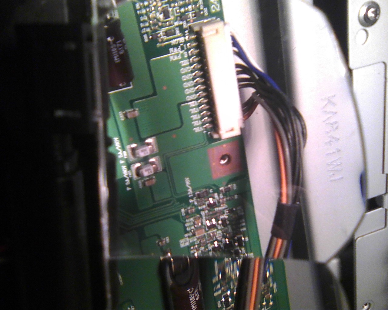

                I don't know how close I can get photos for you that you can see...hard enough for me to read them with my magnifying headset. Maybe later I can, but for now possibly these will work. The first picture is of the incoming plug from the power module to the slave backlight inverter on the right side, looking at the back. It has from top to bottom, 5 VBLs (which all have current when you first plug it in of the voltages I mentioned earlier, and also when you hit the power button again after the three tries that the TV attempts to do whatever it's initially doing when I plug it in. Let me make sure you understand this, when you first plug the TV in it starts this sequence of sending current out to the inverter boards...NOT after I plug it in, then hit the power button. Only after the sequence runs it's course do I get to hit the power button to try again...), then there is 5 GRDs, which don't have power, then 2 NCs, which don't either. Next picture is of the Master Power inverter on the back left where it comes in from the power module. These read from top to bottom BLON, I_PWM, E_PWM, then 5 GND slots, and finally 5 VBL slots. The only ones that have power are the 5 VBL slots on this side too. I do not see any lights trying to light when I plug it in, or when I hit the power button a few minutes later when I get the chance again...though to be honest, there are no holes in the back to see such a thing, and it really doesn't look like it from the front. The final picture is of the fuses you wanted to see on the power supply module (I am assuming, it's the only one I can see). Wish the photos were better, but it is the best I can do for now. It is one of those fuses with the little ball in the middle, and doesn't appear to be broken at all...
                Is this good enough to answer your questions, or do I still need to try to find a better camera?

                    23.6v is within 2% of 24, is fine. That is not your problem. Your photos really are not adequate, as we cannot read any of the important information on the boards. As far as detailed schematics with voltages etc. - we would all like that. Unfortunately, the manufacturers no longer provide that kind of detail, because they do not intend for the boards to be troubleshot to the component level. If you have downloaded the service manual for this model you can check the meaning of the error codes in it. That information is in the service manual. If you don't find it, I can look it up tomorrow, I don't have access to my records from this computer.
                      Re: Sharp Aquos lc42d6u power and OPC flash once together, then power light flashes t
                      BLON is the signal from the main board to tell the backlights inverter to turn on, it should be >3v at that pin. So monitor that pin when you hit the TV power switch on and off, it should change state if the main board is sending out the signal to this BLON pin. Read my guides below.
