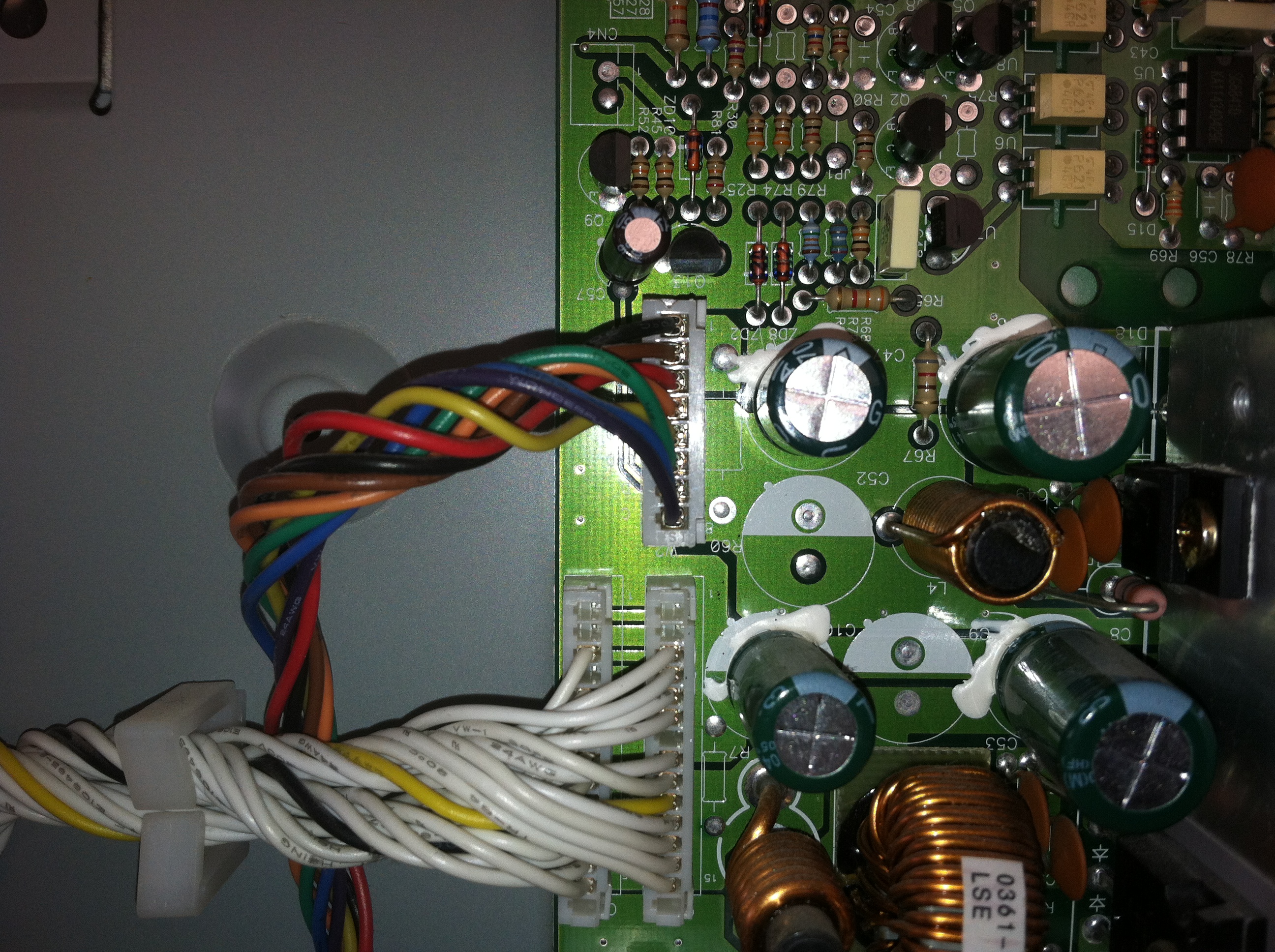

    I found this TV last week and haven't put much effort into it. It's kind of a lazy Saturday morning here so I decided to pull it out and have a look at it. There was an obviously bulged cap on the PSU. I swapped it out but still have the same issue. In standby, at the PSU, I have
    12V = 12V
    12V = 12v
    12v = 12v
    GND = 0v
    GND = 0v
    GND = 0v
    D = 0V
    C = 1.5V
    At power up, the LED turns from amber to green, the backlights flash briefly (maybe a half second) and I see the following voltages
    12V = 12V
    12V = 12v
    12v = 12v
    GND = 0v
    GND = 0v
    GND = 0v
    D = 3.5V
    C = 1.5V

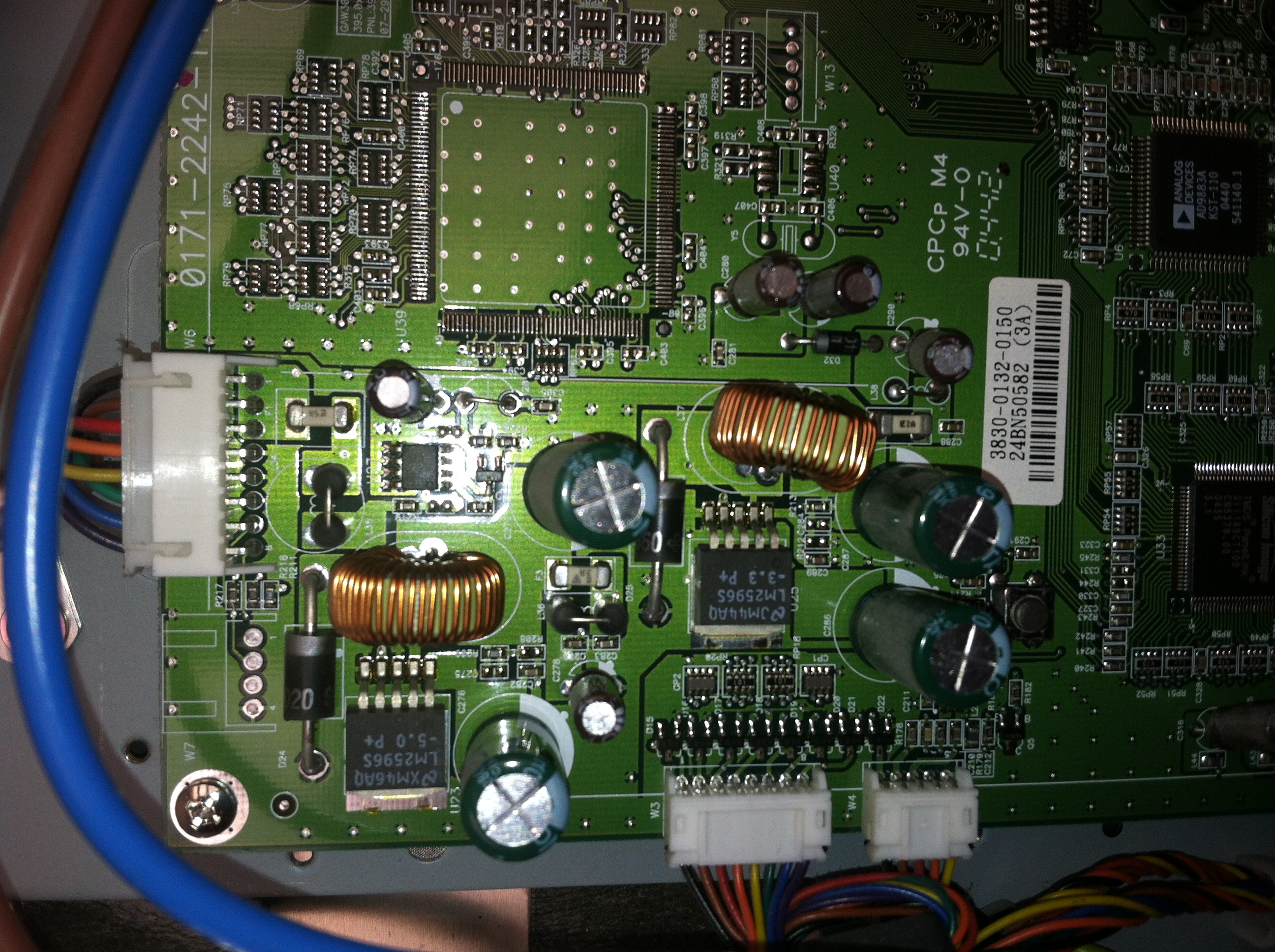

    These voltages hold steady for ~3sec and then the 3.5V drops back out at which point the green LED reverts back to amber. On the main board, I have 3 fuses, they read
    F1 = 12V steady on both sides
    F3 = 5V steady on both sides
    F2 = 3.3V steady on both sides
    These voltages do not drop out when the PSU shuts off. I see one voltage regulator with a shape that I'm familiar with.

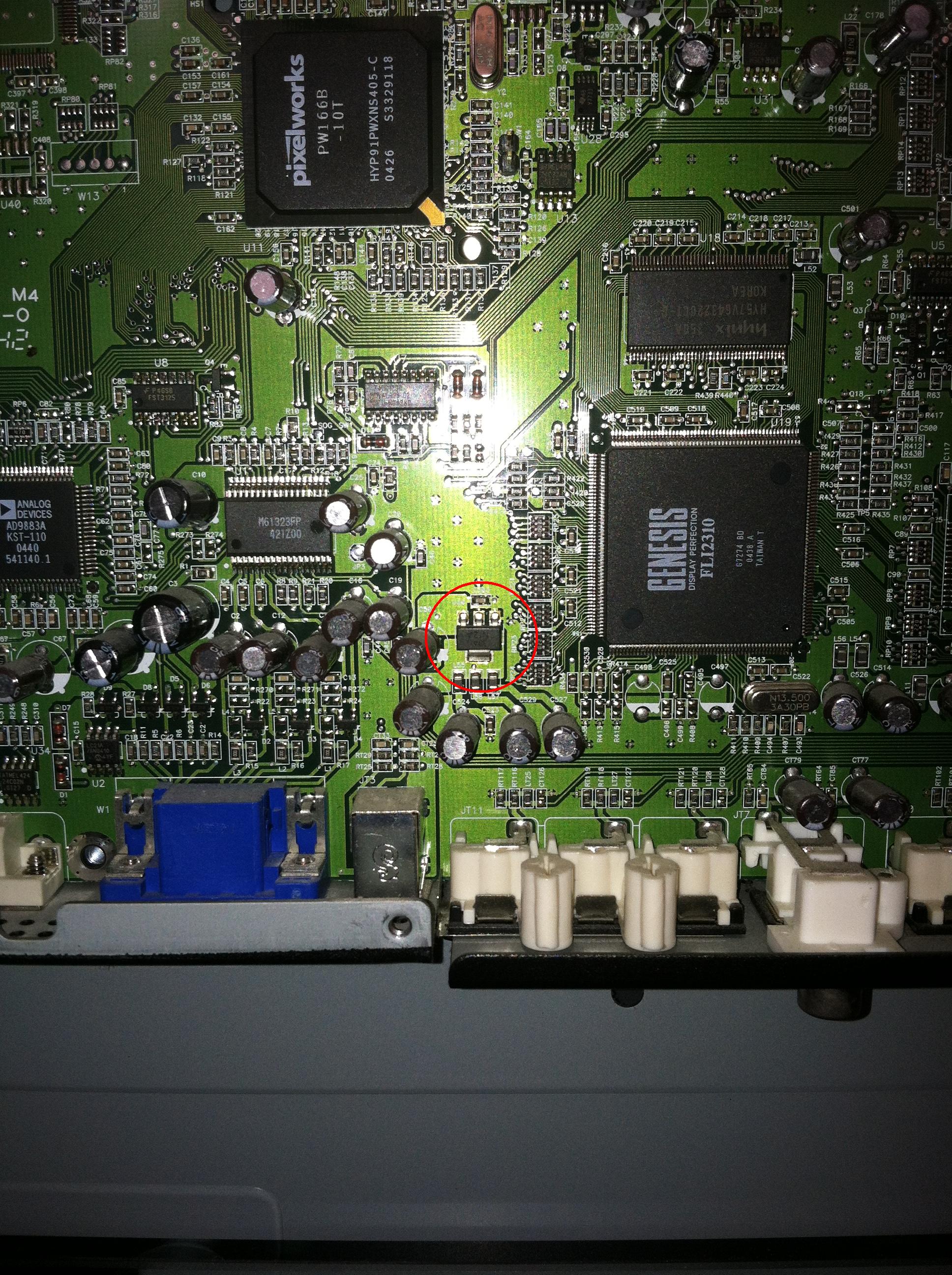

    U20
    38AU
    N12A
    3.3V
    1.8V
    0.1V
    These voltages don't change at power up or standby.

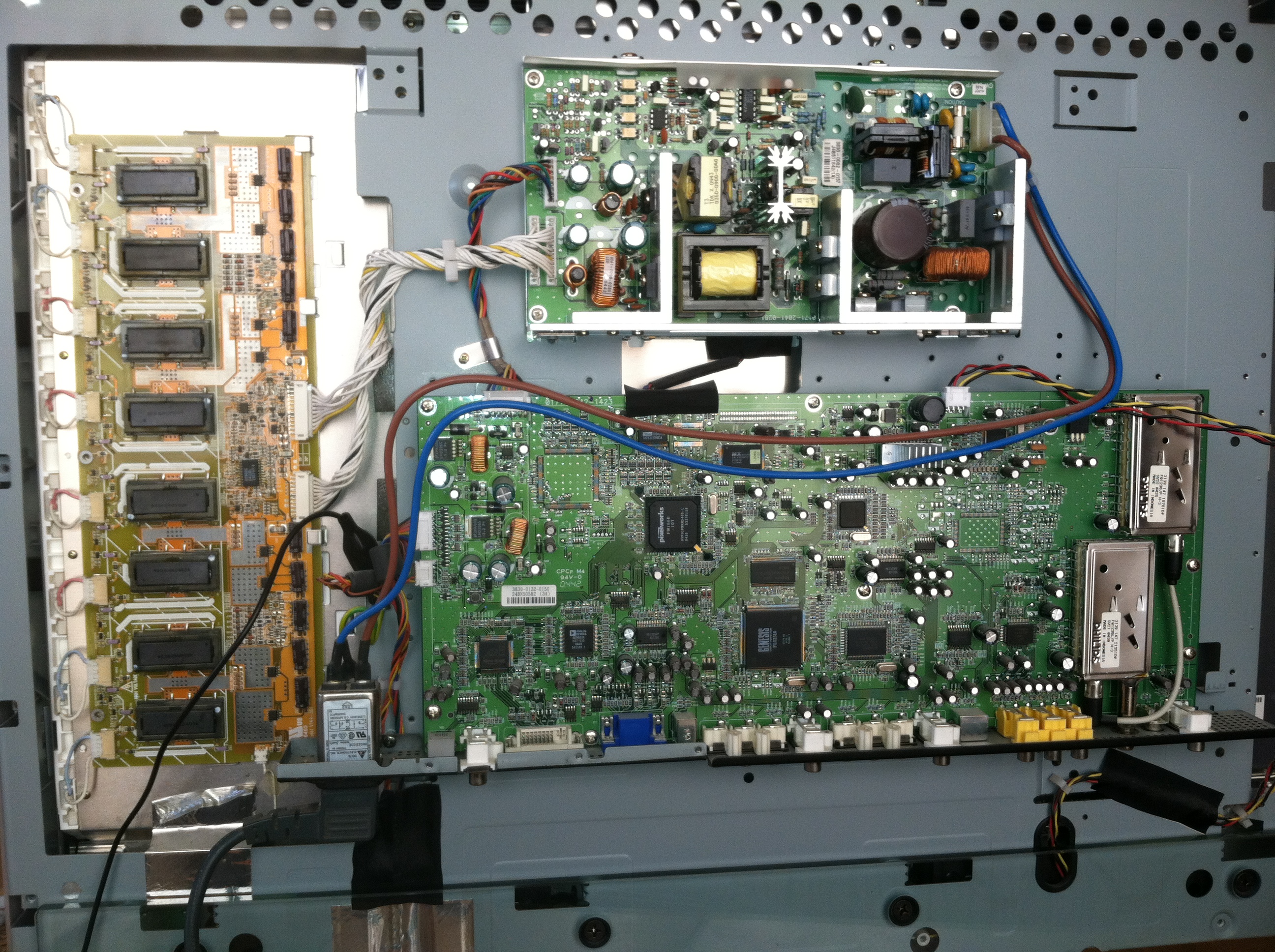

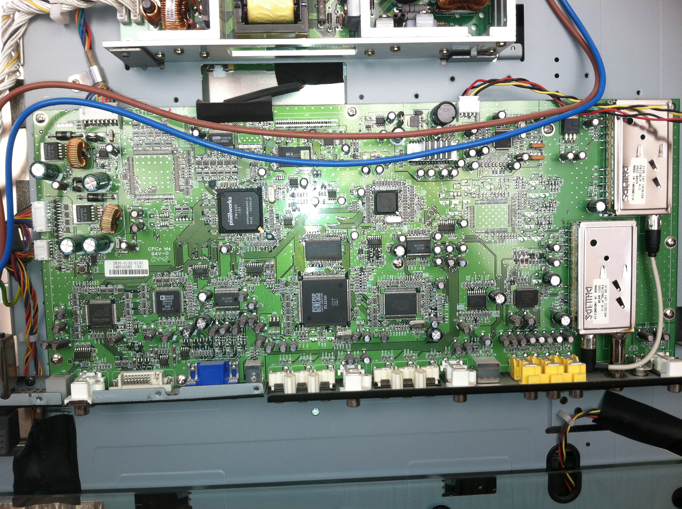

    I'm leaning towards a main board issue. I'm hoping this can be fixed at a component level. The only main boards that I can find for this set are ~$80 which is more than I really want to put into a 9 year old TV. If I can get this thing to just show a picture, I will be happy. My plan is to give it to my brother to use as a computer monitor.
    Re: Vizio L30WGU, powers up for a few seconds then returns to standby.

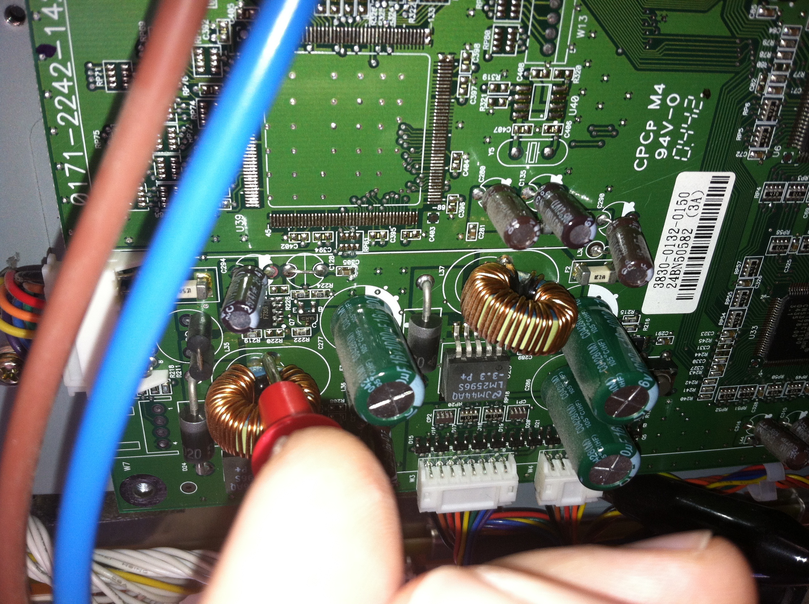

    OK you see those coils on the main board, left hand side? On the end not connected to the diode, you should see a steady DC voltage.
    • johnboy1313
      • Nov 2012
      • 1959
      The top coil shows 5v at the point shown in the pic. The other coil shows 3.3v.
        Perhaps try forcing the backlight on to see what you get. If you see graphical noise or corruption I'd suspect the video processor (PixelWorks IC.)

              1) If you hookup a DVD player so you get a picture and sound, do they both stay on?
              2) On the inverter board, it looks like some Darfon branded inverter transformers?
              You can measure the secondary resistances and report them like so
              https://www.badcaps.net/forum/showpo...6&postcount=20

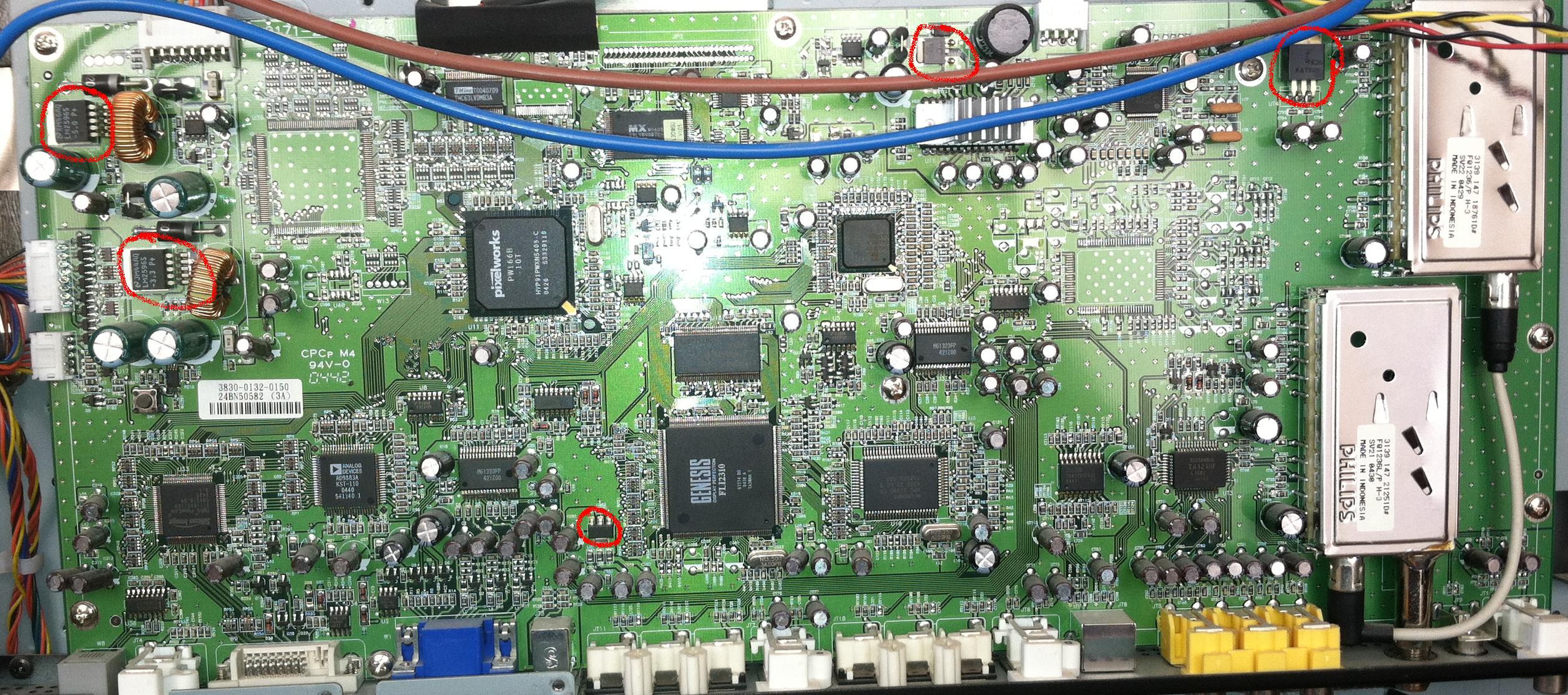

              3) U23 and U25 on the main board are also regulators
              https://cdn.badcaps-static.com/pdfs/...cd58db5a46.pdf

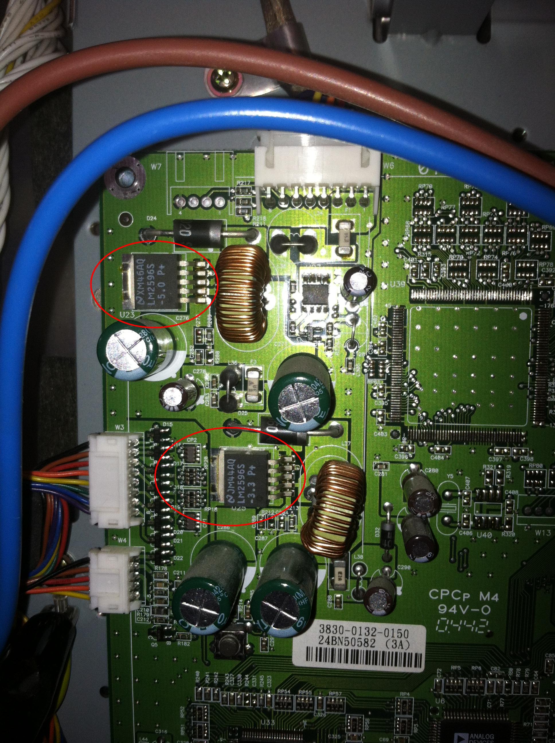

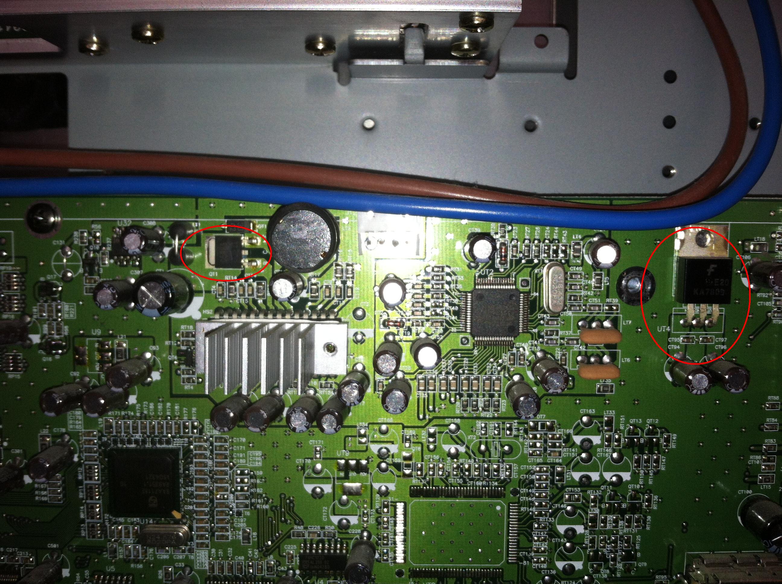

                4) I found a couple of more regulators. I can't be sure since I can't read the part numbers. All circled in red.
                --- begin sig file ---
                --- end sig file ---
                • johnboy1313
                  • Nov 2012
                  • 1959
                  From retiredcaps pic...
                  Upper left regulator
                  U23
                  XM46AQ
                  LM2596S
                  -5.0 P+
                  12.16V
                  4.95V
                  0V
                  5.05V
                  0V
                  From bottom to top, voltages are steady when in standby or powered on
                  Next one below that...
                  U25
                  JM44AQ
                  LM2596S
                  -3.3 P+
                  12.15V
                  3.07V
                  0V
                  3.31V
                  0V
                  The next one is U20 that I reported on earlier, the bottom regulator furthest to the left in retiredcaps pic.
                  The next one is all the way to the top, right above the heatsink.
                  QT1
                  C5886
                  3.65V
                  12.13V
                  3.3V
                  From bottom to top, voltages are brief when powered on. All read 0V in standby.
                  Last one...
                  UT4
                  KA7809
                  12.13V
                  0V
                  9.04V
                  From left to right, voltages are brief when powered on. All read 0V in standby.
                    Those first two are switching converters, not regulators.
