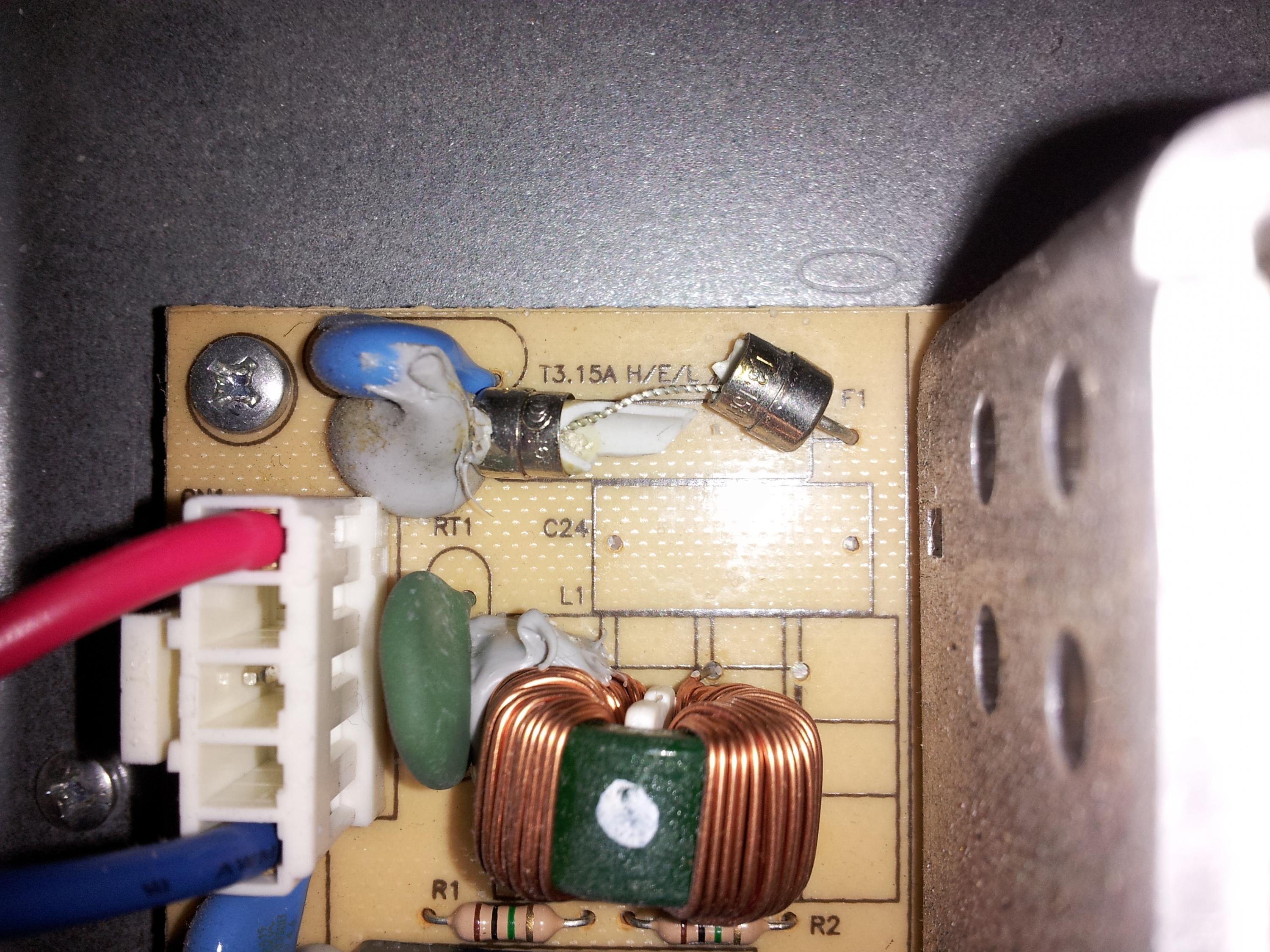

    So my Dad gave me this tv he's had sitting in his garage because it didn't have a picture. Plugged it in to double check. Opened it up and saw a broken fuse (pic attached)
    Is this my problem? and how do i go about fixing this.

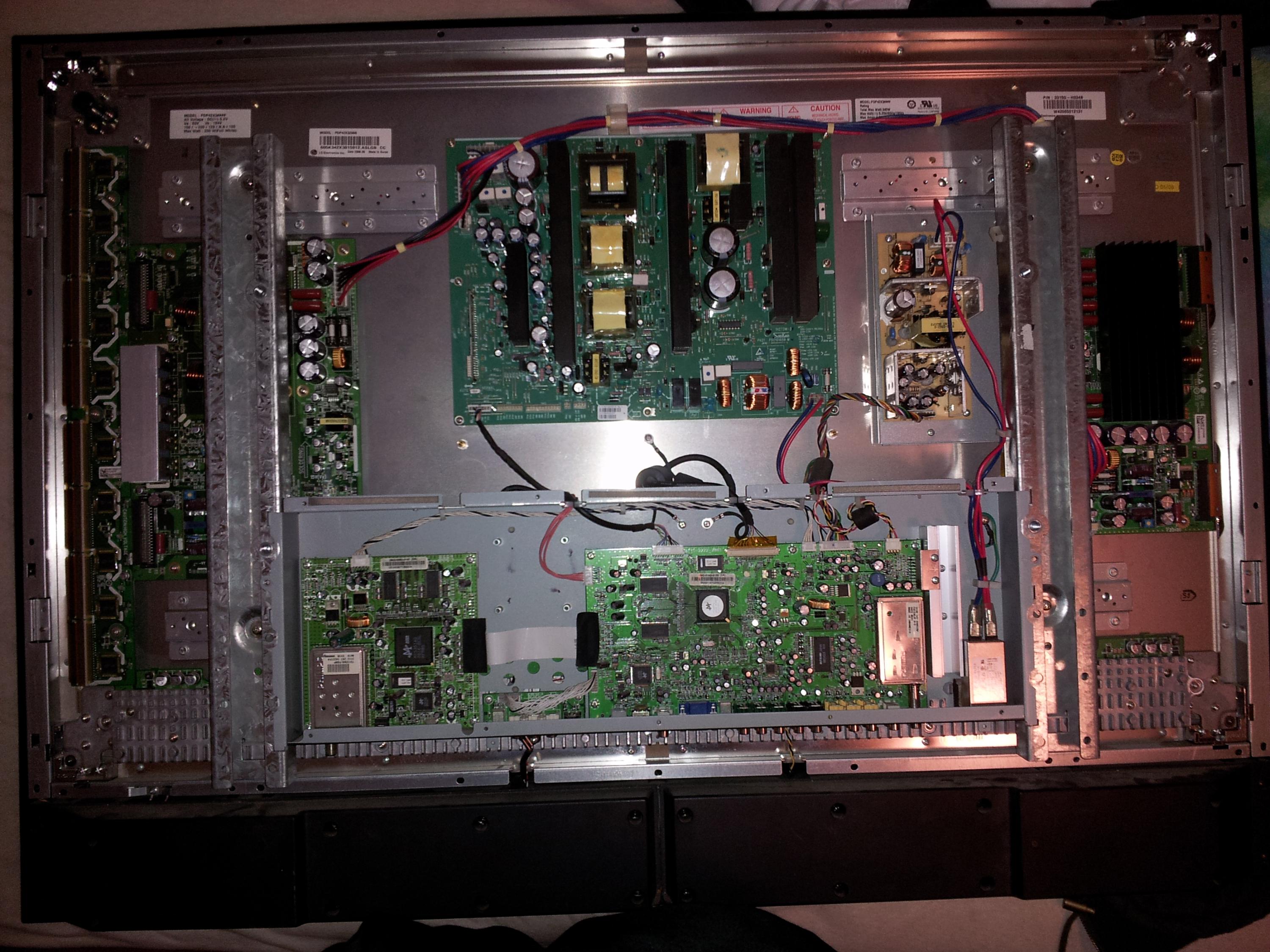

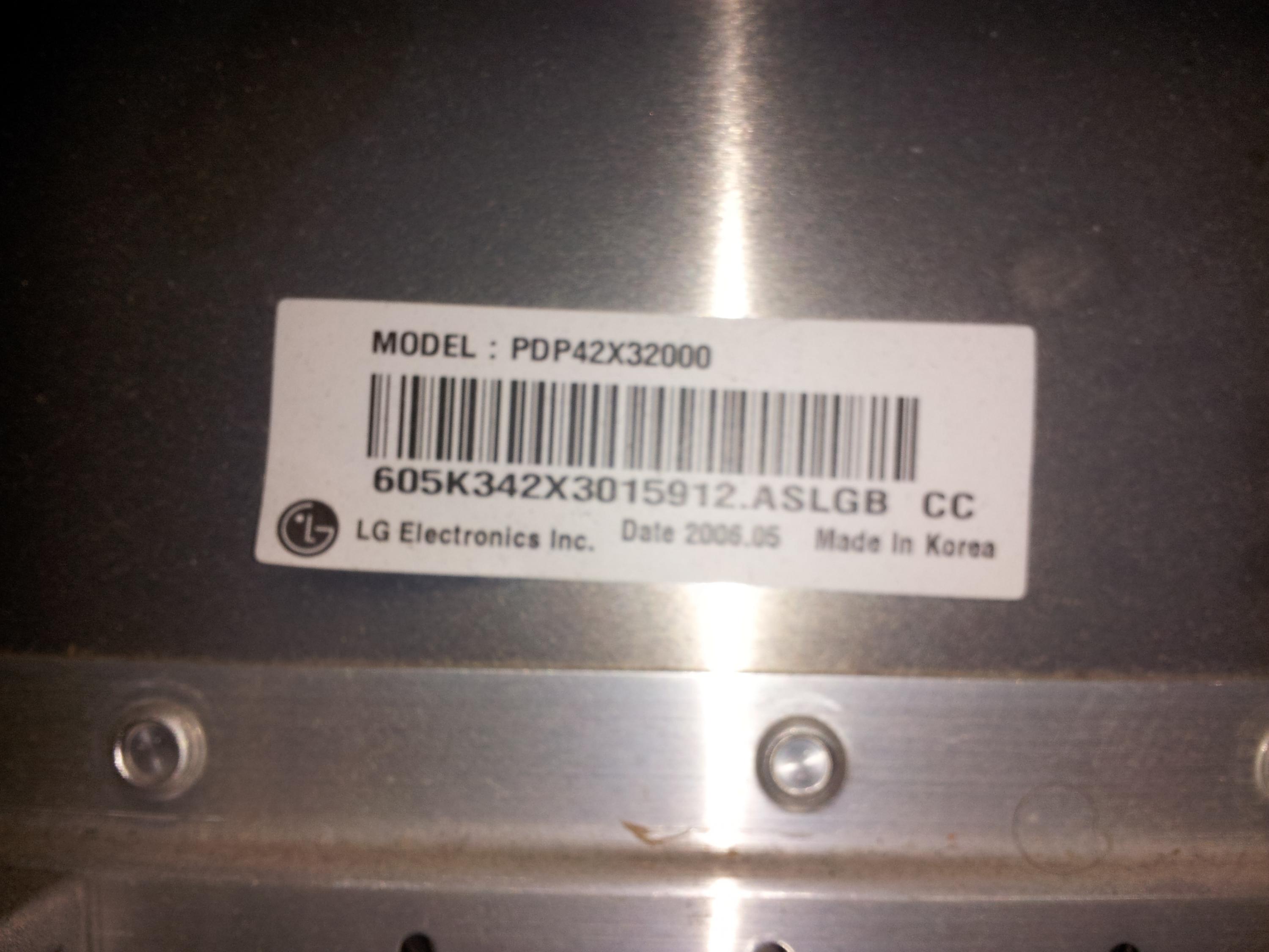

    LG board. Pictures attached
    Vizio P42HDTV10A

    It's a good start. However, it doesn't actually look broken (as in the fuse wire.) If the unit powers on the fuse is probably good. I'd highly recommend replacing it, though.
    This set most likely has dreaded LG IPM failure. This video (not mine) covers dim picture, but it also applies to no picture. You need to find the Y-sus or Z-sus failed board by testing them for shorts. Removing the IPM is very tricky. Soldering a new one in is trivial.
    https://www.youtube.com/watch?v=Y8MNQYXw8E0
