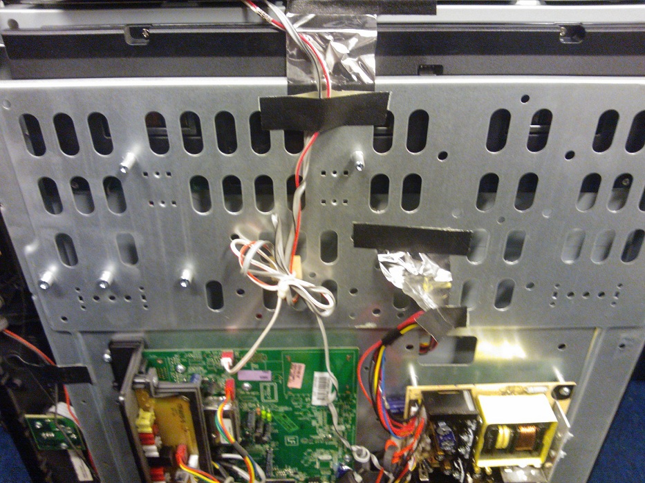

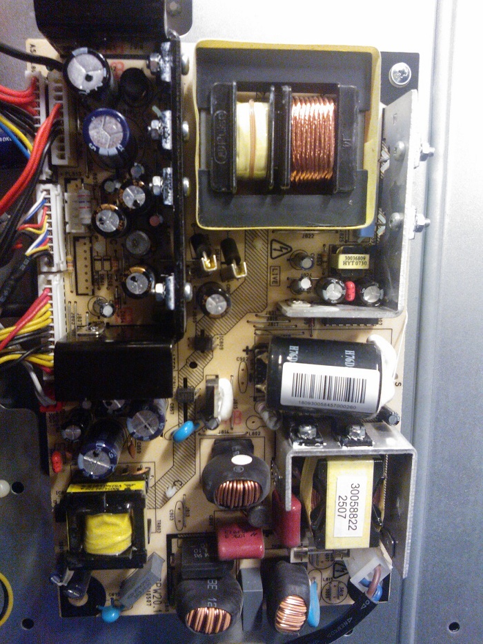

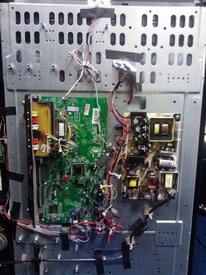

    Good evening folks,
    A friend of mine were very keen to get his 32" LCD up and running so of course I'm there to help.
    It's a "Limited Label model Beluga32/0" which tries to start up. It starts up the backlight for a second, then powersupply shuts off.
    If unplugging the backlight supply (+24V) connector from SMPS, the SMPS stays on.
    During that second the backlight is on, the picture appears to be normal.
    If the inverter were bad I assume the backlight won't turn on at all.
    So, probably the SMPS is weak and shuts off when the inverter needs the startup energy.
    BUT - I replaced the caps on the +24V line, with no help, so please look on the attached pictures if you may recognize something.

    Heh, it's a Vestel. I've seen this chassis and its variants far too many times.
    Replace the two 15nF capacitors near the main transformer and re-touch the soldering on all of the power devices and it should work.
    Or replace the PSU, it's only about £20 on eBay.

      Thanks Tom! Will check this first thing. BTW - Great collection of servicemanuals in your database!
