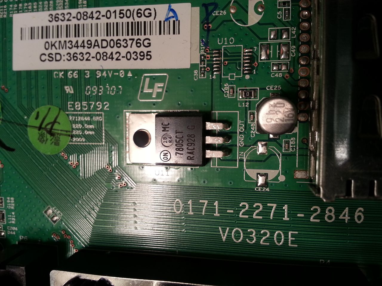

    markings MC 7805CT

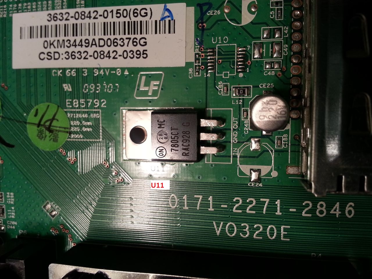

    I suspect that the linear voltage regulator U11 is not working.
    Any ideas what may be wrong with the TV?

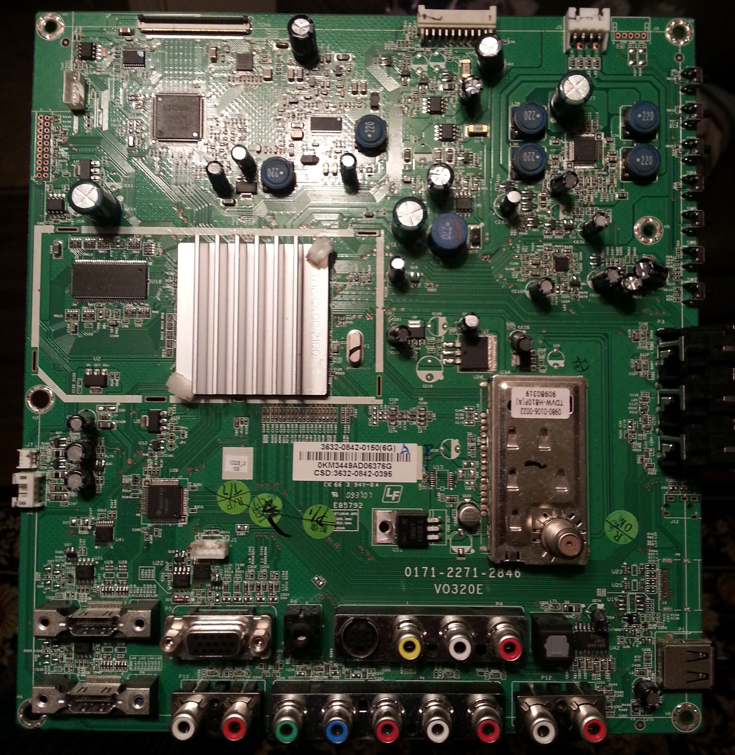

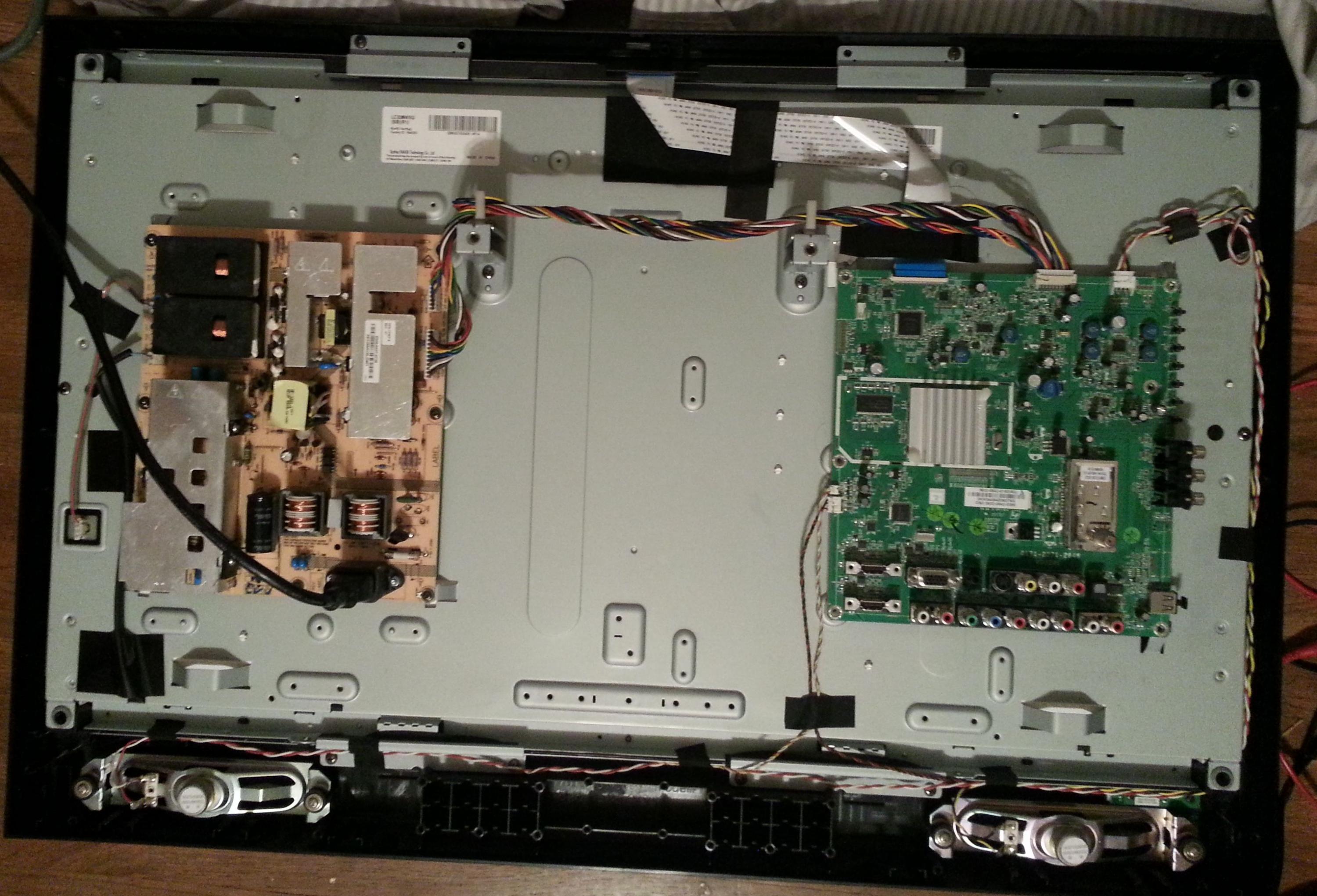

          Please report the readout again after reading this post in the format that we can easily under stand, it will be so much easier for us the figure out what you are getting on your reading.
          Also the pictures of the back side of the TV so we can see how many boards and what kinds you have in your TV.

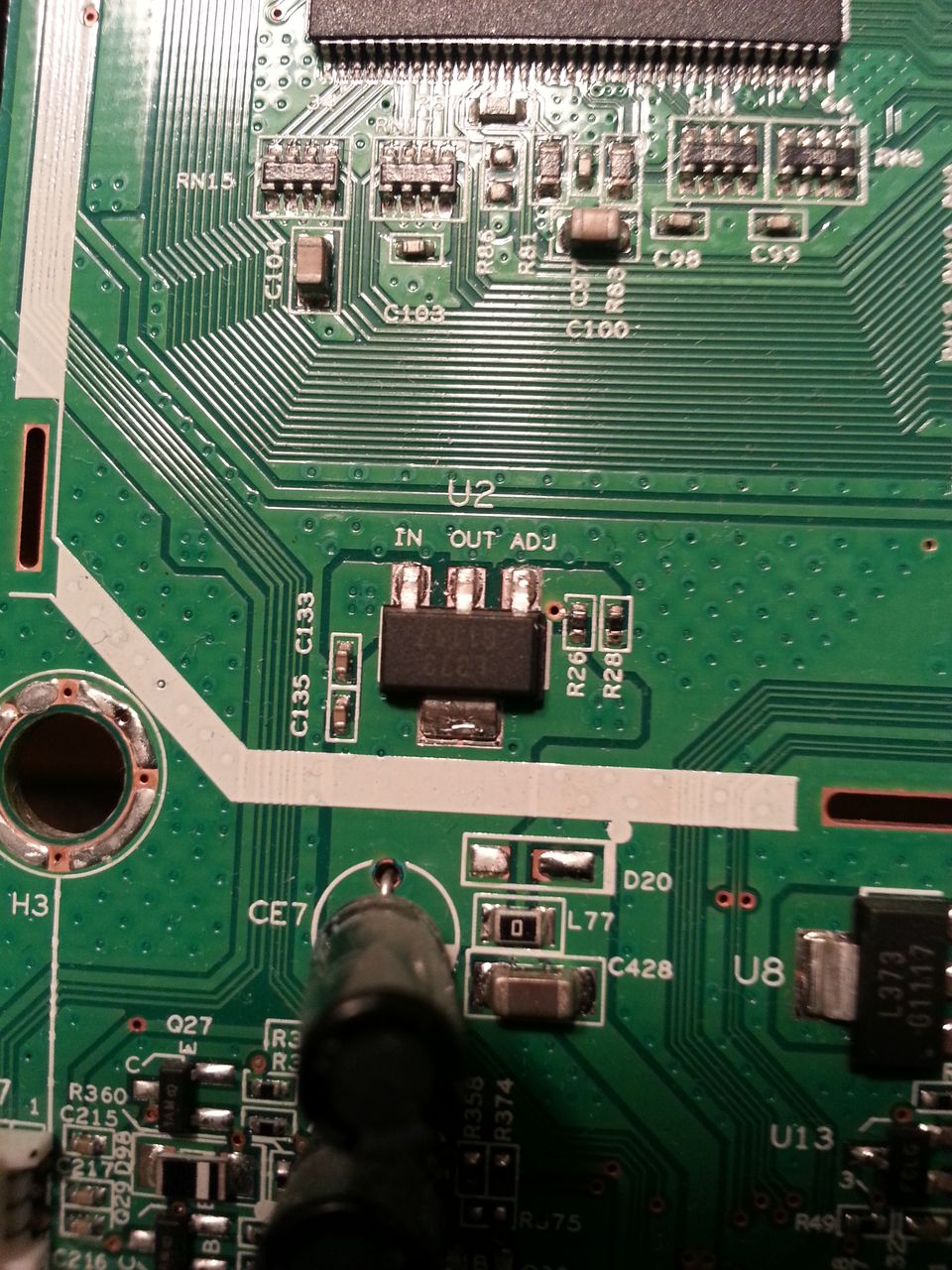

            Re: Visio VO320E - black screen
            ADJ = Pin 1
            Out = Pin 2
            In = Pin3
            U2
            L373
            p1: -1.27
            p2: - 0.03
            p3: 1.71
            u8
            L373
            p1: -1.27
            p2: - 0.03
            P3: 1.99
            U9
            L373
            p1: -1.27
            p2: -0.03
            p3: 2.51
            U7
            L323
            p1: -1.27
            p2: -0.03
            p3: 1.71
            U4
            L373
            p1: -1.27
            p2: -0.03
            p3: 1.75
            U5
            L373
            p1: 2.41
            p2: -0.03
            p3: 1.7
            U11
            7805CT
            pin 1 out: 0
            pin2 ground: 0
            pin 3 in: 1.71
              Here is a picture of the back of the TV.

                You have one of those power supply-inverter board combo type.
                I suspect that the main board is not sending the BL_ON signal to the PWR-INVRTR board.

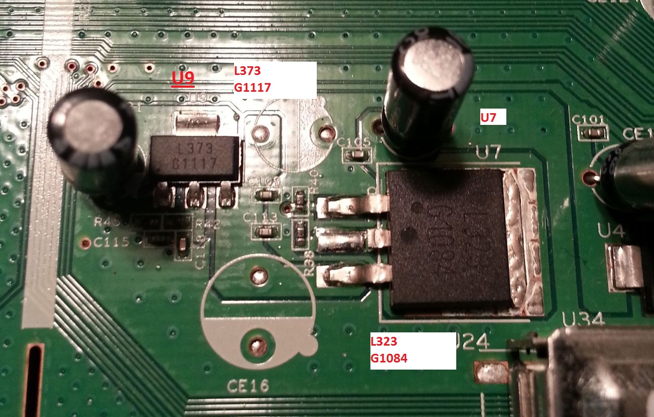

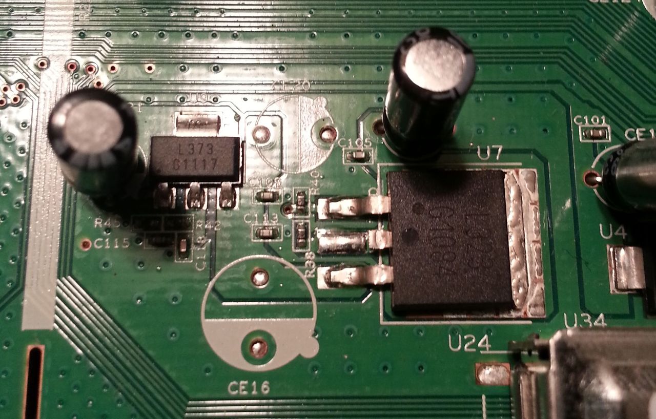

                  The regulator L373 has G1117 on the second row.
                  The regulator L323 has G1084 on the second row.

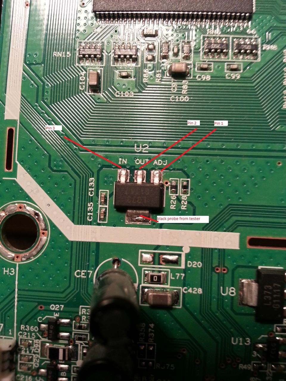

                  I am attaching the picture with marks how I assigned pin numbers.
                    Pins numbers
                      OK, I see why you are getting the wrong readings, that big tab on the regulator is connected internally to the center pin of the IC, so the big is the same as Out pin.
                      You need to put the black probe of your meter to the metal chassis which is the Ground ref. point, then the red probe for reading In, Out, Adj.

                            U11: 0 zero
                              OK, can you do the same report for the adjust pin and chassis? U11 is 78xx series regulator which rarely goes bad, inthis case, it is 7805 which is 5V regulator.
