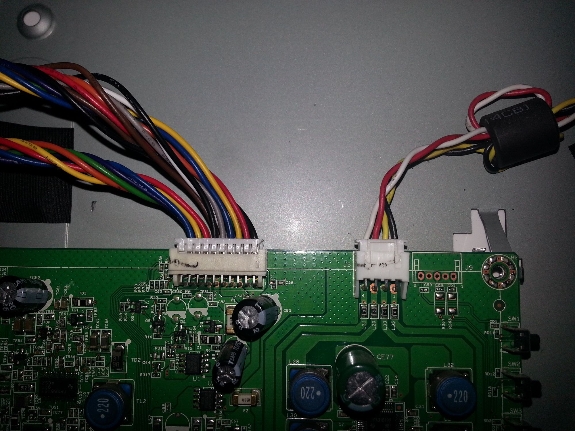

OK, base on your reading at ADJ pin and Ground:
U2: 2.04v (Out = 2.04 + 1.25 = 3.29V. Your reading on post 14 is 3.28V = Good)
U8: 0 v (Out = 0 + 1.25 = 1.25V. Your reading on post 14 is 1.23V = Good)
U9: 1.24v (Out = 1.24 + 1.25 = 2.49V. Your reading on post 14 is 2.48V = Good)
U7: 2.04v (Out = 2.04 + 1.25 = 3.29V. Your reading on post 14 is 3.29V = Good)
U4: 2.04v (Out = 2.04 + 1.25 = 3.29V. Your reading on post 14 is 3.28V = Good)
U5: 1.36v (Out = 1.36 + 1.25 = 2.61V. Your reading on post 14 is 2.60V = Good)

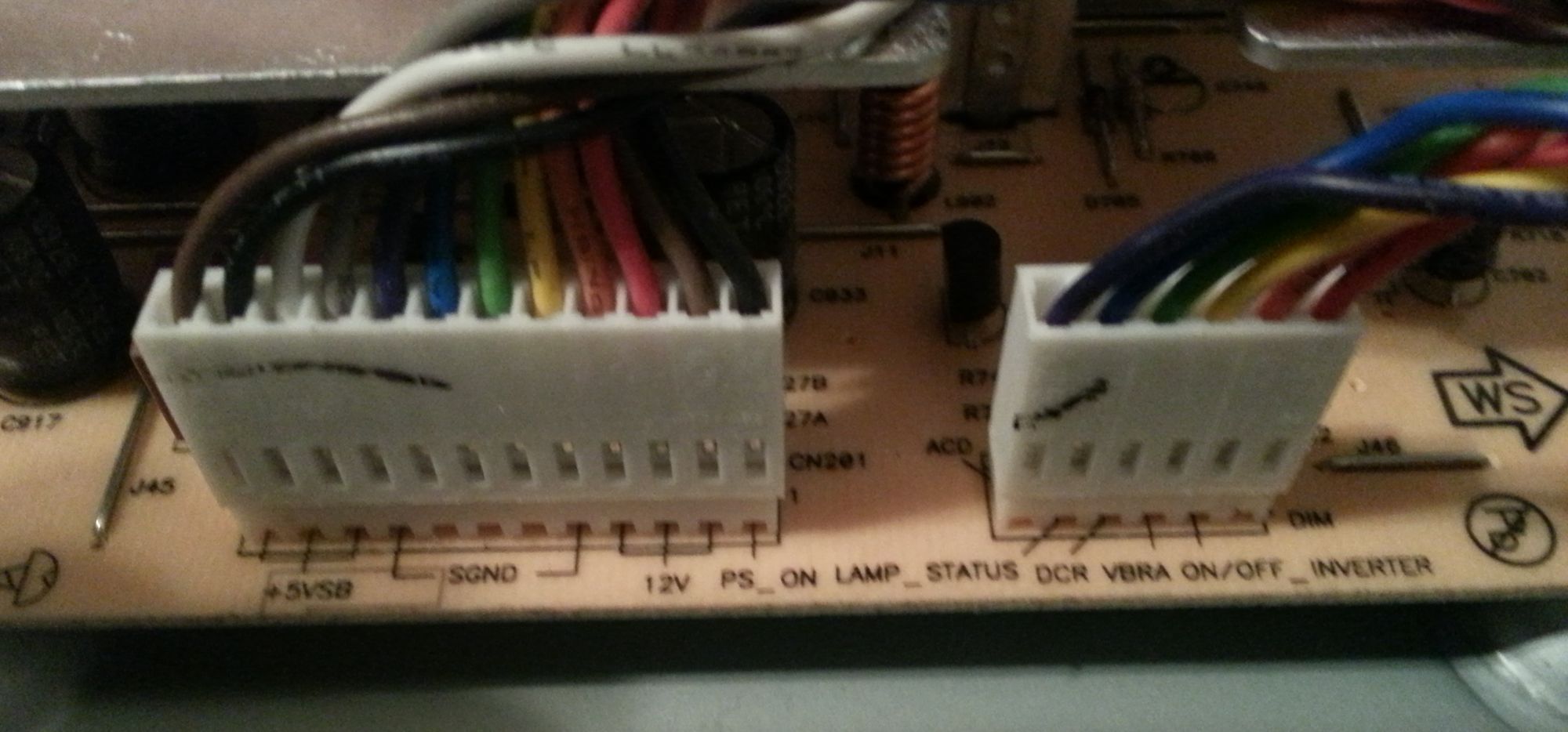

U11: Not applicable. Pin out is not the same as 1117 regulator. It is not getting Vin (12v) from the power supply board.
All the 1117 regulators are OK.
