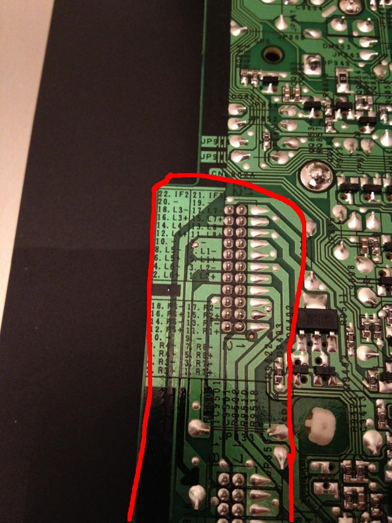

      So should Pins 1 and 2 on the ONL802B connector be getting 176v as the PCB legend states for the LED output? Do you know where the voltage would get kicked up to that amount? I test the surround area where those 4 electro caps are and keep getting 107v as the highest voltage I can find.
        Re: Samsung UN46D7000 46'' LED; No Power
        I have not look real close at the bottom side of the board to see how they drive the LED strings yet.
          It looks like the pins on those two connectors are linked but the picture is not shown. Can I see the picture that clearly show the traces between the two connectors?
          It also looks like the LED are edge lit from the left and the right side of the panel based on the labels of the pin as L1+ L1- (L1~L8), R1+ and R1- (R1~R8).
          At this I may not be able to troubleshoot it down to component level.
            Some pins on the same side - even numbered or odd numbered, are linked. The following are linked:
            802A Pins:
            14/16
            4/6
            3/5
            13/15
            802B Pins:
            3/5
            13/15
            4/6
            14/16
            Are there any other tests I can do to totally confirm it is the PS board thats bad?
