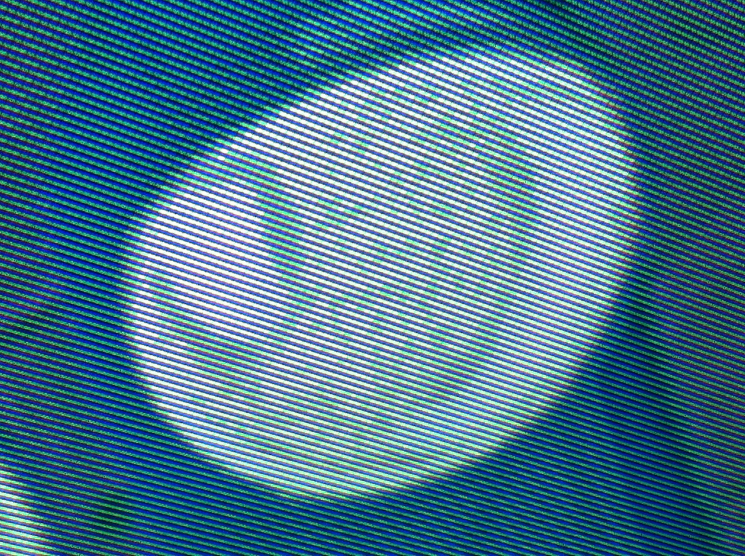

    I just picked up this 2007 42" Sanyo this morning. Occasionally, the bright areas have dark sparklies, kinda like static, the colors go a little weird and some of the images are slow to go away when a scene changes. It looks a lot like screen burn but it slowly fades. This all seems to come and go. It seems to work a lot better when I try to get a picture.
    Does any or all of this sound the the signs of a bad tcon, bad main, or just an old panel? Seriously, I can't get a decent pic of this to save my life. I apologize for the close up but it's the best I could do. This area is not supposed to look like this.

    Looks like a bad display to me , you have scoped all of the dc rails i presume.
    Always worth doing first with weird picture faults.
    T-cons are cheapish usually could be worth swapping it. I would bet t -con or the display either could be the cause .
    Could you post a different picture that one you posted does not tell a great deal.

        Just ignore the pic in the first post. It's really crappy and doesn't really show anything.

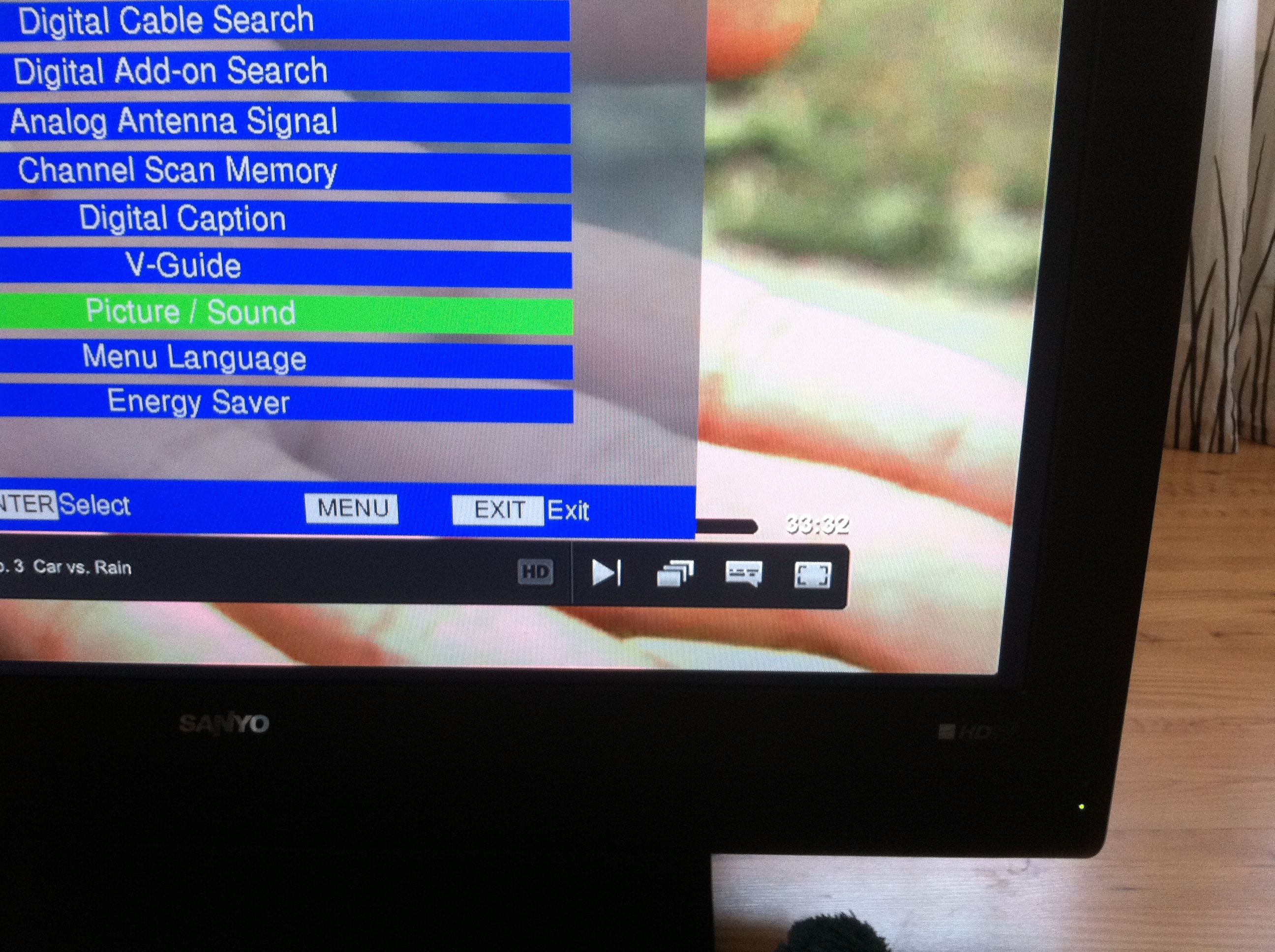

              I should also add that the menu and the "no signal" box look perfect, even when the issues with the picture are appearing.

                  If the menu is good, it can't be the t-con.

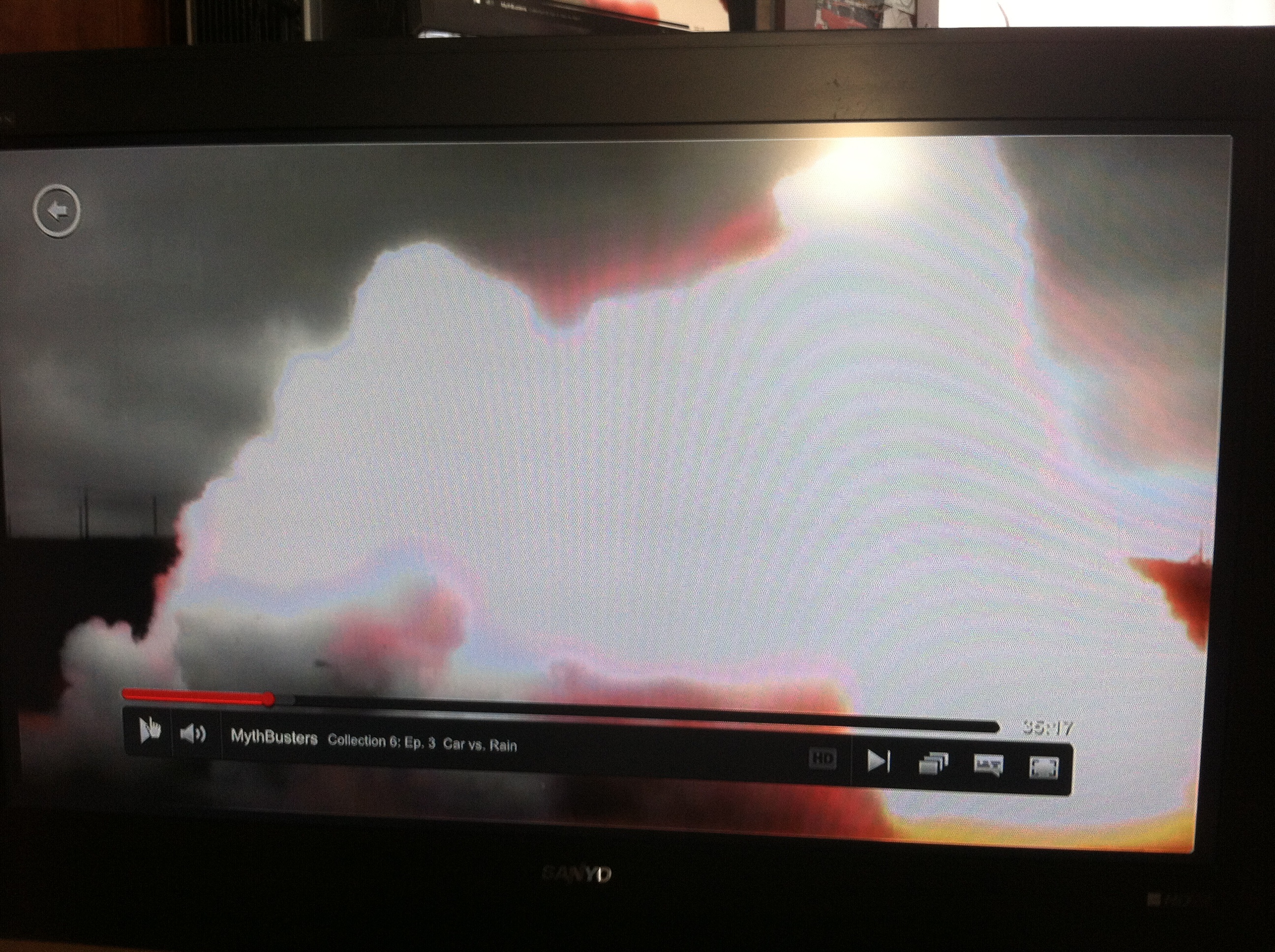

                        I might have gotten a descent picture. Here a shot of the tv. The computer monitor does not show the pink tinted areas. In real life, it's almost like the man's hand is glowing pink in some areas. This is via HDMI by the way.
                          Re: Sanyo DP42647, Sparklies, off colors, occasional ghosting.
                          I suspect an incorrect t-con setting, or one of the user controls.

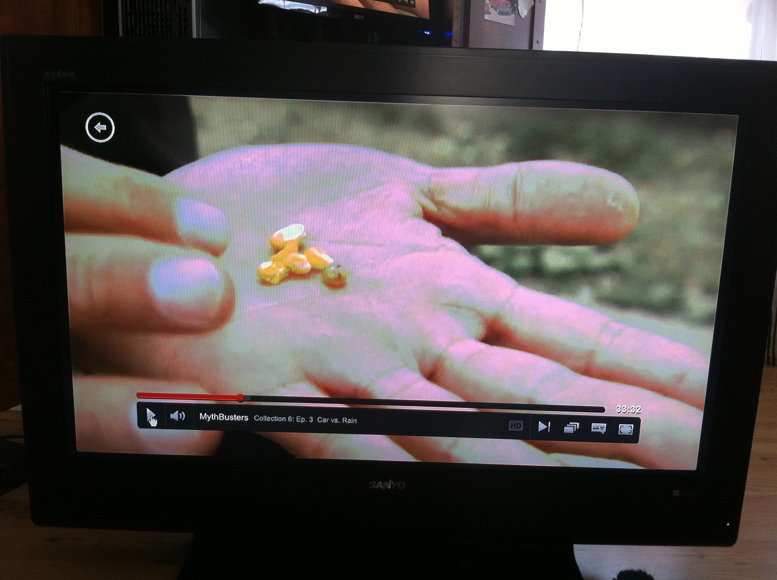

                            Another shot. The bright area get really washed out.
                              I had that effect before. I just turned down the brightness and contrast. Some software/eeprom corruption occurred which screwed up the high brightness peaks. I know it's not a permanent solution but it worked for me.

                                With the menu on.

                                  Well, I took your advice. With the contrast down all the way and the brightness up high, I get a pretty decent picture. Thanks.
