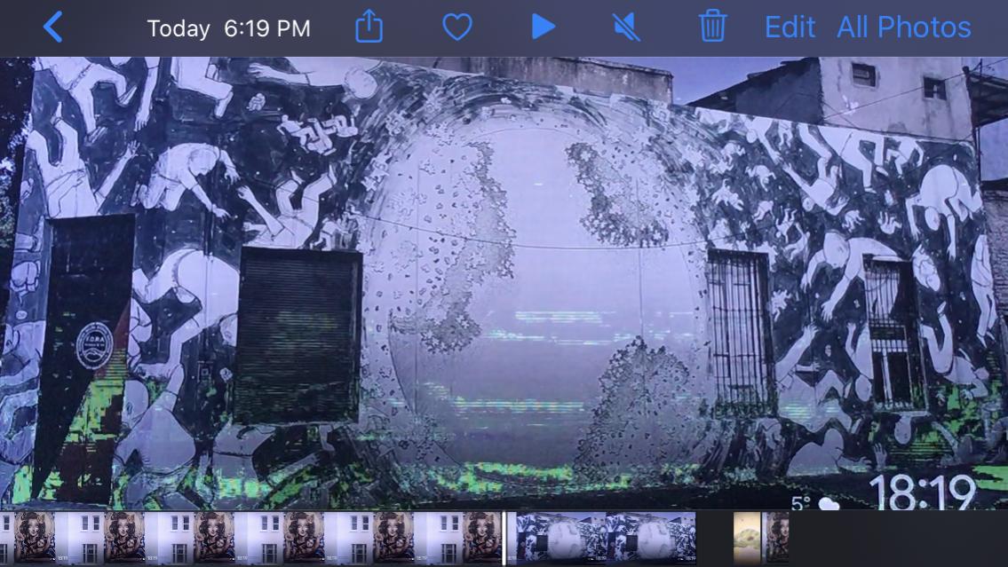

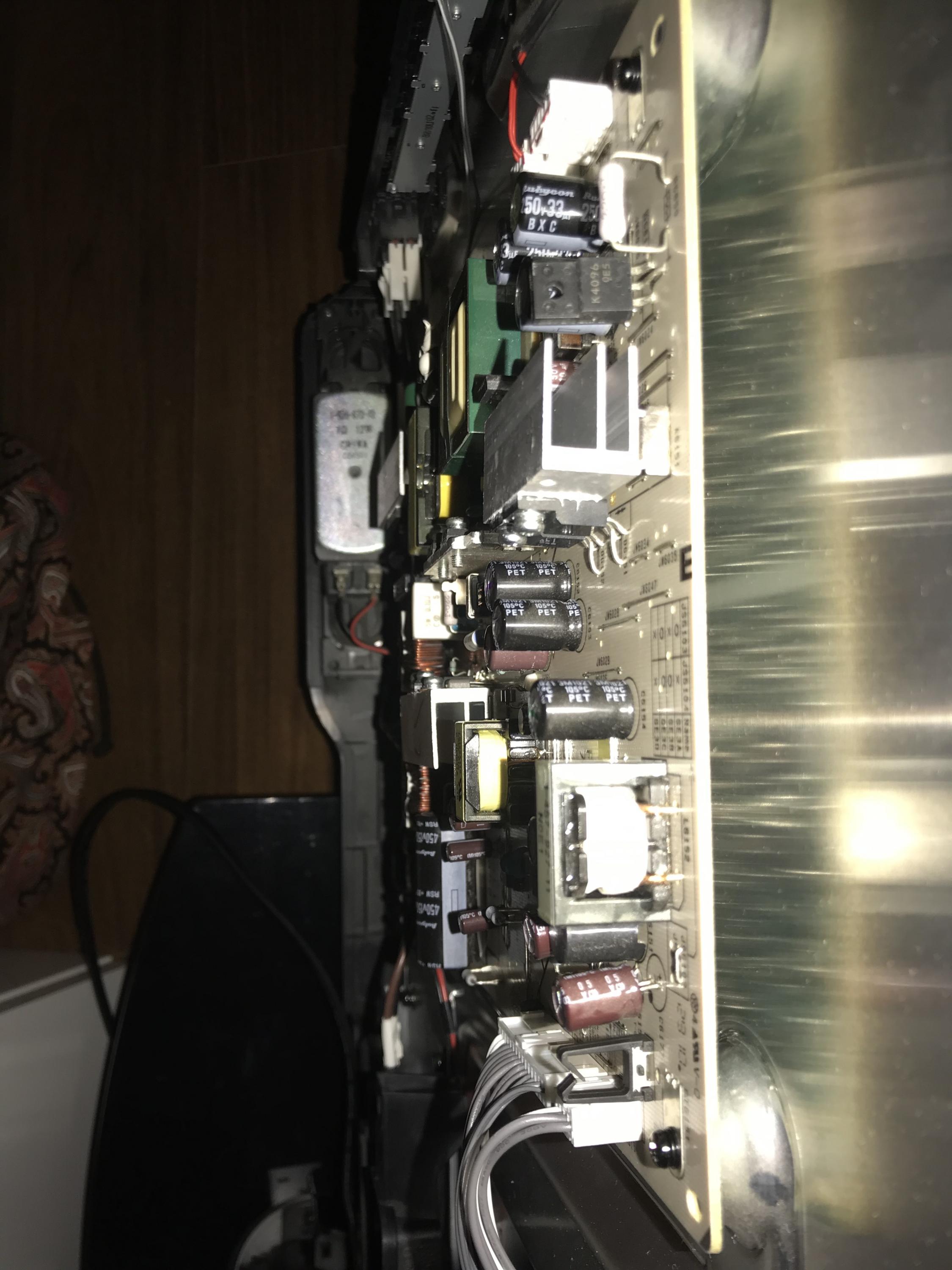

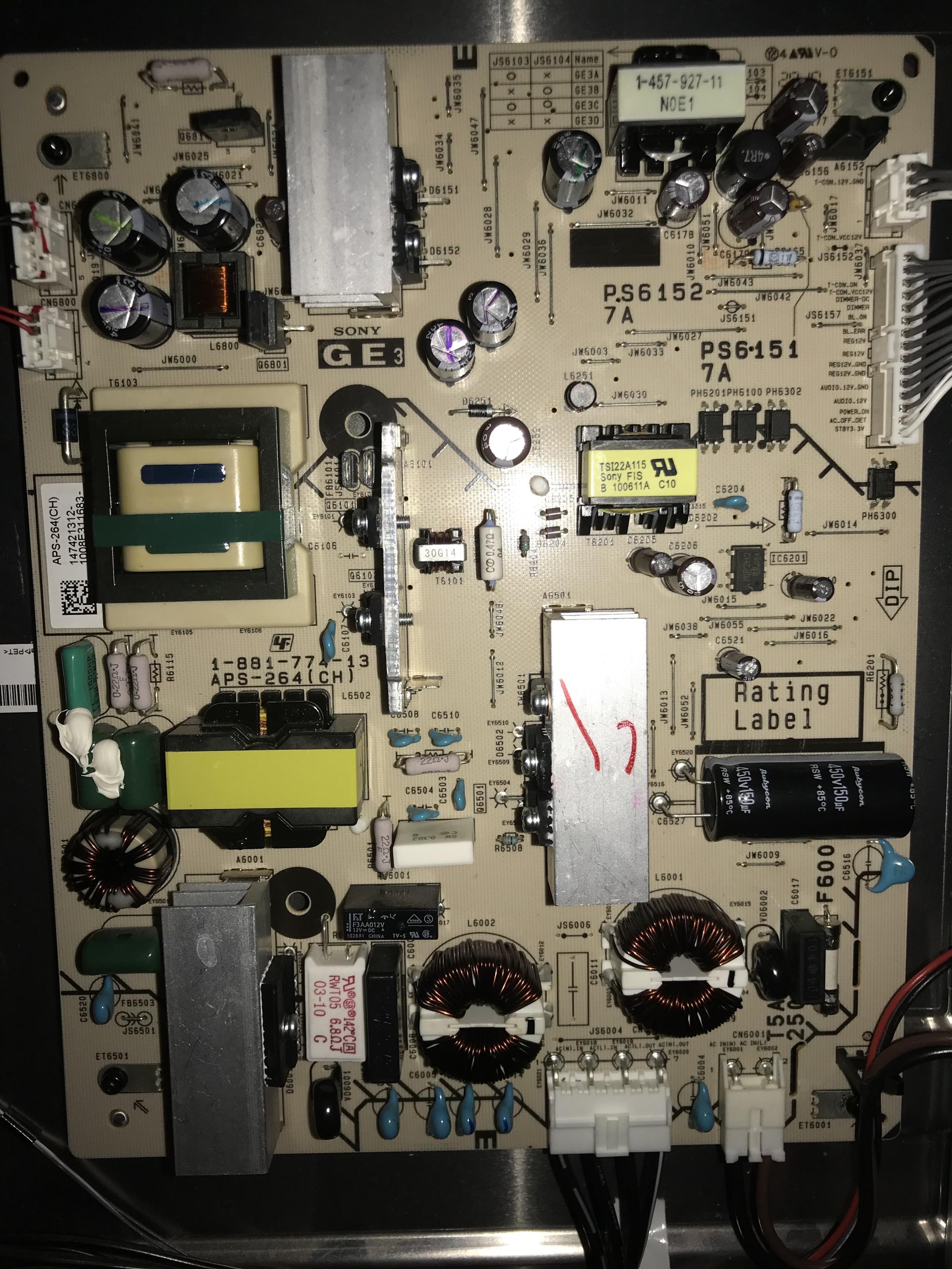

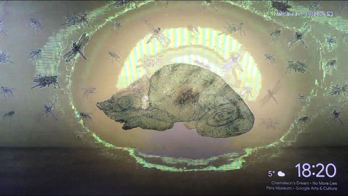

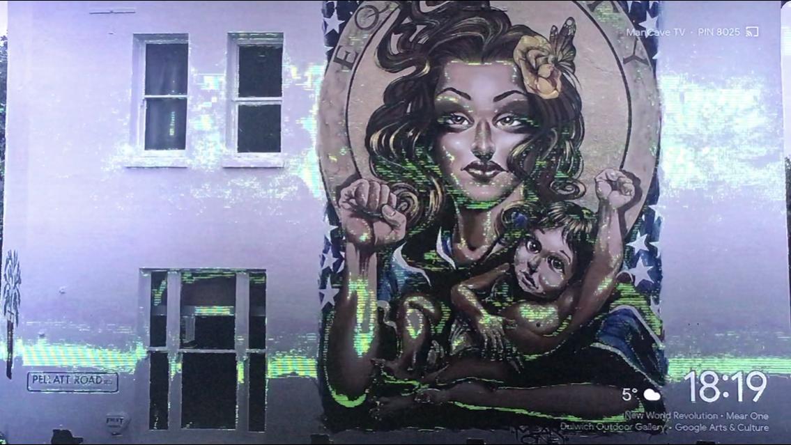

    Sony KDL-46EX710 Occasional "green ghosting" on picture
    The KDL 46 LCD has occasional green overlaying the picture. It seems as to happen less often if I control the picture settings to display less brightness, picture, backlight, etc...
    It often will flash green for a moment, with the pic still visible in behind and then flash off quickly. I have looked at the caps on the power board and none of them have popped. I have also tried changing the Control Board (t460hw04 V5) with a new one and still no luck. I have also swapped the ribbon cables from the ctrl bd to the lcd and no change. Im thinking of replacing all the caps or maybe ordering a new power board. Wondering if anyone has experienced this issue and if it sounds like a power board bad cap issue.
