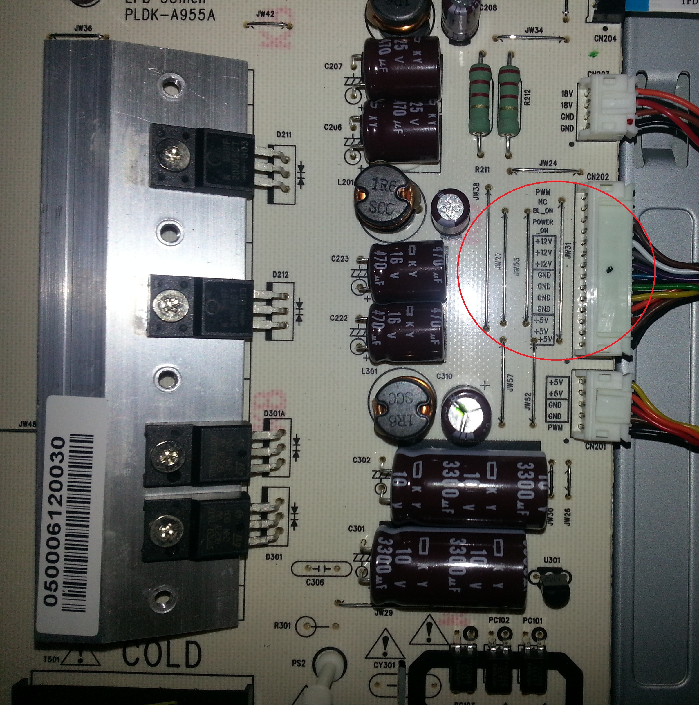

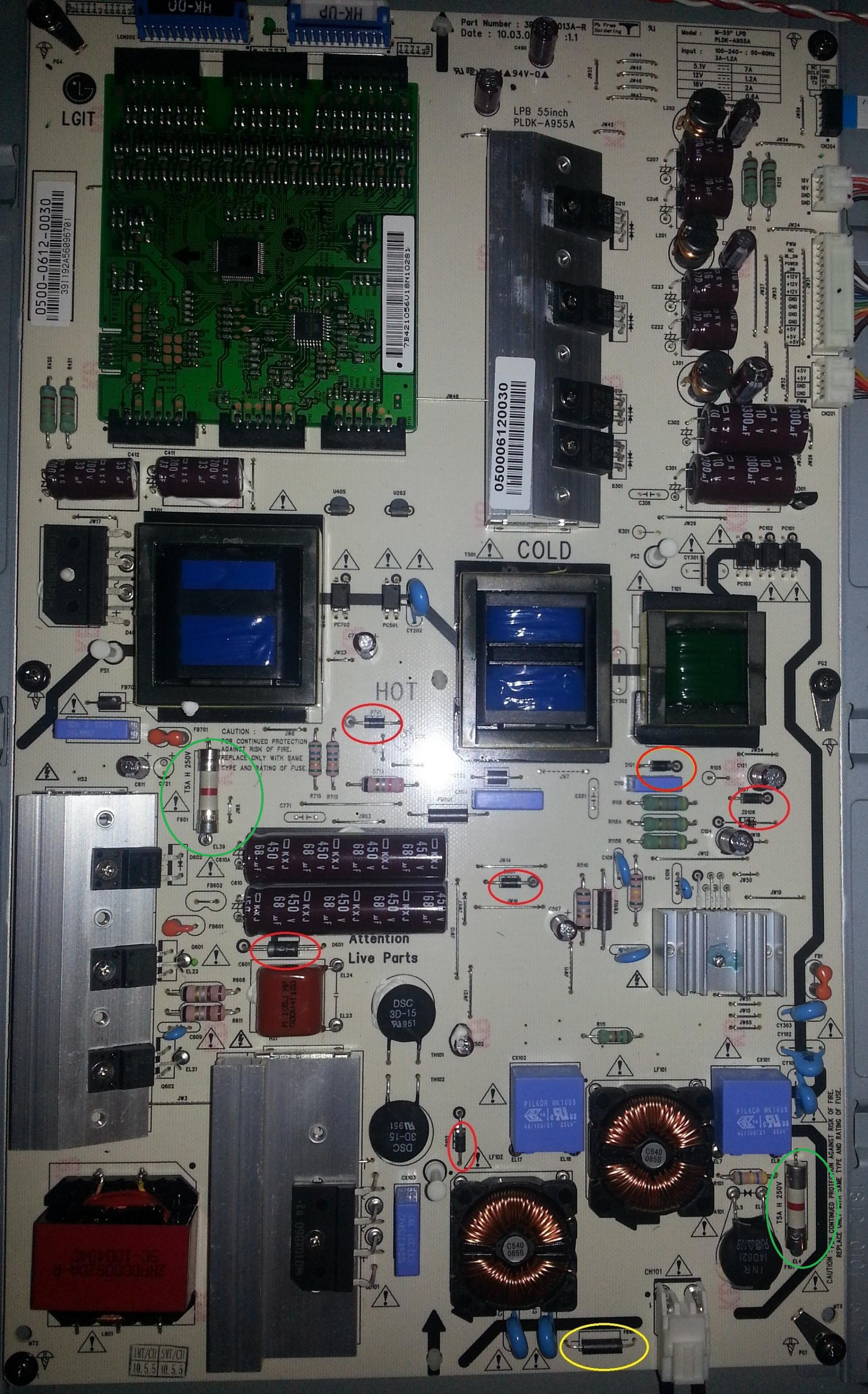

    I have a 55" vizio that when I connect it to the wall outlet, the vizio orange light flashes a lot of times and after a while it stays orange, I turn it on and the orange light turns to white but with no picture or sound. the whole screen is black.
    I opened the tv and got the following readings once the tv was on (white vizio light) on the power supply board where I have placed the red circle on the picture.
    from the bottom up
    1.86v supposed to be 12v
    3.22v supposed to be 12v
    3.32v supposed to be ?
    Is this normal? I hope I am making sense and I am sorry for the poor pictures but its night time.

    you should try to get a closer up picture of the power supply.

      Here is the close up

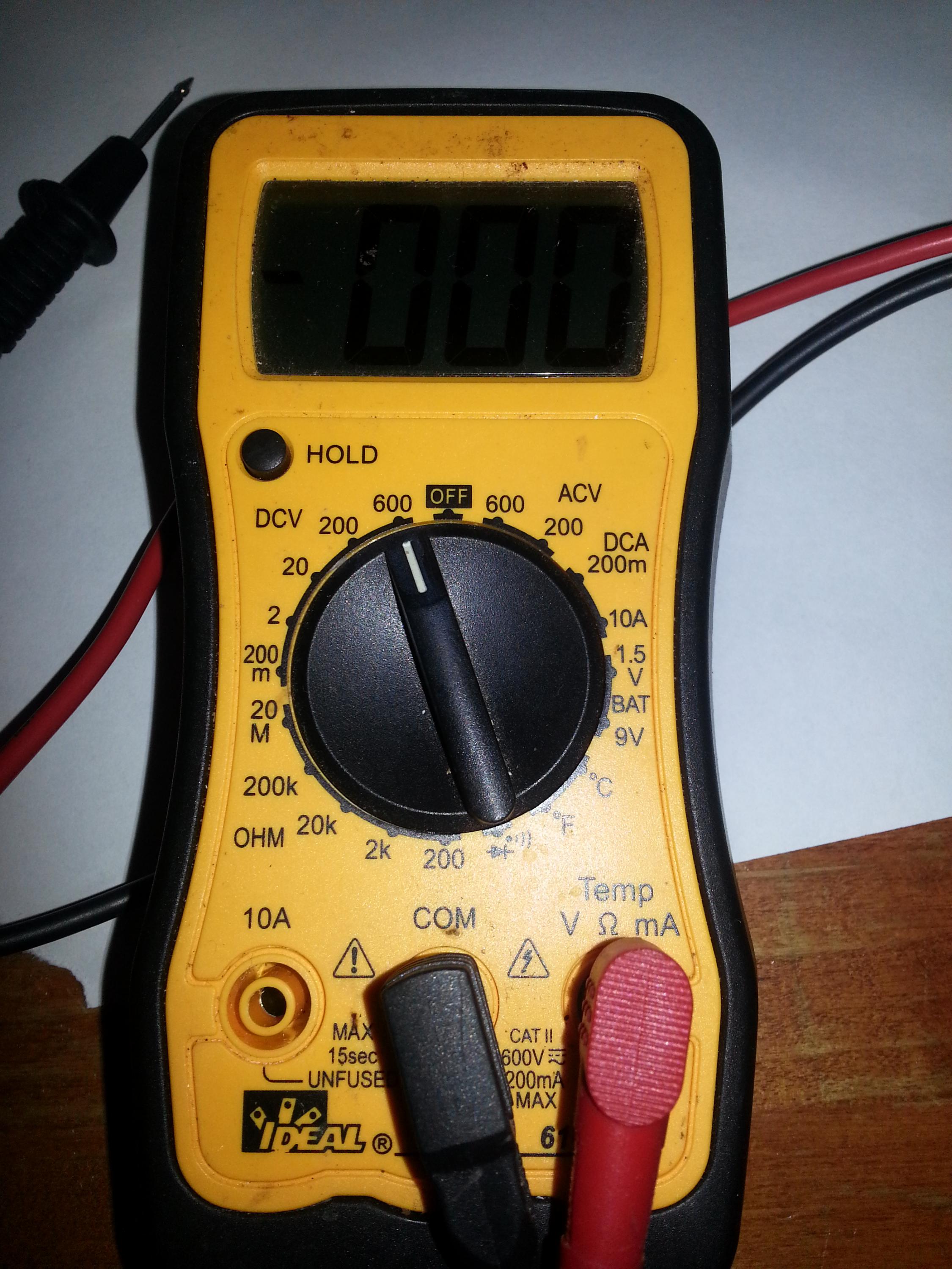

        Just to make sure....is the meter set to DC and the correct range (if not autoranging)? Battery Good?

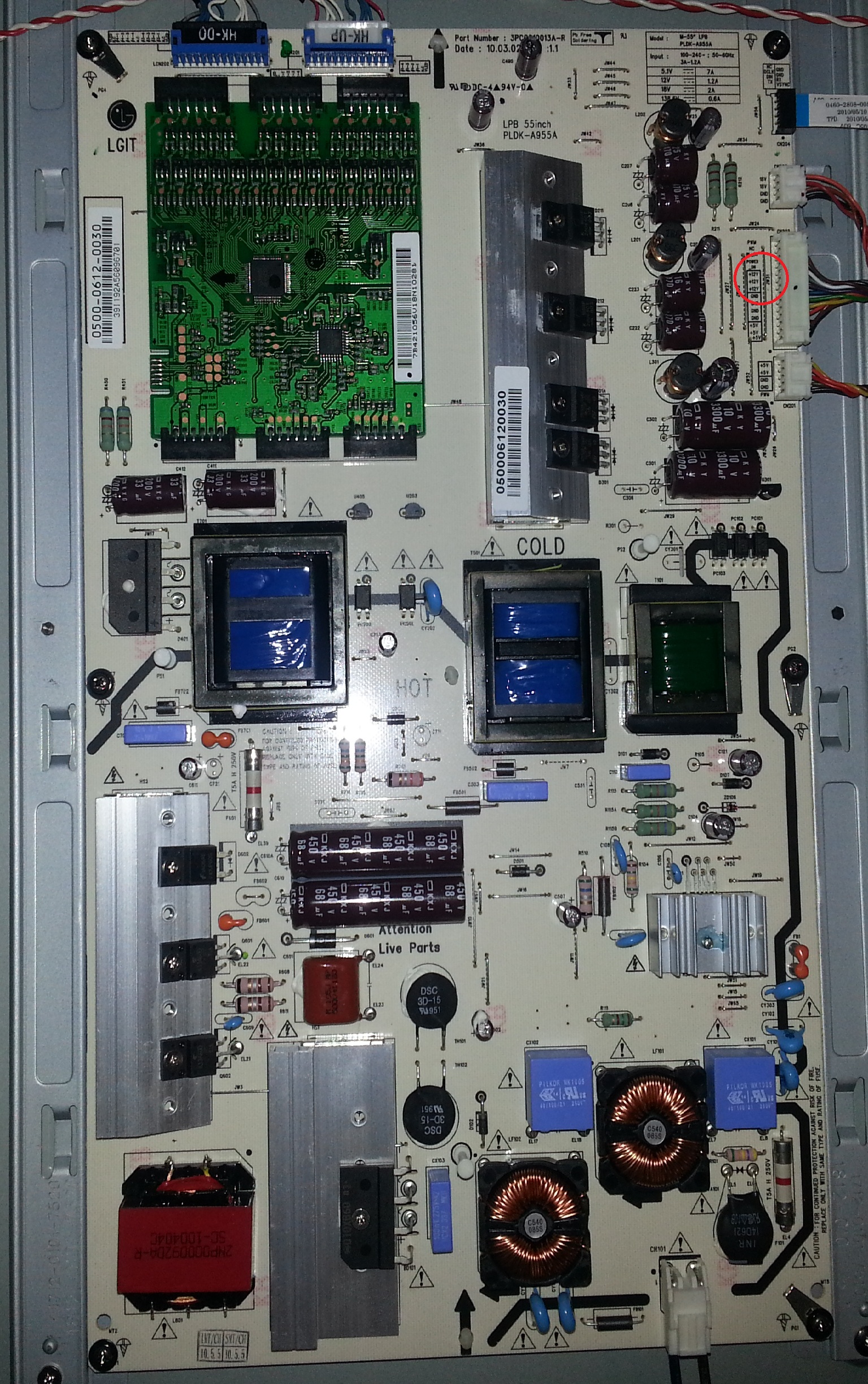

        Well with the tv on (white light) what voltage do you get on those central 450v caps? (Probe on each leg)

          Yes the meter is set to dc and the correct range.
          I replaced the battery last week with a brand new one.
          Is it safe to test them? the 450v caps?
          And I imagine the setting on the meter needs to be on 600v right?
          Also, does it matter which probe goes to what leg?

            It is ok to test them but DO NOT short the legs of the capacitor while ON or on standby.
            Yes 600v is what you use.
            No it doesn't necessarily matter about probe placement - if it is backwards then the voltage reading will just show a negative sign.
            Measure while on standby and then again while it is ON.

              Okay here are the readings:
              the bottom one on standby 168v while it's on 396v
              the top one on standby 168v while it's on 396v
              What do you think?

                  That looks good and pictures are actually OK.
                  I find it very odd that the 12v rail showed 2 different readings since those 3 wires are connected to the same source. What are you using as your ground? Using 20 on your meter, correct?

                      The 450v caps look fine.
                      Are the screws coated? They can mess with readings sometimes (well in my experience).
                      Use the frame itself or GND on the harness and re-list the voltages with respect to the legend.
                      CN51
                      Pin1 - 5v - 4.96v
                      ..and etc. for when the power is on.

                                  To rule out the power supply give us the voltage readings.
                                  • Salvamex
                                    • Nov 2012
                                    • 48
                                    Re: Vizio m550nv
                                    Voltage readings of which component?
                                    the one in the bottom it's all black with no marks on it (yellow circle), if it's a fuse it checks out fine. I tested both fuses (green circles)and they are okay .000 on continuity test and my multimeter beeps same as the one in yellow circle. I tested all 6 diodes I can identify (red cricles) and they all check out okay but I have not tested the bridge and the opto-isolators because I don't know how.
                                    I checked all diodes and on the cathode side I get a reading of .480 and when I switch the probes on the on the other end I get 0 reading.
                                    The only diode I get .465 is the one under the 450 caps.
                                    So it means that they are working because the current is only flowing one way on all 6 of them right?
                                      Re: Vizio m550nv
                                      OK, on the picture in post 3 the closed up pictures of the connector CN202:
                                      The CN202 has 14 pins, so lets make the top pin #14
                                      Please take the DC voltage readings of these pins:
                                      14 (PWM) = xxVDC
                                      13 (N.C.) not connected
                                      12 (BL_ON: Backlights ON, >3VDC = ON) = xxVDC
                                      11 (PWR_0N: power on >3VDC = ON, the voltage on that 450Vdc cap will go from 170VDC to around 390Vdc due to PFC Voltage booster kicks on which you have already verified) = xxVDC
                                      10~8 (12VDC power supply) = xxVDC
                                      7~4 (Ground) = 0VDC
                                      3~1 (5V standby) = xxVDC

                                        okay here we go:
                                        14 (PWM) = .84v
                                        12 (BL_ON: Backlights ON, >3VDC = ON) = 3.3v
                                        11 (PWR_0N: power on >3VDC =3.2v
                                        ON, the voltage on that 450Vdc cap will go from 170VDC to around 390Vdc due to PFC Voltage booster kicks on which you have already verified) = 397v both caps
                                        10~8 (12VDC power supply) = 1.81v
                                        7~4 (Ground) = 0VDC
                                        3~1 (5V standby) = 5.13v
