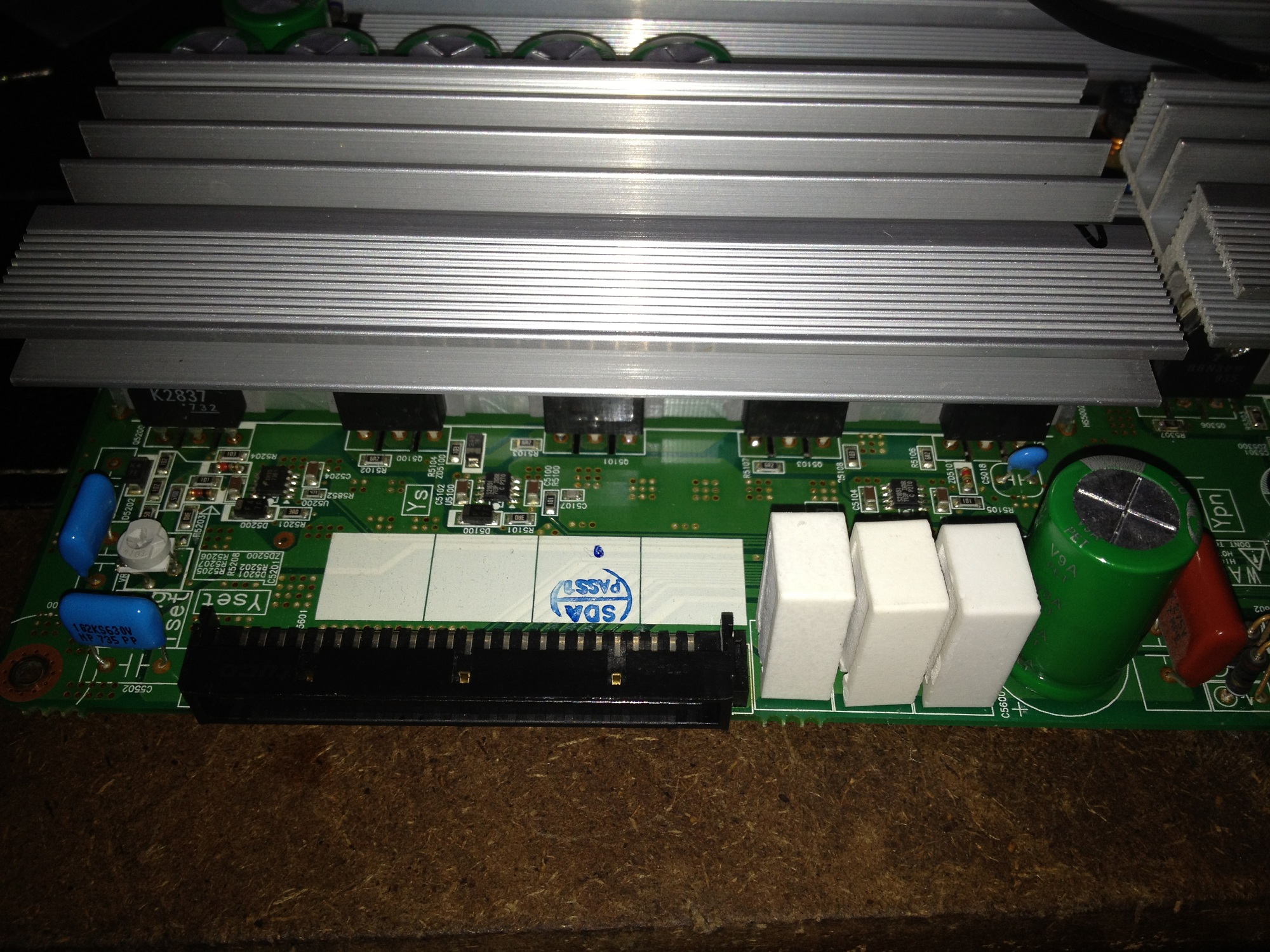

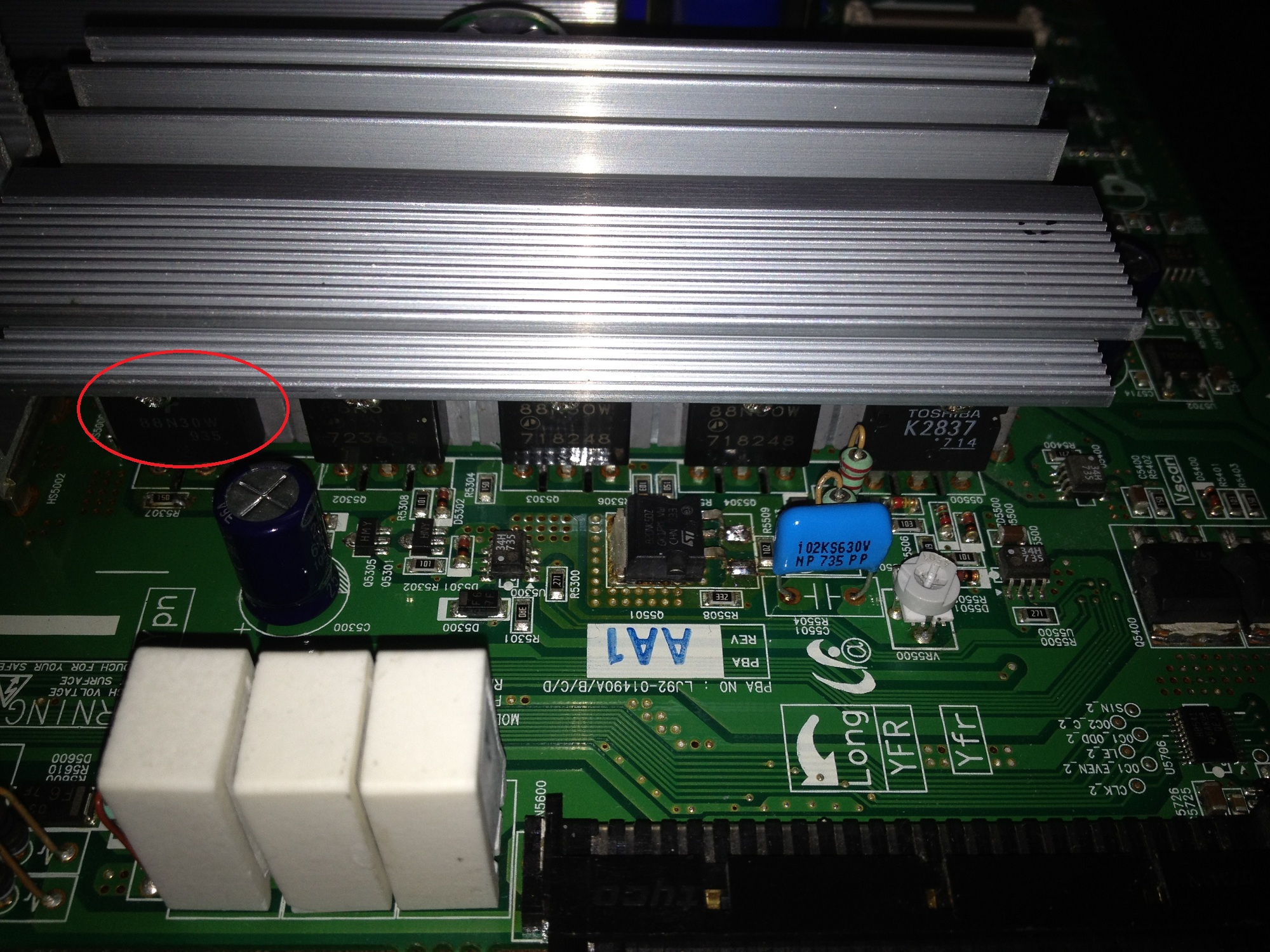

Theres only two fuses I found on the Ymain, a green pico fuse and the glass one but they check out good. Doesn't seem to be any near the Yfr/Yrr adjusters. I was searching on the manual I found F5005 there and i think the fuses you're talking about was for the 42" plasma ymain instead?
