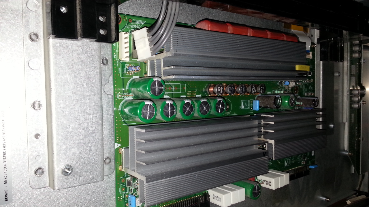

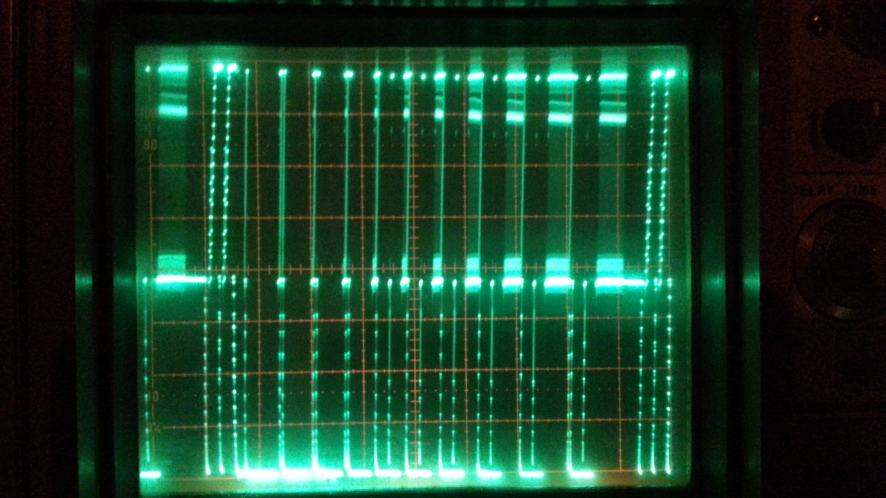

                #187
                Re: Samsung 50" Plasma HPT5044 No Picture
                Ok tom, messed around some more. You were right about having a dead ysus. See pic 1 for some insight into what I found when I went back in.
                Lol
                I think I managed to get a good shot. It seems to match up pretty well with the one in the SM. 2mSec and 50v/div so about +200v to -200v
                What you think ?
                  #188
                  Done it myself plenty of times! Your Yset ramp looks clipped (beginning of the field), it should peak a little higher; can you try changing V/div on your scope up one notch to make sure it's not an artefact of the scope. Poor Yset won't kill buffers but the image will look poor.
                    I tried already, can't seem to crunch it down any.
                    5v x 10x probe = 50v/div, right ? There is a "5x magnification" by pulling the CAL knob out so..
                    2v x 5x mag x 10x probe = 100v/div ? That should offer plenty of resolution for Yset.
                    Will try it again later.

                        My scope is rated at 275v. The Yset voltage looks like it could be approaching 300v. Would that clip the Yset spike and explain what I see in my image ?
                        The bottom of the waveform looks different as well...
                        • mmartell
                          • Oct 2013
                          • 3189
                          #192
                          Ok the scope is rated at 250v, not 275v. And the magnification function is just that. So now I need a little help on working the scope.
                          The highest setting is 5v/div. I ASSUME the x10 probe gives me a max resolution of 50v/div. The grid in the Y axis is 8 high so 400v total. If I try to view the whole waveform (ground at middle of the screen) I clip whatever goes beyond that, Yset being one.
                          Is it possible to focus on say just the positive side of the waveform such that ground being at the bottom of the display I can view up to a theoretical +400v and thus capture the entire top of the wave ?

                                      The number on your scope is the safe working limit. Your scope should be able to show a full waveform including offsets about 2 x from the maximum 1X input. e.g. at 5V/div, it should be able to read ±40V from centre by moving offset. A 10X will change this to ±400V which is sufficient for capturing VSET, so I suspect you do still have a problem with the Y-main.
                                      • mmartell
                                        • Oct 2013
                                        • 3189
                                        #199
                                        I'm sorry tom but what is an offset and how do I adjust it ? When looking at my captured waveform it looks like the scope has hit a hard limit at both the top and bottom of the form.
                                          #200
                                          On your scope, you have a V OFFSET control, or V POS, right? Adjust that.
