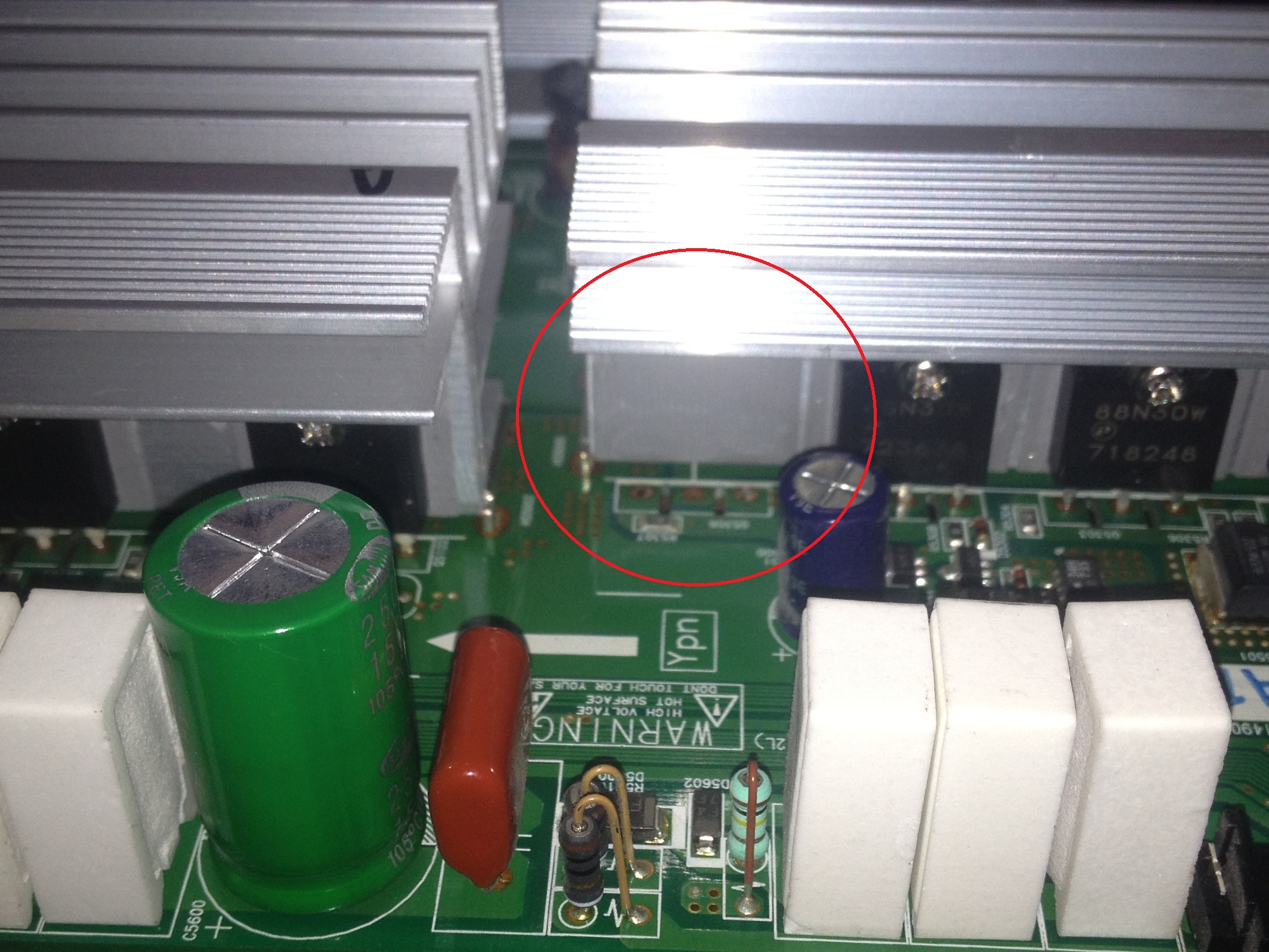

          I did the same- Mosfet right below the AA1 burned (b20nk50z) is that common?
          • tieny
            • Feb 2012
            • 478
            Re: Samsung 50" Plasma HPT5044 No Picture
            How did you check it? Is it the mosfet under the bottom left heatsink?
            • tieny
              • Feb 2012
              • 478
              Wait isn't that a voltage regulator?

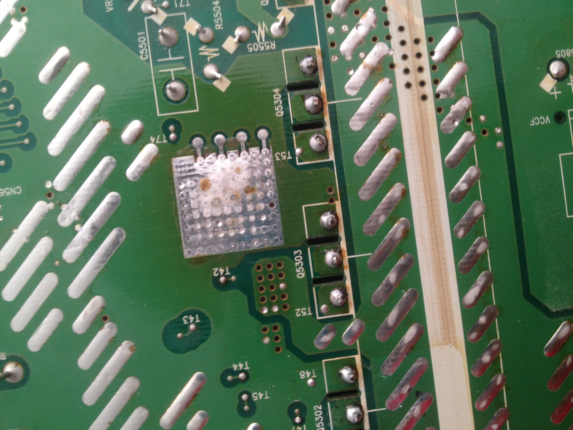

              The one on mine doesn't seem to look burned, but the bottom of the board where its solder kind of look odd.
              • dsnyder586
                • Dec 2012
                • 39
                LOL There is a HOLE in the top of it. Plus it sparked a little. Yes, it is below (not attached) the bottom left heatsink on the board. I unplugged the upper ybuffer, left the low one plugged in and it stayed on with no further exciting moments. It was buzzing pretty well beforehand so I wonder if it was about to go and took the upper Ybuffer IC with it? Or vice versa? I ordered an upper buffer and will send in my Ysus to get repaired- I just want to make sure That's all that is needed so I don't blow any of my new parts!

                  Not a regulator, but same case package as one.

                    Yep, same same. The bottom of my board also looked like it had some heat issues, and the Ysus was buzzing- then when I removed the IC from the ybuffer and plugged it all back in it smelled and the went sparky sparky at this component.

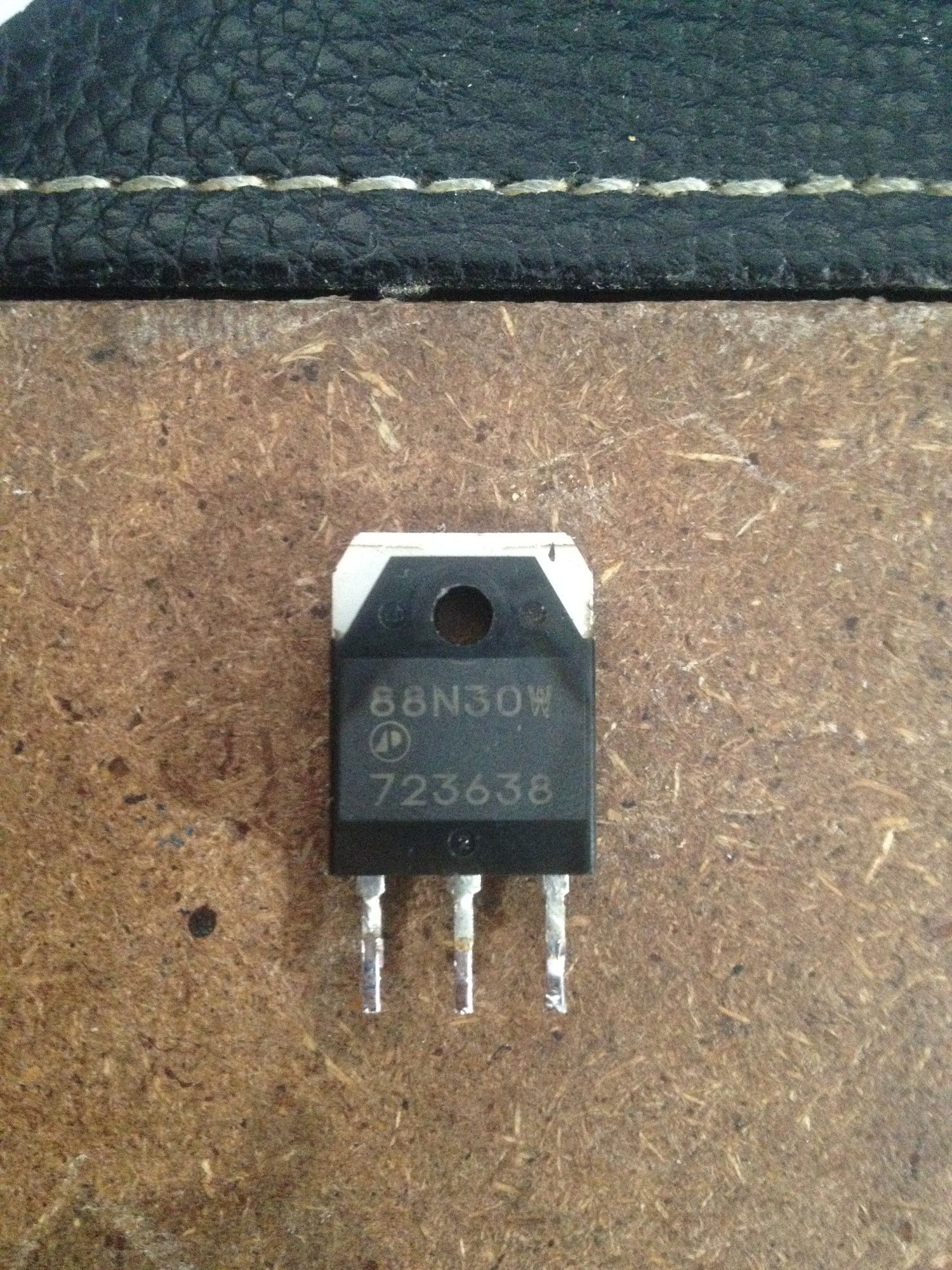

                              Alright so I decided to test the other mosfets and I think I found a shorted one. 88N30W 723638, it was located under the bottom left heatsink.
                              Pins:
                              1-2: 17 ohms
                              1-3: 17 ohms
                              2-3: 1.0 ohms
                              I looked up the SMD component (b20nk50z) Its a 17A 500V MOSFET. I found some on ebay.
                              Trying to find a way to desolder it and test if its shorted or not.
                              Until then I'm gonna test all the mosfets under the right heatsink.
                                #35
                                Those readings look bad to me. It has a drain-source short (1 ohm is likely dead zero but you meter has lead resistance) and gate-source / gate-drain leakages.

                                  How do you find a replacement for this MOSFET? I found some on eBay "88N30W" but the bottom label is different. Do the bottom numbers mean anything?
                                    #37
                                    All that's important is 88N30W.
                                    The bottom numbers are a date code/manufacturing lot code etc.
                                    723 would possibly imply week 23 of 2007.

                                      Found this one on ebay I'm probably getting.
                                      http://www.ebay.com/itm/2pcs-88N30W-...item19d5f78ebe
                                      I checked all the other mosfets and they seem okay. (havent checked the smd fet yet, can't find a way to measure it out of circuit but it seems okay hopefully)
                                      I'll probably order and replace the mosfet. And hook the ysus with only the upper buffer again and hopefully some picture shows. Then i'll just send the buffer boards to be repaired.
