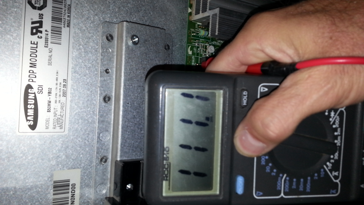

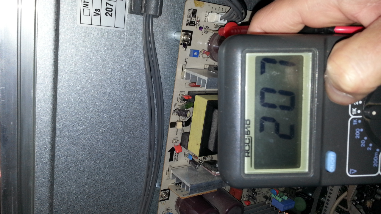

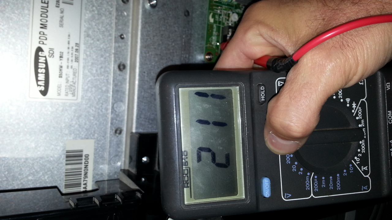

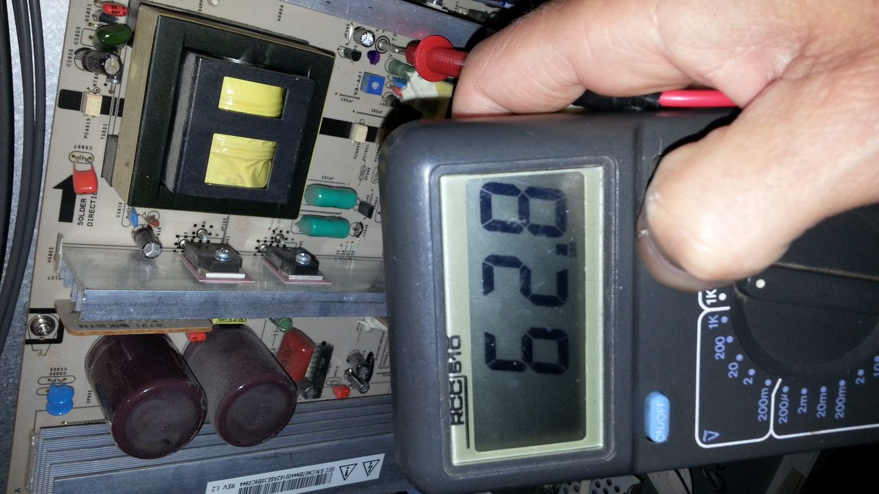

                                #235
                                Re: Samsung 50" Plasma HPT5044 No Picture
                                First two pics are Vs and Va on the ps with no x or y mains connected. Bang on at 207v and 63v.
                                Second two are of Vs and Ve on the xmain with control ribbon unplugged.
                                Next two are Vs and Ve on xmain with control ribbon plugged in. I forgot the Control board was in test mode.
                                Last two are of Vs and Ve on xmain with Control board in regular mode.
                                Both voltages climbed beyond what is pictured before I shut it off.
                                Wtf is going on ?

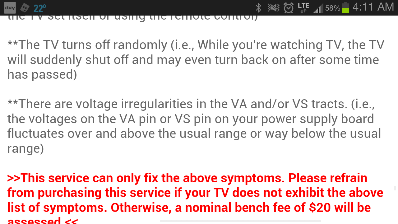

                                      There is a small repair kit available for these boards which fixes known VA and VS tract problems. I didn't think it applied to my situation but then I read this... so maybe ?
                                        #239
                                        Originally posted by mmartell
                                        I've only been testing with ymain out. Voltage only rises with control board ribbon plugged to xmain (or ymain before I took it out).
                                        That is for the cold joints problem which causes Vs/Va to bounce up and down... but not slowly rise.
