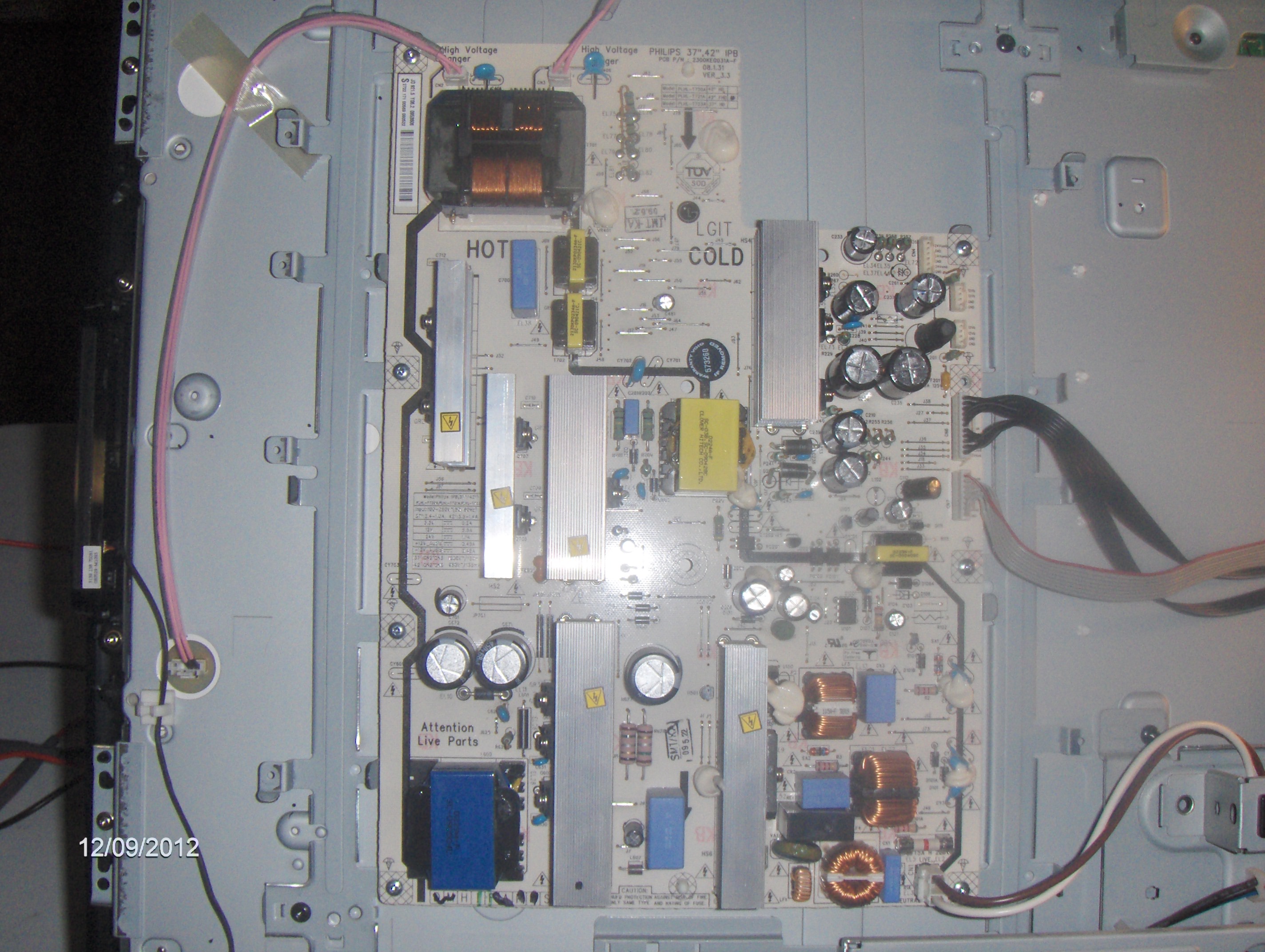

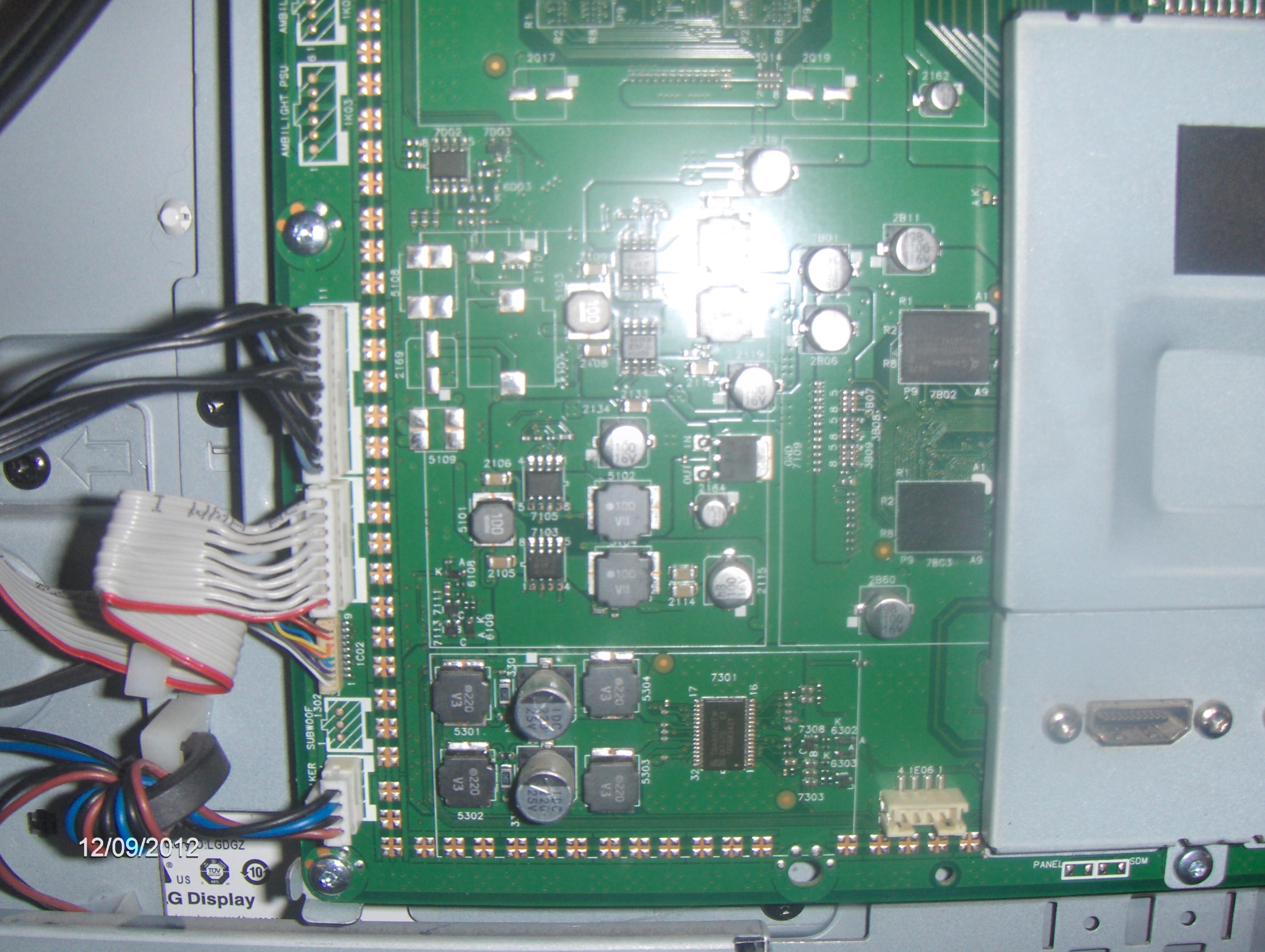

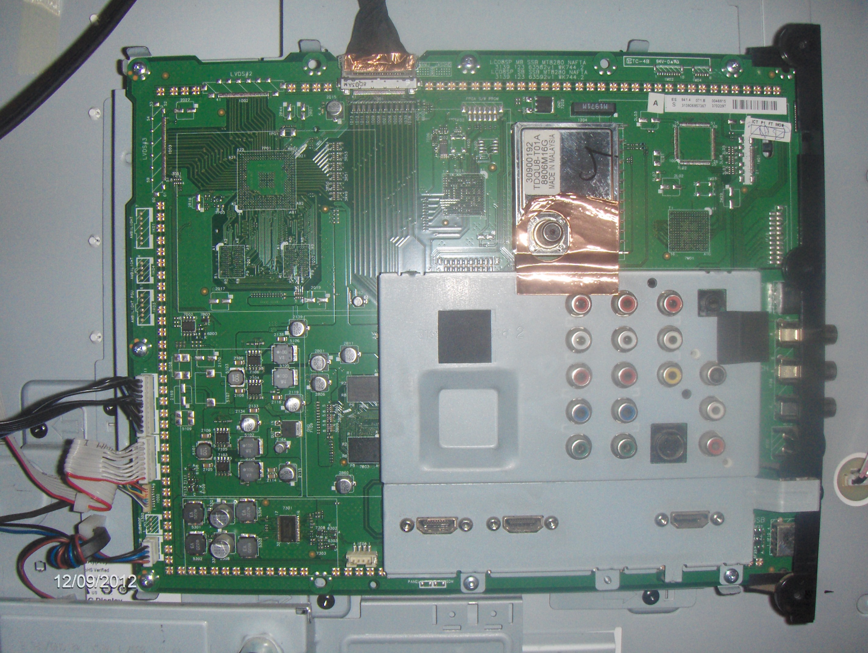

    Magnavox model 42MF438B/F7, Power board 272217100569 and
    main board 313926857366. It came in totally dead so I replaced the power board. Set powered on and great picture but no sound. So I replaced the main board, still no sound. Is there a magic setting I am missing for the sound. The sound adjustment shows on the screen when I adjust it. Speakers test good, no sound on any input. Any ideas??

                    Pictures are not much use for troubleshooting - can you do better, and close ups of audio related parts.
