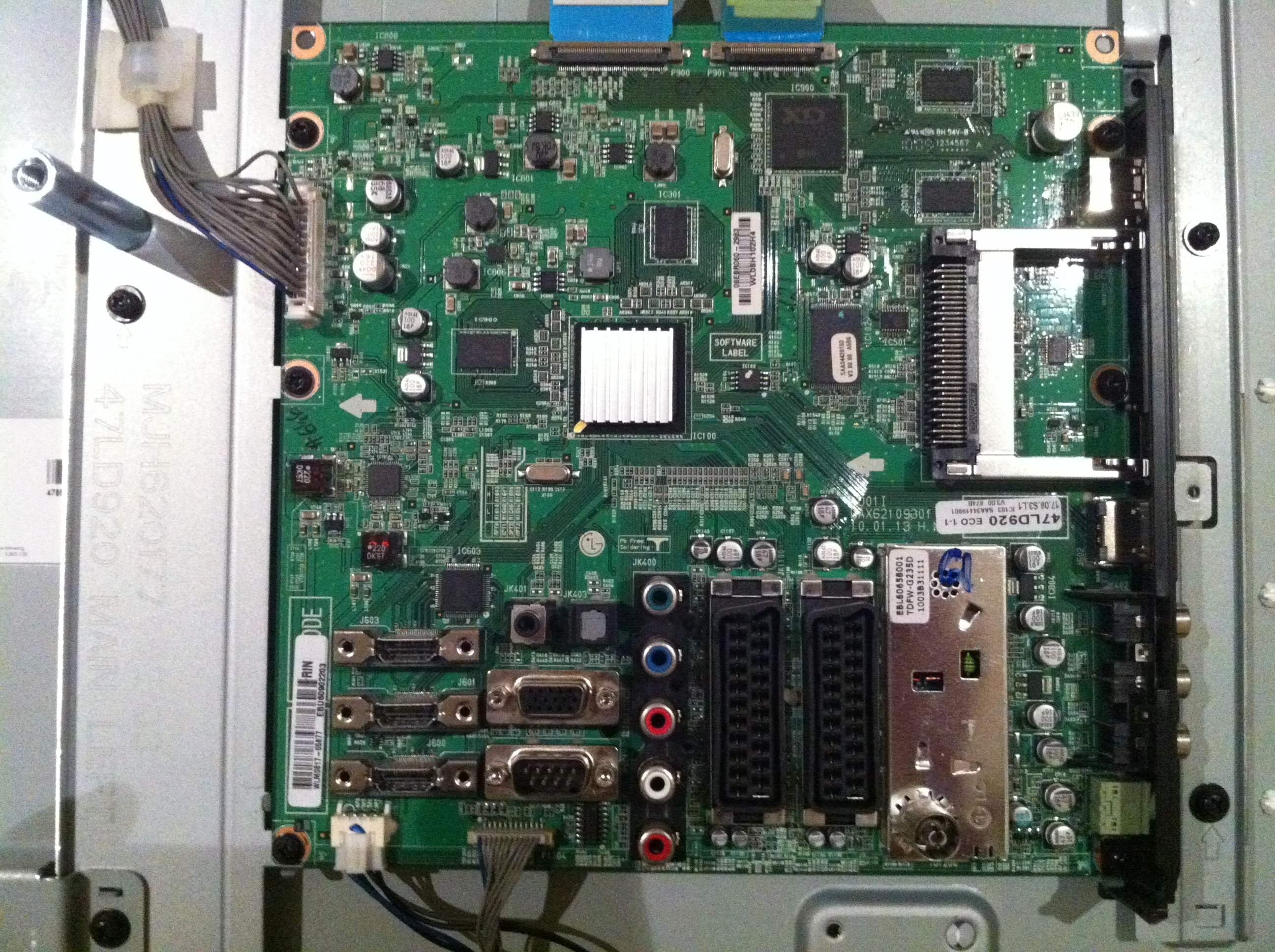

    Hello, good to be here. Thanks for having me!
    I'm a TV repair novice with IT support skills, and some experience in building PCs. Unfortunately I don't own any specific TV testing equipment, but I can probably do some constructive damage with the right assistance.
    It is urgent that I get my TV working again asap, so I'm resigned to throwing some money at the problem. I have to spend Christmas alone this year, I can't afford the TV to pack up, mid Bond film!!
    The set is two years old, but I acquired it in full working order 2 months ago. A few days ago it developed the following intermittent fault:
    The output turns black (backlight stays on) for a split second, before returning to normal picture.
    -The blink only occurs during certain bright or 'pixel busy' scenes.
    (Interestingly, when I pause on a frame which is causing a blink, the duration between blackouts are precisely the same. On one occasion, every 13.9 seconds. Another time, every 3.9s. Another, every 8.0s.)
    -Turning the backlight/brightness down will stop the blink
    -Occurs on all sources - HDMI, USB, RF
    -No break in audio, or loss of any other functionality

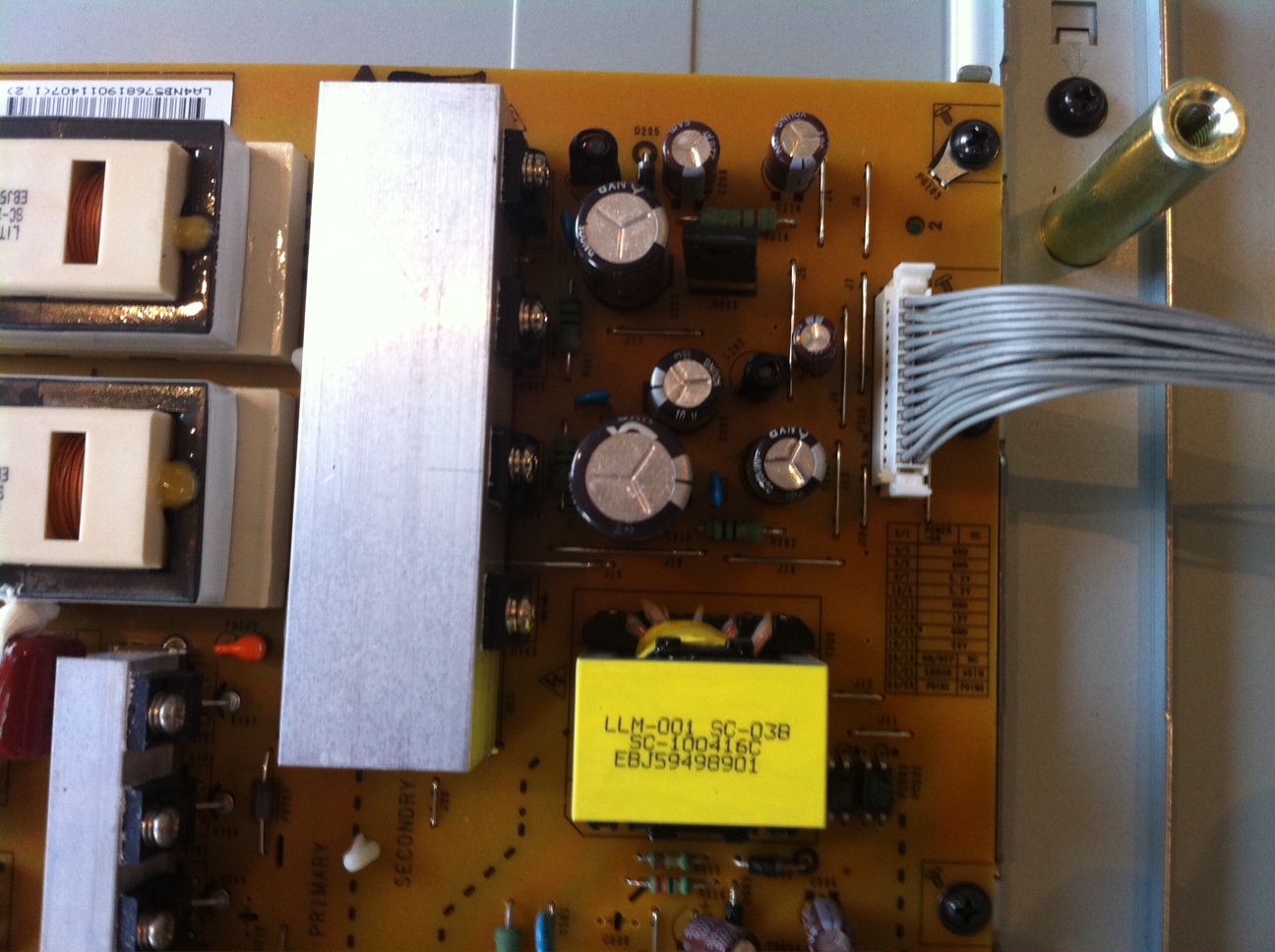

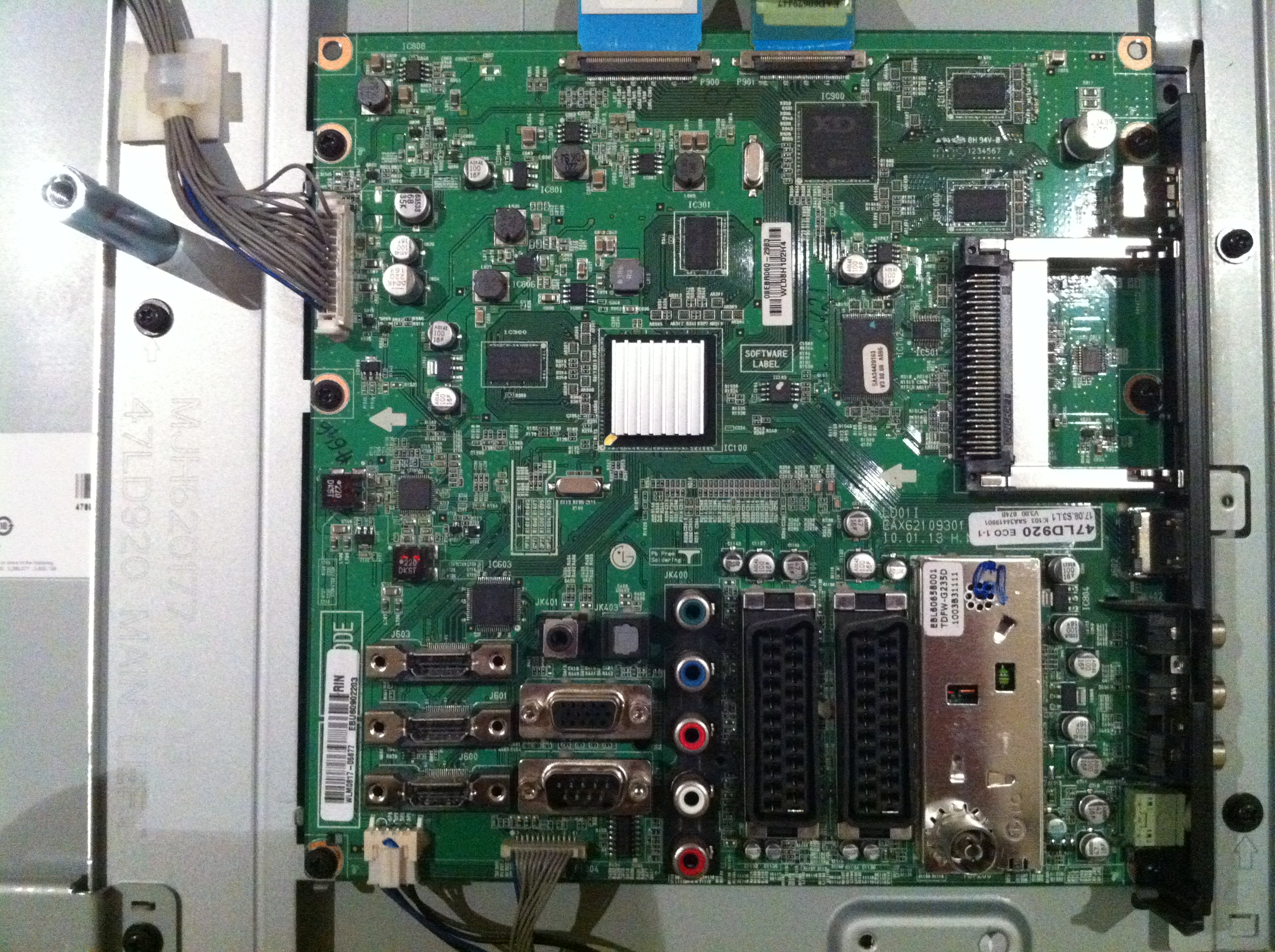

    I carefully removed the rear panel and had a look.
    -No bulging/leaking capacitors on power board
    -No visible damage on any boards
    -No loose connections. (I carefully dis/reconnected all)
    Photos provided were taken before I registered, for my own reference. I don't have a pic of the entire chassis, but at the time I took pics of all four visible boards. If you would like higher quality pics I will happily dismantle and take some more.
    Is the AV board the most likely culprit, as someone else advised?
    If so, I would really appreciate knowing where I could find the rare replacement. EMOS are checking, can't find any on eBay.
    If not, which part should I try to replace first?
    Can't tell you how helpful your input is, guys. Thank you in advance.

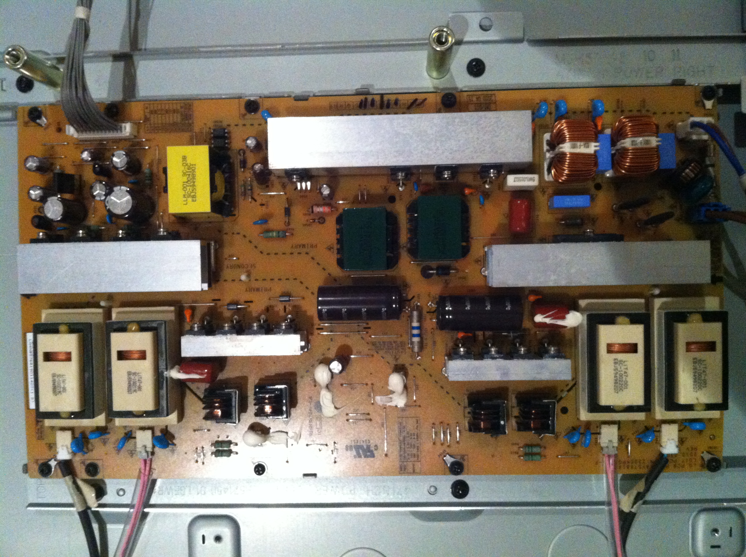

    Re: LG 47LD920 Display (not backlight) blinks off every 8 seconds during brighter sce
    I wouldn't immediately suspect the main/AV board. Those two primary (400V) capacitors can cause this problem. Though they usually cause backlight blinking...

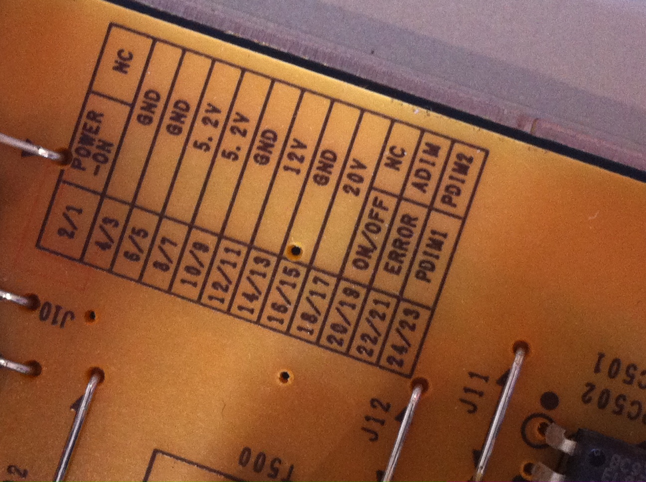

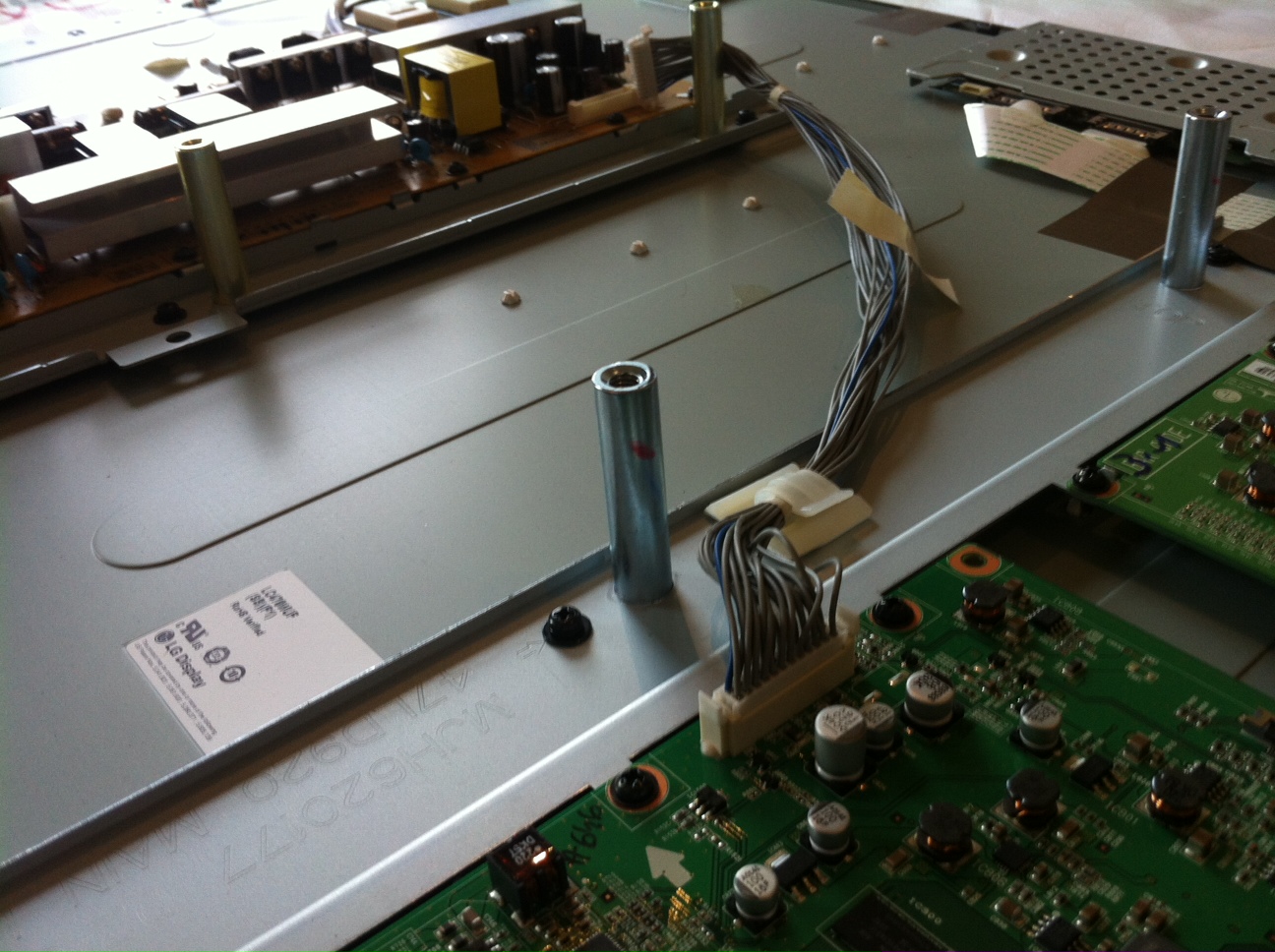

                  Can you list the pin-out on the connector going to the main board from the PSU, it is labelled next to it.
                  • Stimpers
                    • Dec 2012
                    • 37
                    Sure thing:
                    2/1 :: Power-on :: NC
                    4/3 :: GND
                    6/5 :: GND
                    8/7 :: 5.2V
                    10/9 :: 5.2V
                    12/11 :: GND
                    14/13 :: 12V
                    16/15 :: GND
                    18/17 :: 20V
                    20/19 :: ON/OFF :: NC
                    22/21 :: ERROR :: ADIM
                    24/23 :: PDIM1 :: PDIM2
                    TV prepped for further poking around.
                    Haven't used a DMM before, so advice welcome on how to test voltages etc- I'll research in the meantime.

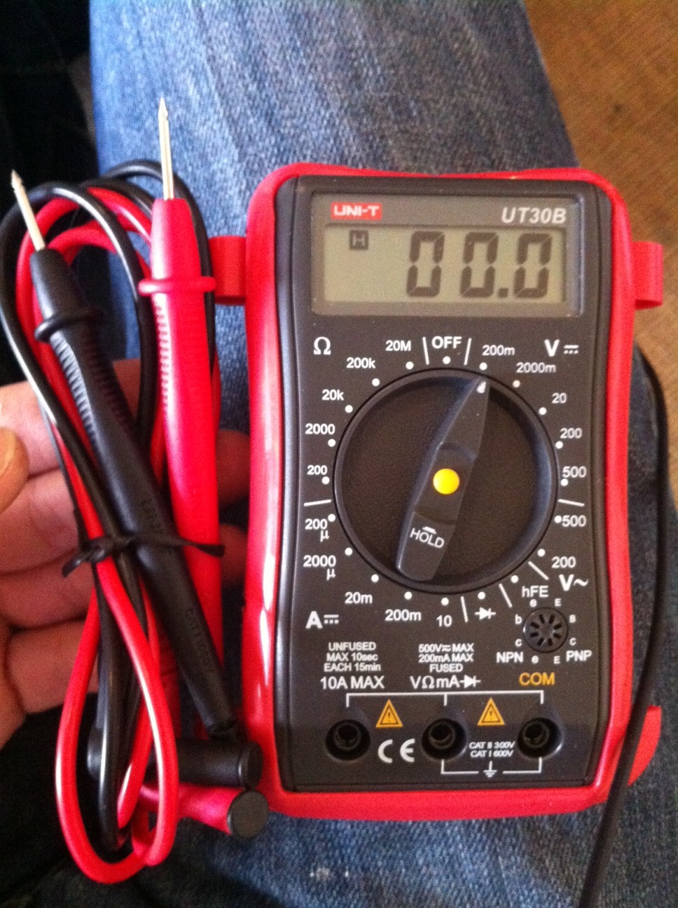

                      OK, voltages of interest are 5.2V, 12V and 20V.
                      First turn off hold on your meter by pressing the hold button until the "H" goes away.
                      Set meter to "V=" 200. Put the black probe in COM and red probe in V/ohm/mA/->|-.
                      Place the black probe in the TV chassis -- exposed screw hole is a good place.
                      Place the red probe on each pin of interest, only need to do one for each voltage as they should be identical. To measure the pin you need to get the metal edge around the pin, with the connector still plugged into the main board and PSU.
                      If you find the voltages to be dropping out as the screen goes black then the PSU is suspect.

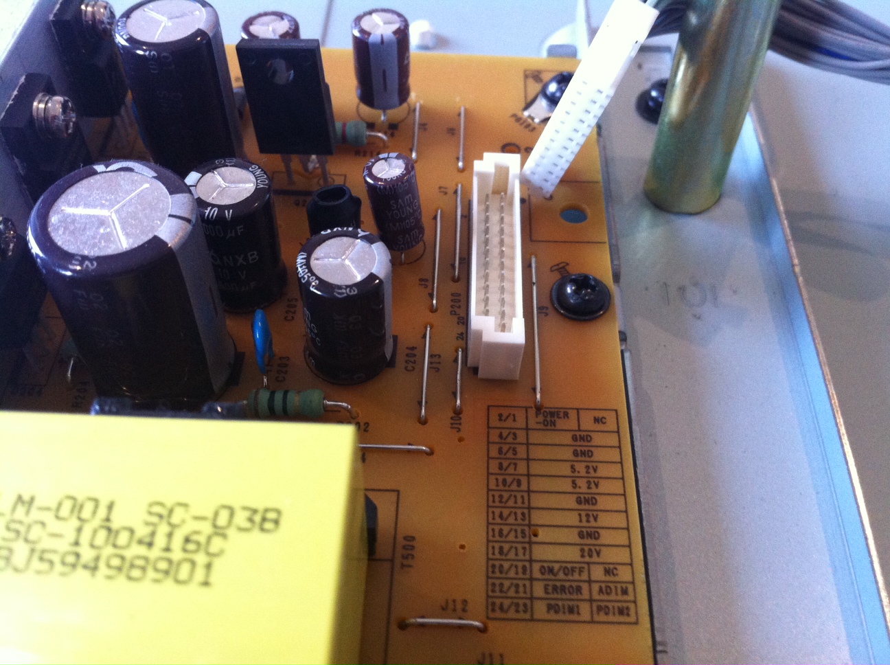

                        Thank you Tom.
                        I am clear on all points, except how to connect the metal edge of the pin whilst connectors are plugged in.
                        I'm YouTubing guides while we go. Close up pics of PSU/Main connectors/boards:
                          It's tricky but just around the wire going into the connector you want to touch the probe against that. The metal should be exposed very slightly.
                              You meter must be on the "V=" not "V~" setting.
                                Noted!
                                (On my meter, closest symbol to '=' is a line with 3 dots underneath. I assume this is the one)
                                Results:
                                8/7 - 5v = 5.2, no change during blink
                                10/9 - 5v = 5.2, no change during blink
                                14/13 - 12v = 12.3, no change during blink
                                18/17 - 20v = 21.1 to 21.2, jumps to 21.3 during blink

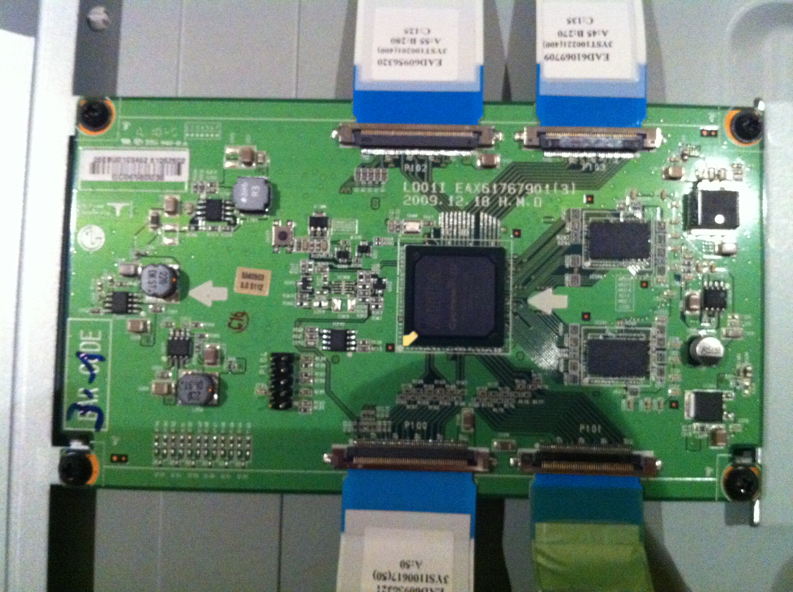

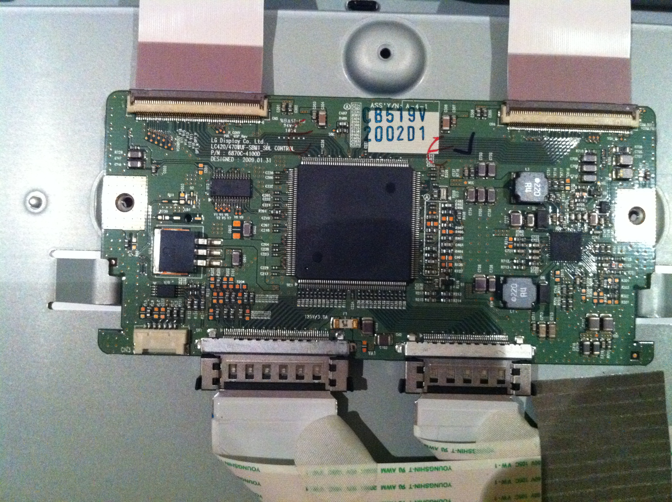

                                On a separate note, maybe irrelevant:
                                I can hear the distinctive, very faint buzz of the screen during operation. (Same buzz I've heard from every healthy LCD).
                                During blink, the buzz - which is almost definitely coming from this board - cuts out.
                                As previously stated, backlight is definitely operational 100% of the time. The display transmits 'black'.
                                  Instructions for your meter are here
                                  http://uni-trend.com/manual2/ut30BCD.exe
                                  "During blink, the buzz - which is almost definitely coming from this board - cuts out."
                                  Very carefully remove, clean and replace the flat ribbons going to that board
