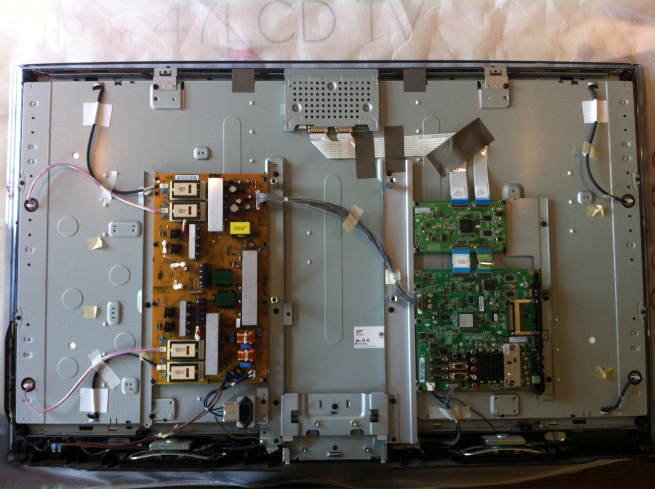

    The set is two years old, but I acquired it in full working order 2 months ago. A few days ago it developed the following intermittent fault:
    The output turns black (backlight stays on) for a split second, before returning to normal picture.
    -The blink only occurs during certain bright or 'pixel busy' scenes.
    (Interestingly, when I pause on a frame which is causing a blink, the duration between blackouts are precisely the same. On one occasion, every 13.9 seconds. Another time, every 3.9s. Another, every 8.0s.)
    -Turning the backlight/brightness down will stop the blink
    -Occurs on all sources - HDMI, USB, RF
    -No break in audio, or loss of any other functionality
    I carefully removed the rear panel and had a look.
    -No bulging/leaking capacitors on power board
    -No visible damage on any boards
    -No loose connections. (I carefully dis/reconnected all)
    Photos provided were taken before I registered, for my own reference. I don't have a pic of the entire chassis, but at the time I took pics of all four visible boards. If you would like higher quality pics I will happily dismantle and take some more.
    Is the AV board the most likely culprit, as someone else advised?
    If so, I would really appreciate knowing where I could find the rare replacement. EMOS are checking, can't find any on eBay.
    If not, which part should I try to replace first?
    Can't tell you how helpful your input is, guys. Thank you in advance.

    Re: LG 47LD920 Display (not backlight) blinks off every 8 seconds during brighter sce
    I wouldn't immediately suspect the main/AV board. Those two primary (400V) capacitors can cause this problem. Though they usually cause backlight blinking...
      Thanks Tom. So you think I'd be wiser to replace the power board first?
                      OK, voltages of interest are 5.2V, 12V and 20V.
                      First turn off hold on your meter by pressing the hold button until the "H" goes away.
                      Set meter to "V=" 200. Put the black probe in COM and red probe in V/ohm/mA/->|-.
                      Place the black probe in the TV chassis -- exposed screw hole is a good place.
                      Place the red probe on each pin of interest, only need to do one for each voltage as they should be identical. To measure the pin you need to get the metal edge around the pin, with the connector still plugged into the main board and PSU.
                      If you find the voltages to be dropping out as the screen goes black then the PSU is suspect.
                        Thank you Tom.
                        I am clear on all points, except how to connect the metal edge of the pin whilst connectors are plugged in.
                        I'm YouTubing guides while we go. Close up pics of PSU/Main connectors/boards:
                          It's tricky but just around the wire going into the connector you want to touch the probe against that. The metal should be exposed very slightly.
