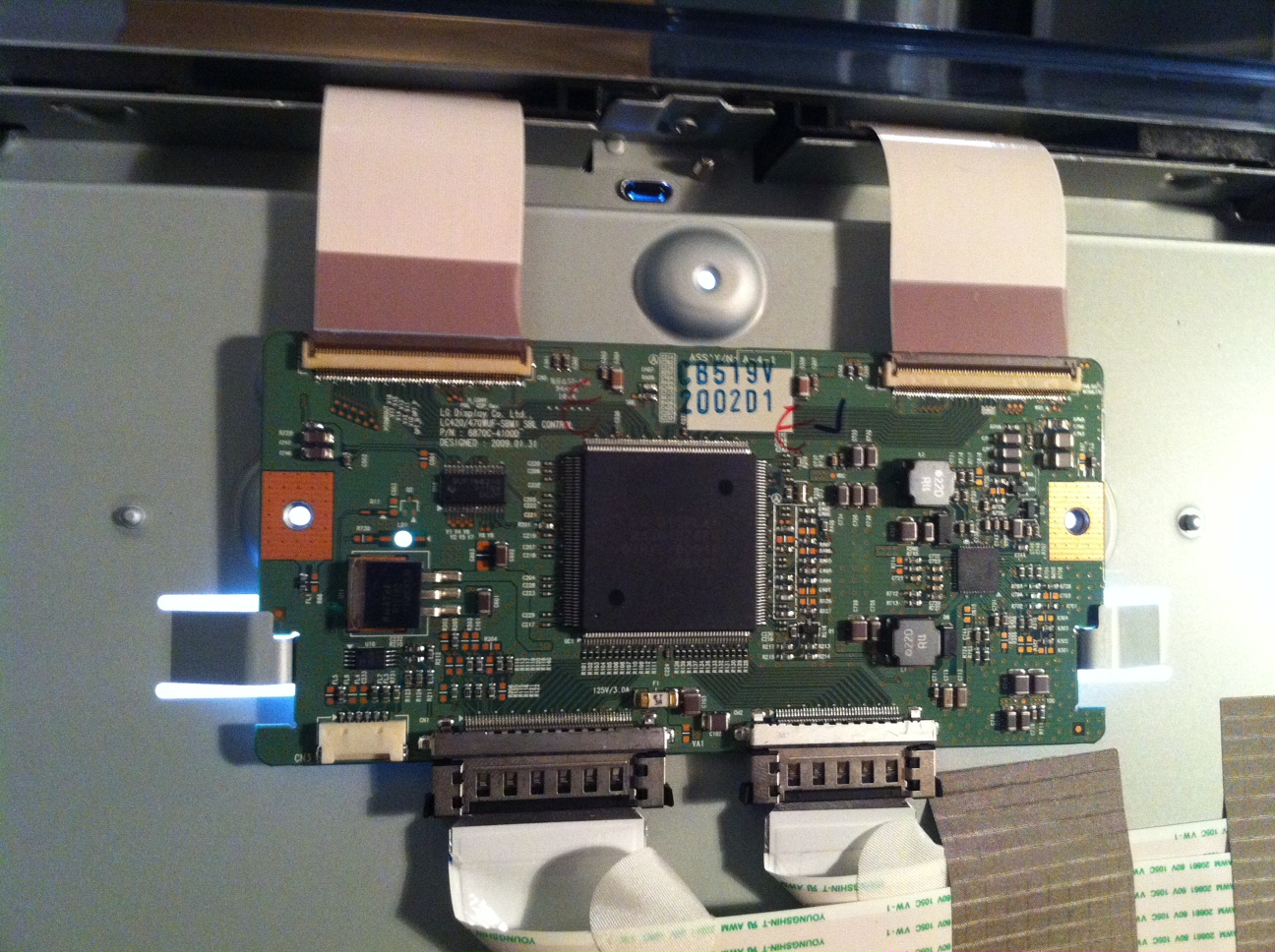

                Re: LG 47LD920 Display (not backlight) blinks off every 8 seconds during brighter sce
                Hi Tom and all, hope youre well. Any chance you are online?
                I installed the new T-con a few moments ago. No change. How utterly gutting.
                Any thoughts on my next move? I'm pretty desperate to fix this mother asap, by any means necessary.

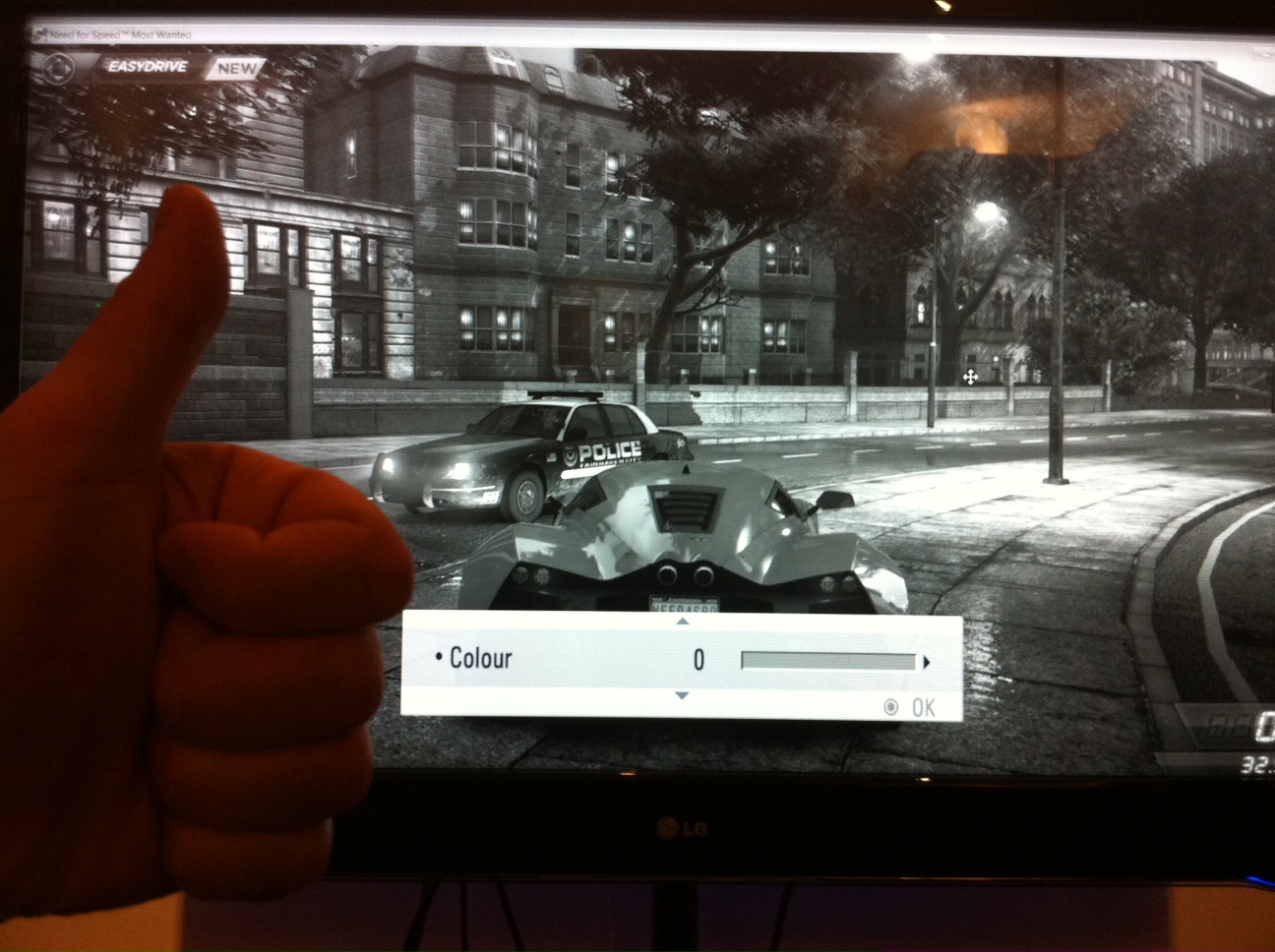

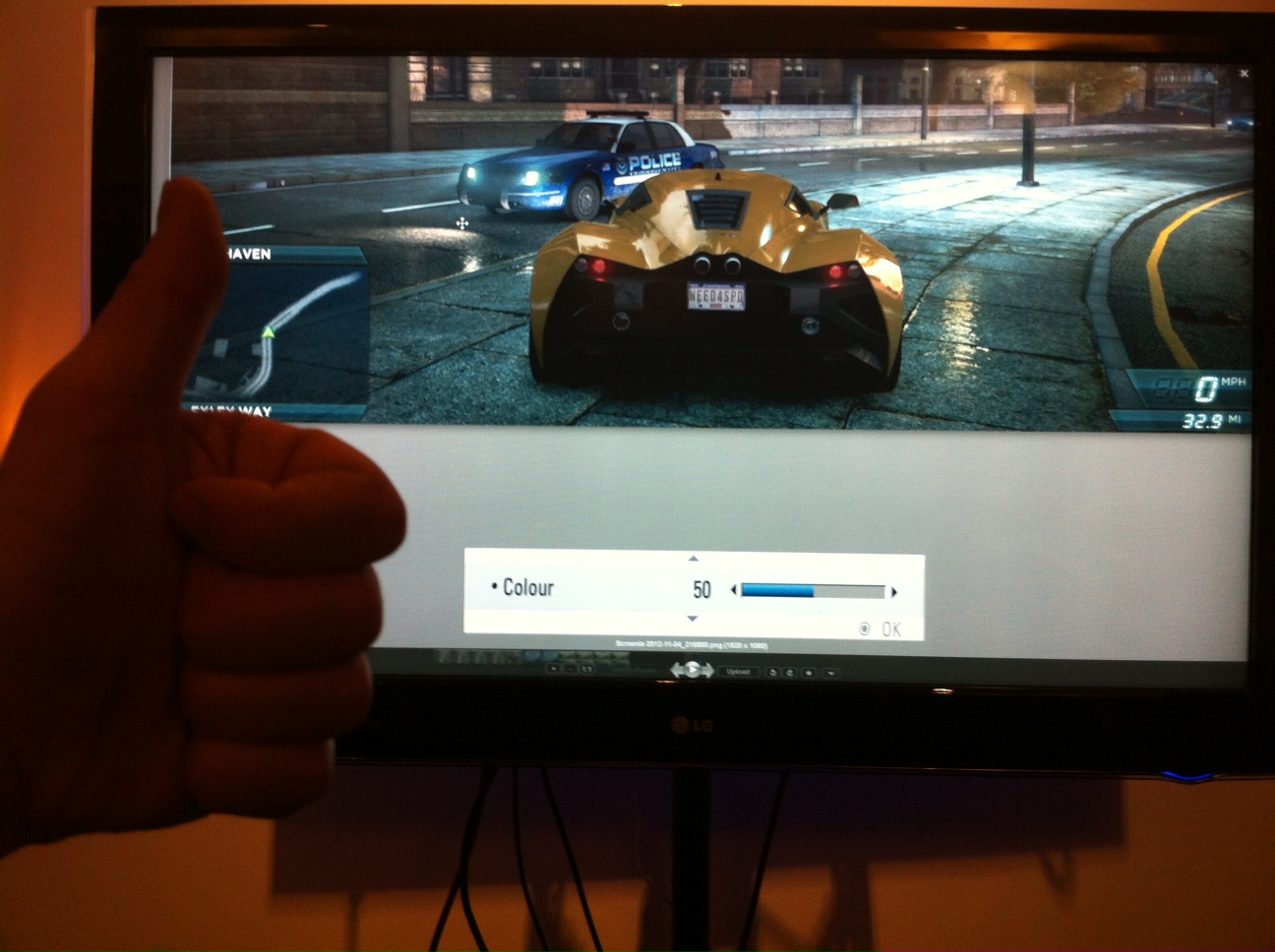

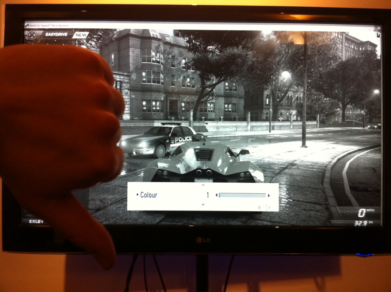

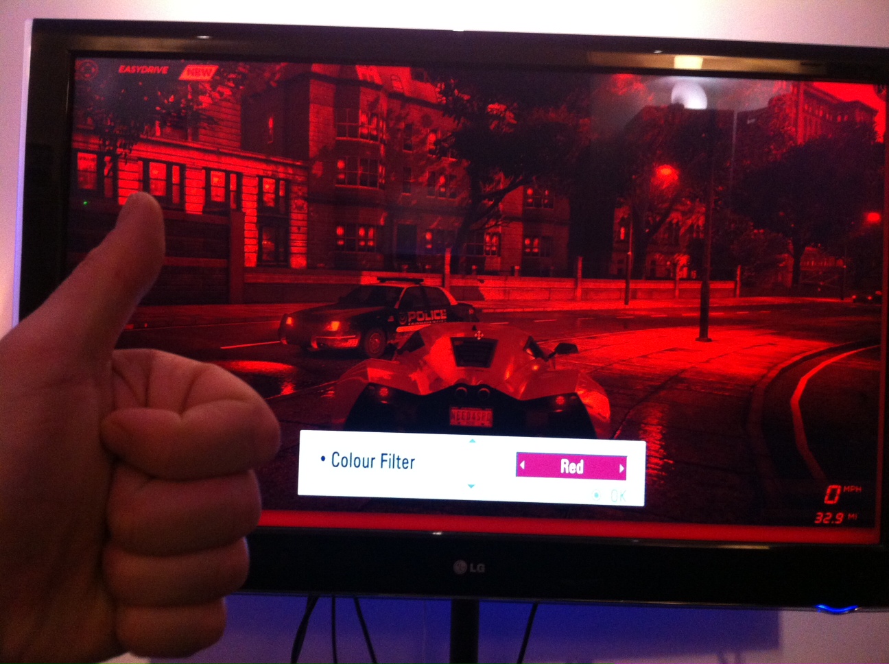

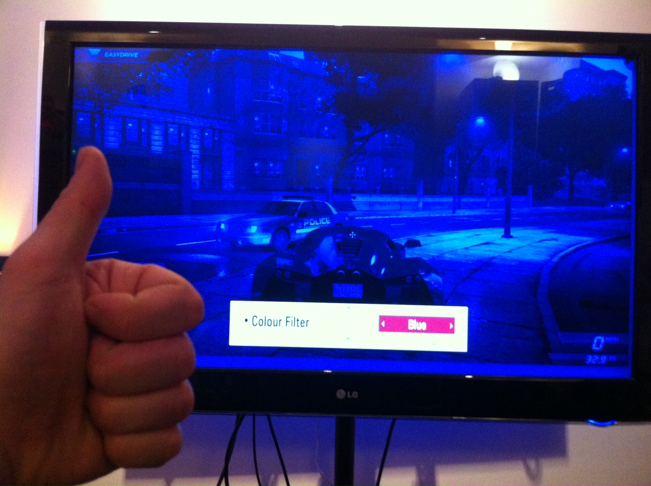

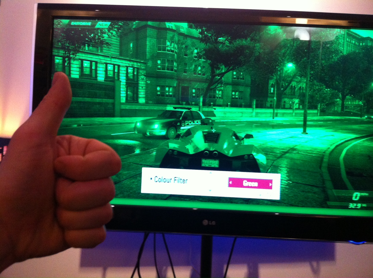

                                          #40
                                          Hi Tom, Selldoor, sorry for the delay and thanks for responding.
                                          I needed to work on other stuff for a few days, but I'm back.
                                          I've come too far to give up now!

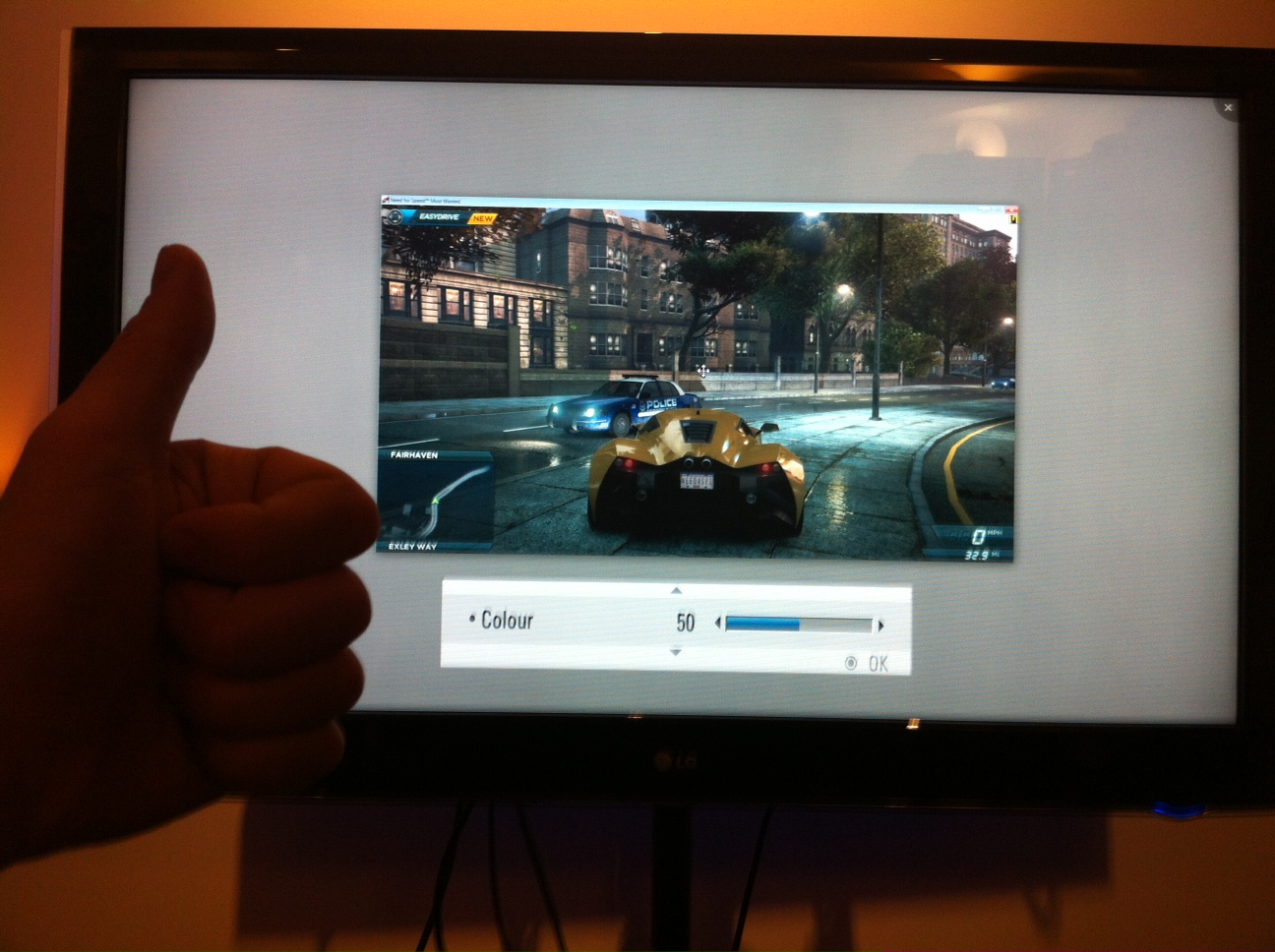

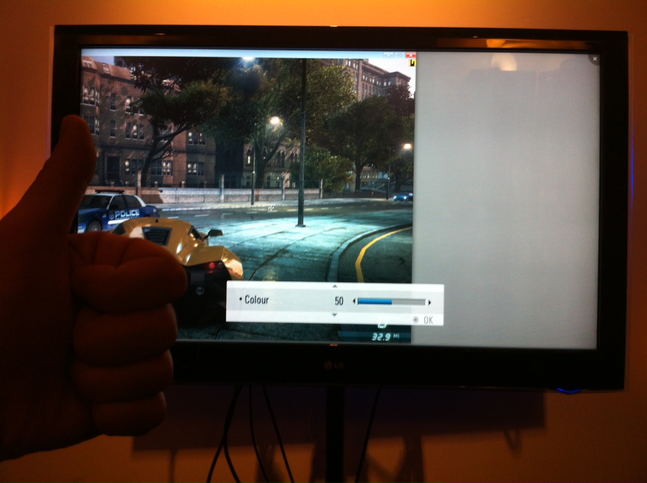

                                          Apologies for the long message, I've been running a few tests and have info I think will be useful.
                                          I previously thought that brightness/frame complexity were affecting blinks. Well, it doesn't. It's colour.
                                          I took a screenshot during a troublesome scene, and by playing around was able to ascertain the following:
                                          • [1] Blinking never occurs when colour is turned down to zero.
                                            As soon as I nudge colour on at all, even at 1%, the blinking starts again.
                                            [2] Blinking always occurs during frames which contain a mixture of colours.
                                            [3] Blinking never occurs on a screen saturated with one colour;
                                            blue, red or green, black or white. Even with brightness etc maxed.
                                            [4] By moving a troublesome colourful screenshot partially off screen in any direction, against a plain background, I can completely prevent the blinking.

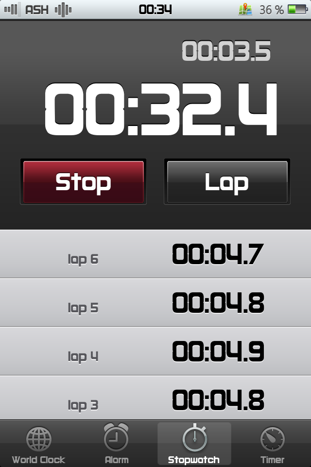

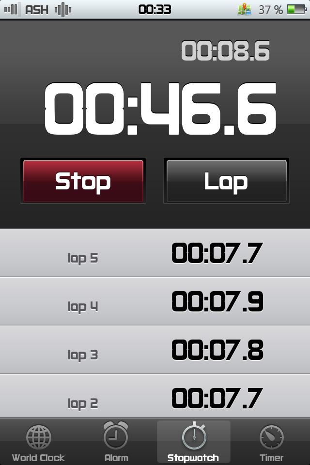

                                            [5] Pauses between blinks are identical. However, the pause can be made to vary depending on how high the colour setting is cranked. eg,
                                            -At 1% colour, blink frequency = Every 7.8s precisely
                                            -At 100% colour, blink frequency = Every 4.8s precisely
                                            -Blinks continue at this frequency as colour is turned down, but stop immediately at 0% colour
                                            [6] When blinking occurs, the OSD menu disappears too. But the plain grey menu can be enough to prevent a blink occurring.
                                            [7] A portable heater pointed at the AV board previously led us to believe that the AV board was at fault, as it appeared to increase blink frequency.
                                            However, I am now thinking that I was either
                                            a) wrong about the freq increase, or
                                            b) that the heater was affecting another component.
                                            The TV is currently remounted, but I will take it down again tomorrow and run heat tests on other areas. I will also take the opportunity to check all connections, including the two recessed T-con ribbons which I couldn't reach last time.
                                          In the meantime - what do you think? Tell me I'm not running out of 'next steps'.
                                          See attached photos of scenarios described.
                                          thumbs up = working
                                          thumbs down = blinking
                                          Code:
                                          [ATTACH]55271[/ATTACH]
                                          [ATTACH]55272[/ATTACH]
                                          [ATTACH]55273[/ATTACH]
                                          [ATTACH]55274[/ATTACH]
                                          [ATTACH]55275[/ATTACH]
                                          [ATTACH]55276[/ATTACH]
                                          [ATTACH]55277[/ATTACH]
                                          [ATTACH]55278[/ATTACH]
                                          [ATTACH]55279[/ATTACH]
                                          [ATTACH]55280[/ATTACH]
