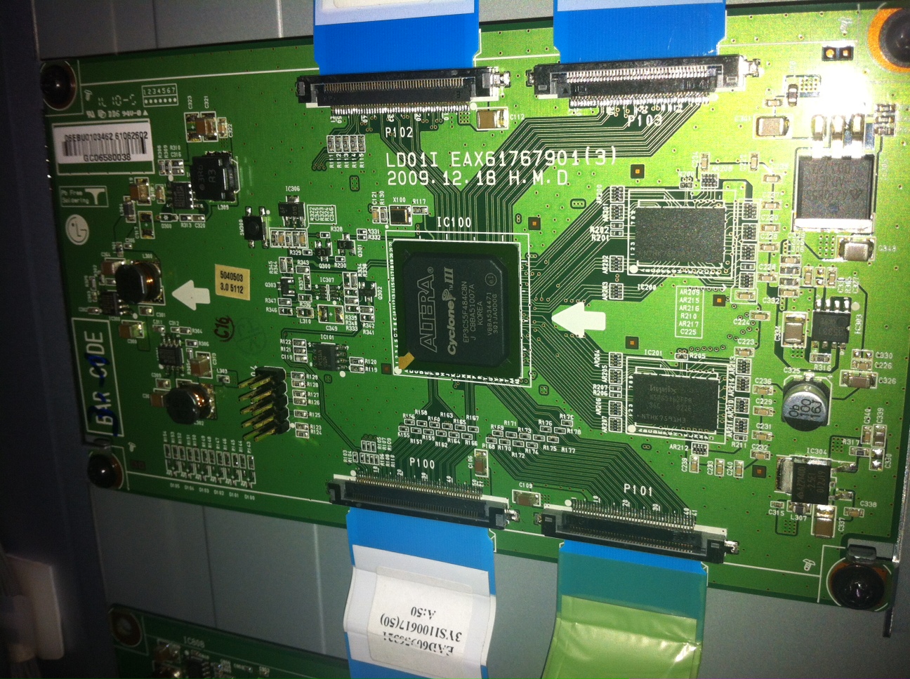

                              Been a while, but I've found some spare time. If you don't mind, I have a question. Something happened during my tests this eve.
                              Could a hairdryer be enough to cause a reflow, or to fix a dodgy board?
                              -I put aside some time tonight (and tomorrow) for another diagnosis session.
                              I wanted to prove/rule out your firmware-bug hypothesis, so I ran some more heat tests, this time on the (unknown) board between AV board and T-CON.
                              -Last time, tests appeared to indicate that heating the AV board caused increased blink frequency, so I replaced it. Problem continued.
                              -This time, I wanted to rule out that residual heat may have actually been affecting the nearby (unknown) board between AV board and T-CON, so I tested it with a more focused heat (a hairdryer instead of fat portable heater).
                              -Initially I thought I had success; Blinks every 8s with no heat, frequency increasing to 3.5s after 20 seconds of heat, decreasing steadily to 4.5s after 2 mins with no heat.
                              HOWEVER...
                              I'm currently unable to run further tests - because for the time-being, and for the first time, the problem has completely gone away! All the colourful screenshots I saved, which were previously guaranteed to get the set blinking, are failing to have any effect whatsoever.
                              Its actually frustrating, as I need more demonstrative evidence that this unknown board is the problem. So in the meantime, I wondered if you could tell me whether the heat might have temporarily solved things, as per my opening question.
                              If so, I'll probably order a replacement board at try a reflow with the current one in the meantime.
                              Pic of board attached.
                              EDIT: Just looked at the details on the board, EAX6167901 (3). I'll search for this part now.
                              EDIT: Having trouble finding out what this board is! Google isn't helping. Any idea?

                                Huh. I did not realise this chassis had a second t-con. A picture of the overall layout could have eliminated such confusion.
                                Heat can definitely temporarily repair solder joints, so you can try a proper reflow on that board if the problem returns.
                                I don't know what that board does. I'd take a guess it's some kind of format converter, or perhaps motion interpolation (100/120Hz?)

                                  www.4ourhouse.co.uk got me the AV board last time, hopefully they can trace the mystery board using the EAX number.
                                  Cheers as always, Tom. Thanks for the prompt response, enjoy your evening.
                                    #57
                                    Re: LG 47LD920 Display (not backlight) blinks off every 8 seconds during brighter sce
                                    Originally posted by Stimpers
                                    Post #12.
                                    Ignore me. I forgot about that. Hmm, it would definitely point to that board.
