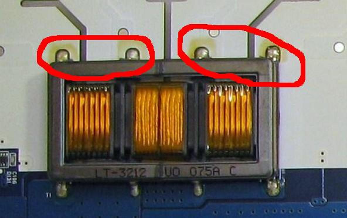

                OK, let me verify the pin out of the transformer LT-3212.

                    We need to verify if we have any bad transformer first. See the new pinout and take the resistance reading using 2000 Ohm scale on the meter.

                          Set on ohms on my meter the pins are reading 1.203 to 1.213 kohms is what my meter says

                              #54
                              Re: Samsung LNT3242H 32" LCD TV, no picture but audio works- no component damage
                              OK from bottom of tv
                              Transformer 1
                              1.210
                              1.200
                              Transformer 2
                              1.201k
                              1.203k
                              Transformer 3
                              1.203k
                              1.204k
                              There is also a little one between #2 and #3 that measures
                              32.2 ohms. No "k" on that one
                                #55
                                OK, they are within 3% from each other so they are OK.

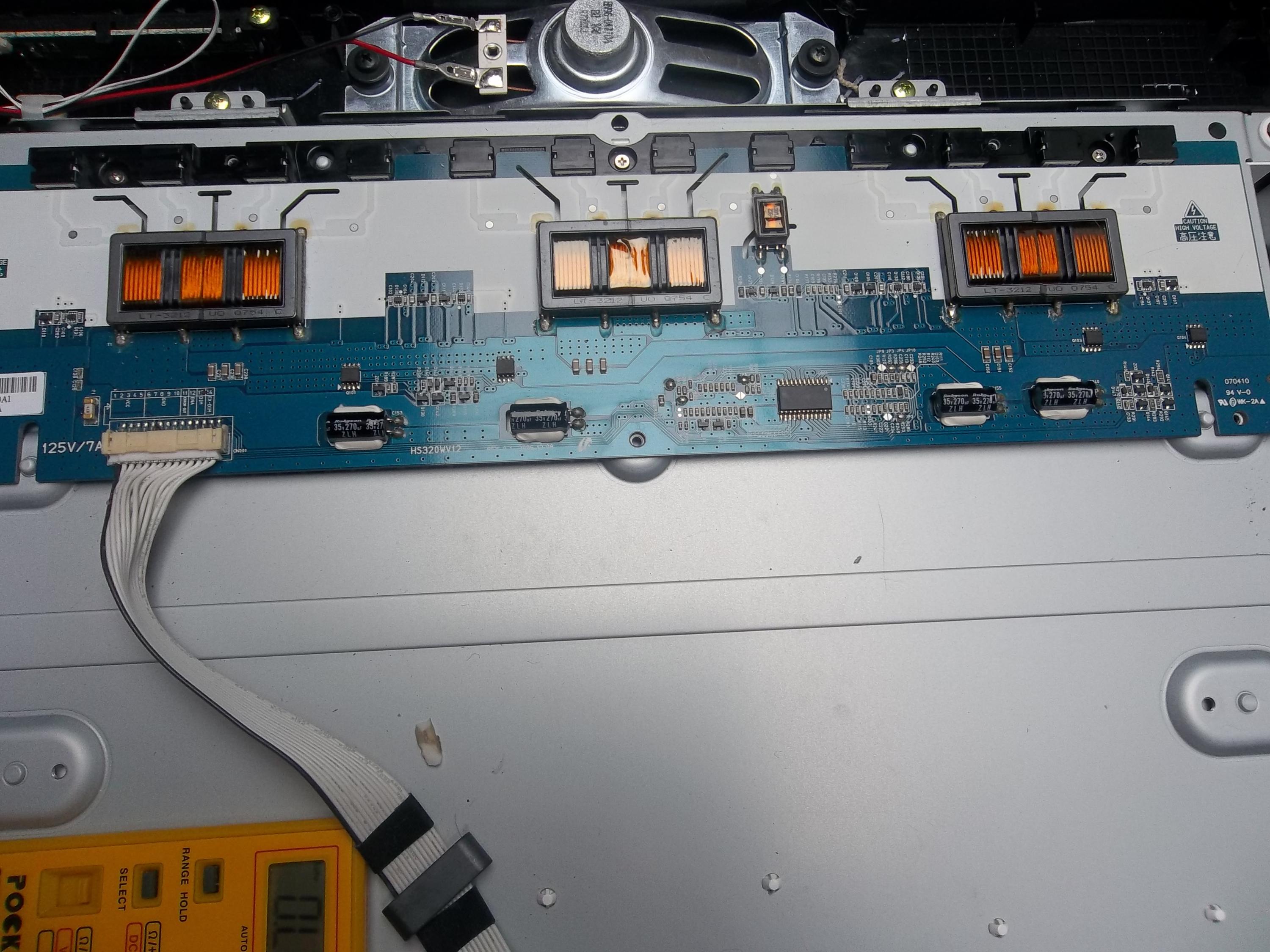

                                Try heating up the four 270uf/35v caps with the hair dryer for about 3 minutes, thn plug the TV in and turn it on to see if the backlights will stay on.
                                By the way, monitor the pin 12 (ENA) CN001? on the inverter baord to see if it still has steady voltage of around 3VDC when the backlights go out.

                                    Yes, it is the same current sensing transformer setup for measuring ALL the lamps in this board instead of individual lamp like the SONY/SAMSUNG larger TV balancer inverter board, same concept. I need to find the rectifier Diode on the output side to make the measurement. Still looking for the diagram for this board also.
                                    I see two copper pads on the output side that he can use the AC meter to see what he gets, hopefully the meter is fast enough to capture it. I have this TV mounted on the wall in my spare bed room which I do not want to take it down to make the measurement.

                                        -02.5mv on the ENA. Hair dryer didn't make it stay on.
                                          #60
                                          2.5mv, that means the backlights will be off, it should stay at around 3vdc. Try this, turn the TV off and leave the meter still attached to the ENA pin and chassis, you should see it jumps up and the backlights will be on, then see if it drops down for sure. This signal is generated by the main board. Once you have verified that the voltage did go up and come back down then we can force the inverter on by using external 3V source to see if we can turn it on manually with external voltage source.
