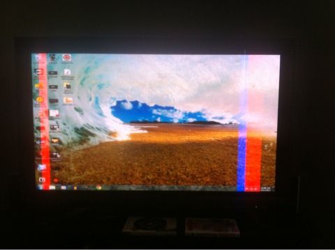

Vizio plasma red and blue vertical lines
  • Cosmo66
    • Nov 2012
    • 87
    Where would you begin trouble shooting this TV? Unfortunately, I've been told by a friend it's almost certainly a bad panel
    Model number is vp42hdtv10A
    Anyone have any input?
    Re: Vizio plasma red and blue vertical lines
    It does look like a bad panel.
    It is POSSIBLE that it is a loose connector, usually you tend to see singe lines or whole black bars with bad panels.
    • Cosmo66
      • Nov 2012
      • 87
      No possibility that it's a failing buffer?
        The buffers for the horizontal are bonded onto the panel. There is no replacing them. Likely the failure is on those. There are boards such as C1, C2, C3 (sometimes named differently) but these just distribution boards. There's very little stuff on them that goes wrong.
