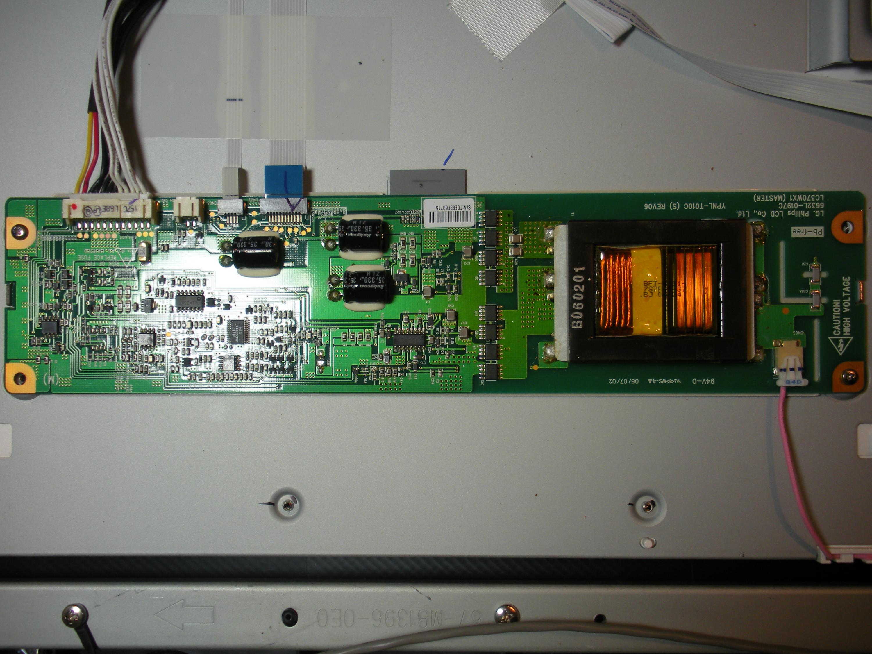

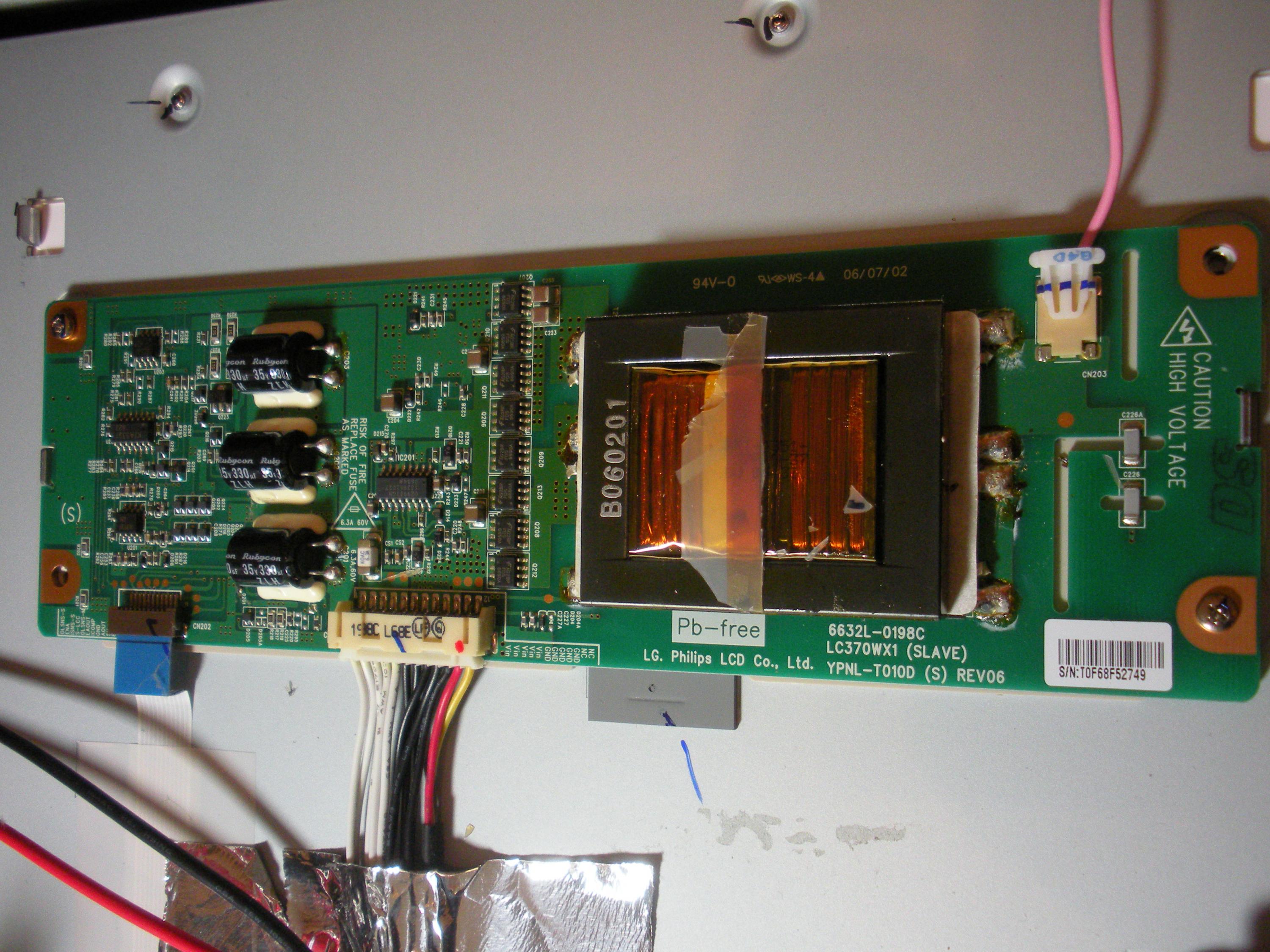

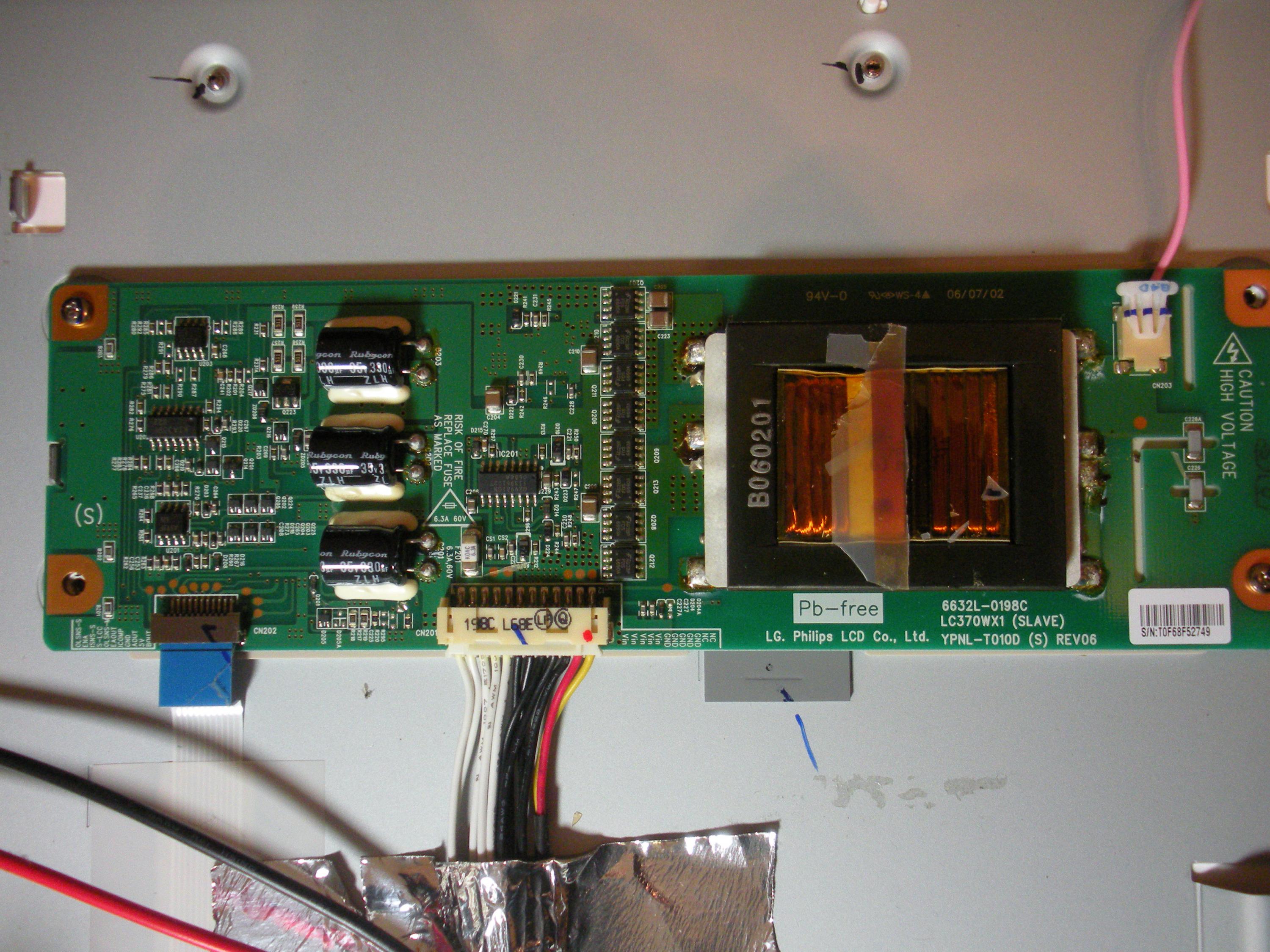

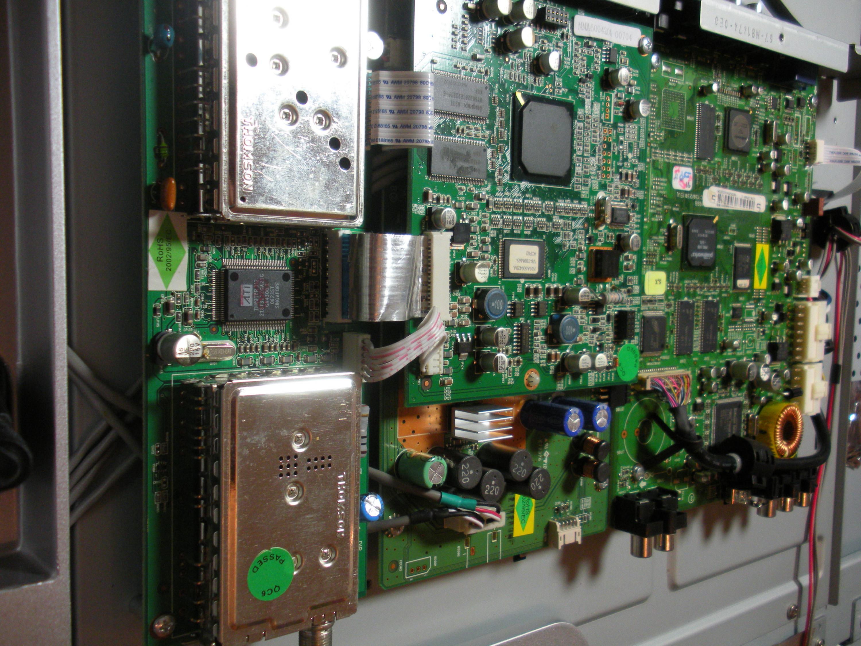

    HELLO FRIENDS,
    Here is what I got, while turning this set on the Video and Audio work great , but the back lights flicker on and off like it has a bad bulb in it. Some times there is no flicker at all when the set is turned on and while it is on it stays lite up until turned back off and on. Now there is no set time or reason this happens and there is no dark spot across screen when on as if a bulb was bad.

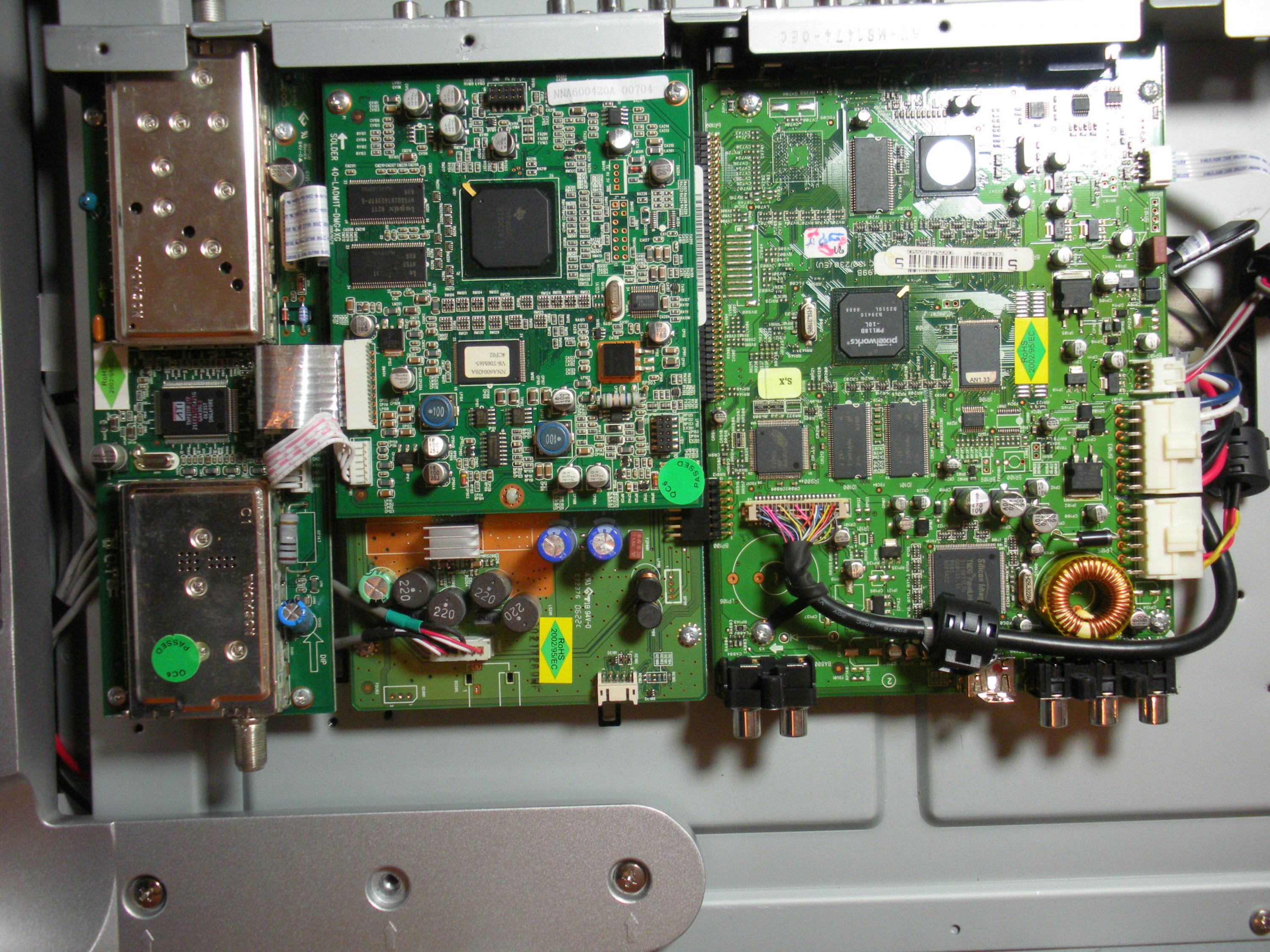

    I found some bulged caps in the PSU and replaced them, Ohm ed out both transformers on the inverters and they have the same readings when compared pin for pin. Have 24 volts , 5 , 3.8 on inverter boards from CN01and CN201, also this was measure while flickering and normal display. I don't know how BL ON is controlled , I see the pin lay out on board but don't know what they stand for, there was a similar post here in JUNE with a schematic , but is different then mine.
    Thanks in advance.
    Mike

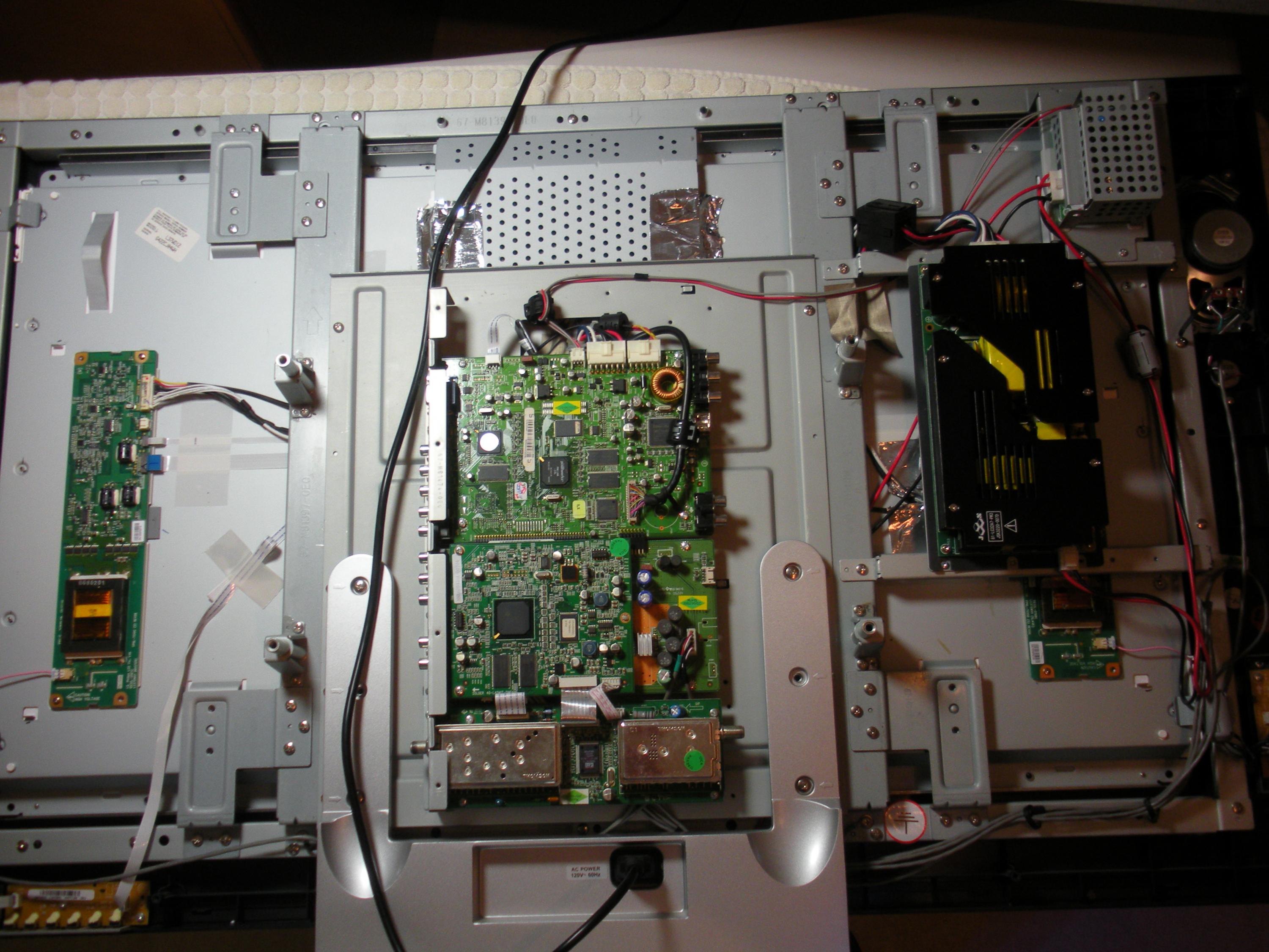

      Its actual Model # 37WD12.

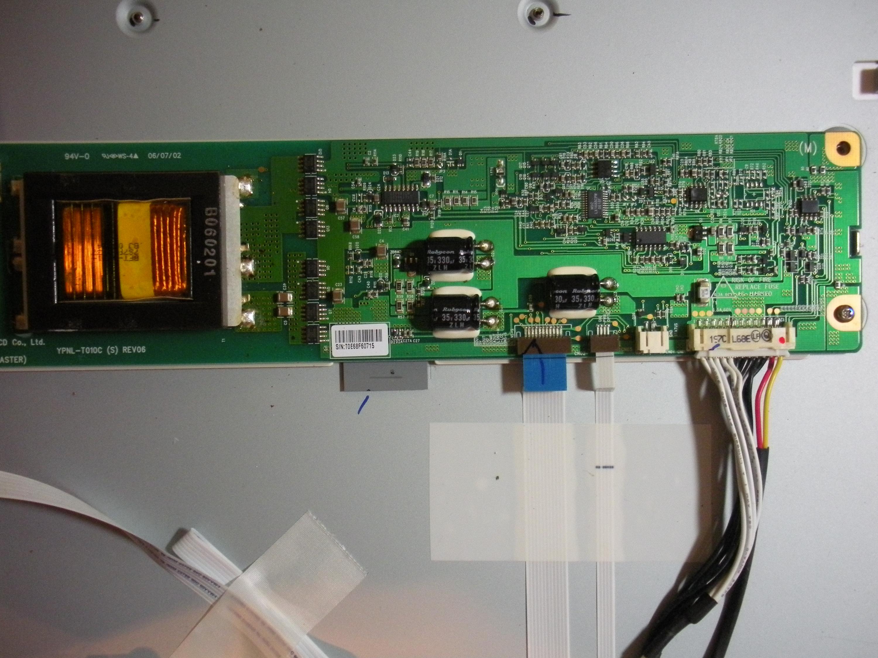

      So funny thing, while the set was laying flat screen side down, it would stop back light flickering after about 3-5 minuets of being on and stay lite. So still thinking like its cold related and takes a minute to warm up I used a hairdryer and started around the Master inverter and it stopped flickering instantly. I have narrowed it down to around the surface Mount caps just above the transformer.
        Re: RCA 37 WD12YX1 Flickering Backlights

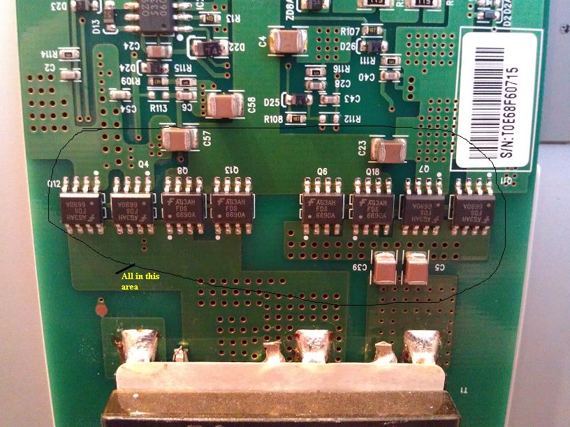

        Looks like you are pretty close... Is there any way to focus more heat on different parts... in particular I would be considering those 8 MOSFETs as well. An intermittent short on one part could cause the problem.

          Thats the next thing, I am going to put a piece of paper on the end of the hair dryer to create a small tipped funnel area(my heat gun has no tips), then start from one edge to the next, its hard due to it instantly works and after its starts up it comes on almost instantly. Has tried to blast it cool air with TV off and on , but starts back up after about 30 seconds.

                  Still think you should work on the 8 mosfets- Do the test in here
                  https://www.badcaps.net/forum/showthread.php?t=10419
                  when its unplugged. The datasheet is here http://www.digikey.com/product-detai...0ACT-ND/965623.
                  Also if they are accessible when its switched on but off ??! press each contact lightly with a non conductive stick - wood/ plastic toothpick.
