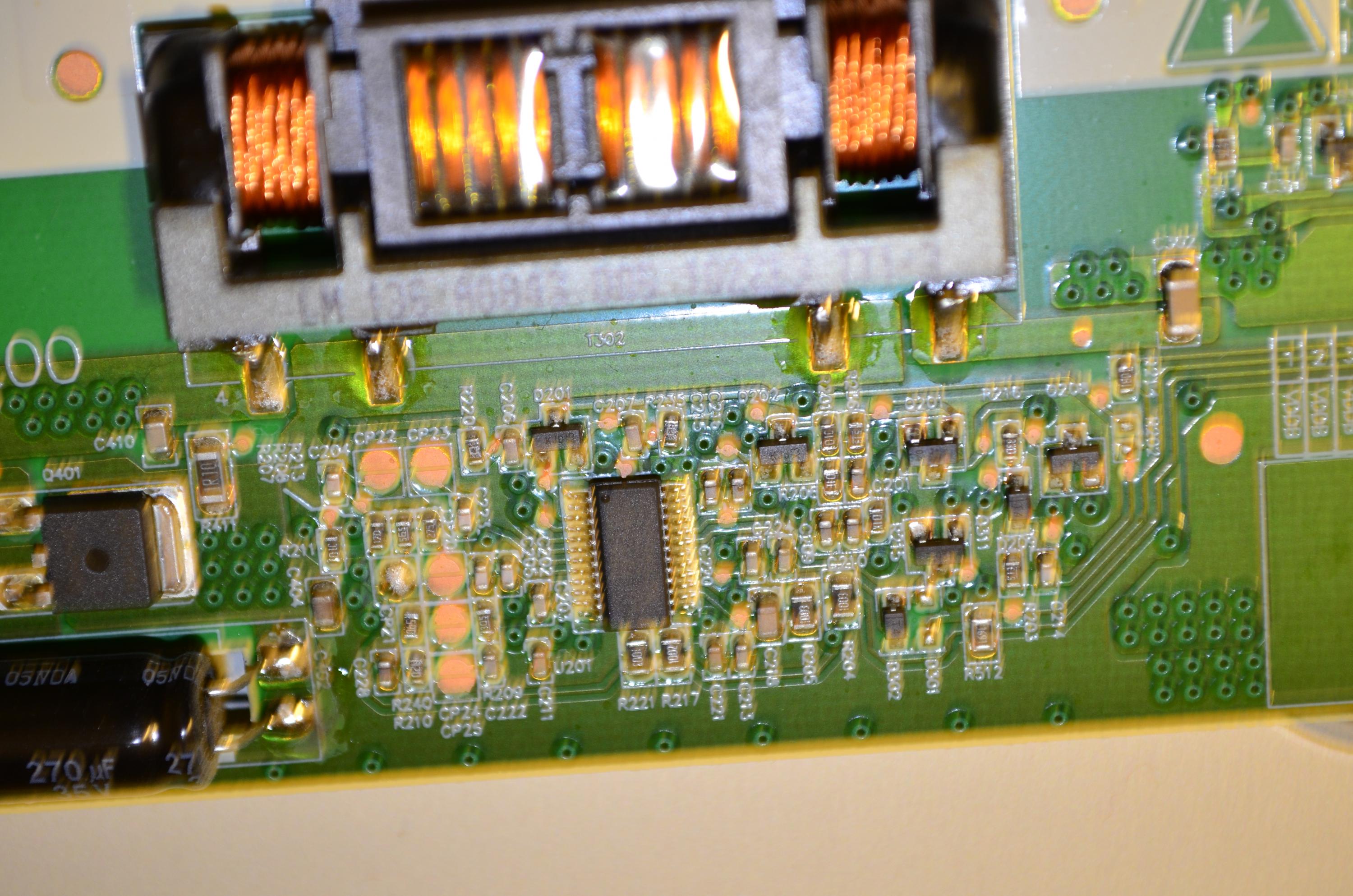

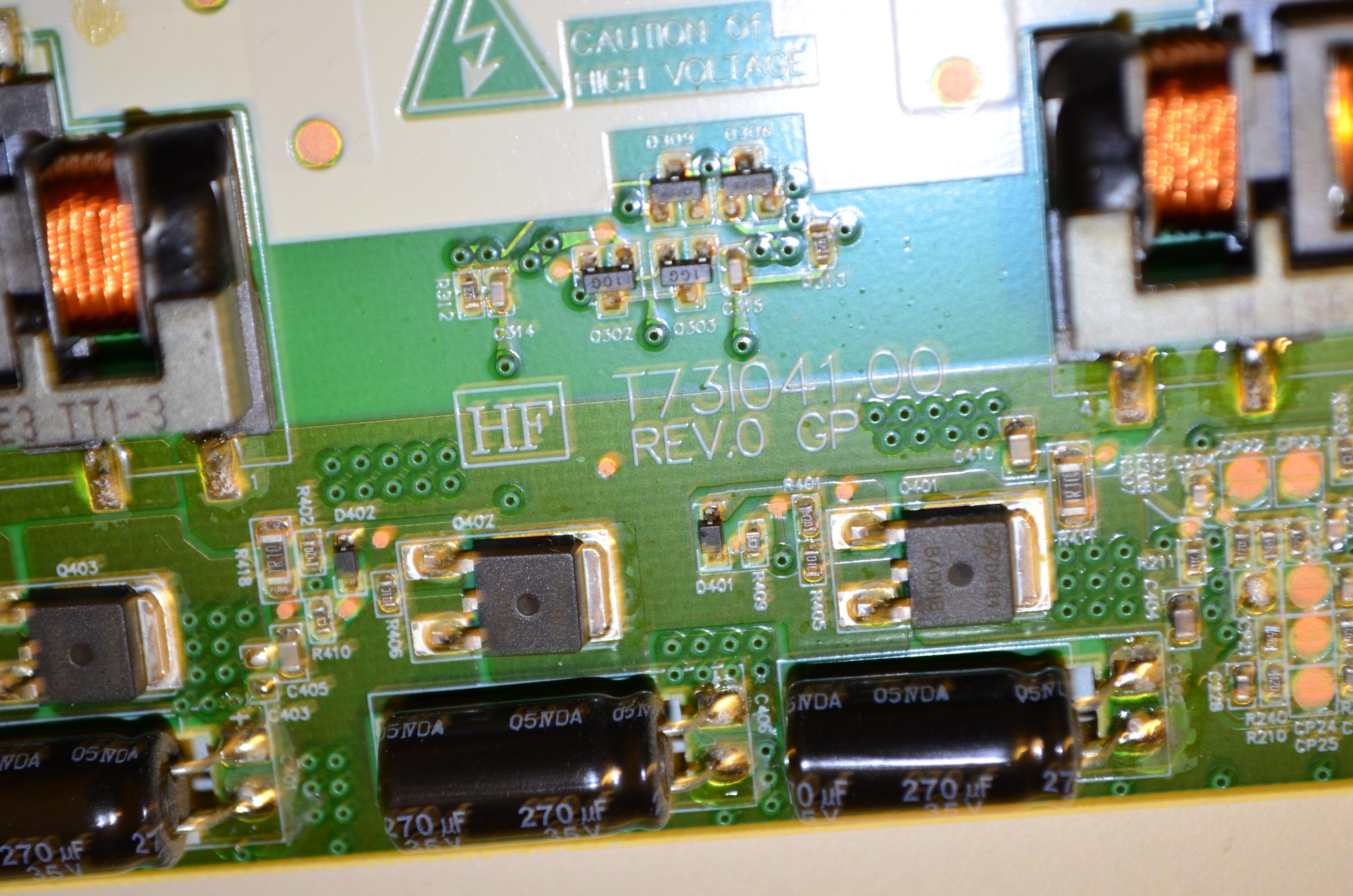

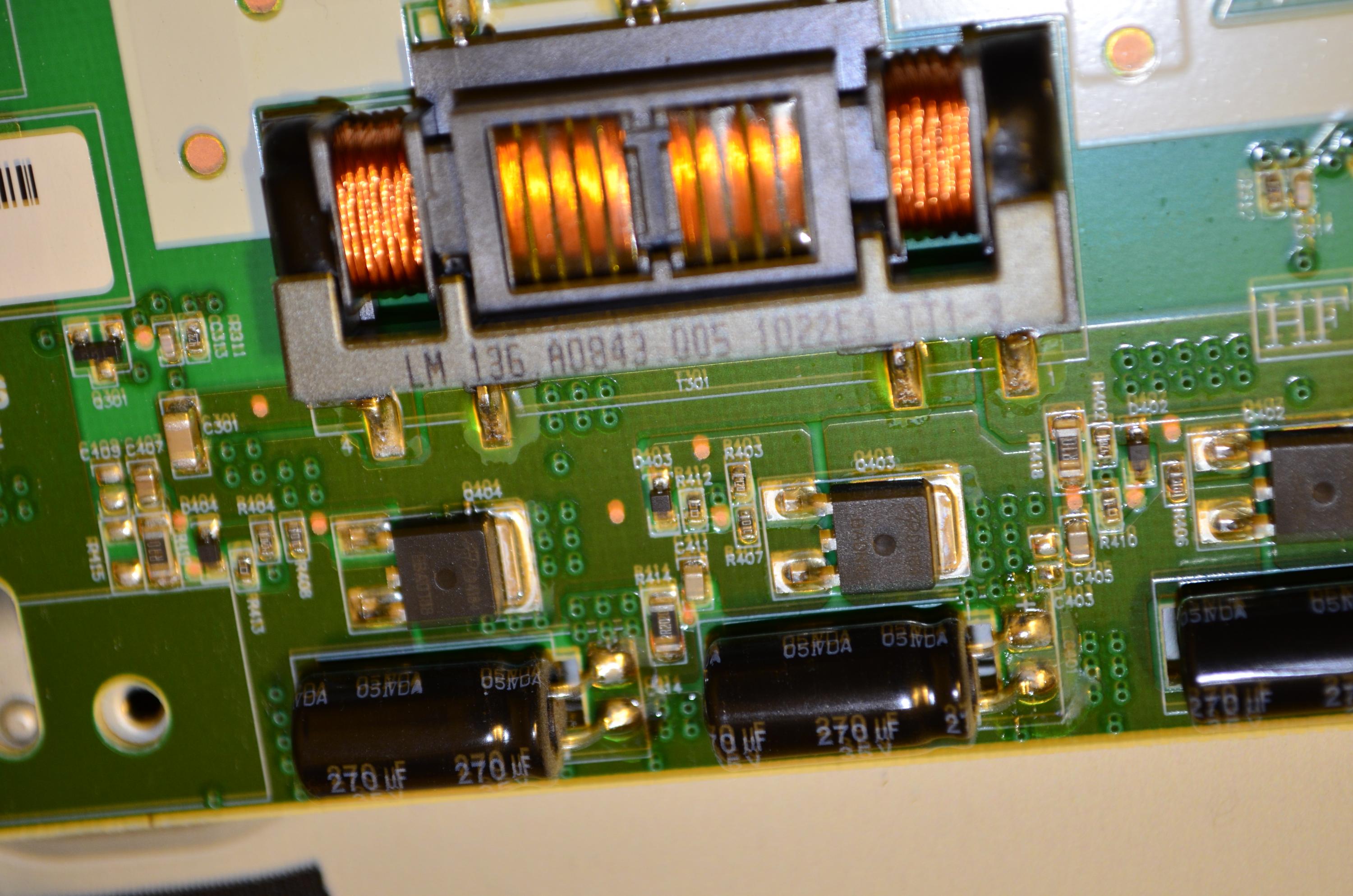

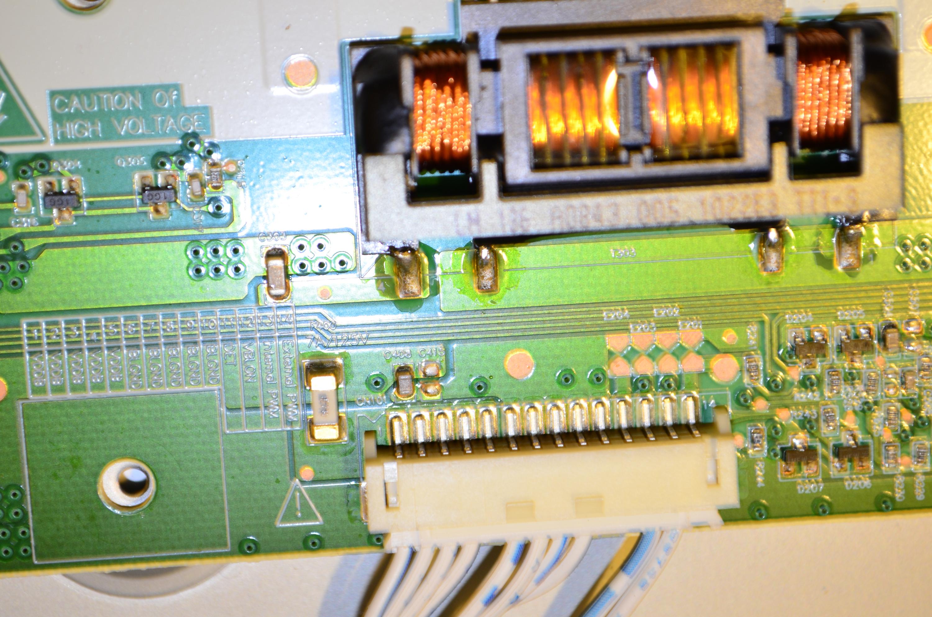

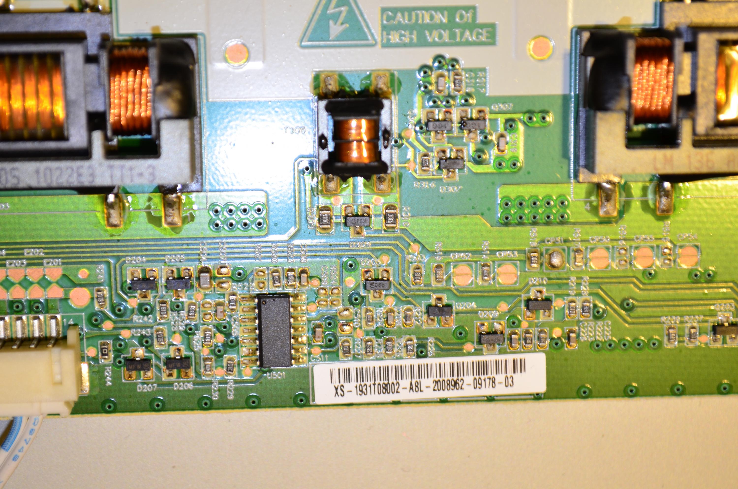

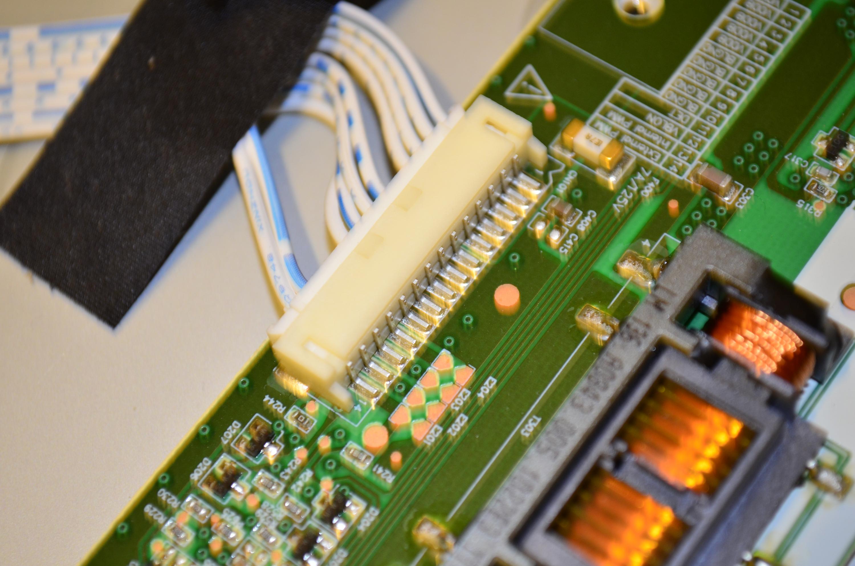

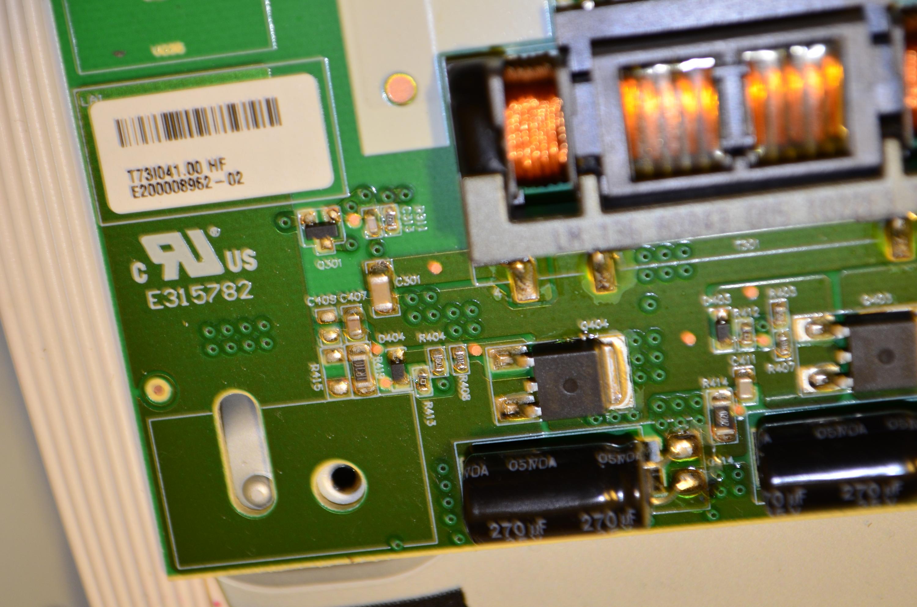

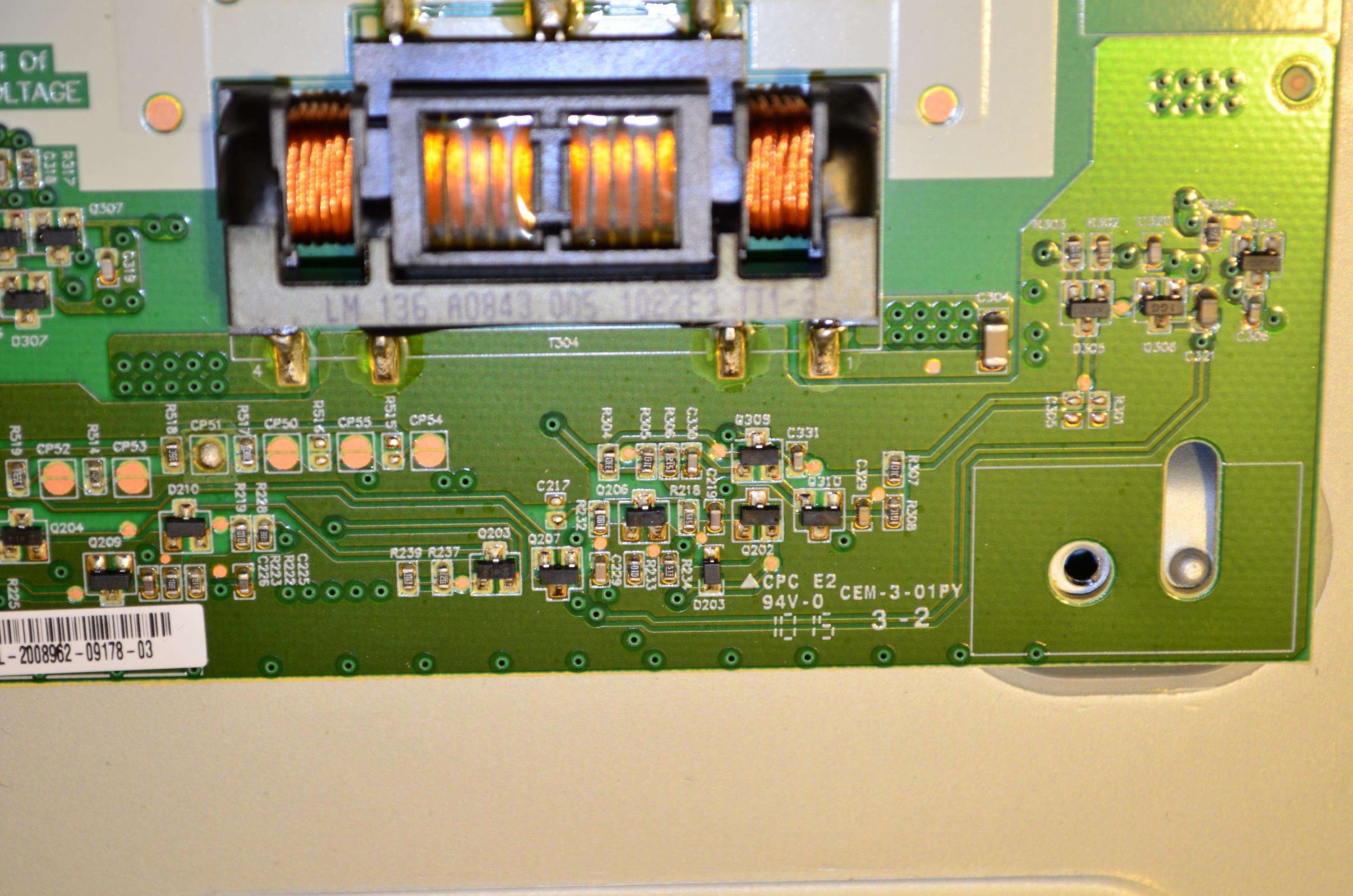

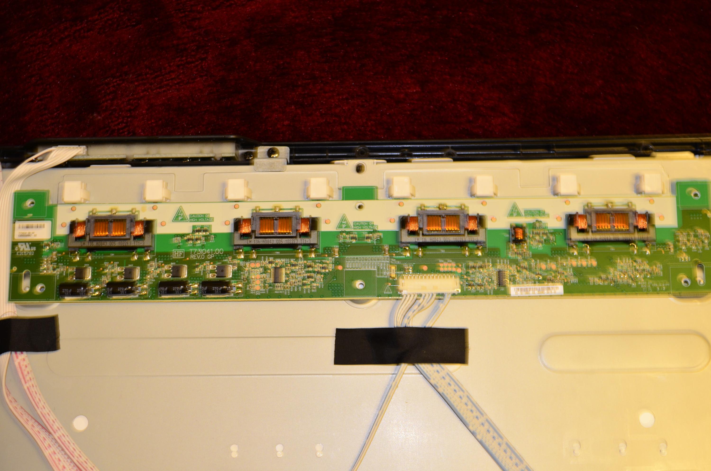

          OK, Can I get the close up pictures of the inverter board (the long board with lots of transformer on it) at the white connector so I can see if it has any labeling on it.
          I am looking for 24v, and BL_ON PINS.
            Re: Sceptre 32" Flashing (Video)
            Pics uploaded

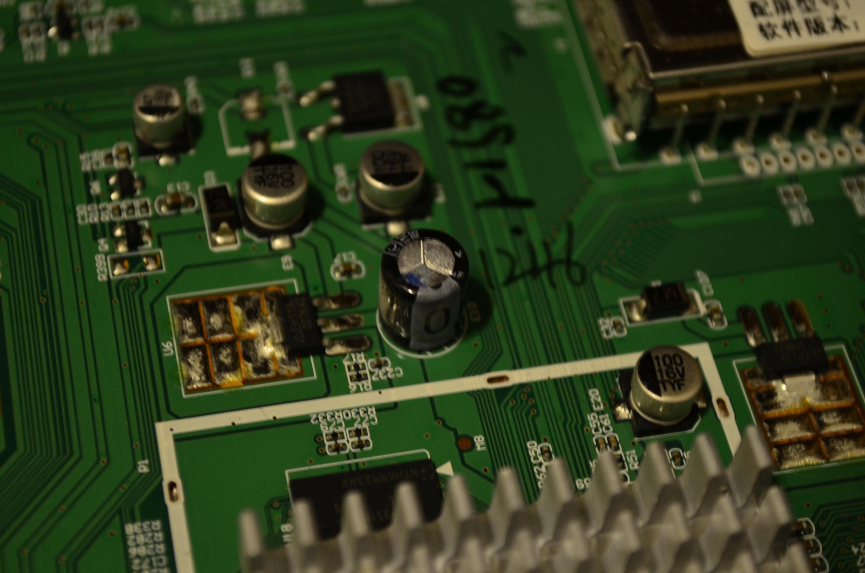

                    I also got a magnifying glass and looked at every single little thing. I then came across this, but i dont know if its a leaking CAP it has blue stuff, do they even leak blue stuff, or could it be some residue from the plastic that the cap is wrapped in?
                    Here's a pic, can the location of this cap even have an affect to what it is occurring to my television?
                      pins 1-5 are the 24v and pin 12 seems to be the BL_ON. Monitor the voltages by putting the red lead on the corresponding pin and the black on the chassis.
                      The blue looks to be like a marking, whether purposeful or not, does not look like anything to be worried about.

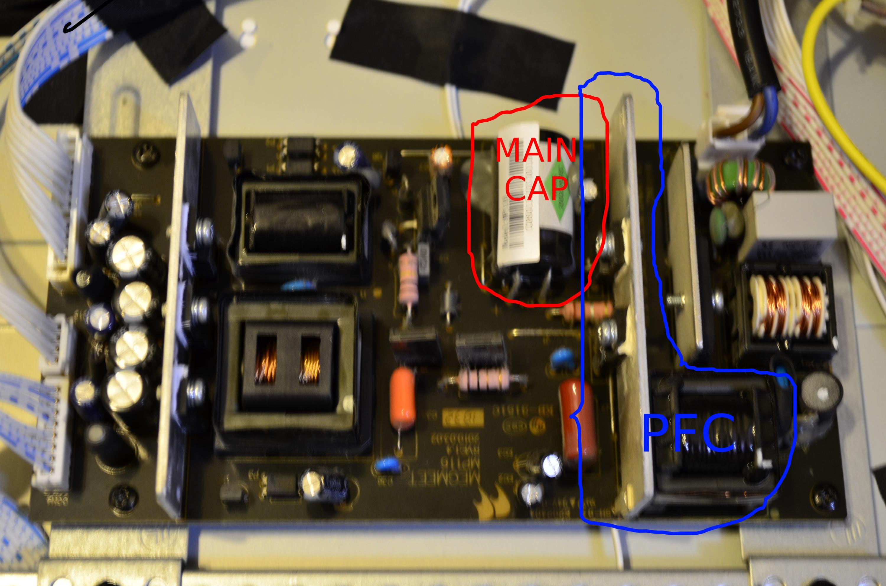

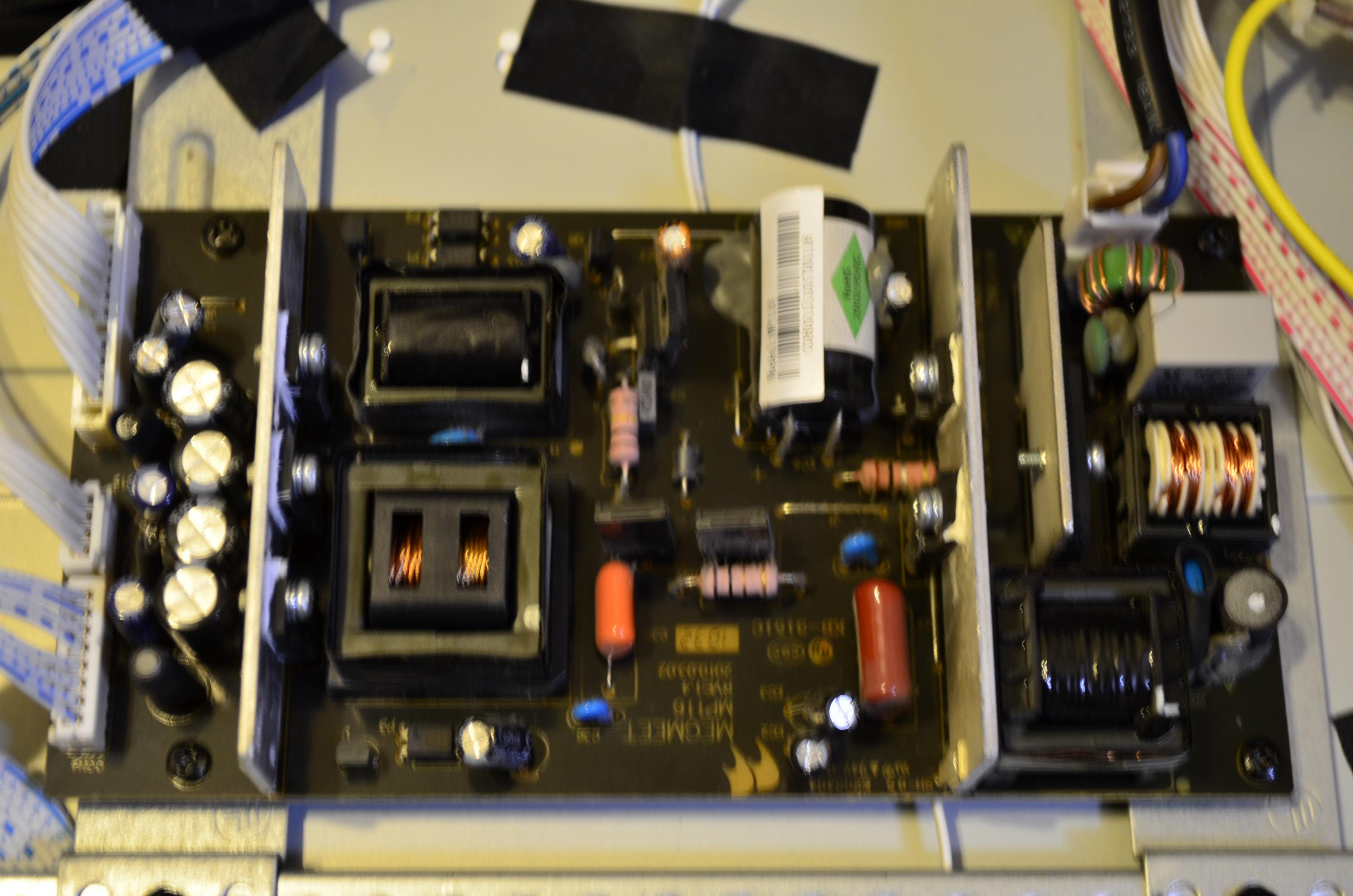

                            If you post a picture of your power supply, we can highlight the PFC/bulk capacitors.
                            You need to set your meter on 200 DCV for measurements between 20V and 200V, and 20 DCV for measurements from 2V to 20V. You shouldn't need ACV except for checking mains voltage is getting to the device (in this case, it is, as the unit is working, although flickering.)
                              Here you go
                                That large cap with the green triangle is the bulk cap
                                  OK, I highlighted the PFC and the bulk capacitor.
                                  While working, the voltage should be around 400V across the bulk capacitor (+/-20V is fine.)
                                  When in standby, it should drop down to around 160V.
                                  Can you check this -- be careful, high voltage!
