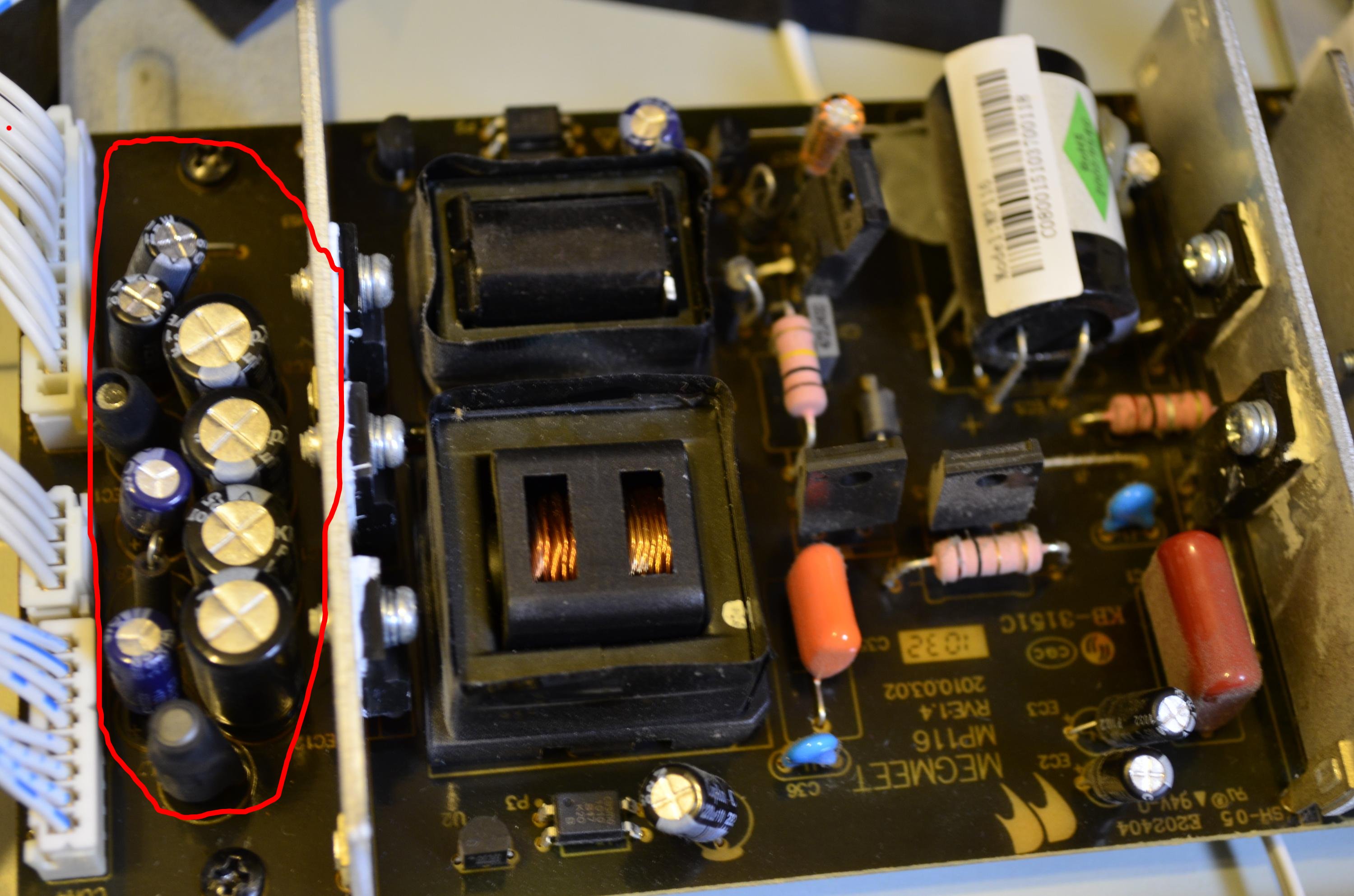

    Nope didnt work. and i left the hair dryer on there for a long time. I checked the capacitor when its normal before it starts flashing, and its 302 then drops to 260-280. The drop occurs after the flash though.
      #42
      Re: Sceptre 32" Flashing (Video)
      Hmm, I really suspect that cap, but cannot rule out other parts of the power supply.
      But the 280V is far too low for it to work and explains why it cuts out.

                        I'm at school right now so i cant see the caps rating, but yeah I can replace the cap and the poly cap just not quite sure which would be best to get there is so much to choose from the site you gave me.
                          #52
                          Check it'll fit:
                          http://www.digikey.com/product-detai...378-ND/3134334
                          Poly cap -- will need code printed on it e.g. "825J 630V".
                          May also suggest you order the caps for the output side as they are CapXon and well known to have a short lifespan. (I have replaced more CapXon than any other cap. They are truly dreadful parts, but I'm sure it's designed-in so products fail quickly.)

                            The poly cap isn't labeled...I called my roommate to check it...and from what I can see from the pics it isn't labeled
                            Sorry for my dumbness but which are the output caps.. I'm about to place my order as soon as I get home.
                            Thank you for all your help
                              #54
                              It would be very rare for the poly cap not to be labelled. It might be very fine on one side or the other,
                              The output caps are the smaller capacitors. I've highlighted them here.

                                ok got home took it apart, and the poly cap says
                                1 05 j450
                                NIS A74
                                I got the numbers for the other 8 caps, I didnt get the ones that are wrapped in plastic.
                                Blue ones
                                -35v 100uf 105c
                                -35v 100uf 105c
                                Black ones
                                35v 470uf 105c
                                25v 470uf 105c
                                10v 1000uf 105c
                                10v 1000uf 105c
                                10v 220uf 105c
                                10v 220uf 105c
                                Today i took it apart and put it back together, and its been working since yesterday, no more flashing. Ever since i unplugged all the cables and plugged them back into the circuit board, the tv has been working. Like you said though, the same way it fixed itself, it could go bad again. I am still going to order all these caps.
                                I went to radio shack today, to see if i could find the big cap, and you were right, i looked at some of the caps, and they werent labeled like they were advertised on the barcode.
                                  #56
                                  The ones wrapped in plastic are inductors, and do not need replacement.
                                  Film cap:
                                  http://www.digikey.com/product-detai...6827-ND/953263
                                  100uF 35V: http://www.digikey.com/product-detai...0294-ND/266303
                                  220uF 10V: http://www.digikey.com/product-detai...2TB-ND/2504118
                                  470uF 35V: http://www.digikey.com/product-detai...0301-ND/266310
                                  (replace the 25V with a 35V cap too.)
                                  1000uF 10V: http://www.digikey.com/product-detai...7CT-ND/3072197

                                        Glad i went back to check the big CAP, it doesnt show the numbers because half of it is covered in silicone paste. What i can see, it says:
                                        KM 105*c
                                        P1034
                                        VENT
                                        RoHS
                                        2002/95/EC
                                        When we tested it the voltage was 302.
                                        • smigglet
                                          • Nov 2012
                                          • 31
                                          #60
                                          unsoldered it and checked it, its a
                                          450v 68uf 105c
