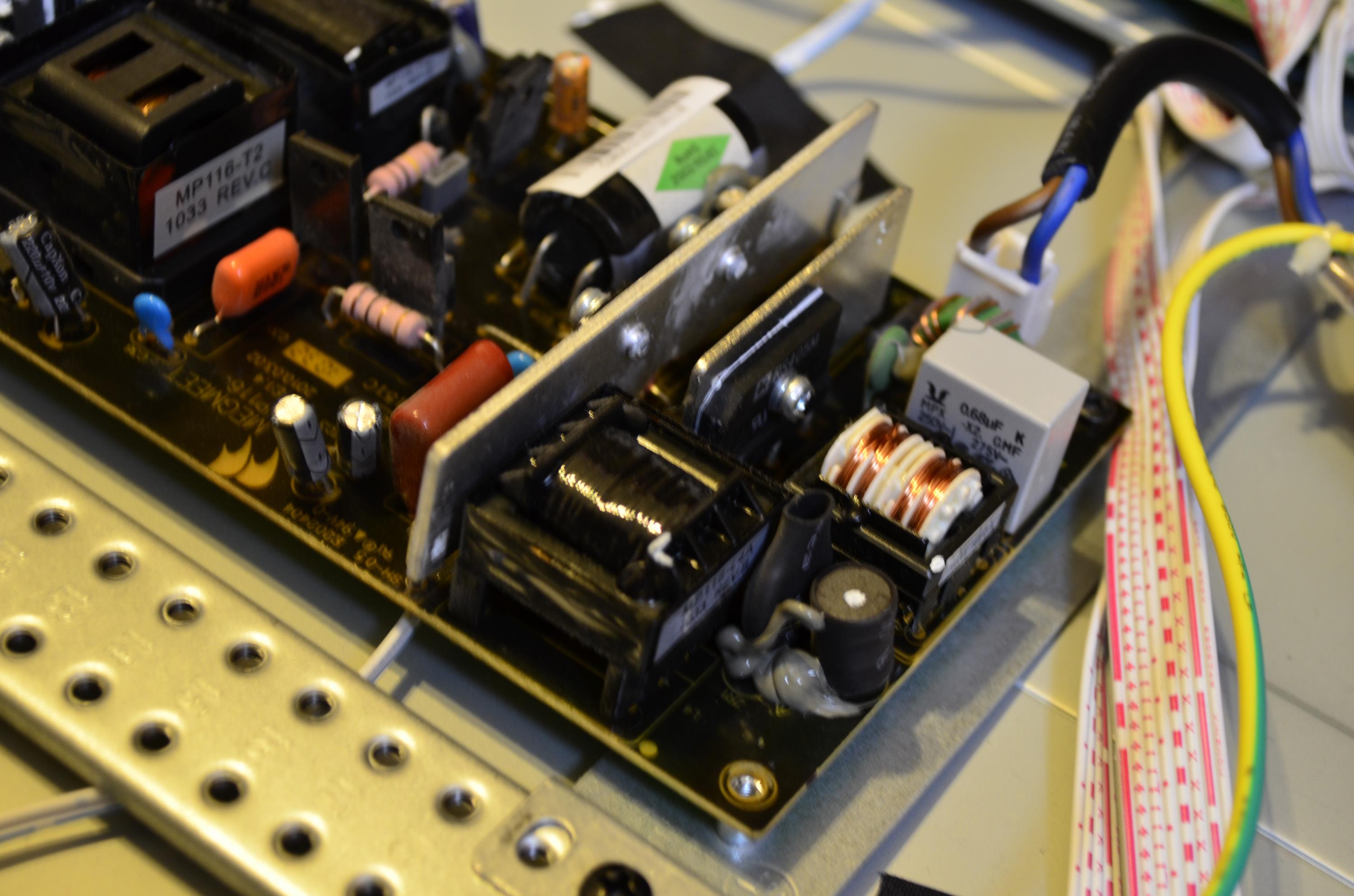

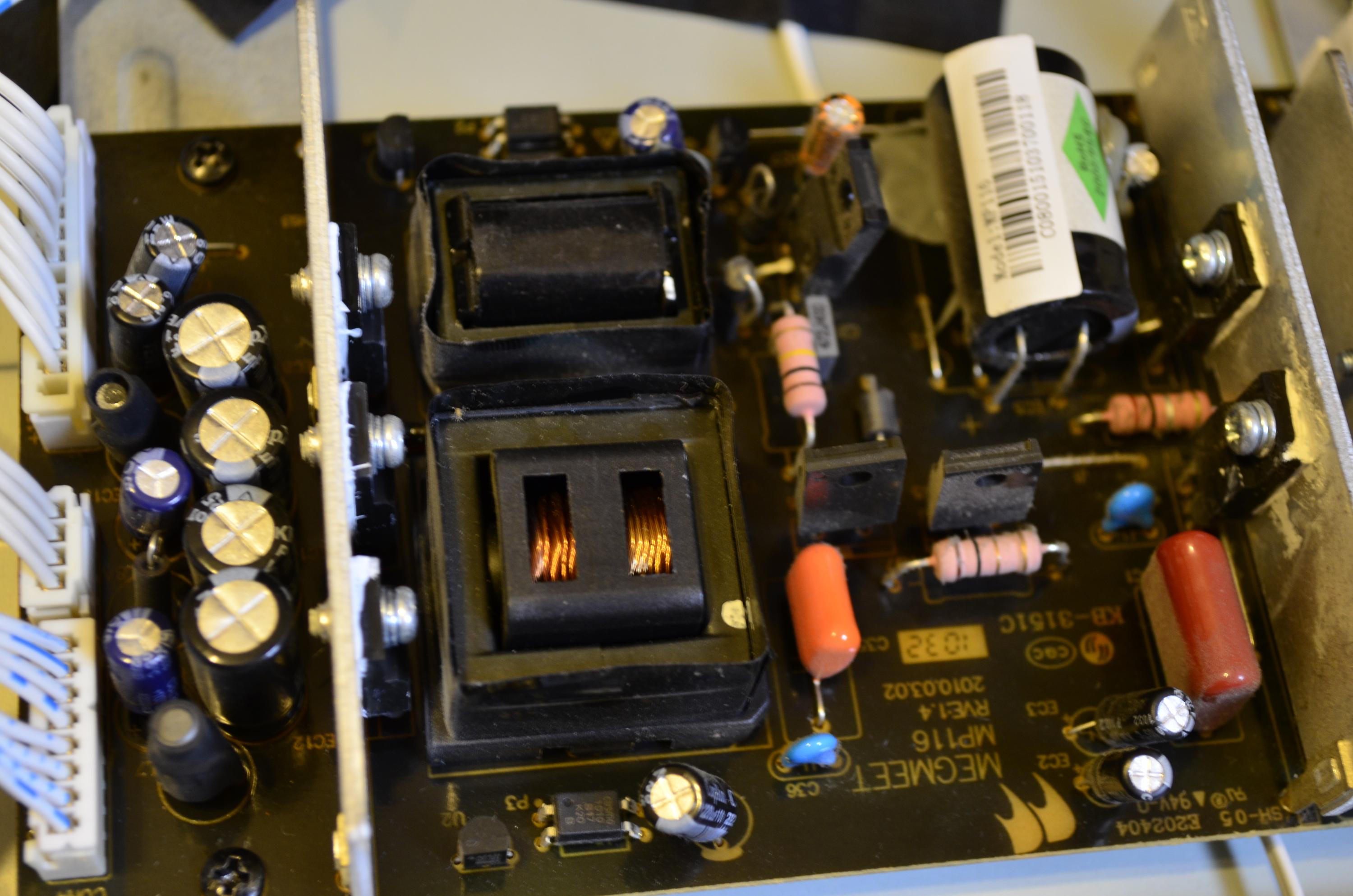

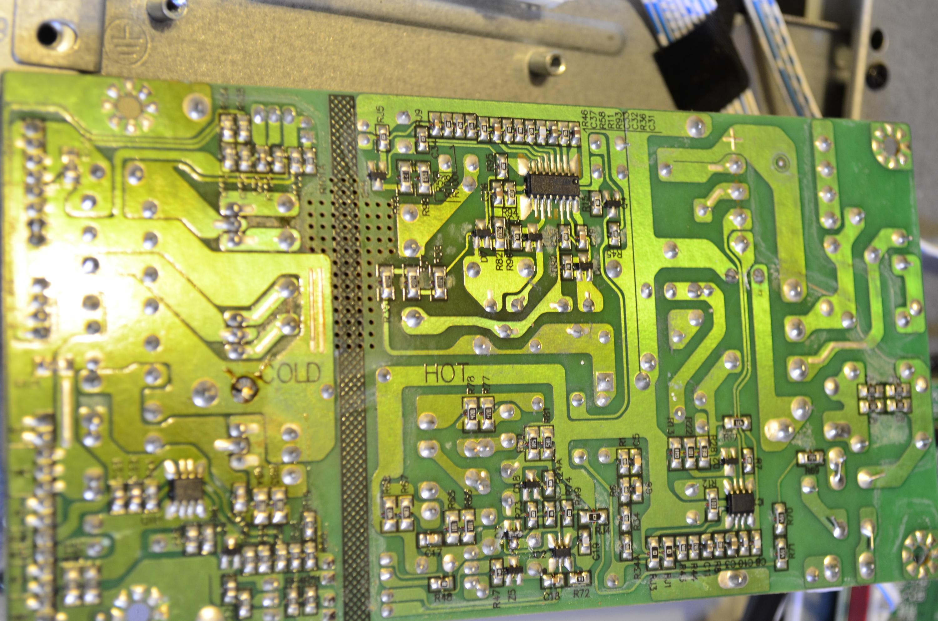

        Here are closer pictures of the board. I looked at c8 maybe there is something im not seeing, i also took pics of the back. There a little solder that looks goldish brown, could it have been a replacement or is it normal?

              The main cap stores the output from the PFC. There's nothing yet to measure in the PFC circuit, as it is working.
              That cap does look suspicious and I have encountered backlight flickering before when those caps go bad -- on different chassis TVs though, not on this one, which I have not seen before.
              If I were to shotgun this my guess would be the main cap or one of those poly (red) caps.
