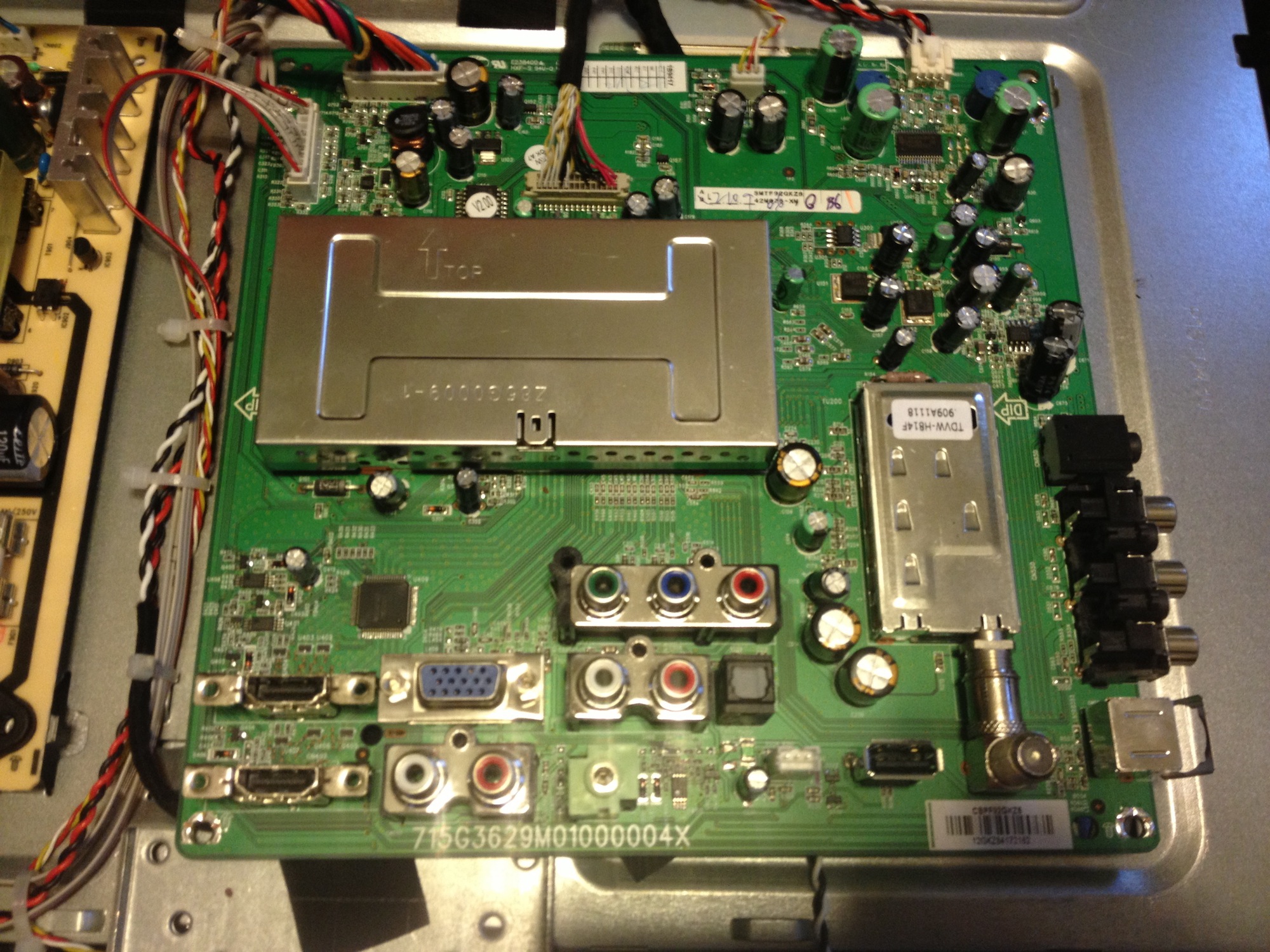

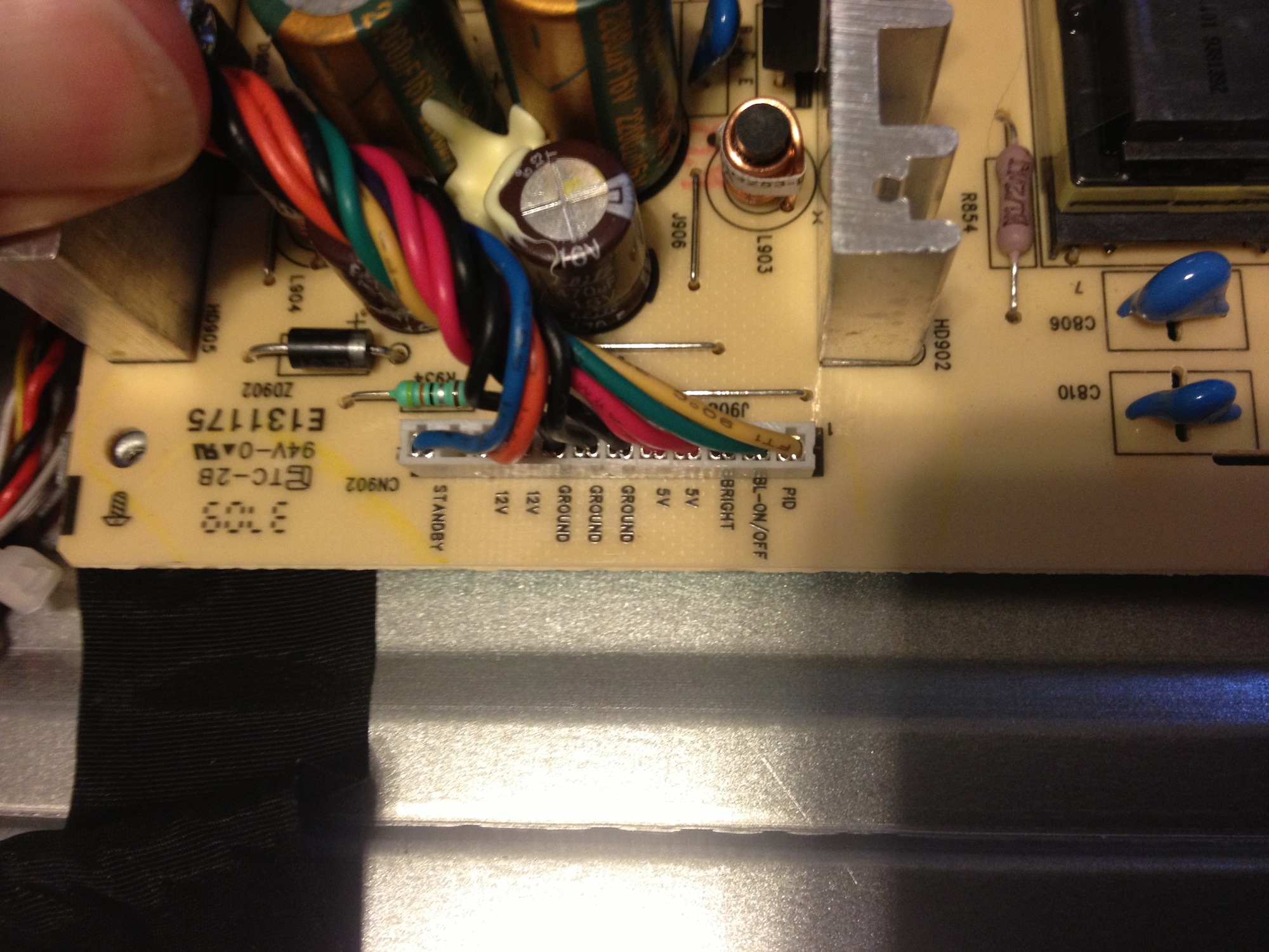

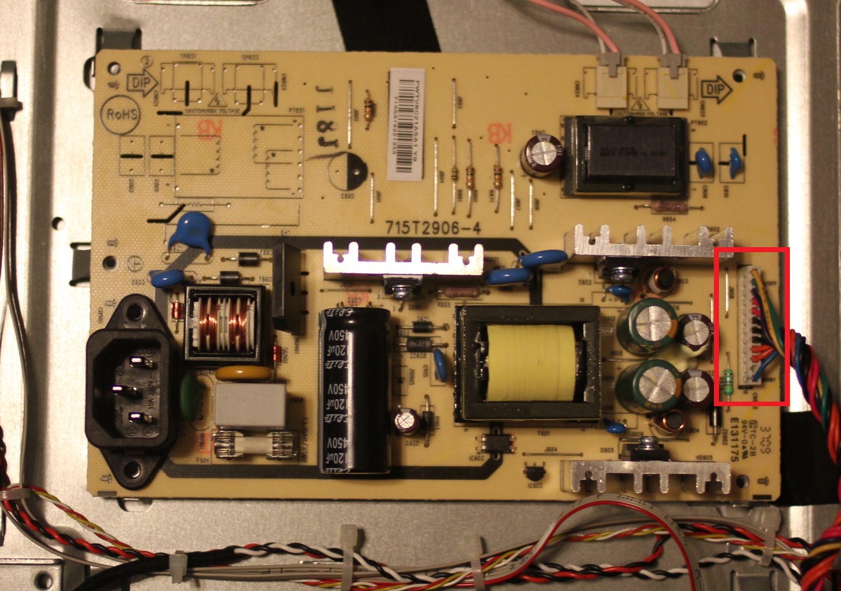

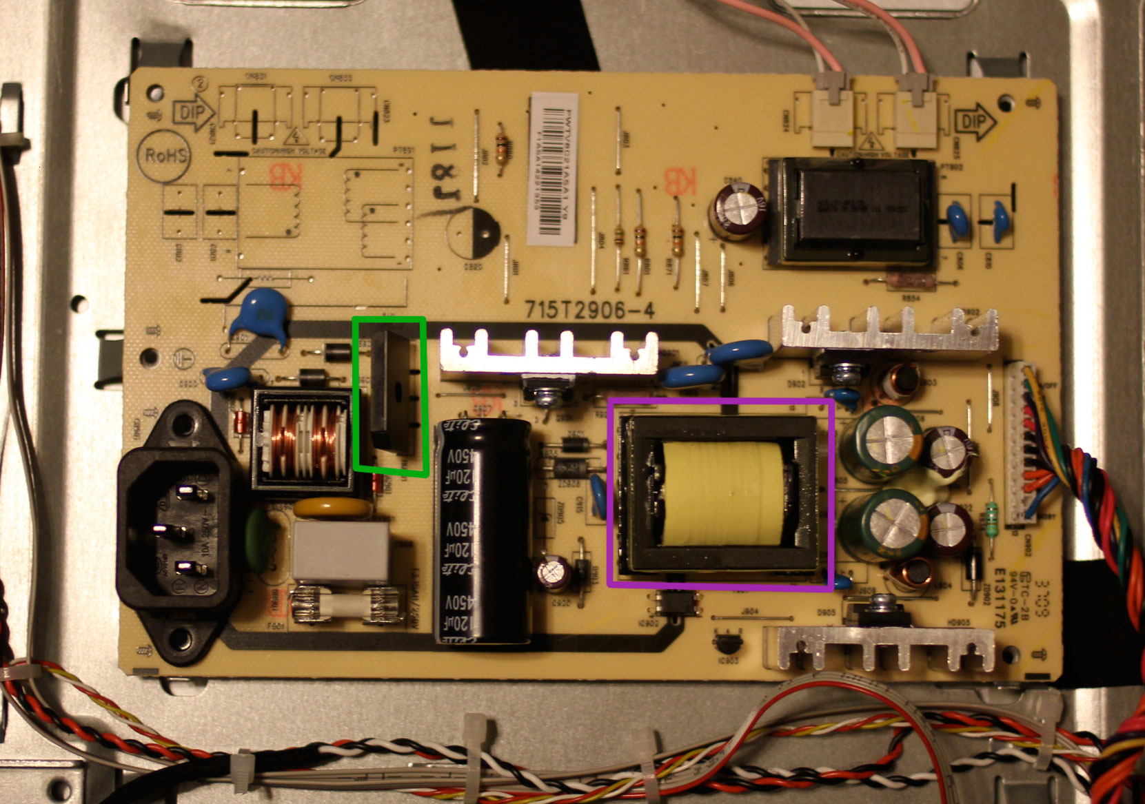

        Will you post a photo of the connector legend that i put a square around? Post a picture of the main board too. See if there are any fuses on the main board and see if they are good.

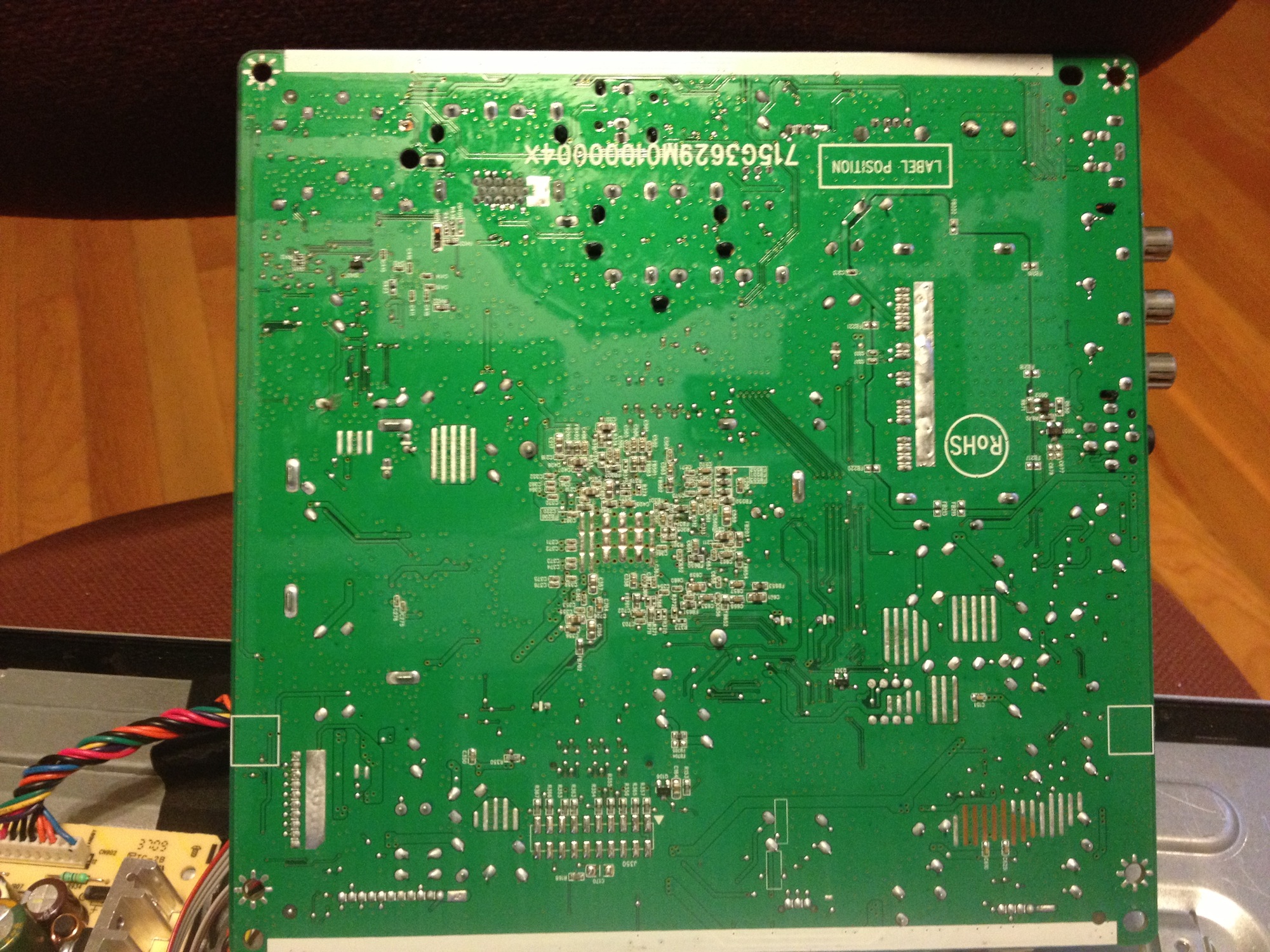

            Re: Vizio VA19L Won't Power On
            Why certainly!
            I don't see any fuses on the main board, but I may well have missed one. Let me know if any of you guys spot one...
            Also, let me know if I can post any other pictures that would be helpful. Thanks again!

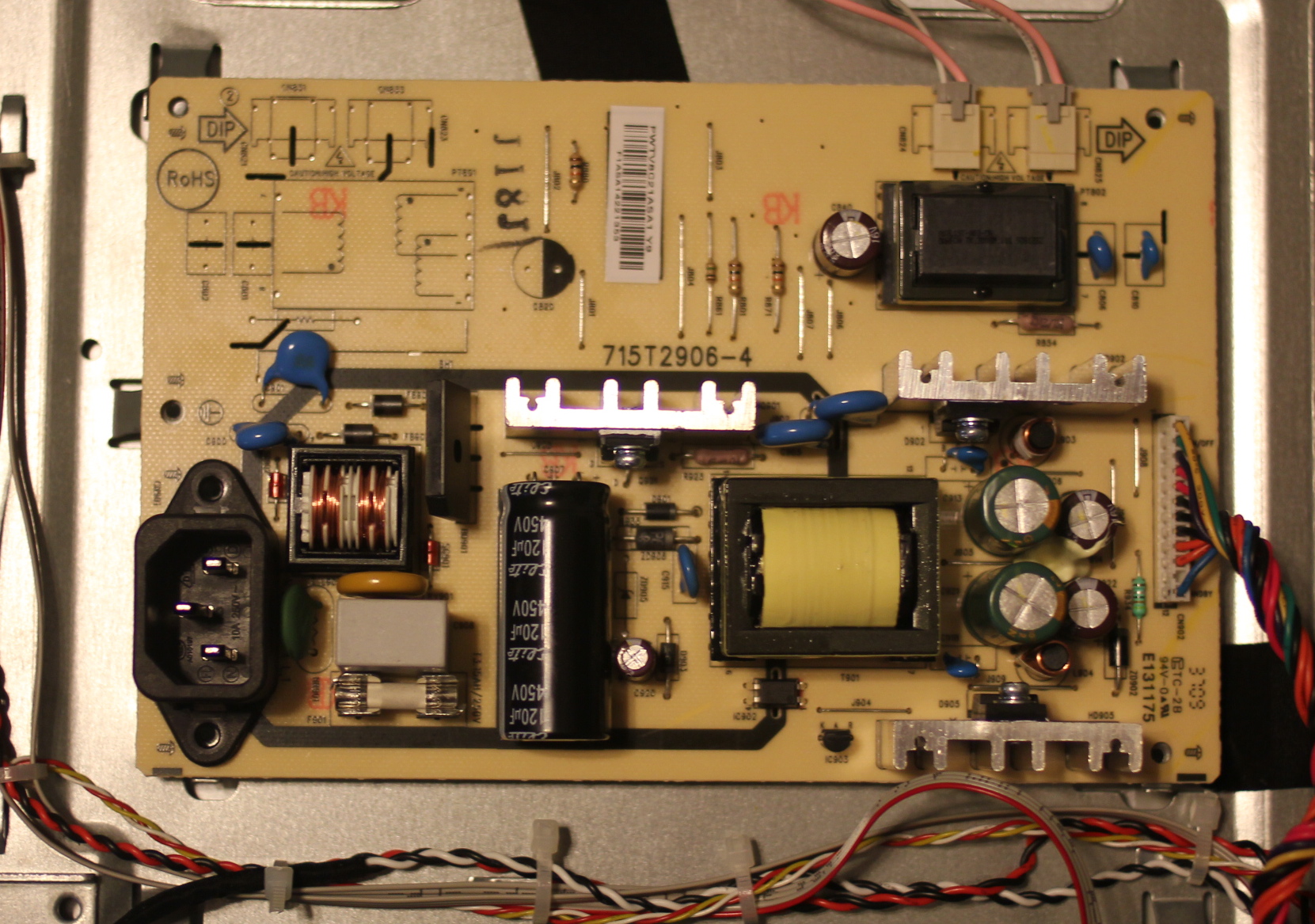

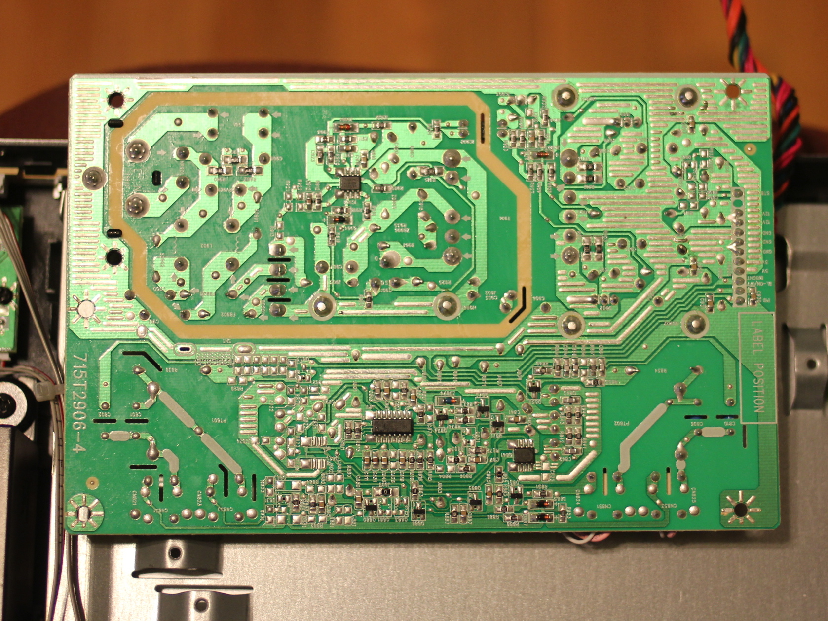

                      That yellow circuit board material is real easy to crack.
                      Can I get good closed up pictures of the bottom side of the power board, take pictures in 1/4 section of the board so I can easily zoom in the traces?

                        Also, I don't know if this is helpful or not, but I noted the following on these two components...
                        Green - 4 pins starting from north to south:
                        0V, 110V, 0V, 110V
                        Purple - 5 pins on the "west" side, starting north to south:
                        110V, 110V, 110V, 0V, 0V
                        On the "east" side, no voltage (AC or DC) on any of the pins.
                          The bridge rectifier (green) is ok since you are getting the 170vdc on the large cap ok.
                          the transformer is getting the power but does not look like it is switching, that is why i need to see bottom side of the board.
                          By the, when you measure the voltages on the primary side, you need to use the negative leg of the large cap as a ground ref, do not use the chassis as the ground ref when work in the primary side.
                              Sure thing, here ya go... I'm posting these offsite because they are 18 megapixel shots. That should allow zooming down to the molecular level
