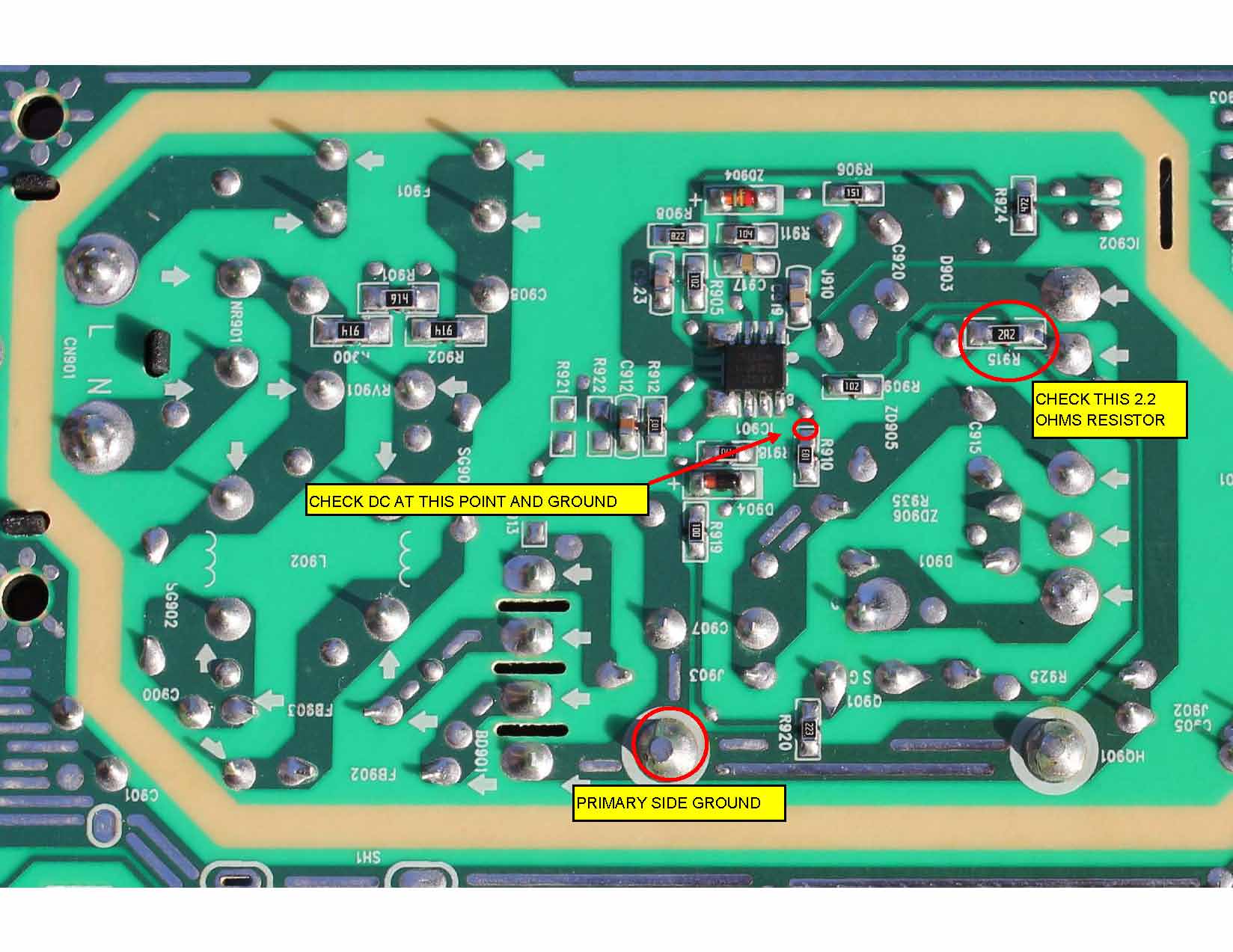

        Please take the resistance reading of the 2.2 Ohms resistor and the kickstart voltage at pin 8 of the IC.
        What is the P/N printed on that IC?
        Great pictures by the way. What did you use for the even lighting?

          First, I should apologize for the delay... I have been traveling for the holidays and catching up on work. I've finally had a chance to get back to this project, and wanted to update everyone who's been helping on the progress.
          One thing I want to note is that a week or so ago, I was able to procure a replacement power board exactly like the one we've been discussing on eBay for a very reasonable price. I figured even if it did not fix the problem, I could use it as a tool to continue learning about how all this works, and I may even be able to make one working board from the two.
          What I've discovered is that the new board appears to work, though I haven't yet installed it in the TV. I tested all the voltages at the connector going over to the main board and they appear normal on the new one (you'll recall I had 0V on all of them on the original, broken board).
          Probing around between the two, the main difference appears to be around the IC the budm has pointed out...
          The 2.2Ohm resister at R915 had 0VDC.
          On both the old board and the new one the voltage is 178VDC at pin 8 of the IC. Here's where it gets interesting though...
          IC Pin - Old Board - New Board
          1 - 0VDC - 12VDC
          2 - 0VDC - 0VDC
          3 - 0VDC - 0VDC
          4 - 0VDC - 1.5VDC
          5 - 0VDC - 0VDC
          6 - 0VDC - 0VDC
          7 - 0VDC - 0VDC
          8 - 178VDC - 178VDC
          What I've been trying in vain to figure out is which pin is the input pin for the IC. In other words, do I have a bad IC, or is pin 1 in the input and the IC isn't getting the 12V it needs to work its magic? I suspect the former given the 178V at pin 8, but I think it's clear at this point what my suspicion is worth...
          I can't read the old one at all, but the new one appears to say EA1530A.
          I had a morning option on the world's best lighting equipment: the sun I couldn't get decent lighting in my office so I took the board out on my deck and shot there...

              I think your TEA1530A is bad. Pin 8 get the voltage from the main B+ 170vdc to kick start the IC, once the IC start driving the Mosfet which drives the transformer, the AUX winding of the transformer output will get rectified to produce the 12vdC for the VCC pin 1 of the IC, then the pin 8 will not be used once it starts running. Just think of it like your car, you need the batteries to start up the car, once the engine is running, the power will be coming from the alternator and the batteries can be disconnected and the car will keep on running as long as the engine keeps spinning the alternator.

                            pin 8 Gets the kick start voltage from the main b+ which you indicated that it has about 170v so the feeding resistors are OK, that voltage on pin 8 feeds the internal current source which will charge up the start-up cap which is connected to the VCC PIN1, when that voltage reach Vstart (11V) on that start-up cap, the circuit will kick on (the current source will stop) and send out the drive signal at pin 6 which drives the MOSFET which drives the transformer, at that point, the AUX winding of the transformer (to the diode and the 2.2 Ohms resistor I have you checked earlier in post23) will be supplying the VCC to pin 1 to keep the IC running. Since you are getting 0V at VCC pin1, it means that that internal current source did not start the charge up process of the start-up cap. That is why I believe the IC is bad.
                            Since you have good board, what you can do is to do resistance reading comparison between the good board IC (TEA1530), MOSFET compared to the bad board.
                            To check the IC resistance, use pin2 (ground) as the ref point and measure all the pins of the IC with ref to Ground pin to see what you get on both boards.

                                    The 47uF 25V should be fine. The maximum voltage for the SMPS IC EA1530P is 20V DC and the startup is 11V DC as per

                                      Before you change the startup cap, you should measure the resistance as per budm post #33.
                                      We have seen this SMPS IC EA1530 go bad before. That is, VCC is shorted to ground.

                                          Thanks again guys... I tested on the old board, and it *does* appear that VCC is shorted to ground on the IC. I can't compare yet to the new board because that TV is now in use in our guest room
                                          As soon as I get an opportunity I'll compare the two and report back here, but it looks like I'll be ordering and replacing that IC soon.
