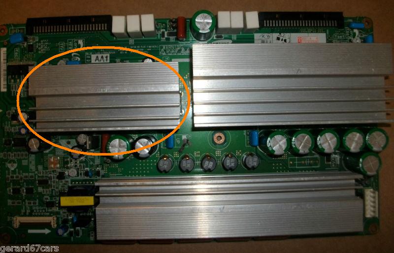

              Before you get a main, pull the ymain and test the 88n30w fets for shorts as it's common for these to go together with a shorted upper buffer board

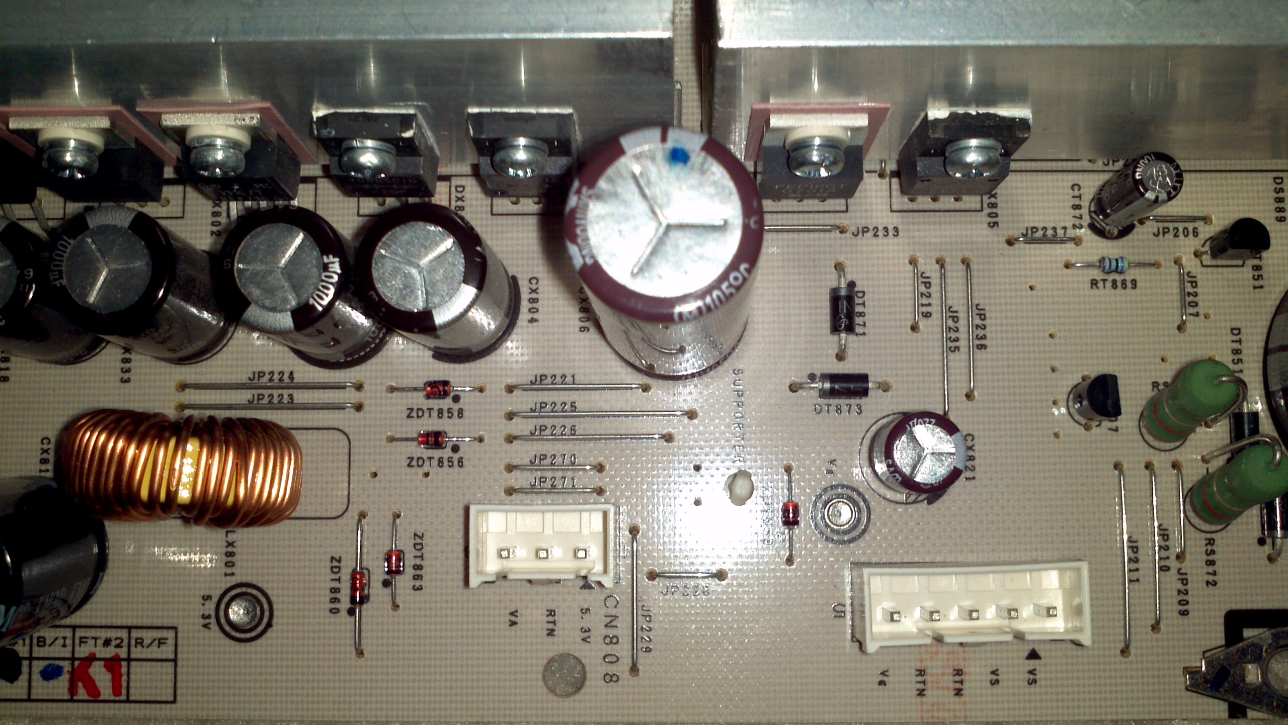

                I've checked the voltages while powered on. I'm missing the Ve. Instead of 94v I'm getting 4v. The cap near the test point 25v220uf reads .41. What should I start checking?

                    Common fault with this PSU is one or both of the MOSFETs on the middle heatsink (skinny one, in the center of the board) going bad. Our samsung has the same PSU, and it had a problem where it wouldn't power up (kept clicking). Two of the MOSFETs were bad.
                    Replace the two 1000uF 25v capacitors just below the inductors LX804 and LX803. Also replace CX814 and CX813. These all had bulged slightly on mine, but wasn't the direct cause of the problem.

                      I've replaced all four of the mosfets and the two caps at CX813/14. I just checked the esr of the four caps next to LX803/4. The two 25v1000uf are .12 and the two 35v470uf are .04. I've pulled one leg of the three big diodes near the four caps. I'm not sure of the readings. I'm getting 308,146 and 158 on the diode test. These are bottom of the board above CN801.

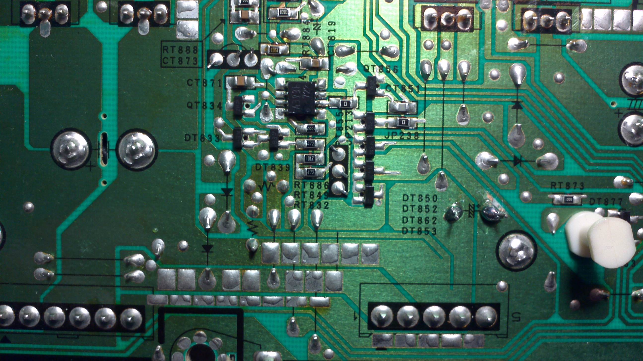

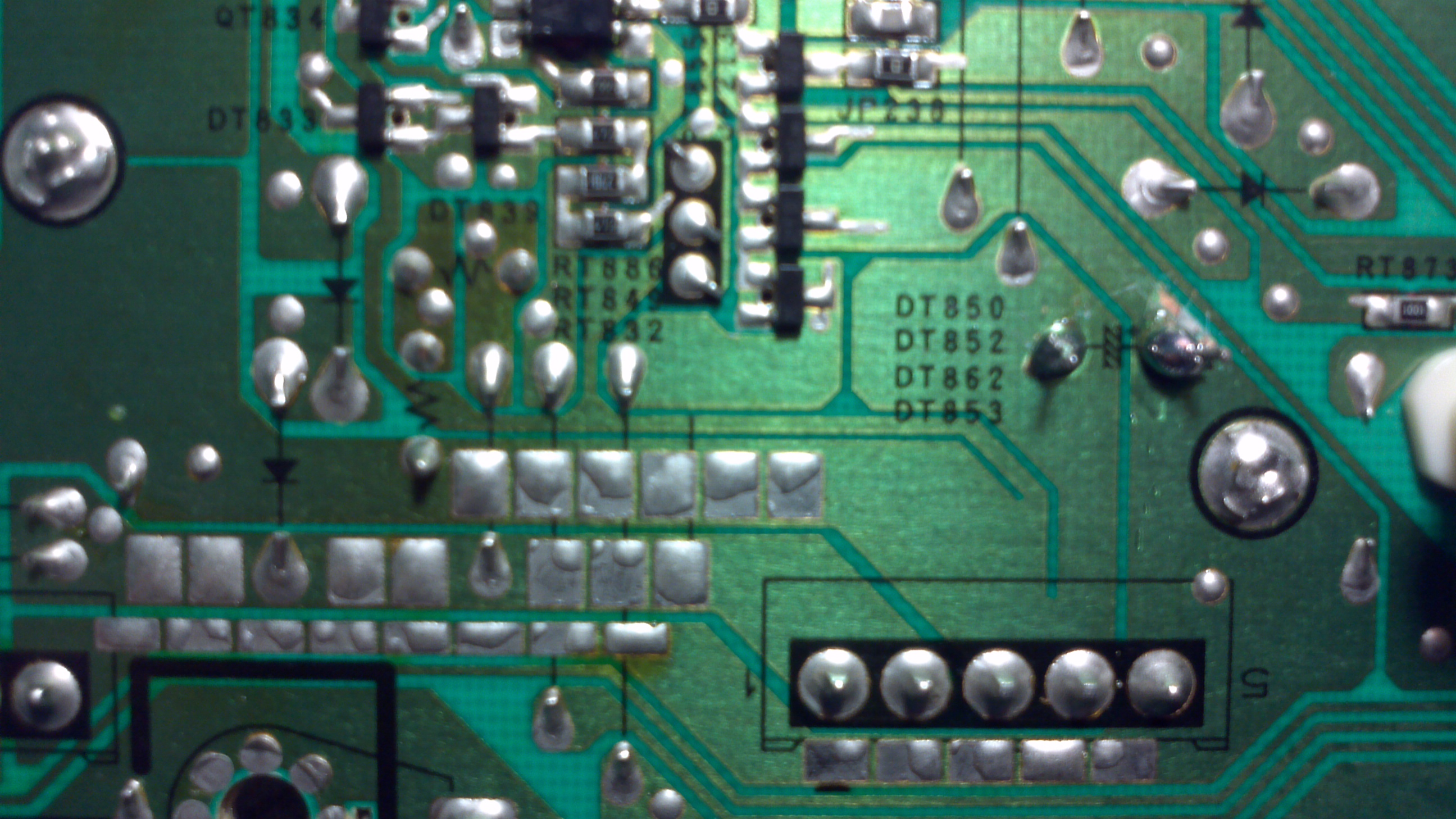

                                    If you look at the 3 pics above I removed the semiconductor on the right. It is connected to the Ve pin on
                                    CN809. I think it is bad but not sure if I'm testing it right. The part number is KIA7815API. The datasheet has pin1-input, pin2-gnd, pin3-output.
                                    In diode test with negitive on gnd I get nothing on input and output. With postive on gnd I get 578 on input and 678 on output.
                                    On 20k ohm there is nothing between 1-2,1-3, and 10.26 between 2-3. Which test is right and is this shorted like I think it is? Or am I just way off.

                                      7815 is a voltage reg 15v pos. input should be a couple of volts higher than 15 and output should be 15 volsts with the ps on. you should be able to find it at radio shack. i have always tested them by output voltage it is not a transistor it is an intergrated circuit.the center is common look up the data sheet for the input and output pins.

                                        I'd already look at the data sheet. But after I read your post the input/output hit me. I looked at the SM and the Ve 94v I'm looking for isn't coming from the PS. It comes from the x-main to the PS. Guess I should have ckecked the SM sooner.
