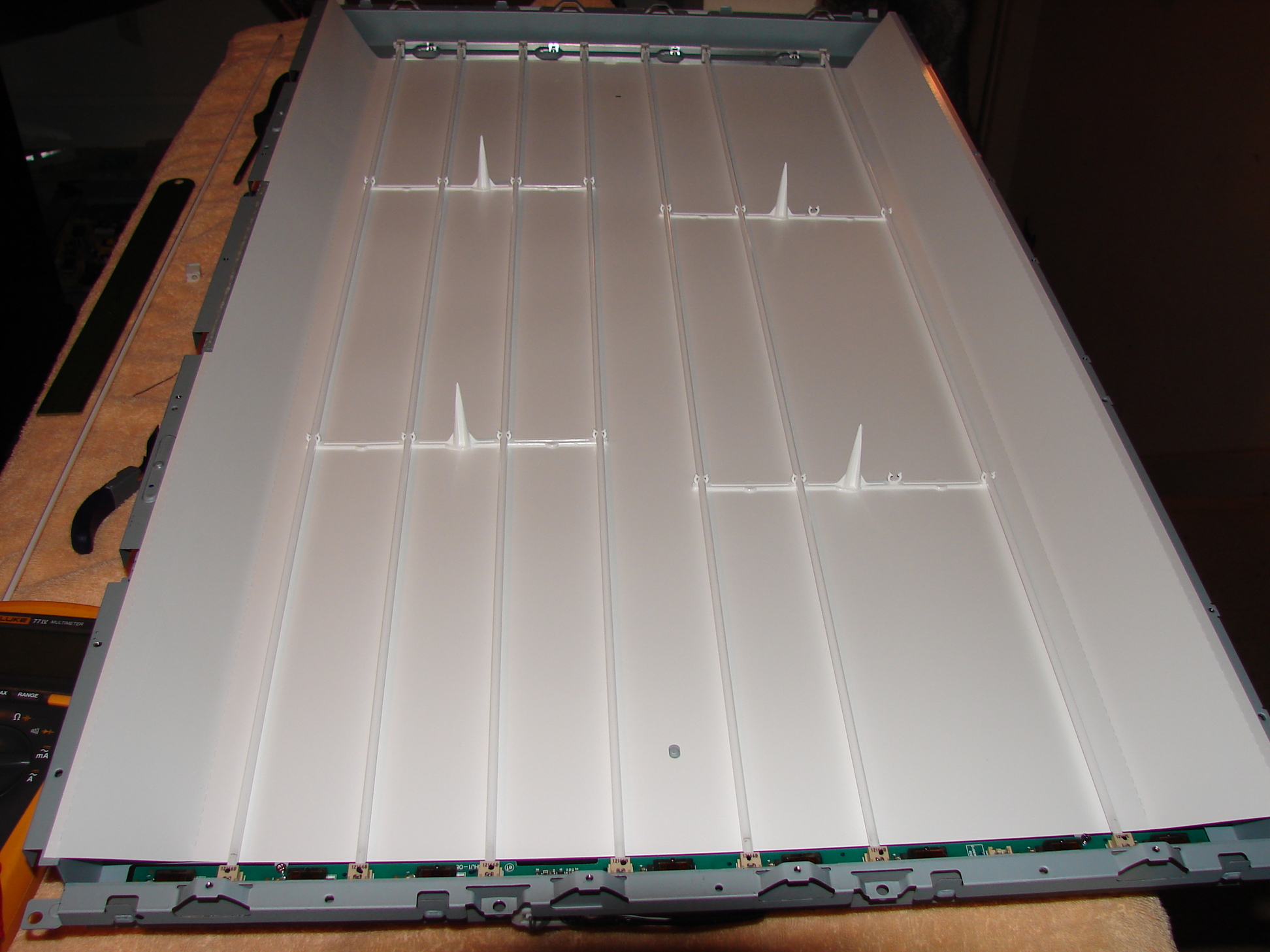

    So I got this Vizio in for repair and it had the 2 seconds to black symptom.
    For this normally I would order/work on the power supply but it seemed bare on the inverter side.

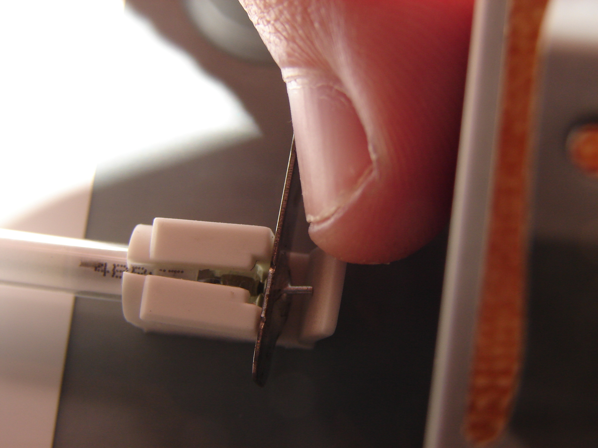

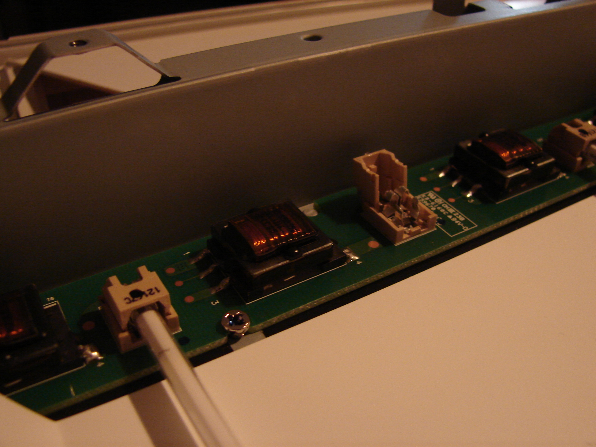

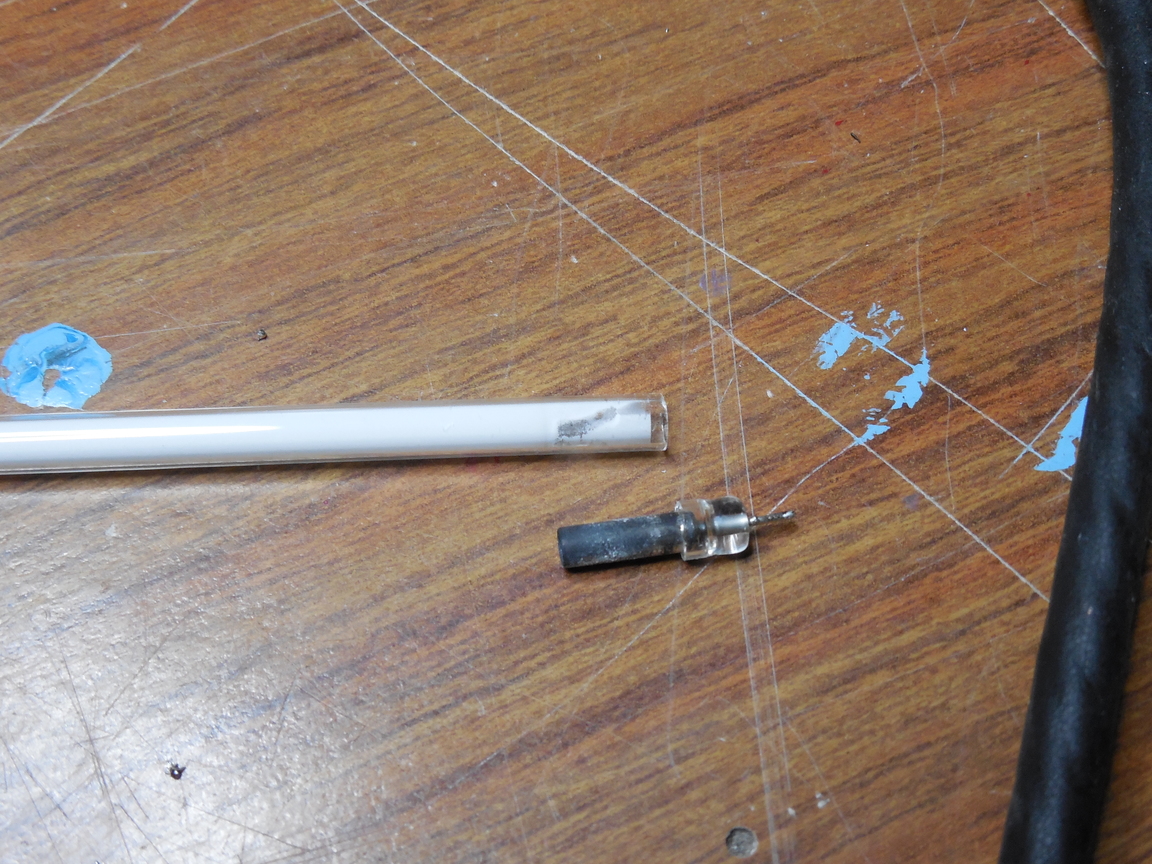

    It was really bothering me, so I took the LCD and diffusers out (not as easy as the 32" sharp). And behold, the little HV transformers for each bulb. Furthermore, I actually had a broken bulb so replacing is a little more of a pain as they soldered one end to a metal strip. (portable soldering guns are great for this)
    Just thought I would share, and I am really hoping the LCD works when it goes back in (i.e. doesn't crack)
    MS30834 is the part number that should fit this TV for CCFLs from lcdparts.net

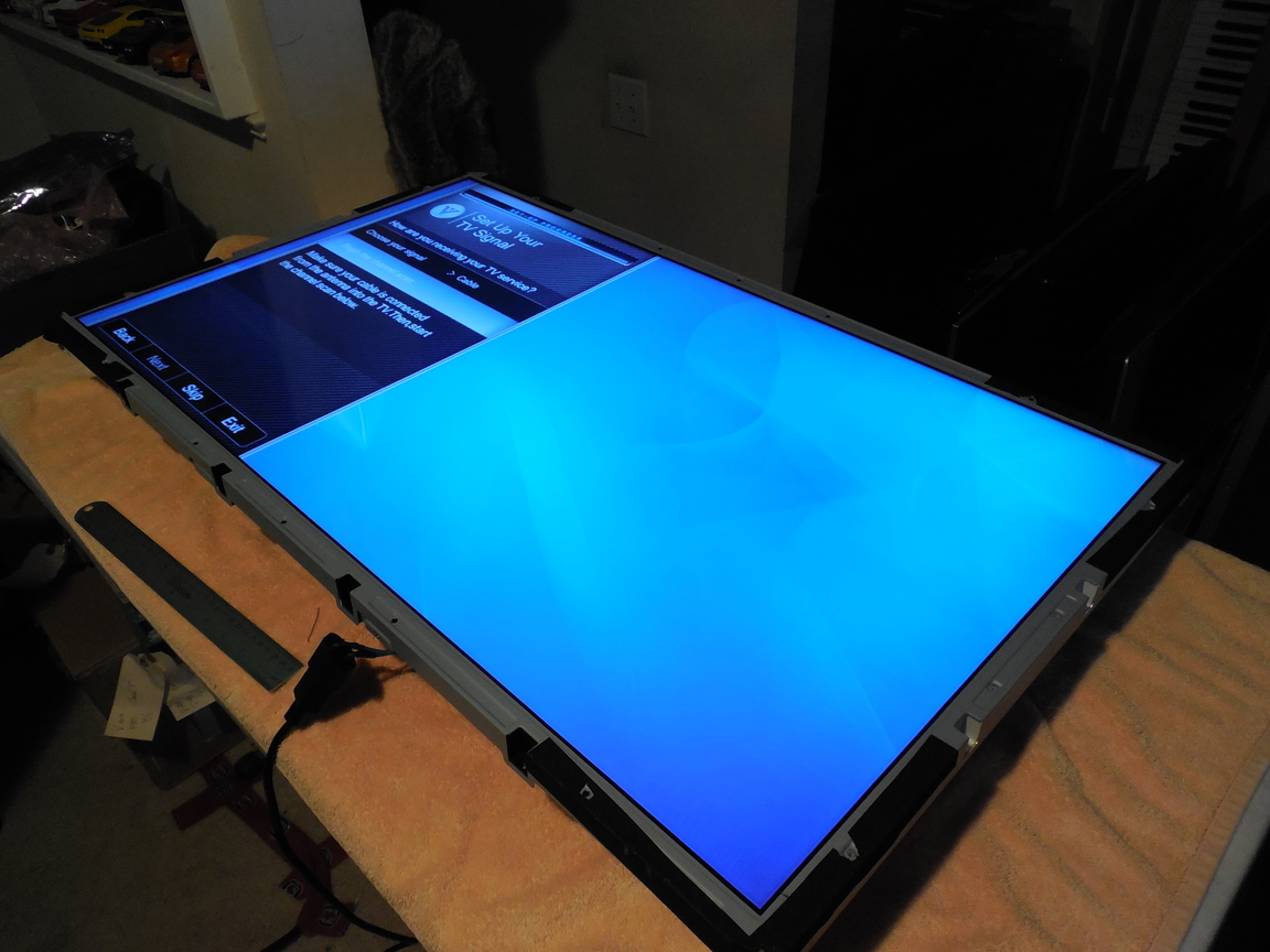

              Hey well thought I would post a follow up.
              Got the screen in with no problems but did run into a supply problem with the ccfls
              Apparently, lcdparts did not have those particular ones in stock :/ but out of chance, I was about to throw away a 39" insignia. Guess what, it had the exact same panel! Go figure haha
              So now with nothing in parts invested, this will be a good profit. (Well actually it was a trade for a free repair on another TV)
              And a quick side note/laugh - make sure the other side of the LCD is clean before installing - hair does show through the other side :P

                Holly cow, balancer transformers INSIDE THE PANEL! They really Do not want you to fix this TV. Good job fixing it.
