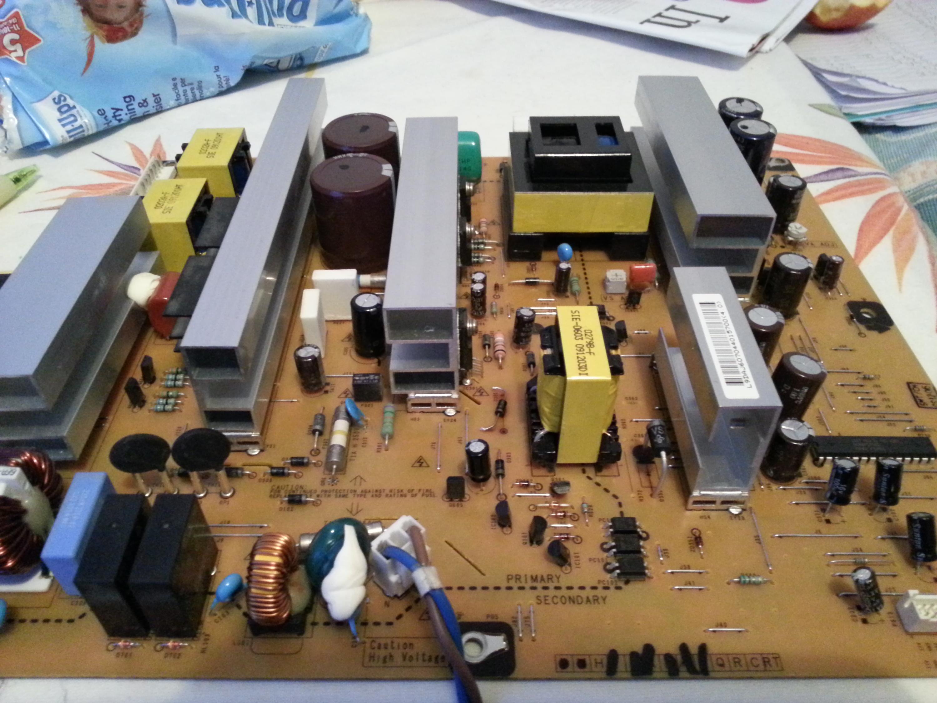

    Yeah you did, after looking at all the options in more detail it worked out better value with CHS (2 diodes for £7.00ish delivered).
    Farnells minimum £20.00 spend and postage ect. Do you think I would of been better of just doing what I was told first time round lol?
    Jarrett

        Right next move will be to get the blasted thing back down from the wall and replace the diode. I will make the legs a lot longer to aid cooling this time.

          Re: LG 50PQ6000 unstable 5v standby
          The replacement SB3200 has a 0.9v drop. The original VSB3200 has a 0.63v drop. That difference must have been why it failed.
          Muh-soggy-knee
            #145
            In addition, junction capacitance is much higher, which will lead to a slower reverse recovery, and earlier failure.

              So CHS need to update there details.
              Good spot guys I tried to match stuff up between the two and missed all that.

                OK CHS refunded my money and I have ordered 2 of these:

                          Ok well got the bits and no customs charge (bonus) and so swapped out the diode.
                          Did a quick test on the old one and it did test ok! So might have to issue an appologie to the nice lady at CHS. I have to say they have a good aftersales service at CHS but the website did not make it clear I was not going to get the exact part I ordered.
                          Digikey on the other hand sent exactly what I wanted so I am happy I have the correct part now.
                          Anyhow,
                          Swapped over the diode and still not working.
                          Did notice another diode I had tested last time looked a little hot/burnt? Tested that and its short circuit. You can see the diode removed in the picture (central).
                          I used the schottky diode as a quick test replacement and still nothing. Do you think this was a good test??
                          The diode is a:IN4007S 943
                          Repaired: LG50PQ6000
                            #153
                            1N4007 MUST be replaced with 1N4007. A normal diode has too low breakdown. 1N4007 is 1000V rated.

                                      Checked fuses replaced the diode and nothing. Psu clicked on then off. Sooooo something is up.

                                        What does standby voltage measure?
                                        • Baileybum1234
                                          • Sep 2012
                                          • 245
                                          #160
                                          Bit of a weird one.
                                          Control board unplugged 2.8v.
                                          Control board plugged 0.4v. Power TV jumps upto 4.28v then hit standby it sits at 4.28v for about 40 seconds then drops suddenly back to 0.4v.
