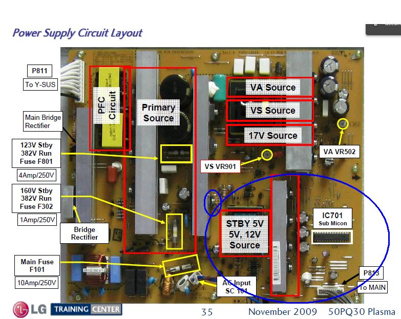

                              Ok IC301 could be something to do with it. Its a str w6252 9531p ssome kind of protection device if it was playing up it would effect the standby 5v.
                              Also need to work out what tappings on the coil I need to look at and the 3 components strapped to the heat sink what they should measure.
                              Its hard to see how exactly the 5v standby is made by following the tracks. Does any one have a simular circuit diagram or have they done it before?
                              Circled in blue.
                              Repaired: LG50PQ6000

                                  Does any one know of a link that talks through the path and demonstrates how the standby 5v is made?
                                  I have tried to follow the tracks back but they just dissapear.
                                  I feel if I could wok out how the sb5v is produced I could start looking at the components inline and testing them.
                                  Hopefully then working out why I have a low 5vSB might hold a clue. Also maybe I could follow the path and lift a leg on a component to see if the voltage goes upto 5v again indecating a short?
                                    #217
                                    Re: LG 50PQ6000 unstable 5v standby
                                    It just comes from the transformer, goes through a diode, into a capacitor.
                                    There's a feedback loop to regulate it too.

                                      AC Voltage is supplied to the SMPS Board at Connector SC101 from the AC Input assembly. Standby 5V is developed from 160V source supply (which during run measures 380V measured fromthe primary fuse F302).
                                      This supply is also used to generate all other voltages on the SMPS. The STBY5V (standby) is B+ for the Controller (IC701) on the SMPS and output at P813 pins 11 and 23 then sent to the Main board for Microprocessor (IC1) operation.
                                      So it looks like a good place to start. I should measure 160V across F302 in standby and 380v in run.
                                      Please could I just confirm im measuring across the fuse and not to ground and is it DC or AC at this point. Im in two minds about the second point so would like a second opintion.
                                      Jarrett
                                        #219
                                        Your ground ref on the primary is the negative lead of the large caps. Measuring a substantial voltage across a fuse is never good. It indicates the fuse is blown.
