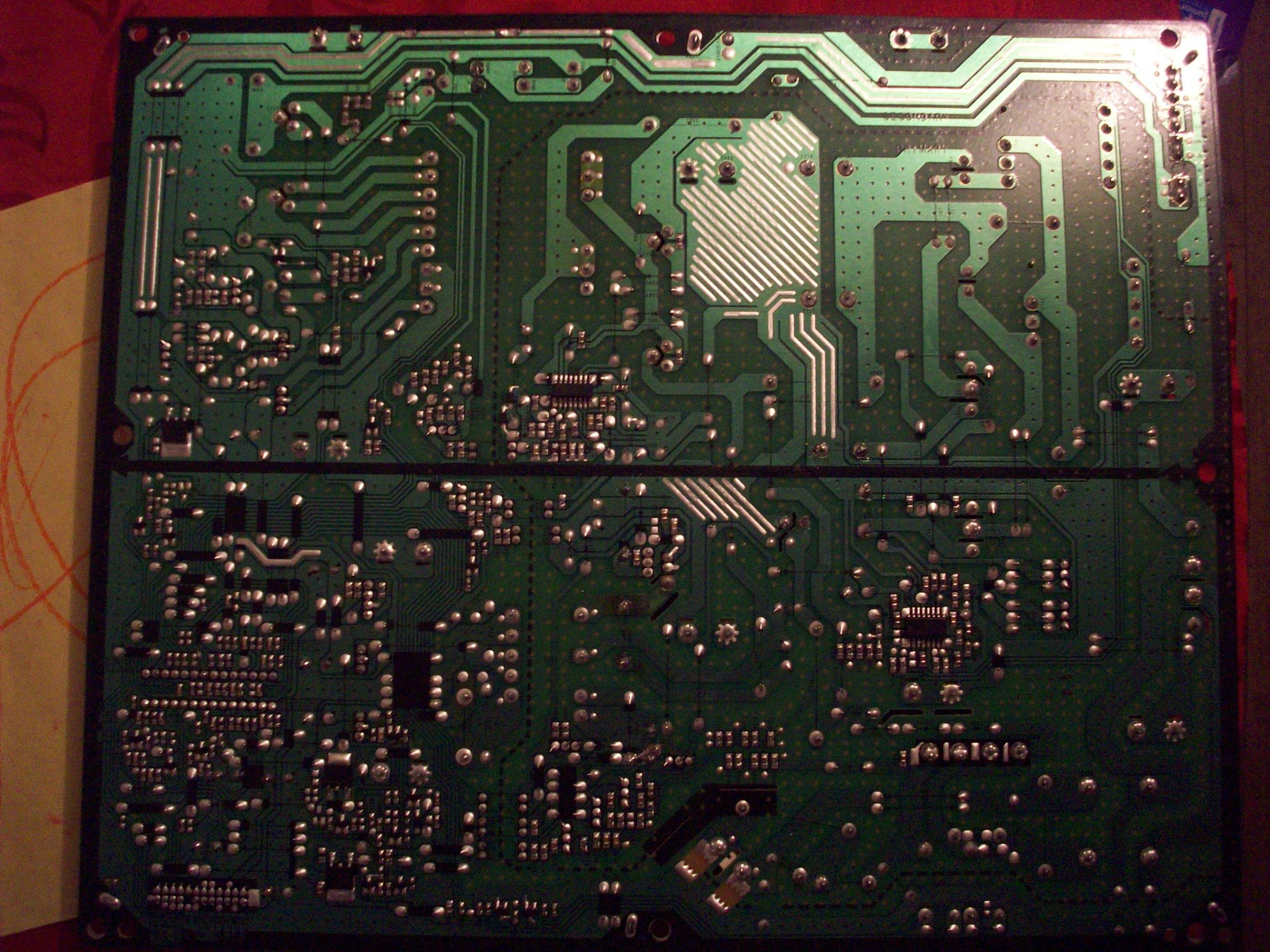

                  Re: LG 50PQ6000 unstable 5v standby
                  Can you get a little wider shot of the back (green side) -- include the transformer pins.

                      #70
                      Any better?
                      Repaired: LG50PQ6000

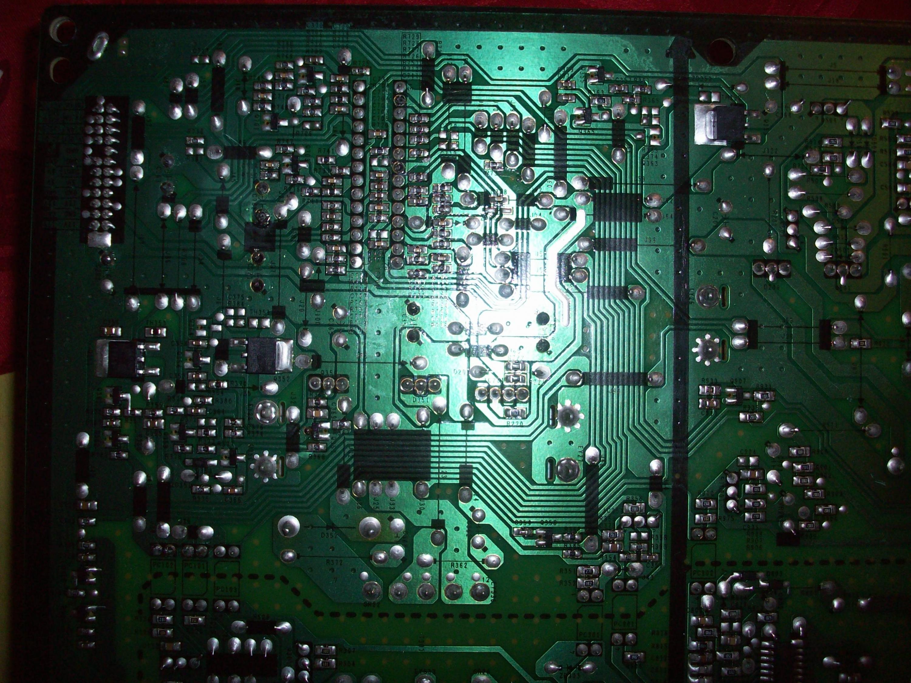

                                    #77
                                    Thanks for the big photo but I meant just a little bit expanded around the same area, not the whole board. I am trying to figure out where the 12V comes from.

                                        • Baileybum1234
                                          • Sep 2012
                                          • 245
                                          #80
                                          Its hard to avoid flash reflection but hope this helps.
