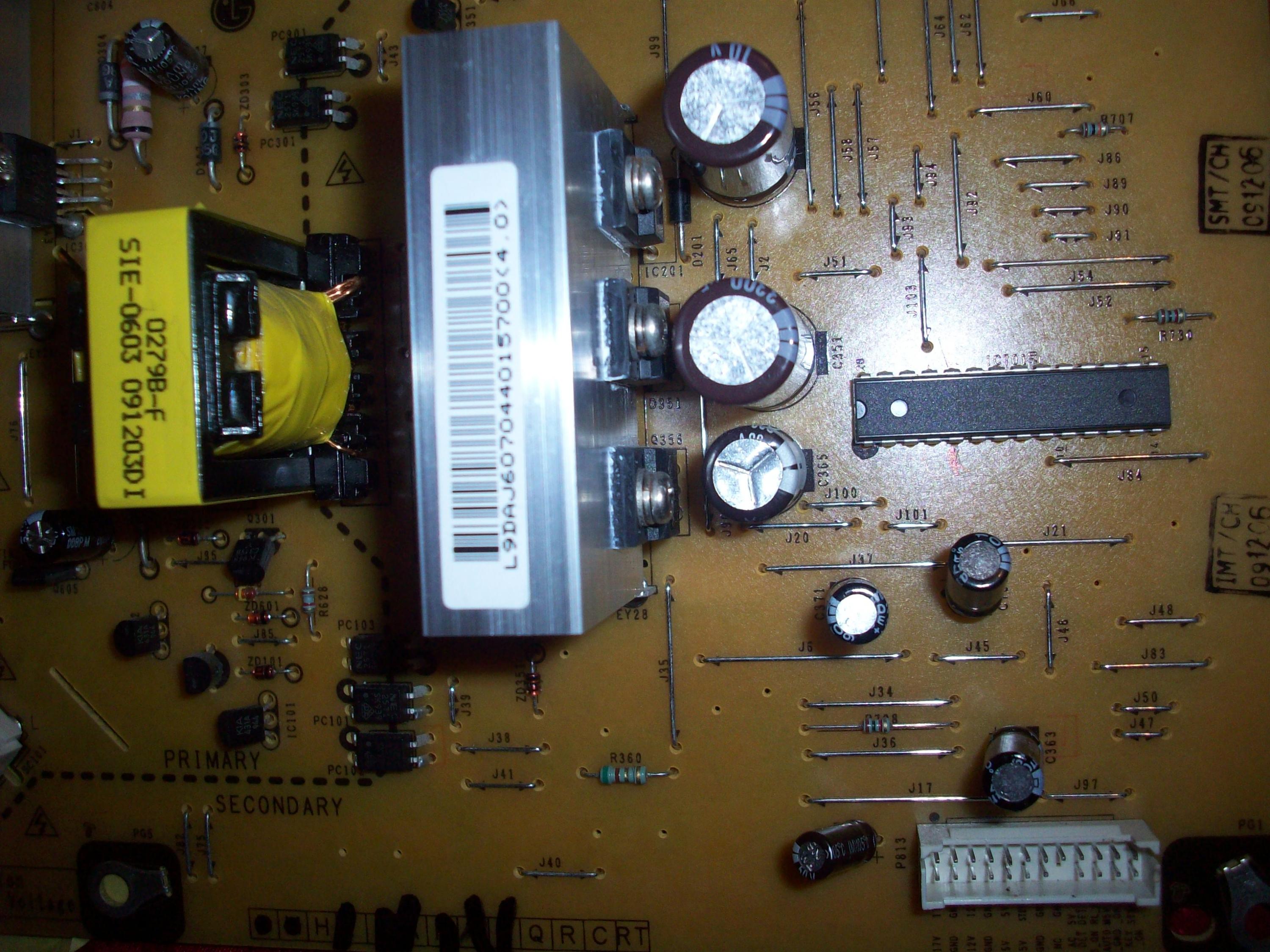

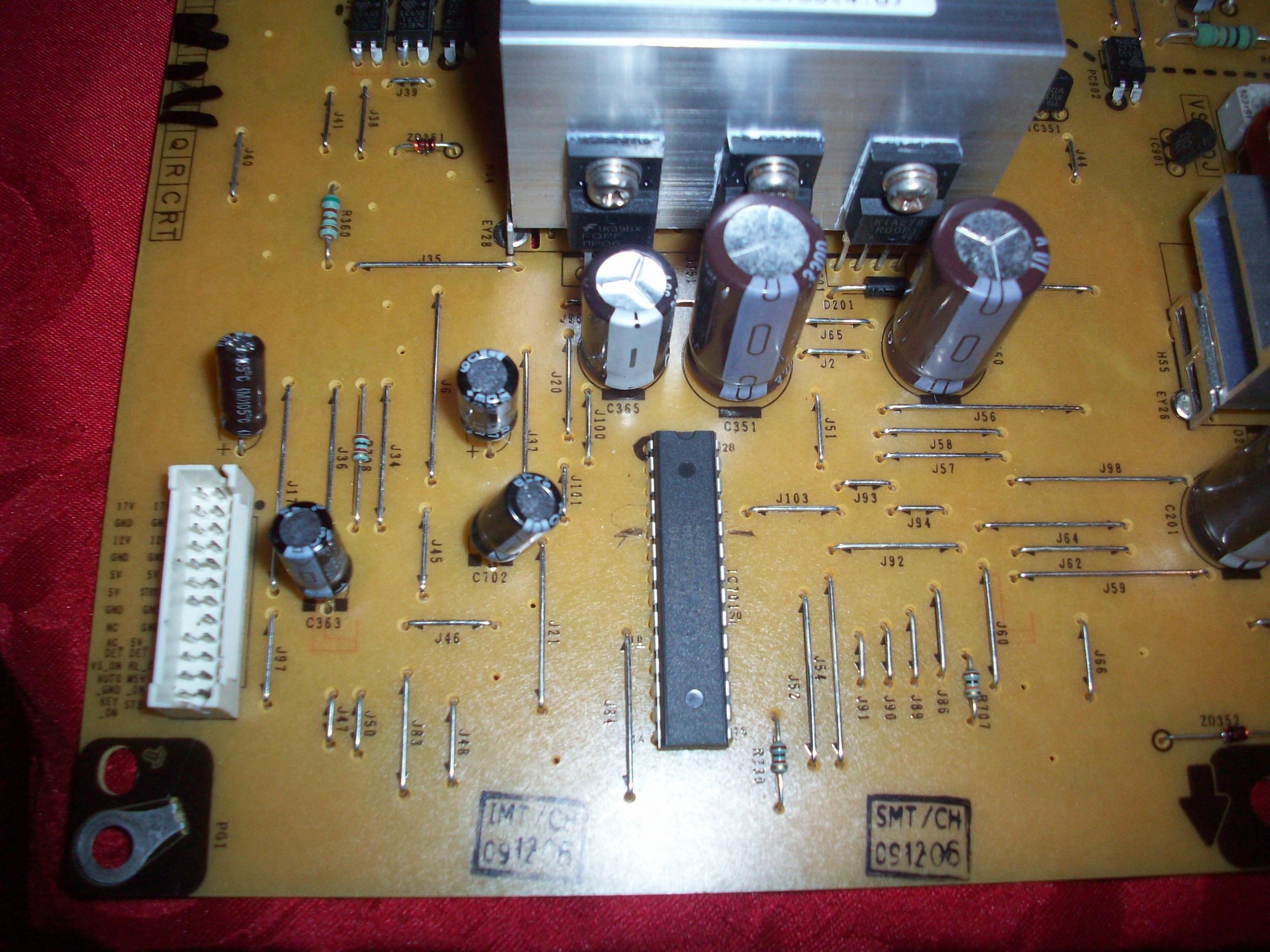

                              Can you take a close up of that side of the board? So we can see the ICs/rectifiers part numbers?
                              Muh-soggy-knee
                                #55
                                Re: LG 50PQ6000 unstable 5v standby
                                Originally posted by ben7 View Post
                                They are saying that the 5v standby is derived from 12v [standby]?
                                I think there could definitely be an issue with the capacitors.

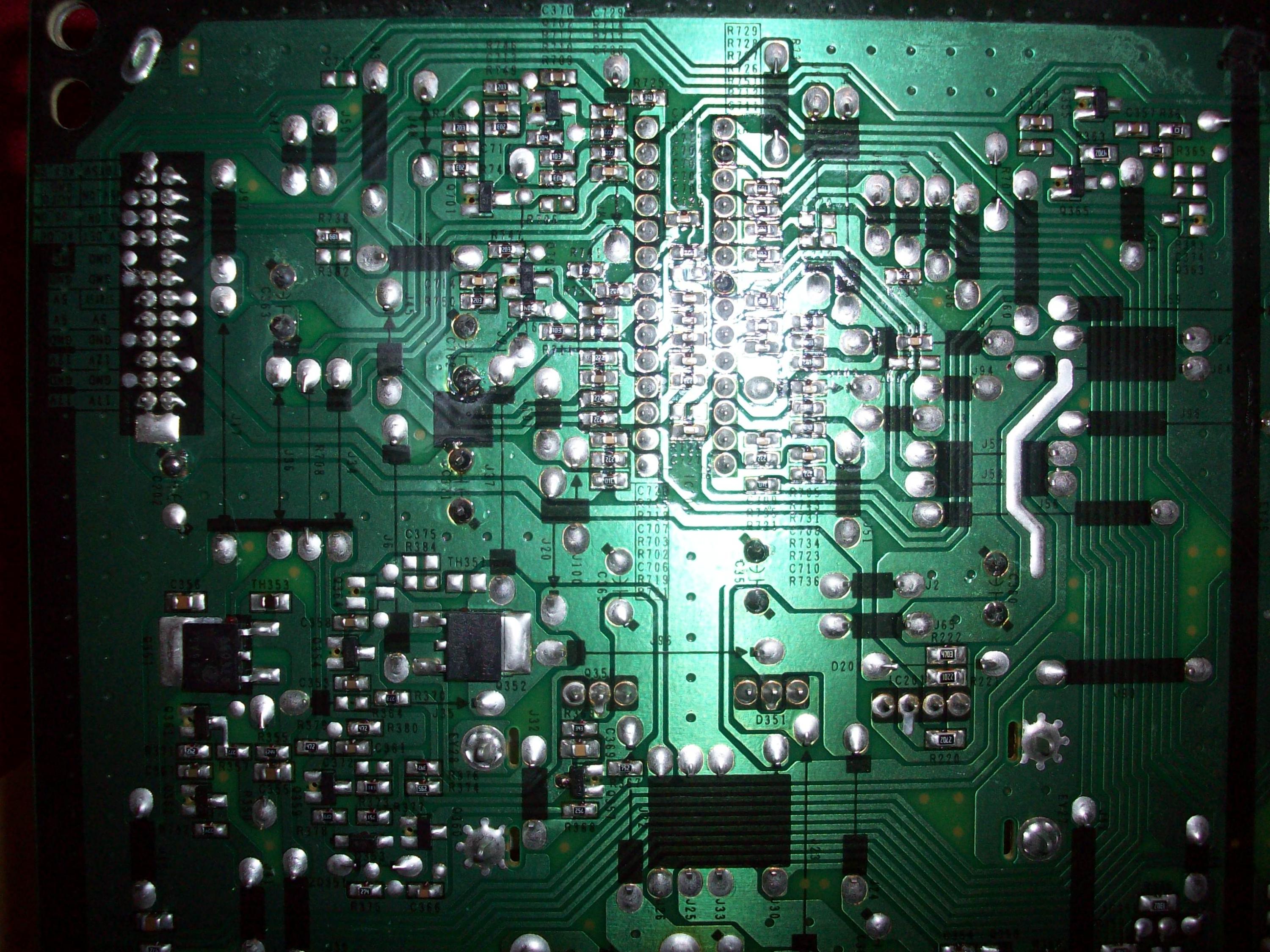

                                Hope these are good enough.
                                Repaired: LG50PQ6000

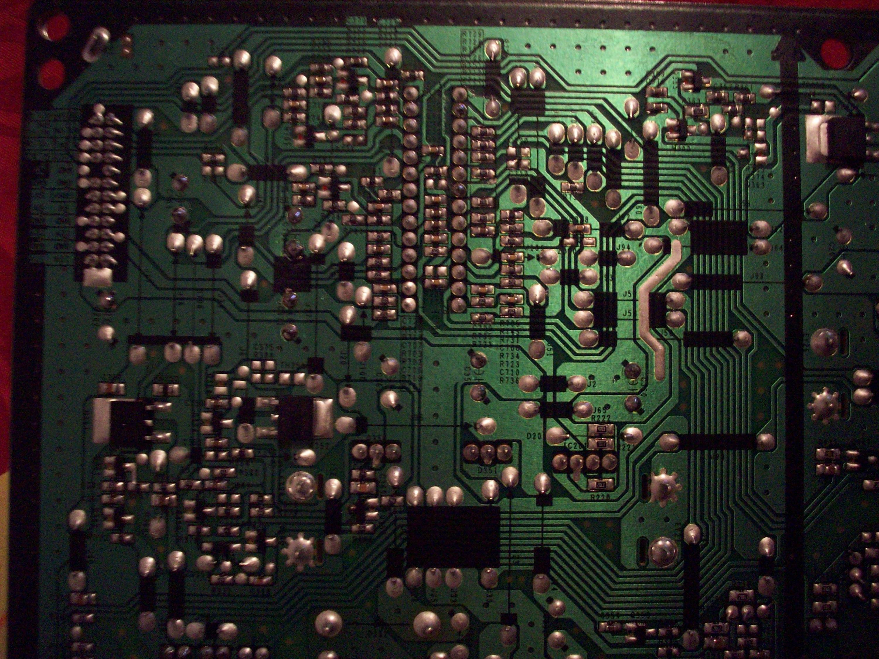

                                  #56
                                  Do you need the back also?
                                    #57
                                    Sure, wouldn't hurt!
                                        If possible. I suspect the 5V MAIN is derived off here...
                                        If the 12V is also low by about the same amount (30%), then the suspect would be the primary side, controller IC, or TL431.
                                          Rear of low voltage board area.
