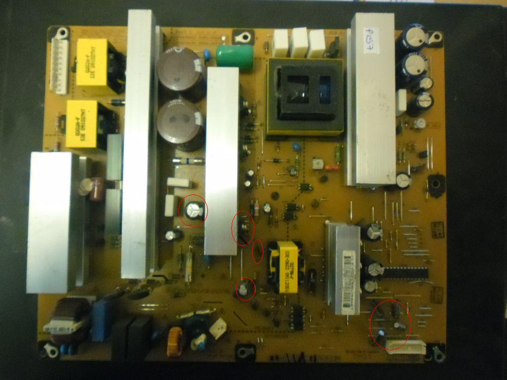

                          Re: LG 50PQ6000 unstable 5v standby
                          Hope this is a good enough image. Its a picture I found on the web and exactly the same board.
                          The things I have ringed are what I think is the IC that supplies the 5v, I have tested the zener I ringed and already replaced the capasitors I have ringed but there obviously not the right ones
                          I also notice that zener and IC getting very hot (burn mark under the zener diode eventhough tested fine) when connected to the main board.
                          Repaired: LG50PQ6000
                            It's not really good enough, plus we need pictures from underneath...
                            I have heard of some people replacing that IC on the heatsink, though cannot find the video I watched on it right now...
                              Hm, replace all the secondary filter capacitors in the bottom right of the PSU.
                              Also, is there a snubber network on the primary side? (usually is a power resistor, and a film capacitor, and a diode. Sometimes also a zener)
