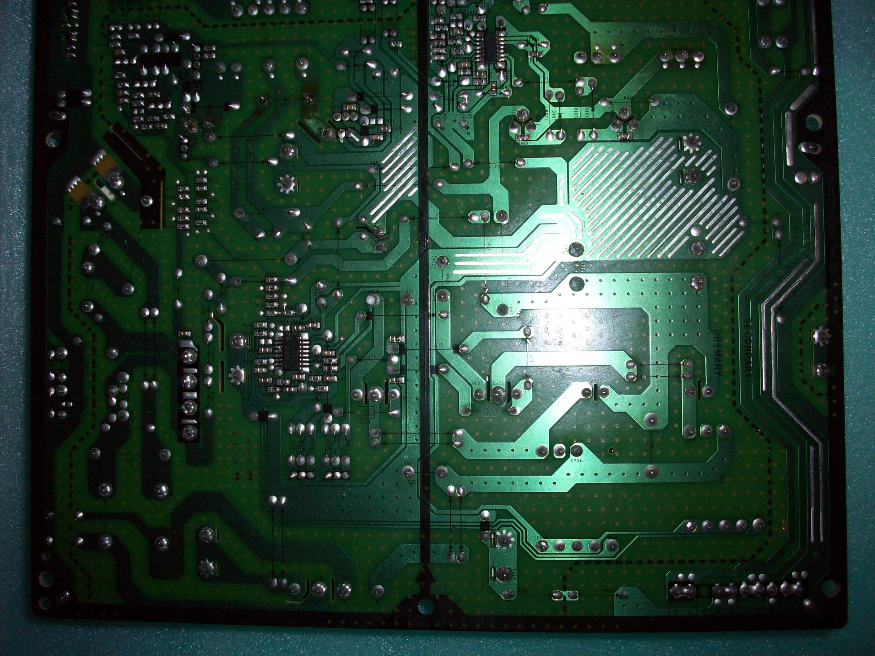

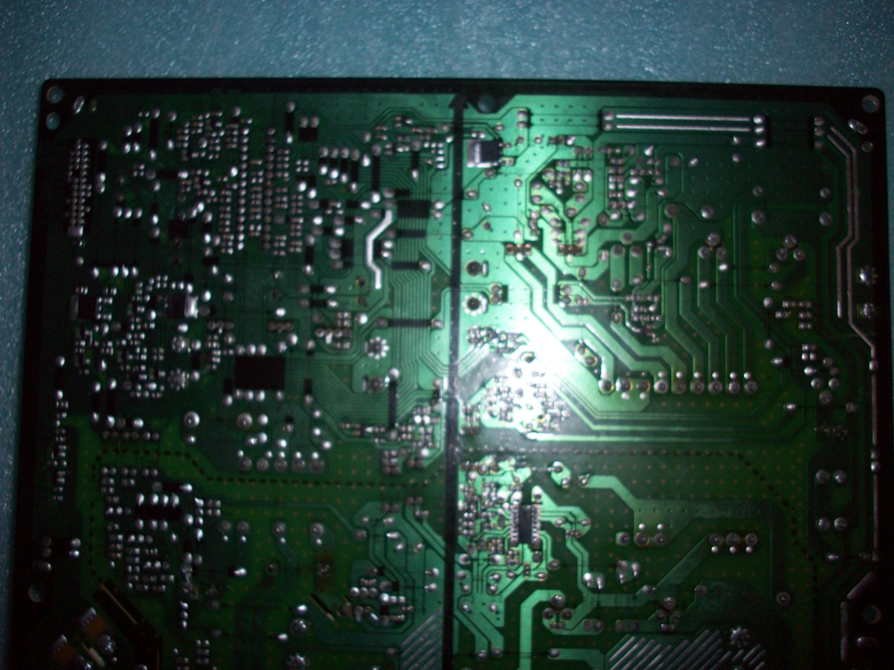

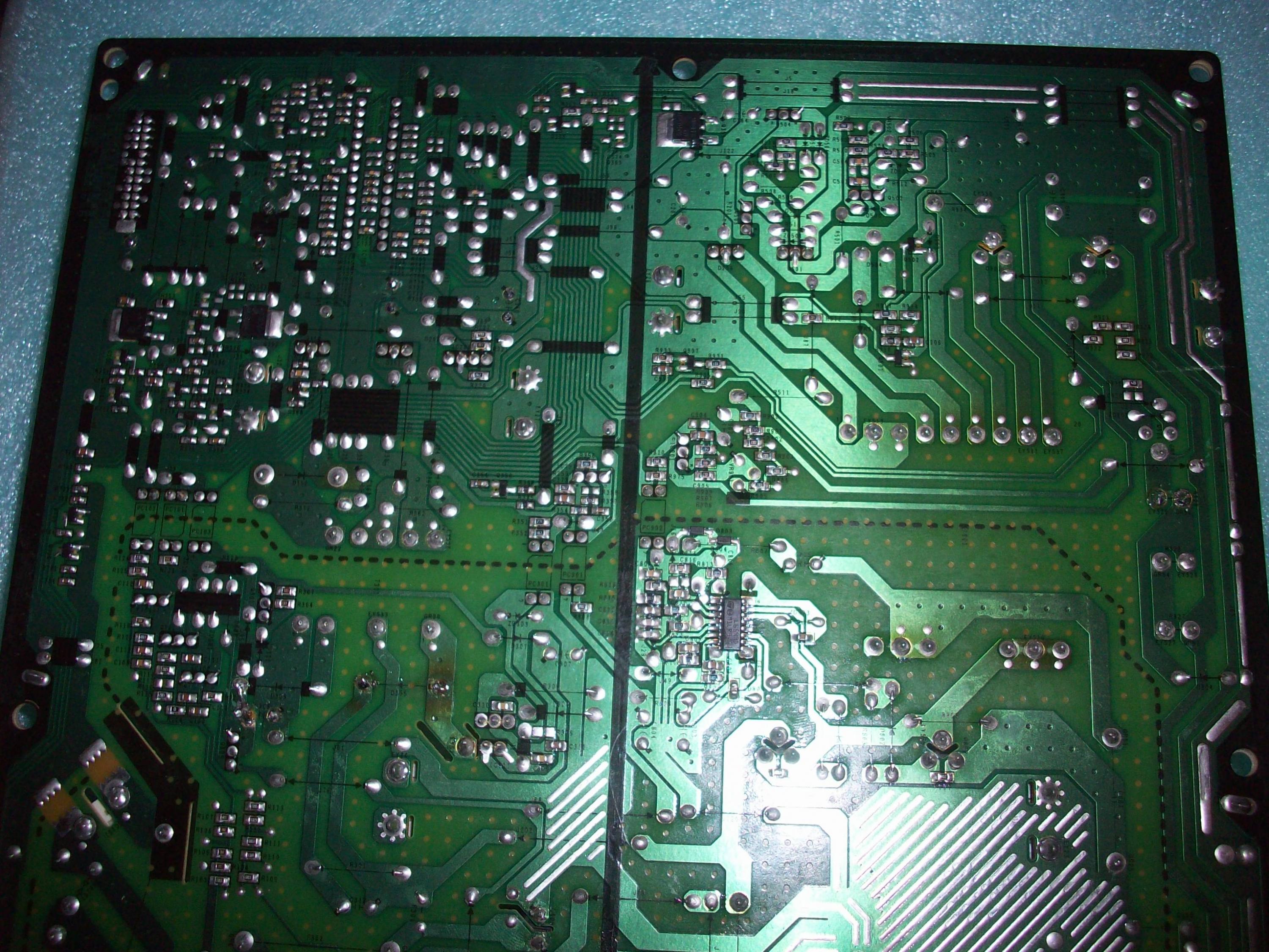

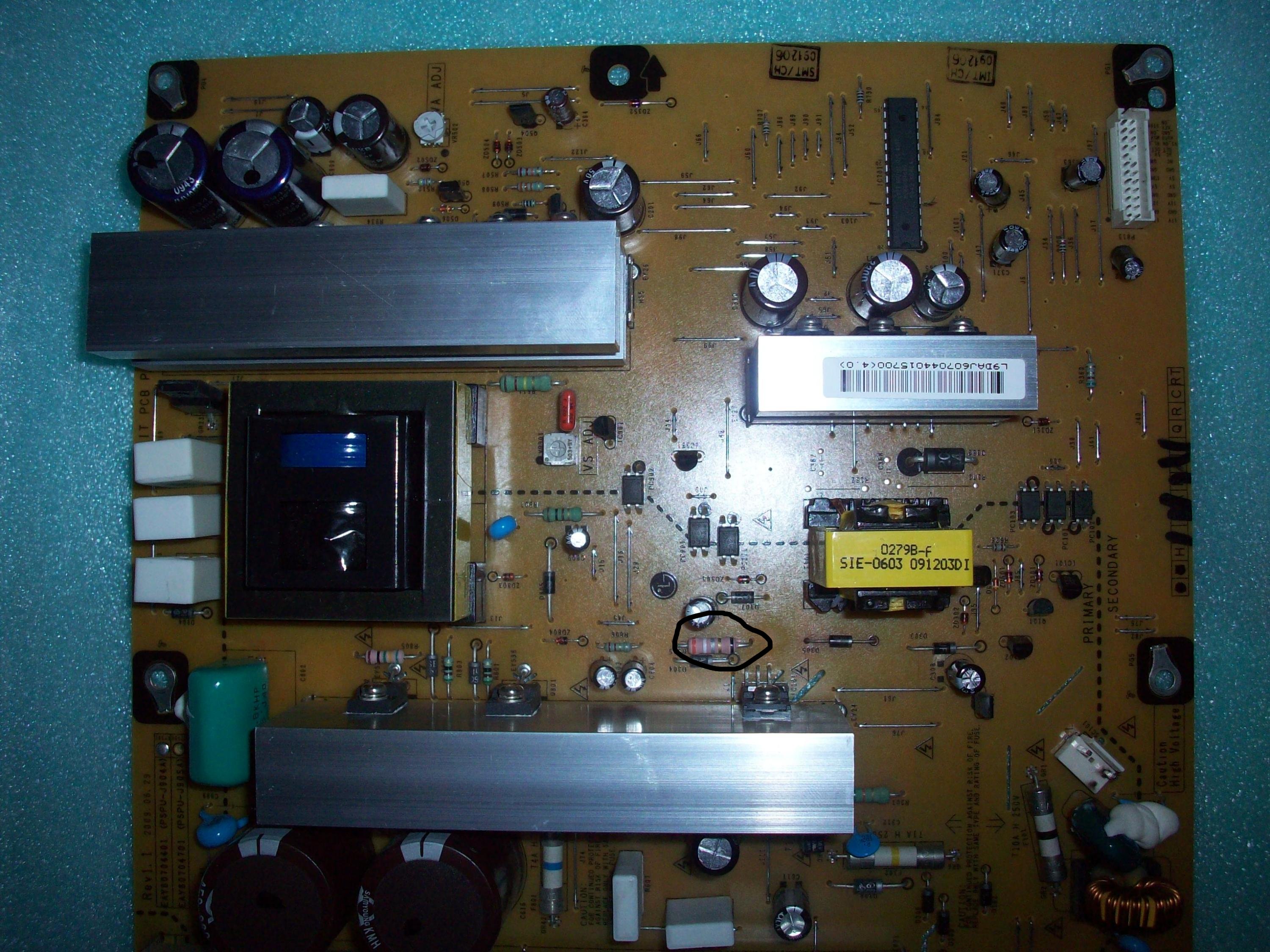

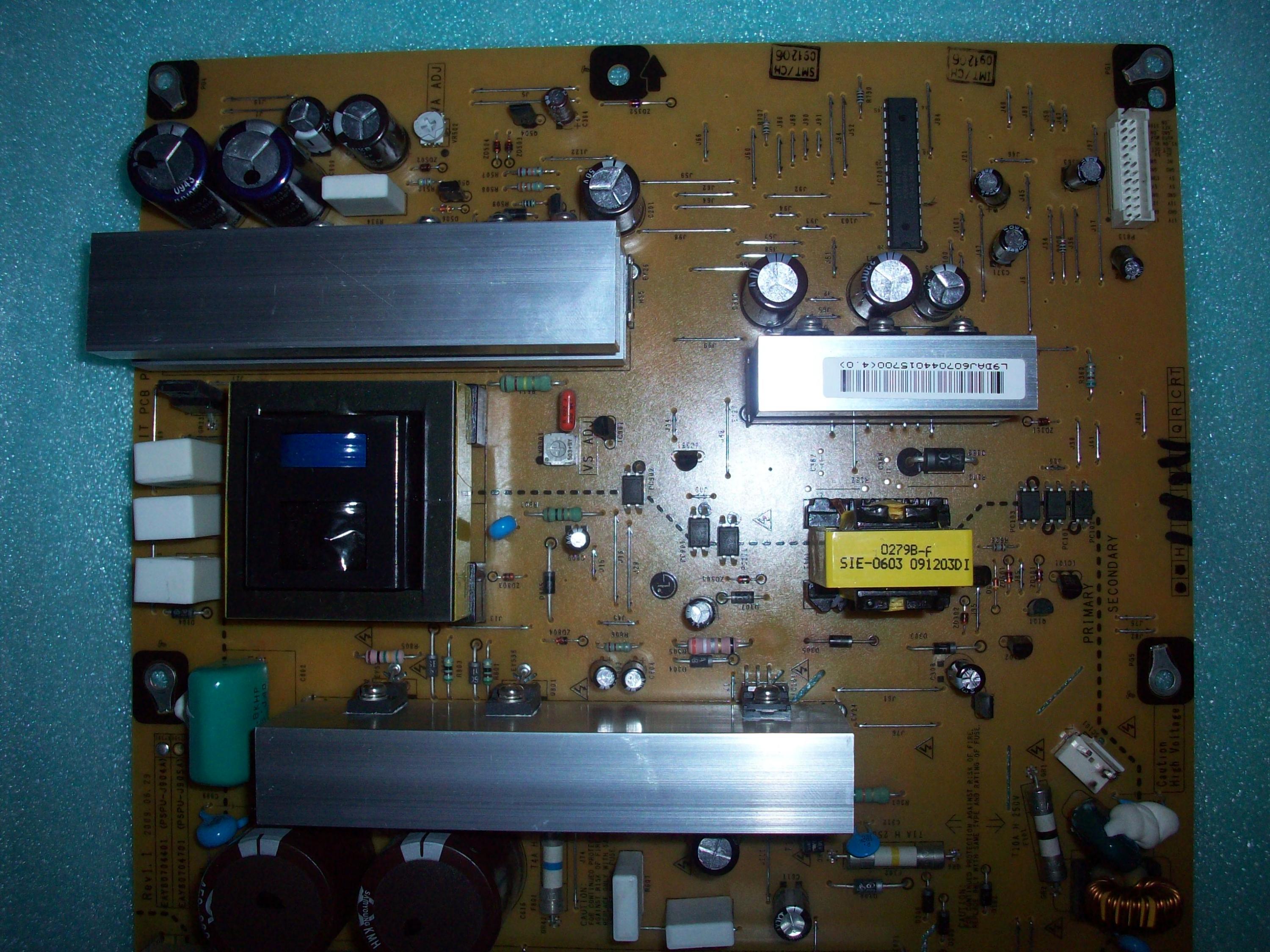

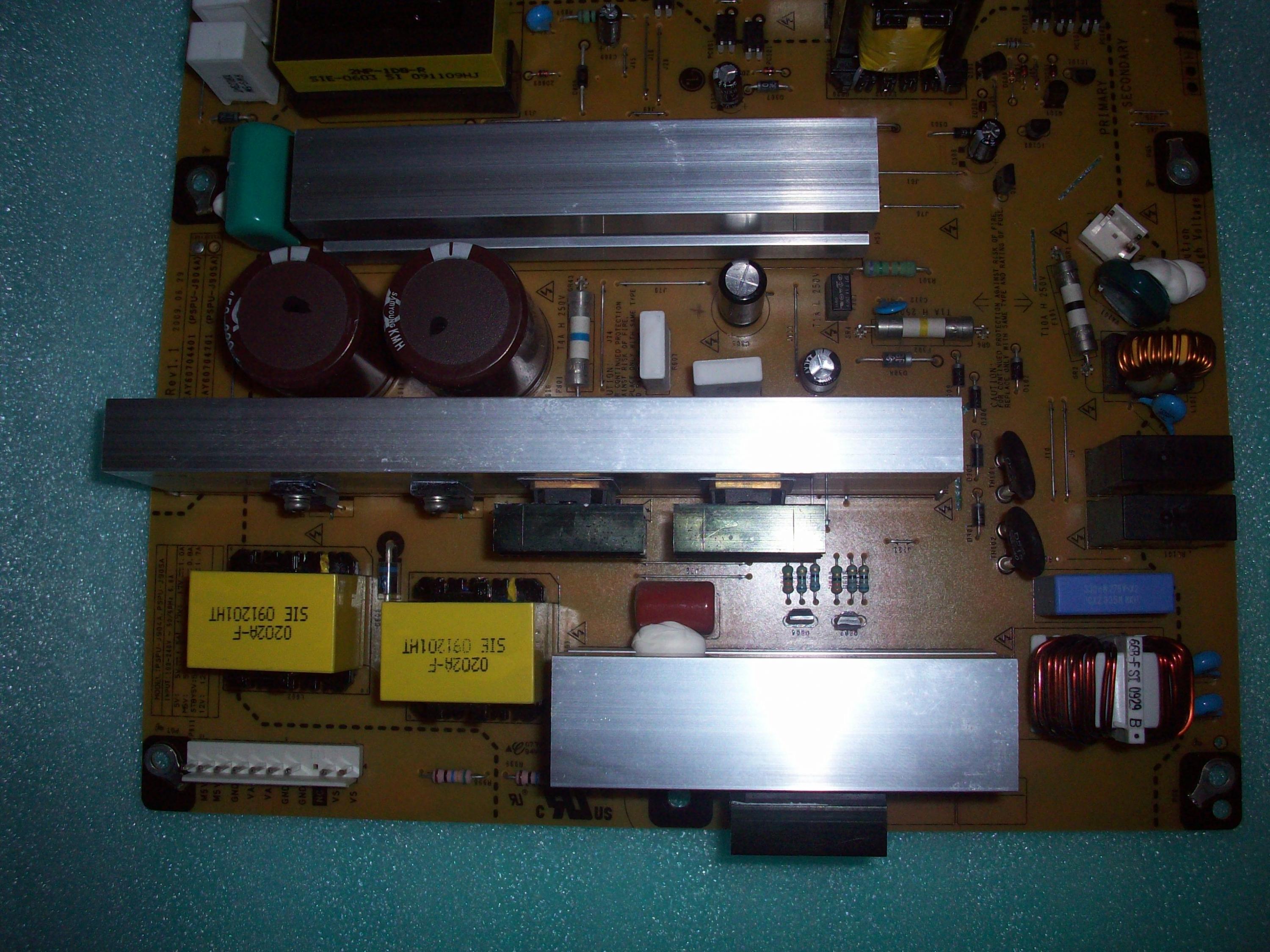

            Re: LG 50PQ6000 unstable 5v standby
            Here you go they came out better then I thought they would:
                Check the resistance of the two power resistors, R607 and its sibling (can't see part number).
                Is the clicking happening when the PSU is plugged into the TV?
                How many volts are you getting on the big brown filter capacitors, C610 and C611? In standby? When trying to turn the PSU on (when it's in the TV)?
                  Test this resistor. If it is good, it should test less than 0.5 ohm; subtract the reading your meter shows when the leads are shorted. It is a 0.39 ohm resistor, I think.
