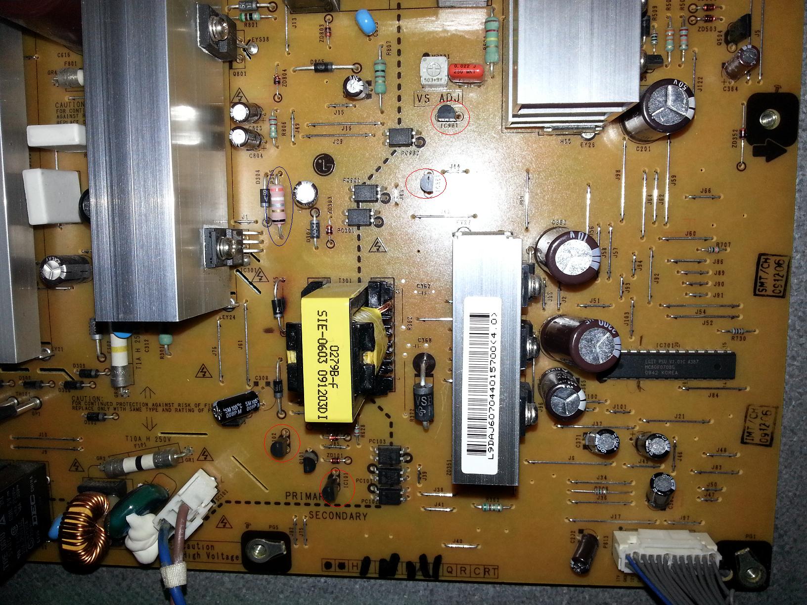

                        #191
                        Re: LG 50PQ6000 unstable 5v standby
                        I replaced 4 x TL431 but still a low stand by voltage.
                        I was lookng at this resistor and it was sutch a low resistance I couldnt check it??
                        Ps. have circuled a few bits.
                        Repaired: LG50PQ6000
                          #192
                          Whats with that diode looks brown/burnt?
                          • Baileybum1234
                            • Sep 2012
                            • 245
                            #193
                            Just been replaced with a new 1N4007. The original was shorted.

                                    #197
                                    It would be 1N4007S not IN4007S.
                                    But anyway that's the right part.
                                    Is the new part shorted in any way?
                                    Does it measure 4.4V with main board unplugged?
                                    • Baileybum1234
                                      • Sep 2012
                                      • 245
                                      #198
                                      New 1N4007 seams ok with diode test on DVM.
                                      4.45vDC board unplugged.
                                        #199
                                        OK, can you buy beg borrow or steal a 10 ohm 5W resistor? We need to see if P/S is stable under load.
