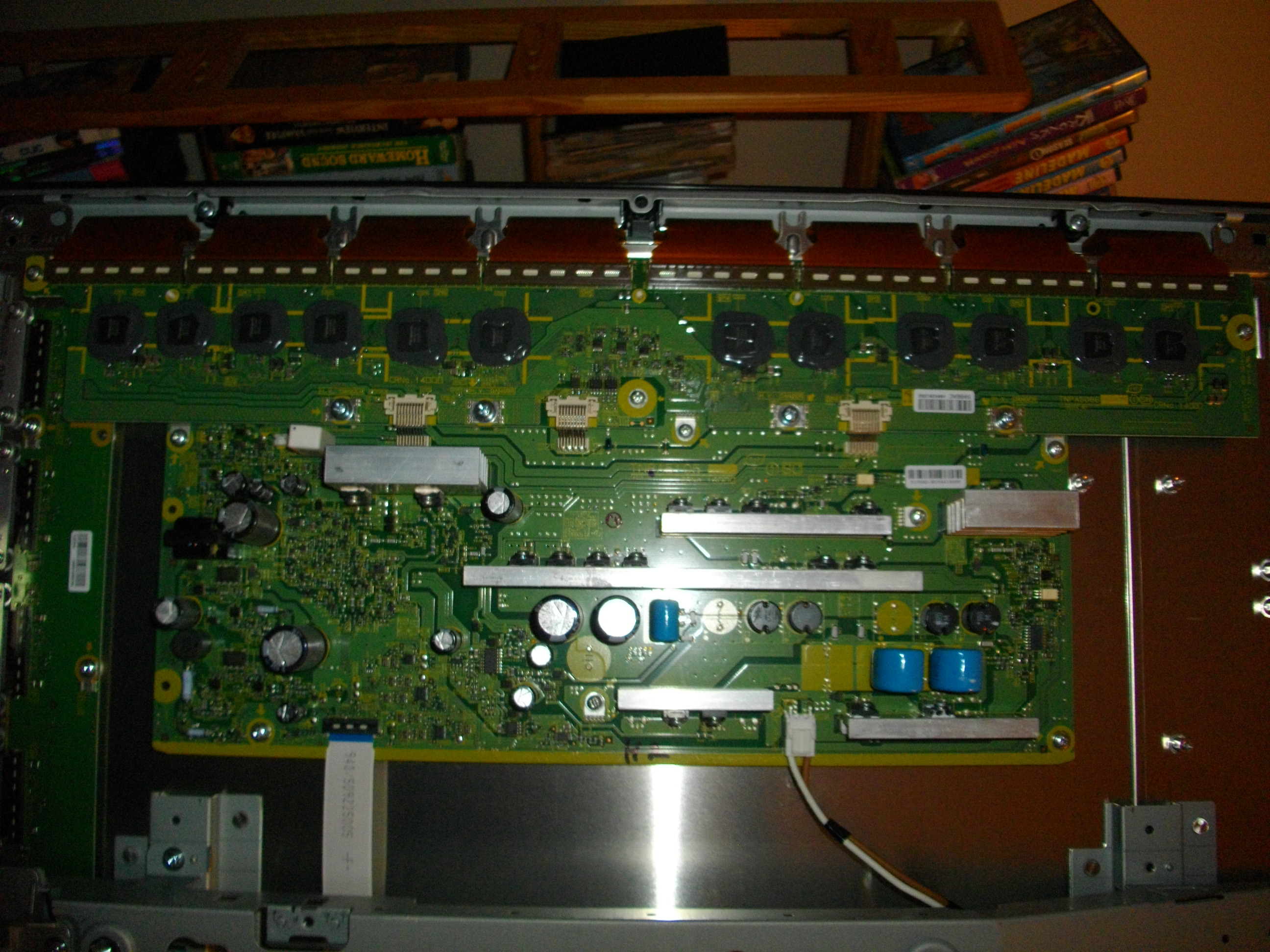

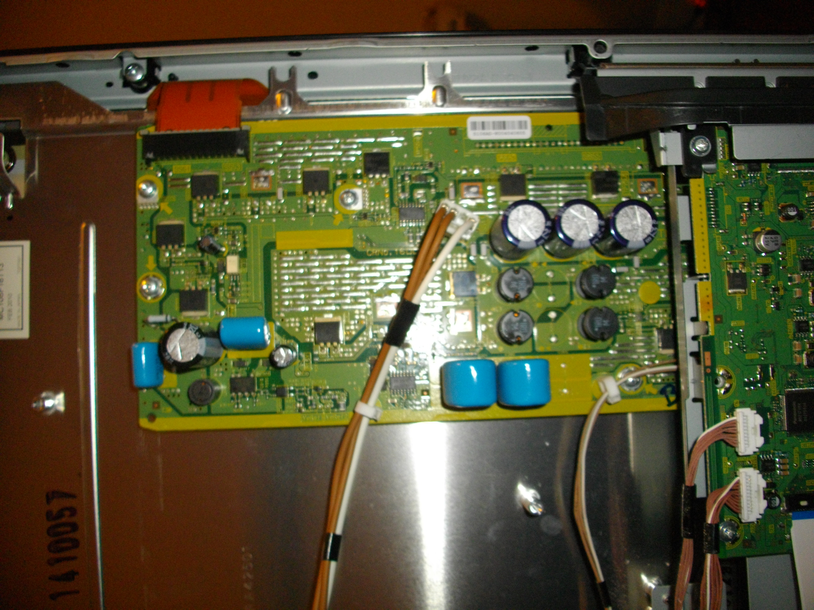

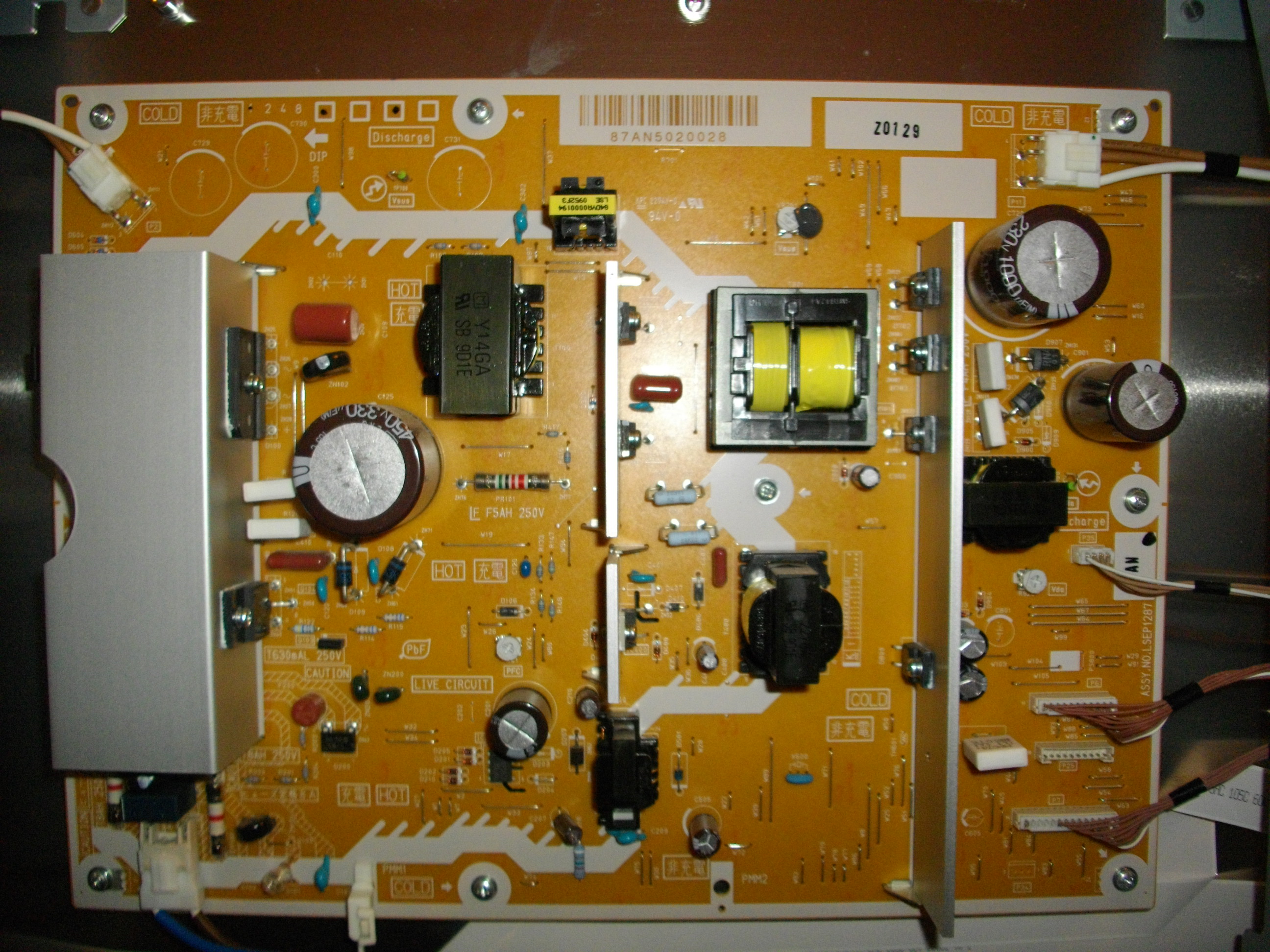

    Ok hear is the rundown.
    TESTED STB 5v 3.3v is acting a little weird (need to find pin out for this psu)
    Vsus 207v, 15V shows up and gone with Vsus.
    LED's light up on SS and SC
    So it looks like all systems go..but no :S I will upload pics right away.
    Any pointers?

    1 blink on a p42s1 is standby 5v sense timeout/ Comm error with IC9003

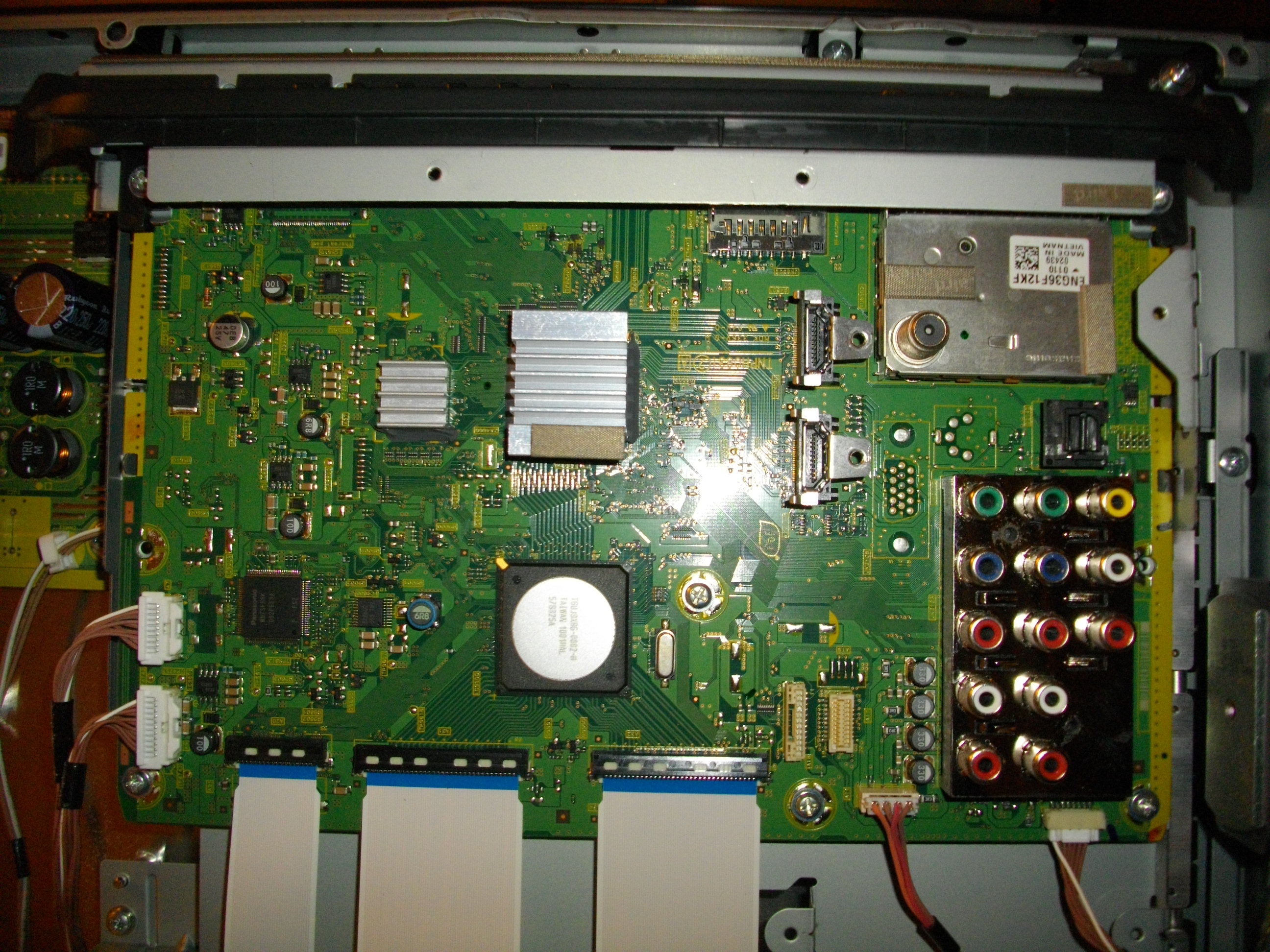

      Pics. I have read about the ic9003 any way to confirm?

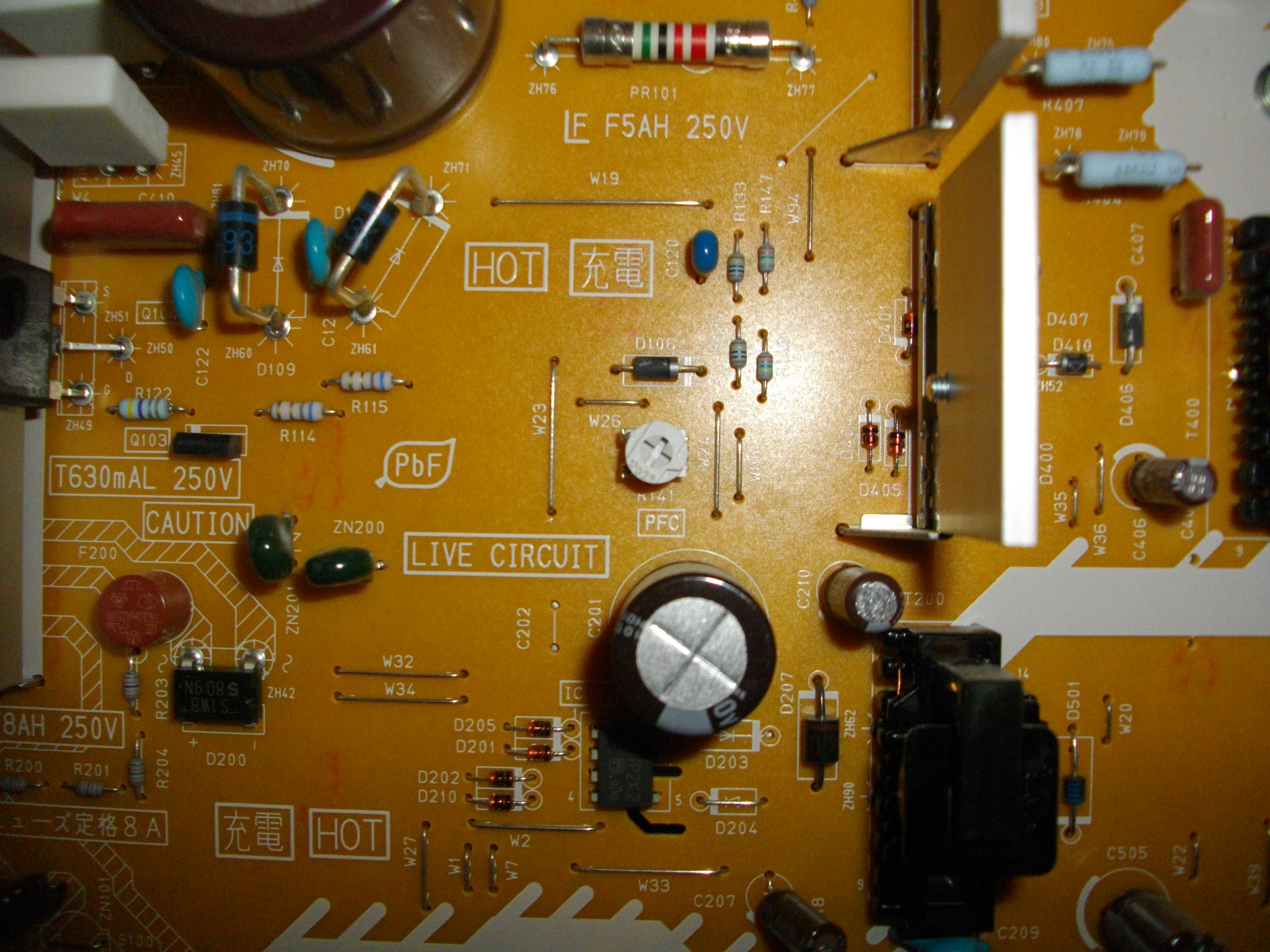

      Also, I hear a slight arcing sound in the upper right quadrant of the PS

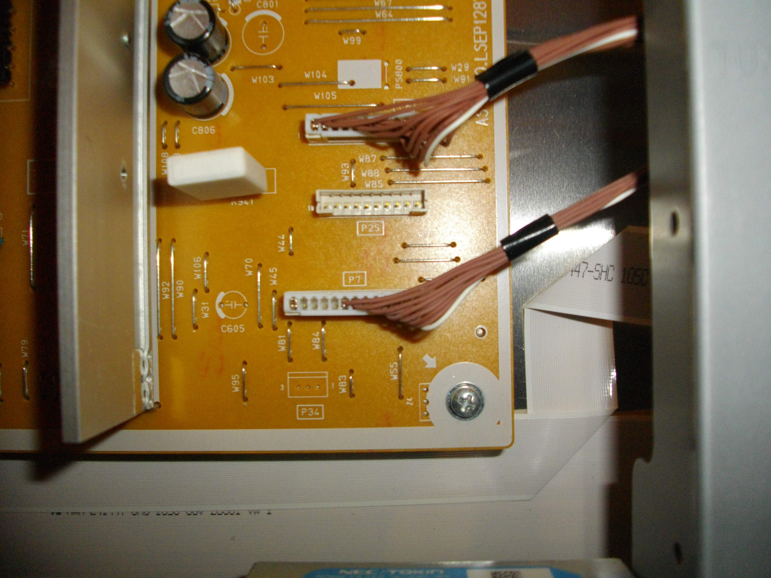

          With other board it powers up right, but that is all I can do because all connectors are diffrent other than IR, Aud and the 2 power connections.
          How do I trouble shoot what component is bad. or try to trace it along and check everything?

            Do you get a picture? I doubt that the 1080p panel would work with a 720p board.
            IC9003 is the main microcontroller.
            Have you got the SM? If not, here it is:
            http://tgohome.com/ServiceManuals/?d...&Search=Submit
            Not sure which pin triggers 1 blink but there's an A board schematic from page 48 onwards.

              F_STBY_ON is only showing 4v....could that be a problem?
                Re: Panasonic TCP42S2 1 blink
                Sorted out the 1 blink...1/2 way anyway, Now I have good pwr on 3.3v signal, but only have a momentary Panel_main_on.
                seems like the panel cpu may be toast

                    1 blink was caused by a bad Vreg for 1.8vsub
